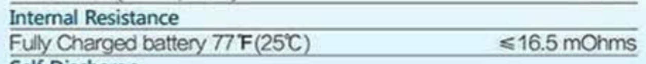

The manufacturer's data sheet list the internal resistance.
So far, NO ONE has said WHY it is ok to charge this battery at more than the manufacturer's recommended rate.
or how the maximum charging current is limited by anything other than the internal battery resistance.
There is an old saying: "I am from Missouri the show me state. Show me." ... how one will not go over the manufacturer's recommended maximum charging current in a typical RV aircraft installation using the alternators that the majority of these aircraft are using.
