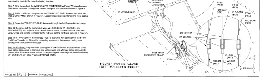

I am having trouble getting parts numbers for the molex connector to my fuel flow transducer. I have an older kit with three wires coming from the fuel flow transducer. My new wiring harness comes with a molex ES-00008 connector. What I need to know is the part number of the molex connector that mates to the ES-00008 and the part number of the pins that insert into the mating connector so that I can connect my fuel flow sensor to the wiring harness. Does anyone know these part numbers?
Jeff
Vans Support Says:
ES-00007 is the molex mate
ES-00005(pin) and ES-00006(socket) are the pins and sockets
