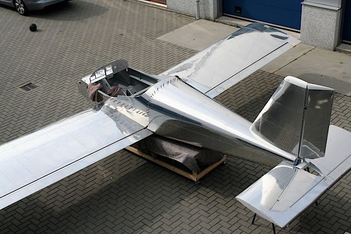

Yesterday I tried to fit the wings but they didn't fit properly.
The left wing went better than the right wing but I need to lift the spars for about 1/16' at the bulkhead cap position to insert the pin. The problem is that the spars touches the bulkhead Cap. The pin at the end of the spar can be installed.
Anyone needed to trim the bulkhead caps?
Any further ideas before contacting Van's?

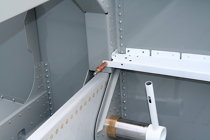

Joeri,
I relieved my bulkhead caps a bit. I know of at least one other plane that did the same.
Tony
Tony thanks for the picture. I had already searched your gallery but was not able to find a picture about the bulkhead caps.
Did you trim the caps when they were attached to the plane or did you drill out some rivets?
Joeri.
The other plane that I saw over a year ago with the bulkhead cap interference was one of the original builders and he trimmed them after installation with a Dremel. I was not at this point yet so I trimmed the caps before installing them. I thought Van's was made aware of the issue.
There is also an issue with that hole you see in the picture in the bulkhead not being present. The hole is for the wire to the spar pin magnetic switch. I had to drill the hole after the fact, as did others.
