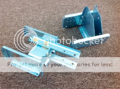

Deluxe kit
Dave,
John had to wait so long for his fuse kit that Van's sent him the deluxe blue anodized option. Perhaps I will get the gold anodized wing kit.
Alex
John,
How did you get your parts that pretty blue?
-Dave
Easy?paid the man at the anodizing shop.
Before anyone asks why (since these parts are buried under the floor and thus appearance is not part of the equation) the answer is that I didn't want to shoot primer on control linkage parts so as to avoid any possible paint thickness build-up from compromising freedom of movement.
