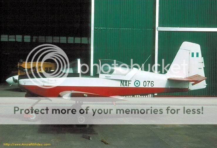

Air beetle IS/WAS a Van's RV-6A....
Dornier replaced the rod nose gear with an Oleo, among other things. Best picture I could find.
It's not clear if they are still in operation. They are almost 40 years old now, even given the decade (2000 - 2010) they were out of service, you have to wonder.
bigger rudder & counterbalance vs the original 3-4-6 which had none.
If Dornier were involved it is likely they did the engineering properly. Strut looks similar to that used by Grob on G115.
Notice also main gear legs look kind of like 8A legs, wonder what type gear leg mount system they used.
Also the vertical & rudder is neither 6 or 7 shape, hybrid?
If I had to guess, probably the engine mount.
That would take the sag out if landed nose first, and make a lot of cowl interference.
The front cowl clearance would also change just by adding the static weight to the mount and removing it during flight.

Lycoming O360. I spoke to the man that did all these modifications and helped build the fleet in Nigeria. 50 some planes I think… He was there for 20 years. The big NACA vent was for the oil cooler to get it off of the baffles. They modified the engine’s compression so they could run car gas since they didn’t have high octave avgas in Nigeria. The main gear was modified to flat gear legs. The oleo strut nose gear plane never flew. Just a mockup I think he said. He said the pilots were the worst and beat the planes up badly. He talked about those wing tips too and the modified fuel tanks.
