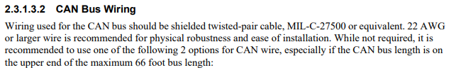

I have a G5 I will be wiring up (magnetometer and likely a arinc429 adapter).... two questions.
Garmin's recommended $8.85/ft or another less expansive "120 Ohm 24 Awg can bus wire" is $7.50 ft. I can get high quality shielded twisted pair wire for about $1.10/ft. 120 ohm really? Any suggestions?
I got the Garmin G5 used with harness but it was cut with the approved wires. Can I splice it back? I hear it can be done carefully, but it may cause problems. May be better to de-pin and start over. Suggestions?
I have to laugh with magnetometer being a 15 ft run. It would cost over $120 in wire to use Garmin recommended wire.
I am no expert to can bus, but it can't be that picky. I suppose if you have a complicated set-up with a lot of nodes.... Can bus is not new cars have had them for well over 20 yrs. I don't think they are using anything more than twisted pairs.
