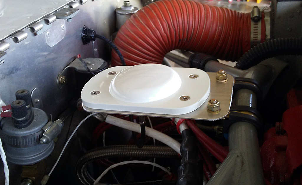

I have a very early RV-12 w/D-180. I had the Navworx mounted on top of the map box. I removed and installed the two new boxes as shown. The antenna hooked up to same type connector. They provided a short adapter wire to use my current GPS antenna and convert to needed hookup to GPS source. Wire harnesses are provided. Shane said it was ok to combine +'s, and -'s from original setup. Only had to run one of the provided harness wires from one box to the other. Do setup, and RTG. Very happy so far. Will be flying again today, so will see if any issues. Got a perfect report back yesterday.
ECHO UAT - -
Forgot you asked about where output Antenna is mounted. From the Navworx install, I have it under side near first rib of tail. About 5' from original TXP Antenna. They provided a new one, but I just used my old one.

I run the coax under the arm rest, behind the gas tank, into tail section. The GPS receiver I mounted on same original plate as XM receiver would have been mounted, beside Garmin receiver. This install is SIMPLE compared to the Navworx. Hook power lead to both units. Hook ground to both units. Connect ONE wire from provide harness to other box. I had a plan in mind, so I was ready to go. It took about 2 - 3 hours until elec bay cover was back in place. Took a few minutes to do setup. Then fly and test it. My wiring is crude looking because I left all the excess wire in a coil on top of the boxes. Next time in I can remove all the unneeded wires if I want. I left old wiring in place also, just being careful not to have bare wires in contact with anything.

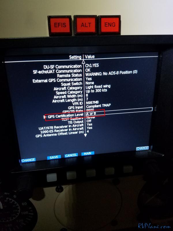

Worked through learning curve
Got the Echo UAT/GRT combo mounted in the 12. I really like it that the components are a lot smaller then the NavWorx box we were originally thinking about using before the FAA fiasco. Wired the Garmin GTR200 com in the second set of ports on the GPS. Will eventually put the combo in my 9A when the pocketbook will allow. I learned quite a bit on setting up the ports on the GRT Sport EFIS's working with support from the GRT guys. Will make the upgrades on the 9A a lot easier when I add my second EFIS screen. Wired the combo into the 4th set of ports on the primary EFIS which are the high speed ones.

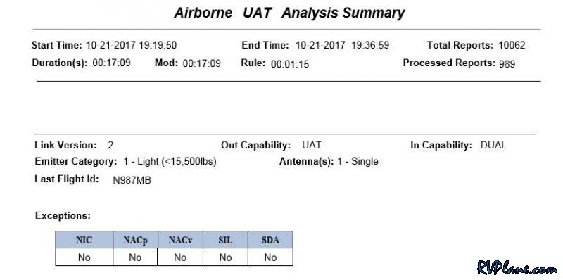

compliance report for Echo-fix
Mike, let us know how the compliance test with the FAA comes out, when you get a chance.
That will be awhile
The plane isn't flying yet so it will be awhile. Kind of neat seeing targets on the screen when turned on.
uAvionix EchoUAT + SportSX
I installed the EchoUAT with the GRT Sport SX EFIS. It took a while to get the settings right, but all works fabulously!! I couldn't be happier. :D I am using the transponder "sniffing" feature with a GTX-327, so the RV-12 performance should be the same.

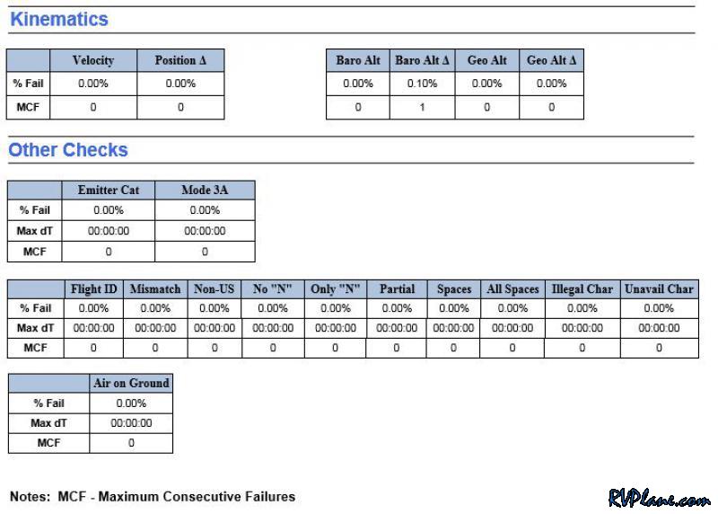

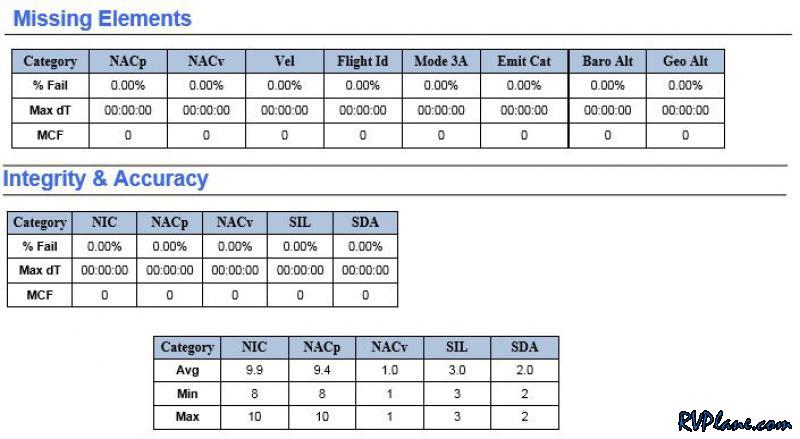

And the FAA Compliance Results
Full write-up and more details:
http://rvplane.com/?categoryid=10000&dayid=1373
http://rvplane.com/?categoryid=10000&dayid=1375
http://rvplane.com/?categoryid=10000&dayid=1378 (lower Part of writeup)
