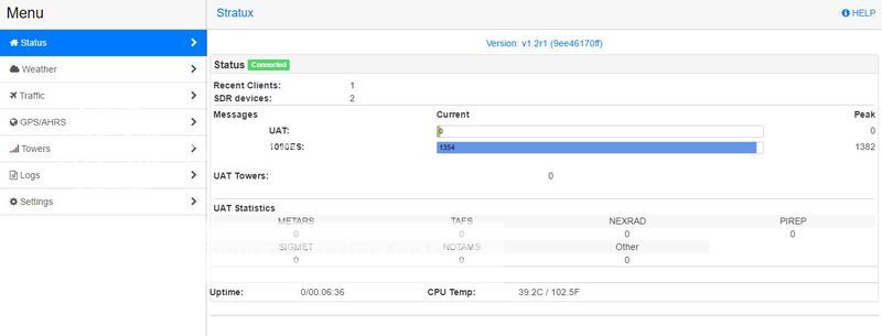

Building dual band Stratux from kit on Amazon
Easy peasy.
One thing isn't clear though. Neither of the nano receivers provided have any indication of the frequency they are tuned for. Can't tell which one should be connected the appropriate antenna.
Or am I missing something?
Powered up unit and viewed output through wireless connection on my laptop, all sitting on the dining room table. All seems good on 1090 but no indication of signal reception on 978.
When powered up, one of the receivers has a blue LED illuminated, the other is is white with a green caste. Don't know if this means anything. No mention of how to distinguish in the instructions. Am I missing something?
Hope someone has a clue to this. All help appreciated.
Check on either side of the metal USB portion of the SDR, mine were labeled in sharpie there.
Failing that, you can boot up with only one plugged in, and at the command prompt type:
Code:
service stratux stop
rtl_eeprom -d 0
If your SDRs were purchased pre-programmed, the response to the above command should include a line marked "serial number," and the serial number strong should contain the number either 978 or 1090.

No id of any kind. No monitor either. Can this be done when connected wirelessly to laptop?

Yes, and you can configure the two radios for specific bands. You will need something like PuTTY or a similar SSH program on your laptop (www.chiark.greenend.org.uk/~sgtatham/putty/download.html) to connect to the Raspberry Pi. Then you follow these directions.
If your antennas are tuned for individual frequencies, like the Dmurray units, you'll want to take this step. Otherwise stratux will assign the frequency and you'll only have a 50/50 shot that they match the antenna.

Interesting... My SDR's were marked 1090 and 978, as were the antennas. I have always used them with the corresponding antennas, but haven't done the naming step in the previous link... I thought as they were marked for the frequencies, that they would be somehow labelled internally (software) such that the Stratux would know what to do.
Does the script write something to the SDR that "brands" it with the frequency, or does the script just set something on the PI that says "when this serial number of SDR is plugged in make it this frequency?"
The process sets the SDR receiver so that when it's plugged in, the Stratux software can tell whether it's designated for 978 or 1090. If you bought a pair of receivers and antennas that are marked for the bands, the seller should have already set them up for you.
Correct. The frequency designation is stored on the SDR, not in the Stratux s/w. When you follow the instructions, it writes the detail to the eprom on the SDR and stratux reads this on startup. I am sure if they were labelled, someone did this step.
