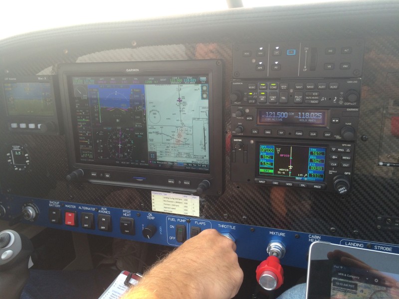

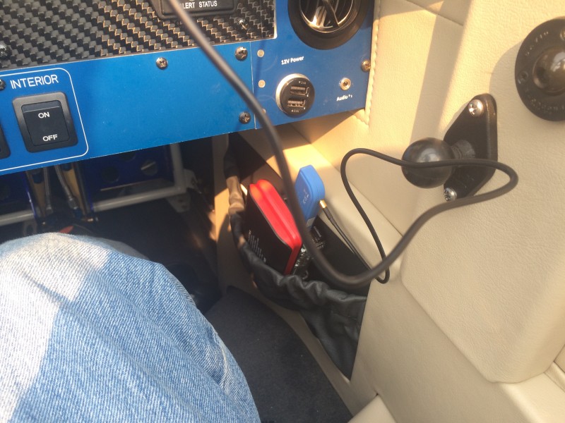

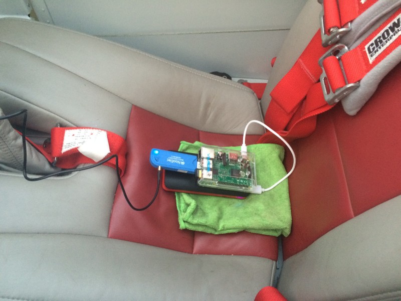

I shirked my duties this morning and flew with the Stratux up on my glare shield. As a point of comparison, I have a GDL39 with a dedicated antenna on the bottom of my aircraft back under the RV-8 rear baggage area.

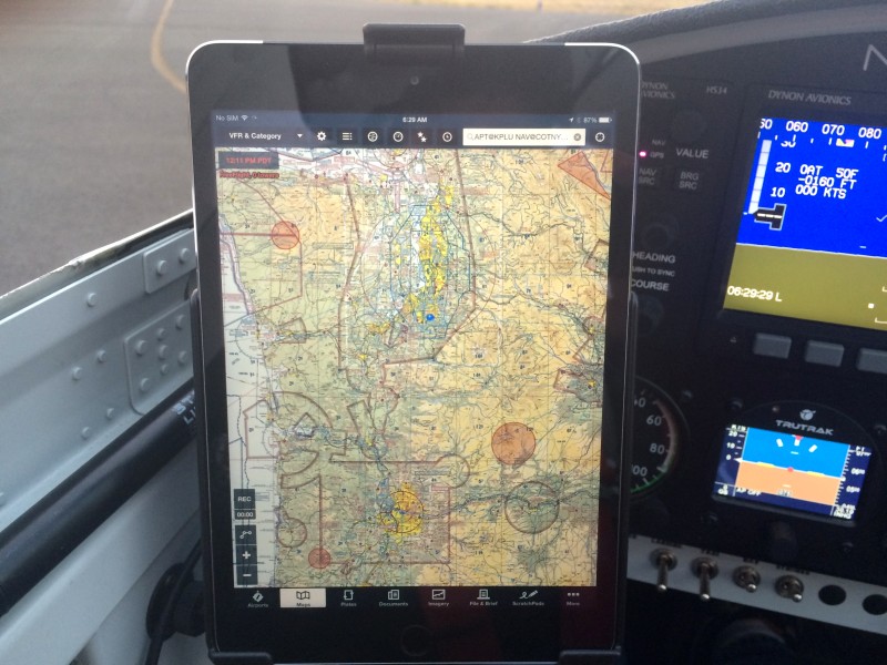

I had no problem getting my iPhone 6P to connect to the Stratux wifi. The first problem came when I tried to get ForeFlight to recognize the Stratux (FreeFlight) device. It took 20 minute of random ideas and then it connected. None of this surprised me since I had the same problem yesterday in my bench. Subsequent boot-ups of the Stratux had no problem with connecting. I'll classify it as one of those random things.
During ground ops and in flight I noticed the ForeFlight "connection" to FreeFlight would drop. This again was random. When I looked closely at the videos linked to the reddit posts I notice it happened to his system as well.

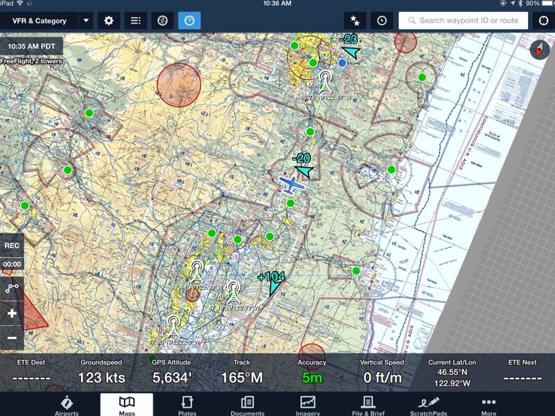

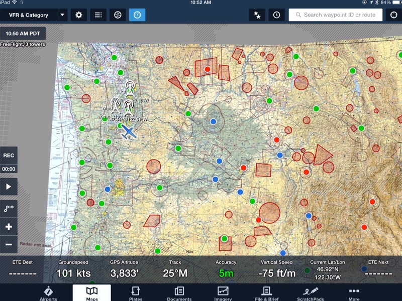

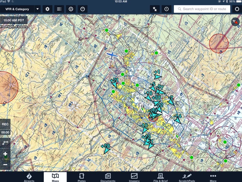

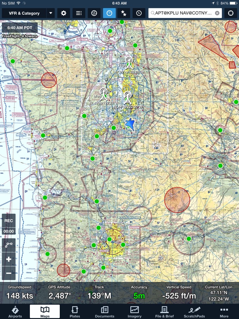

I picked up the first tower at 650' AGL. It was unreliable. I would lose it frequently. The direction and orientation of the aircraft would contribute to the loss. At 2500' AGL I had two towers but that would fluctuate often back to one and zero. By comparison, the GDL39 had five towers. At 3500' AGL I had three towers with the Stratux ranging from 30-50nm while the GDL39 had seven towers from 30-90nm.
I did receive a 4 local radar frames and 1 national radar frame with the Stratux during the test flight. I also received 280 text reports. I checked three local airports and had METAR and/or TAF for each. I don't know the data for the GDL39 but I had radar animations and weather reports for the four airports I checked.

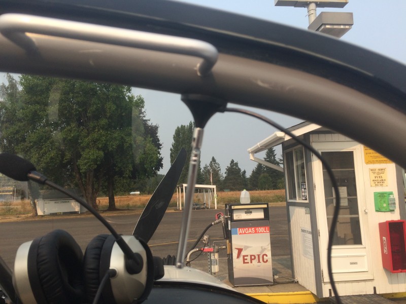

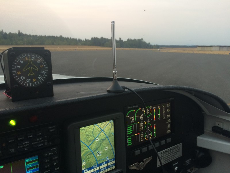

I tested with both a 1/4 antenna tuned to 978 mhz and the little SDR supplied antenna. It's a guess but I think the tuned antenna was better. Both antennas were affected by the orientation of the airplane. I observed a tower 30 miles away while flying toward it and lost that tower when flying away from it.
