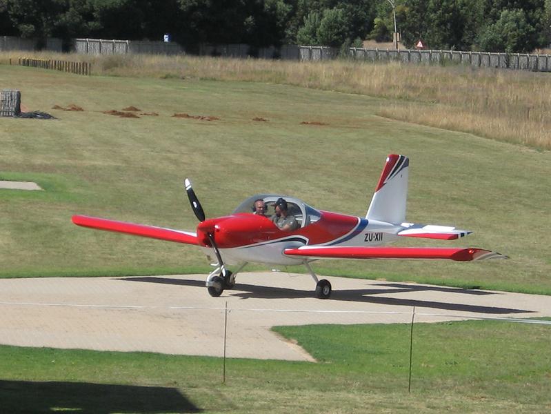

Today we did Taxi Test to Run the Brakes in, Matco says take her up to 35Knots and then brake hard to 5Knots and repeat to settle the brakes. Problem is at 25Knots the front wheel comes off the ground and you wheelie her and she just wants to take to the sky. So I had to reign myself in and nurse the front wheel back to the ground and run the brakes hard. Every time I repeat the process the nose wheel comes off the ground and she wants to go. This lady cant wait to take to the sky. But we have to wait for the official Test Pilot for Maiden flight...
We also put the final touches to her like wing walk and Canopy guides etc. She is 110% ready.
Now the WX and the Test Pilot just needs to play along. Hold Thumbs [-o<

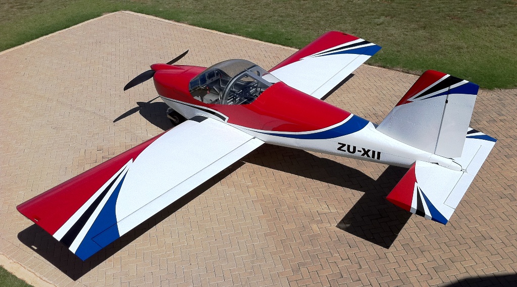

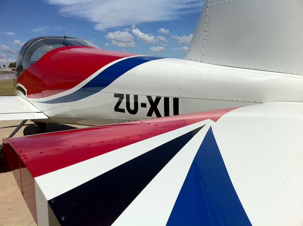

Here is the final reveal picture, some other members might post pics too. Cause today a lot of pictures were taken...
And a nice Artsy photo
Now we really cant wait anymore...SOON!

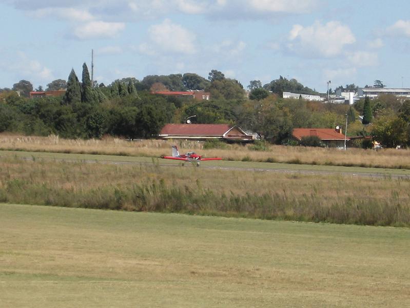

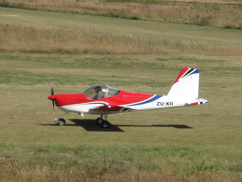

Here is some picture Peter took of our taxi test.
Myself and Gerrit getting ready for first taxi test run, and to run the brakes in.
"Thundering" down the runway performing brake run ins
Taxing back to the hangar.
We hope to get air under the main tyres soon, since the nose wheel has seen some air time already :D

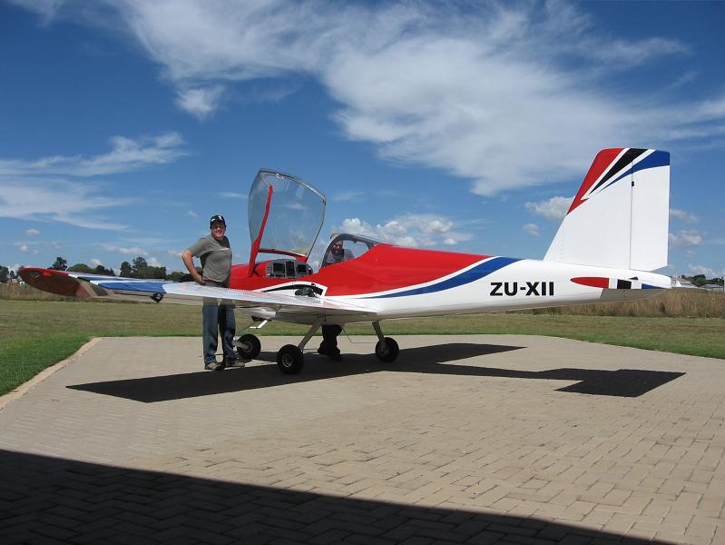

Here are some of Peter's pictures of the Taxi Tests on Monday past. Nope we still have not flown, Test Pilot's paper work is not sorted yet...
Just back from the first taxi test / brake run in
How's this for the First Group Member RV-Grin, and we have not even flown yet? Gerrit's RV Grin
Here is Alan's RV Grin after Taxi test #2
Test flight might happen tomorrow, pending test pilot's paperwork and exception report and motivation.

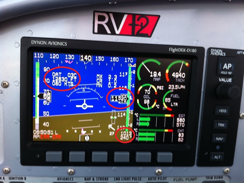

CLIMB Test
As part of proving flights to Satisfy CAA we had to do a climb test. So I logged a flightplan for sunrise Saturday from Springs our local airport to Secunda, a sector with little traffic.
We loaded the airplane to Gross 600KG (340KG Empty + 260 Payload [60KG FULL FUEL + 175KG Pilot and Pax + 25KG Baggage]) and set off.
Our airfield (5500ft) is close to an international airport, so our ceiling is limited to 7500 ft
We tried to get hold of Johannesburg International Airport Low Levels to activate our flight plan but they were not open yet, so we need to step up an airspace and resorted to contact JHB (FL115 and above) to activate it. We listened to all the big boys talking to JHB, International Boeing this and that etc here we were in our little RV12 talking "with" them. The little baby among the Big Brothers.
I expected to be routed 7500ft till outside the international airspace then to start the climb test, but a nice surpise awaited us.
JHB asked our intentions...I : "Experimental Aircraft ZU-XII on Proving Flight like to perform Climb Test to FL115 from 5500ft as per flight plan xyz toward Secunda"
JHB : "Squak XYZ and Stand By"...20 seconds later.."XII climb approved to FL115 through our aisprace towards Secunda"
Man did I hear correct, we were barely outside our airport still in Special Rules Area limited to 7500 ft ceiling and he allowed us to break the magical 7500ft ceiling. JUP I was correct!
Off we went with our little 100HP RV12 at climbing at 700ft/min through the TMA with the BIG boys talking on JHB all around us...Another Magical moment.
The Climb Test Results we got to FL115 fairly easily and our little fixed pitch RV12 was still climbing at +/- 250ft/min as the screen below is proof off at that level.
You can see it was 3 degrees C outside, also note all the temperatures and pressures were in the green after our extended climb from 5500 ft.
Not once did we have to worry about the temperatures and we could keep her at best rate of climb speed all the time. YIP we use Degrees C and Liters here...

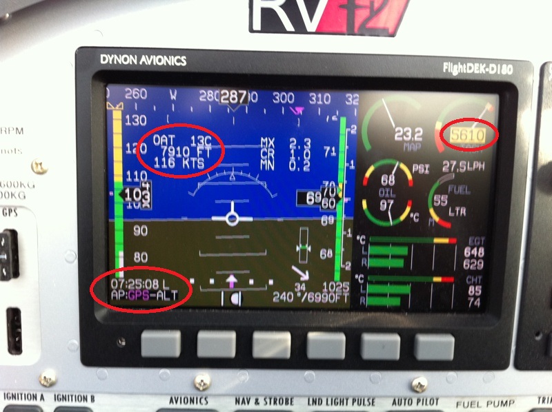

SPEED Test
On the way back, now happy with the climb performance, we decided to do a quick speed run again, since we have been playing with the ground adjustable fixed pitch prop to get a a sweet spot and we think we have found it 70.0 degrees, but did not test the straight line speed again after finding the climb sweet spot.
The Results are below...just as Vans promised. The Dynon can if you feed it the correct QNH and it measures the outside air temperature work out TAS (True Air Speed).
We switched on the autopilot to keep GPS heading and altitude hold and pushed the throttle all the way forward and waited for everything to settle in.
Density altitude was 7910 ft and outside temps was 13 deg C and that rendered a TAS of 116Knots.
A quick glance to GPS ground speed less head wind component renders the TAS numbers corrolated correct. RPM was just into the YELLOW at 5610. Remember Rotax is 5500 continues and 5800 for 5 mins.
I was not too worried, because remember at 7000 ft we loose in anycase +/- 30% Horsepower since we are not turbo charged.
Now remember this is a Sport Plane limited to 120 knots. So Vans has hit the mark again. With our Wheel pants that will be fitted later (after training) we will definitely see a couple of knots extra taking us to 120 knots limit.

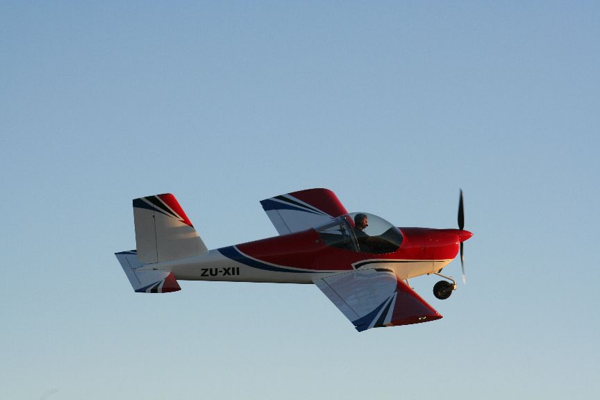

Here are some inspirational photos of our Proving Flights!
seXII reaching for the sky, late afternoon!
Approach along our cross Runway!
Fly by Shot
Late afternoon flight with the African Sun Setting
