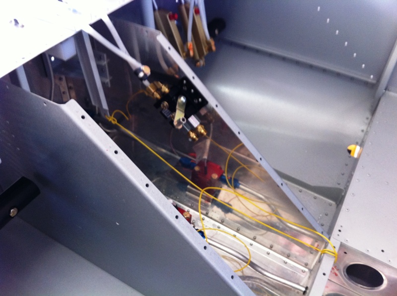

- Installed a park brake system (We need one if we want to present the airplane for ppl training approval to our CAA=your FAA)

About the park brake system... how did you do it? Could you share some details as I would like to do that modification as well.
Beautiful job! What a difference it makes to have a bunch of people working together! Just 9 days and you have THIS.
Park Brake is a CAA requirement here for PPL training...That and a Physical Magnetic Compass ;-(
Park Brake and install kit is available from VANS for other RV models.
You will need 4 additional straight brass fitting for plastic pipe since the kit comes with connectors for alu tube.
We fitted it inside the center tunnel Right hand side just above where you are suppose to clamp the brake lines with a P-Clamp. The yellow string in the photos are mimicking the route the rudder cables travel. Make sure it clears it. We will then re-use the existing P-Clamp and clamp both brake lines slightly lower down to ensure it clears the rudder cables.
So bassically your brake line routing stays exactly as is you just insert & attach the park brake valve in the tunnel RH top side.
We still have to figure out the best place to put the engagement cable on the panel somewhere...

Great pictures. Thanks for sharing this Rudi! I put this on my list of modifications. It's really nice to have a parking break and not having to fly around with you own chocks. Looks like this could also be easily installed after certification (losing the brake fluid though).
Regards
Rudi
Do you have to put the park brake control on the panel? Could you not "slot" the tunnel and extend a lever out of it?

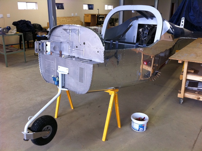

Sunday Day #10
Build Sunday 10:
(Total of 721 Airplane Building Man Hours)
We had 10 members present.
End of day Result:
- Right Wing Skinned
- Finished turtle deck and rear window installation
- Installed seats and safety-belts
- Installed upper firewall
- Assembled all the wheel assemblies and installed the nose gear and nose wheel.
- lots of small bits and pieces.

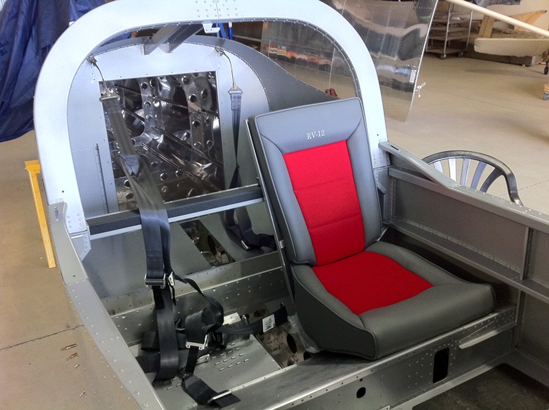

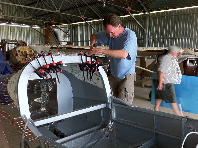

Peter busy with the rear window installation, we drilled and tapped it and then stored the window away till late in the project, cause having access helps a lot.

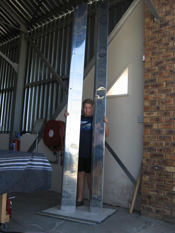

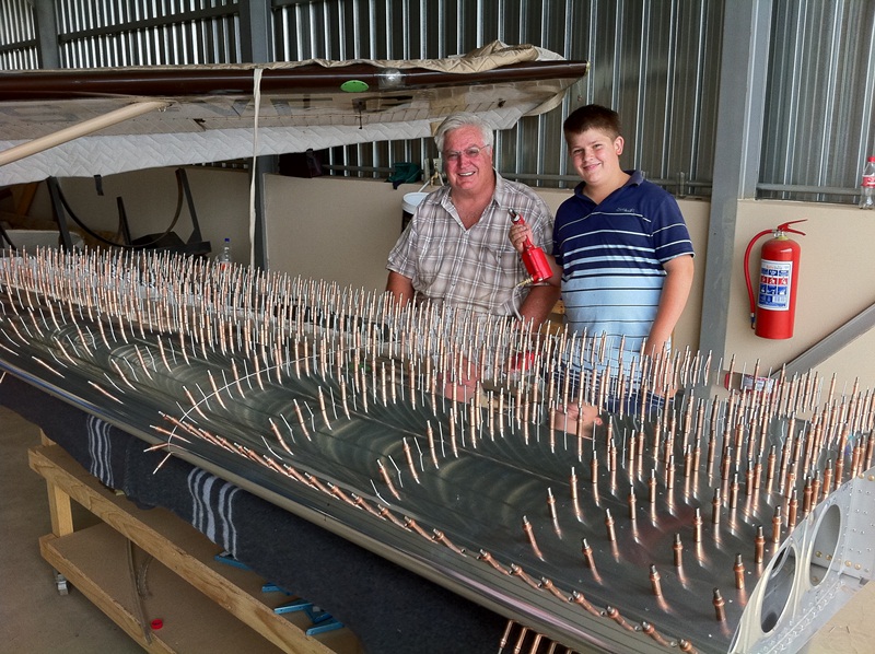

Julius and Martin's son ready to rivet the bed of nails. See even a kid can do this :twisted:
With the seatbelts fitted we wanted to see what the seat would look like. This is it...we noticed the bottom cushion that VANS supplies is extremely thick and our tallest pilots might have a problem with head room, so we are going to make new thinner bottom cushions specifically for the gravity defying pilots.
We installed the upper firewall and the nose gear and nose wheel is attached.
Next build Sunday is in 2 weeks time.

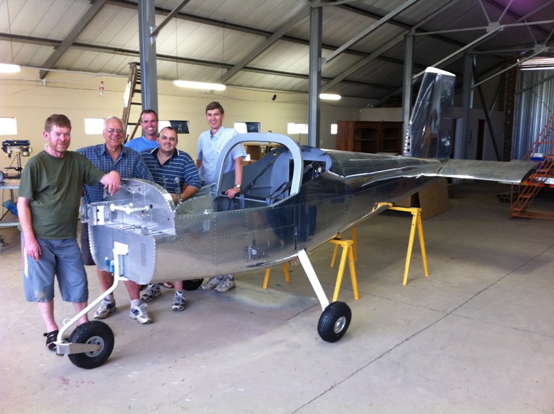

Build Sunday 11
Build Sunday 11:
(Total of +/-800 Airplane Building Man Hours)
If you exlude the first build day that was an educational day then it means,
WE ACHIEHVED THIS in 10 BUILD DAYS (and the wings are done too!)
We had 8 members present.
End of day Result:

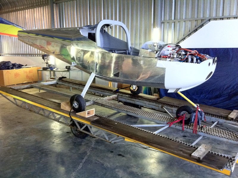

- Fuselage on wheels
- Both wings now complete
- Started with fuel tank
- Made progress with control system installation
- Made progress with wiring harness installation
- Made progress with instrument panel installation

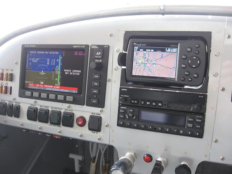

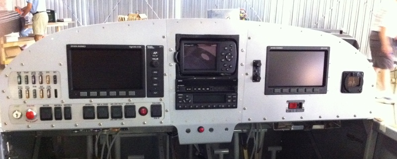

Build Sunday 13:
Gents we had summer holidays here in South Africa, so we were enjoying some time off...
Anycase We crossed the 1000H man hour mark. The end is in sight, but as the saying goes 80% done and 80% to go...
It is clear we loose effiency building in 2 man teams of 5 and all on the same day, but the social side outways the negative on time spent.

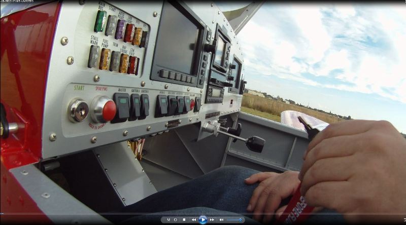

The milestone for yesterday was that we fitted all the avionics in the pannel. Sorry for the crappy cell phone picture.
Yes before you ask: Compass, Gizmo and Fuel Pump switch modifications:
- Compass mandatory by our CAA for Learning to fly
- Gizmo for ease of GPS access use between 10 members, some have their own GPS they want to swap out.
- Fuel Pump switch because we can and it helps with tradition flight training procedures.
In addition:
- The wiring has been tiedied up with cable ties , and looking neat as a pin.
- The Engine Preperation work has started in ernest.
I will see if I can source more pics from the other members to post here...
Regards
Rudi

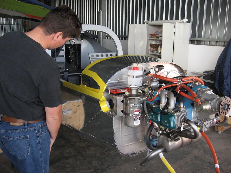

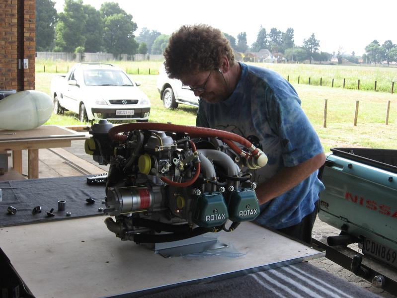

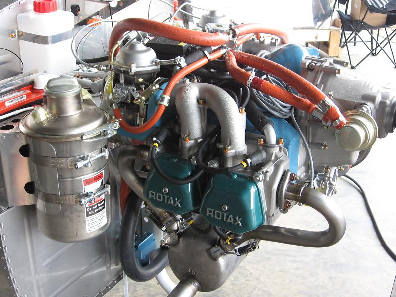

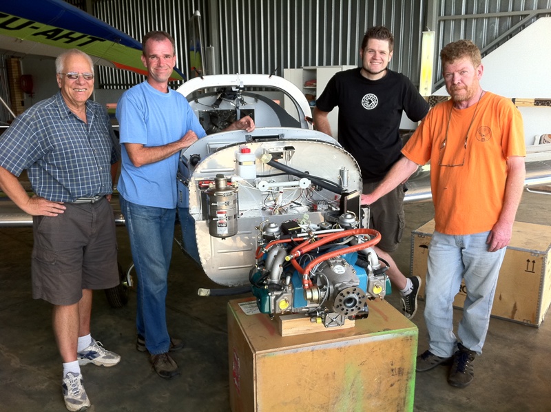

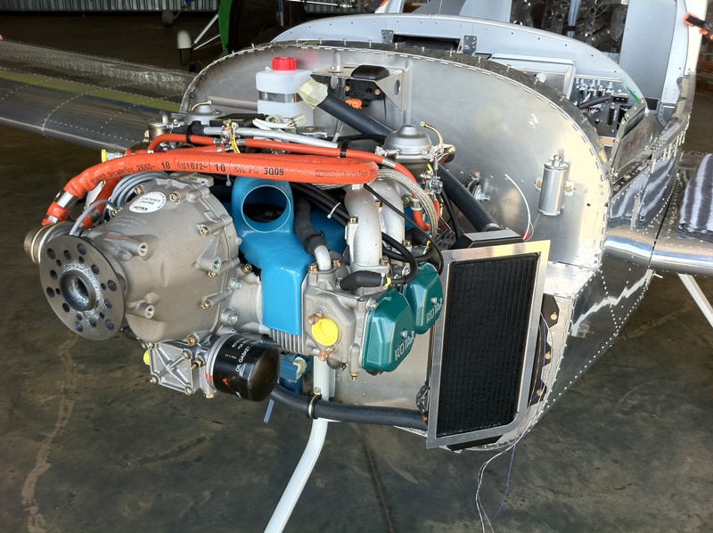

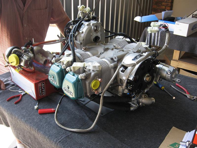

Start on the engine: Just out the box
Splitting it to do the cooling shroud

Sunday 14 & 15
I have not posted for a while so I will just copy some of what one of our members Peter had to say on a South African Aviation Forum:
The guys are so excited we did some un-official ad hoc building on our off sunday. 1/2 the team came in.

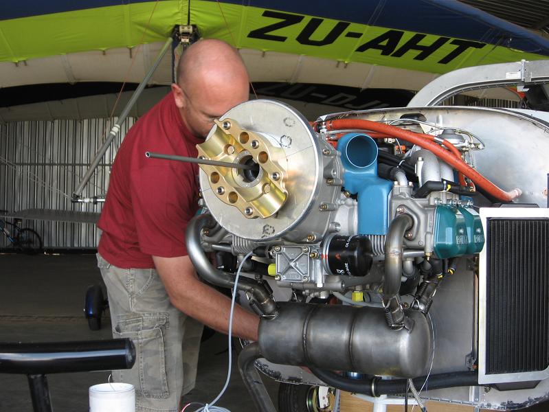

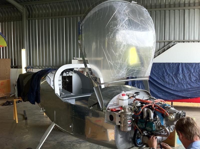

BIG MILESTONES Reached:
1) The Rotax Engine is hung.
2) The flaperons and Wings has been connected tested and taken appart again for painting
3) The Autopilot Servos and Magnometer has been installed.
Getting ready to hang the engine
It is on:
Peter:

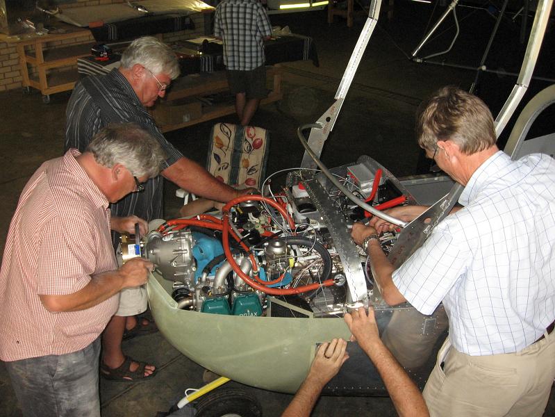

"We had eight members of the group building over the weekend. Alan continued his great work on the engine on Saturday, installing the exhaust system, control cables and a host of sensors.

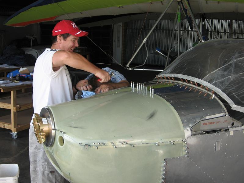

Martin & Rudi worked hard on the fibreglass engine cowls and did the "install, mark, trim, reinstall" dance throughout the day. By the evening the lower cowl was in position and work had progressed on the upper engine cowl.
The stabilator, vertical stabiliser, & rudder were removed from the aircraft, bubble-wrapped and packed with the wings to be sent to the paint shop
Small, time consuming, jobs were done on the panel. We have a working Garmin GPS now & it has made friends with the Dynon D180.
Most of the small jobs in preparation to installing the canopy onto the canopy frame have been completed, so the Plexiglass should be on by the next official build Sunday.
Finally, the pitot tube mounting bracket, spinner back plate & propellor hub were installed.

The Exhaust Done
Martin working the bottom Cowl
Dynon and Garmin Talking to each other.
more..

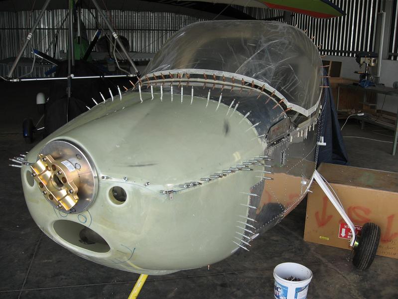

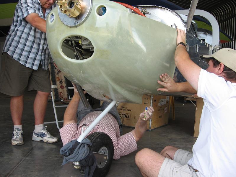

Fitting the bottom cowl. Man am I glad we waited to fit the cowls until the engine is hung and we have a reference of the prop back plate. These cowls are very flimsy compared to other RV cowls. So deviate from the plans sequence and wait with the cowl mounting, you will be well rewarded.
More trimming and fitting to ensure it fits perfect behind the spinner

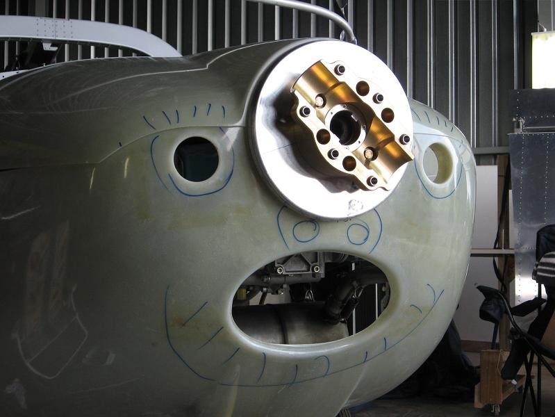

We fitted the top cowl loosely over the bottom, and had some fun with a blue sharpie! Presenting Miss Piggy, soon to be turned into a Flying Fairy.

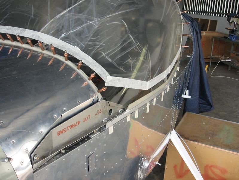

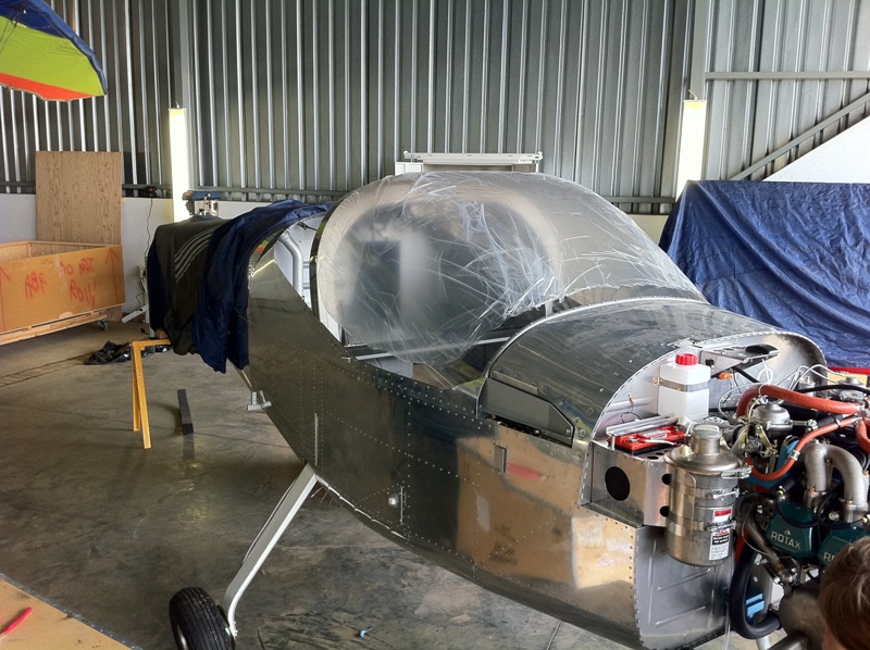

Sunday 16 & 17
Hi Guys,

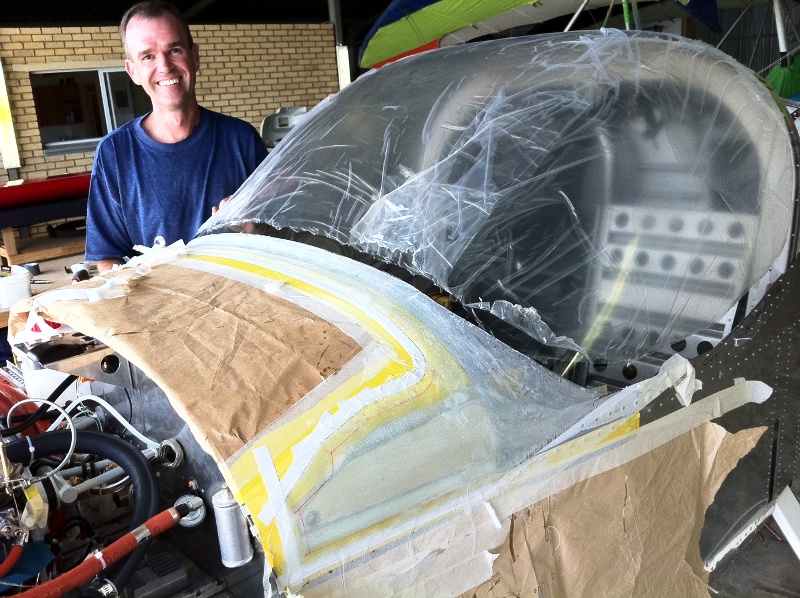

well here is the info on Sunday 16 & 17, we also put some time inbetween with the canopy fiberglass work, cause it takes many short work sessions for the glass work to cure and can't wait 2 weeks each time....

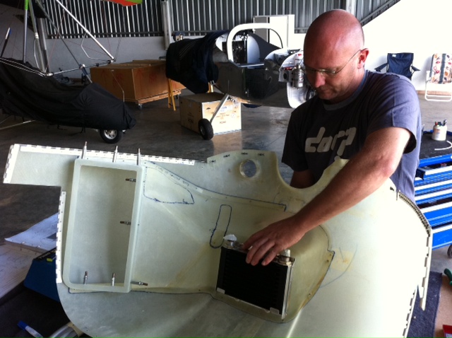

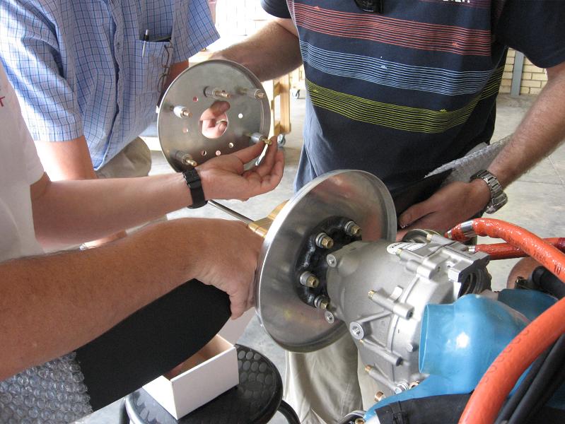

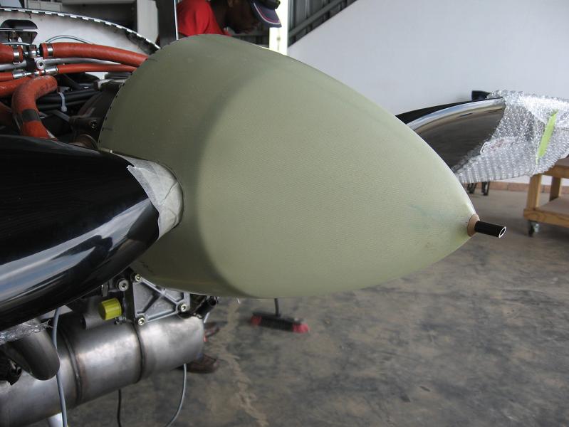

Fitting the cowls, we deviated from the plans and wanted a spinner backplate fitted on engine to ensure perfect alignment...(I did not trust cut to the line and hope for the best the plans suggested hmmm....) This is me having fun
Then we drilled the canopy plexi to the canopy frame
The Top Cowl and Canopy drilled in place
Gerrit fiddling with the cooling hoses.
Fitting the propellor and spinner
Perfect! But we had a loose blade! Sensinich is shipping a new hub.

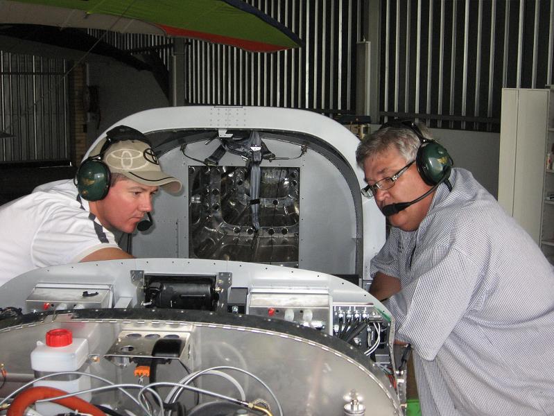

Testing the Radio and intercom with Martin
Gerrit fiddling with the oil Cooler...Jip we had to do cut-outs in the cooling shroud to clear the exhuast and rocker covers. The areas marked in blue.
The Canopy all riveted UP
Open Sesame!

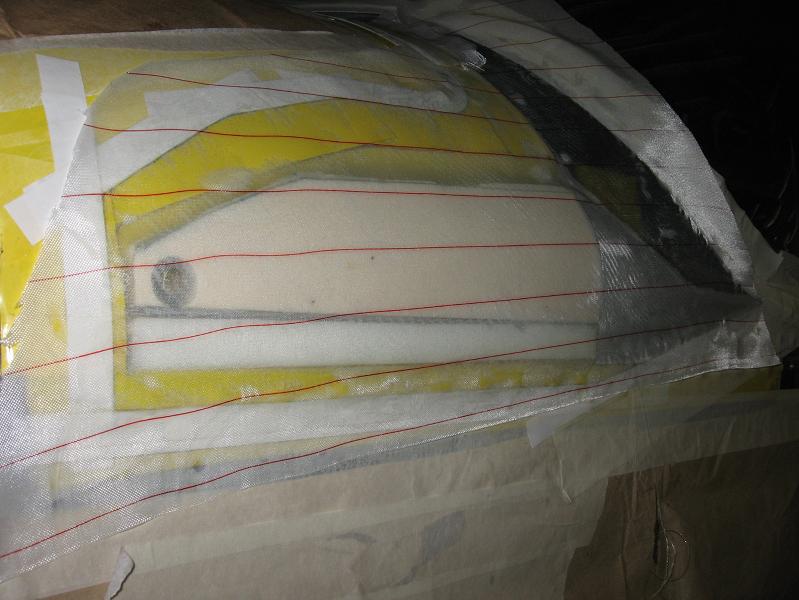

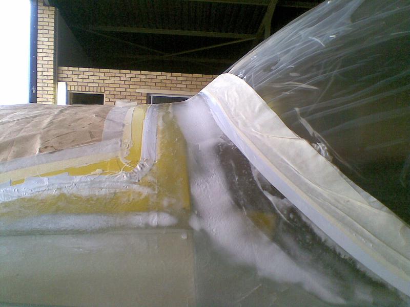

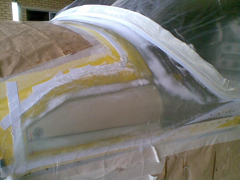

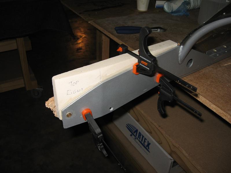

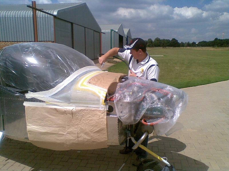

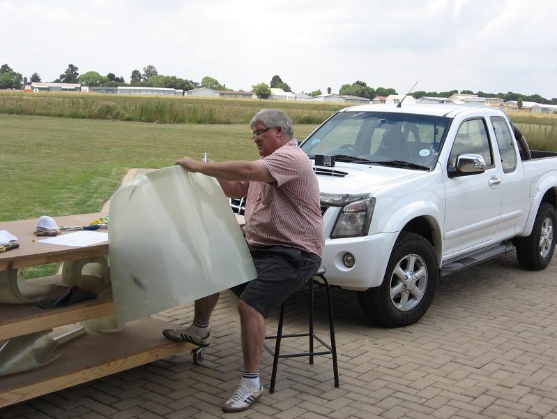

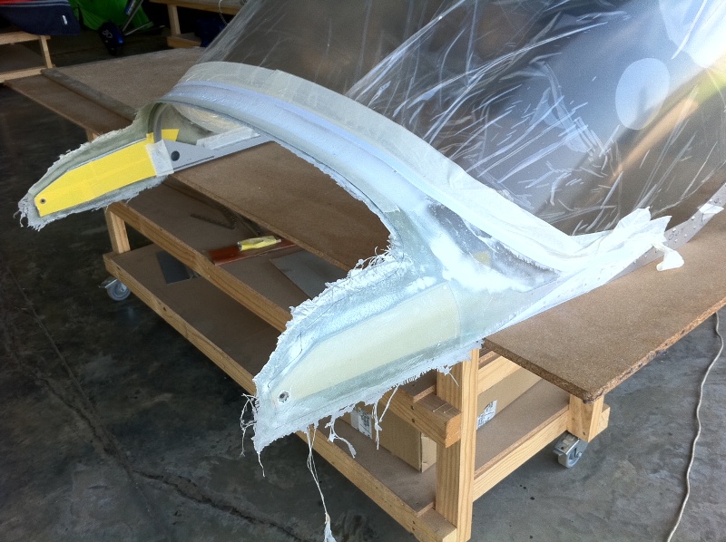

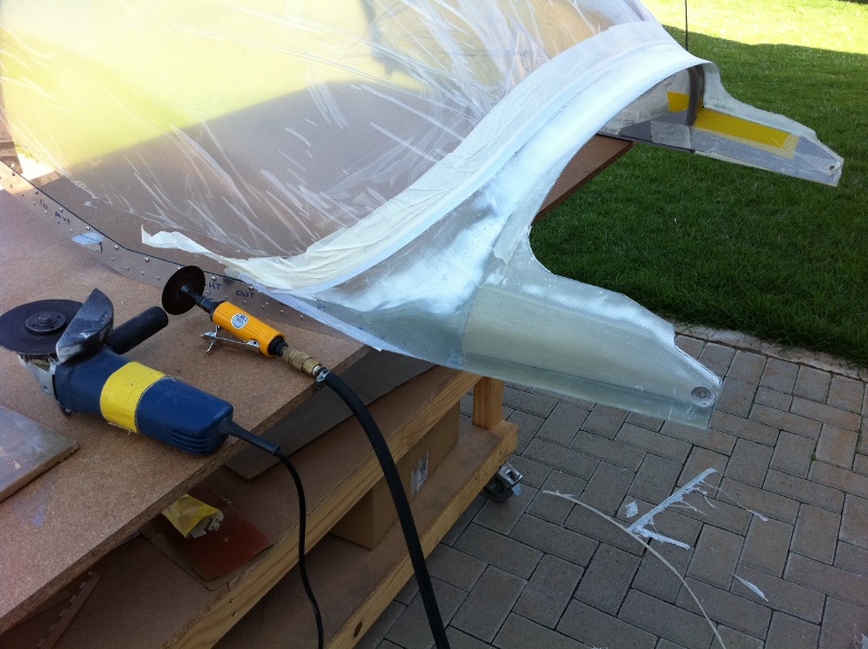

Me looking confused trying to figure out the canopy side skirts

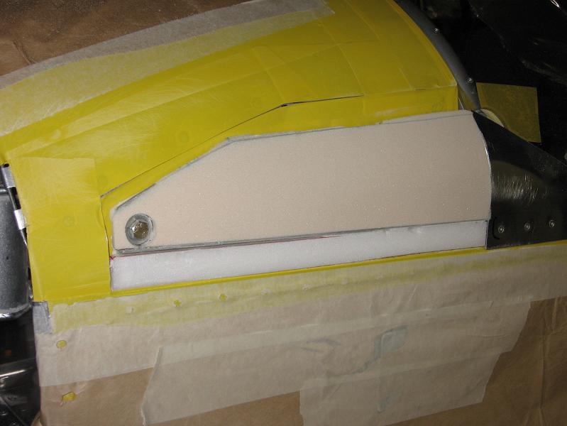

The foam side inserts glued into place
Fitted and sanded to shape on the canopy. Note additional foam inserts below, just to temporary to bridge the gas shock gap.

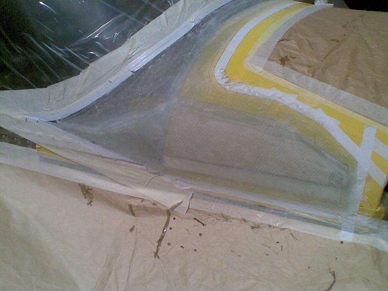

5 layers of fiber glass and some peel play
The result after adding all the glass layers
Me cleaning off all the dust (Sunny South Africa good weather were having)
Filling the low spots
Blending in the rounding to get a good transition between canopy and fuselage
Peter inspecting the work, he is just to happy the FG work is almost done
The canopy after it has been popped of the fuselage but before any trimming.

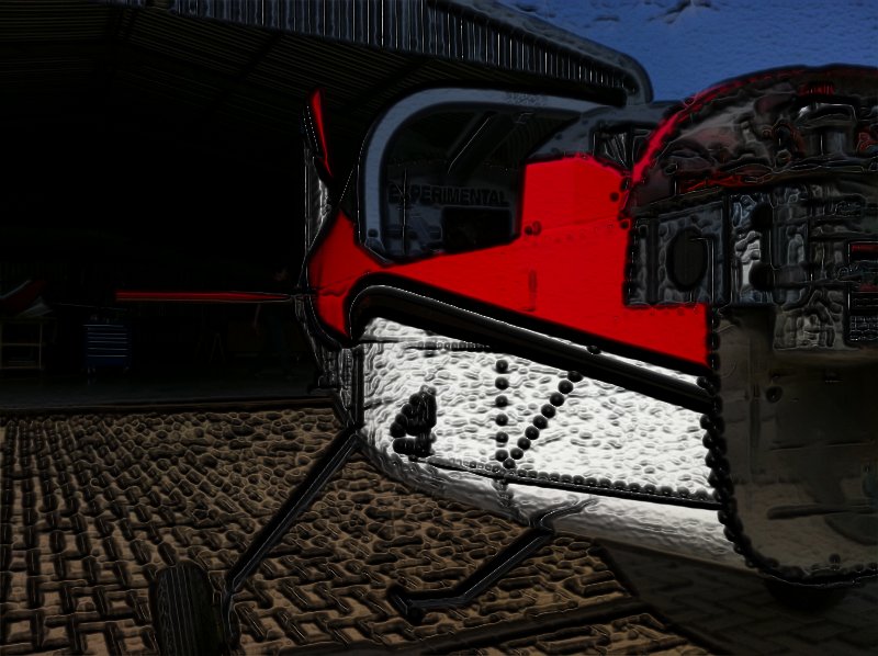

The cutting is done...lots of sanding and smoothing ensued!

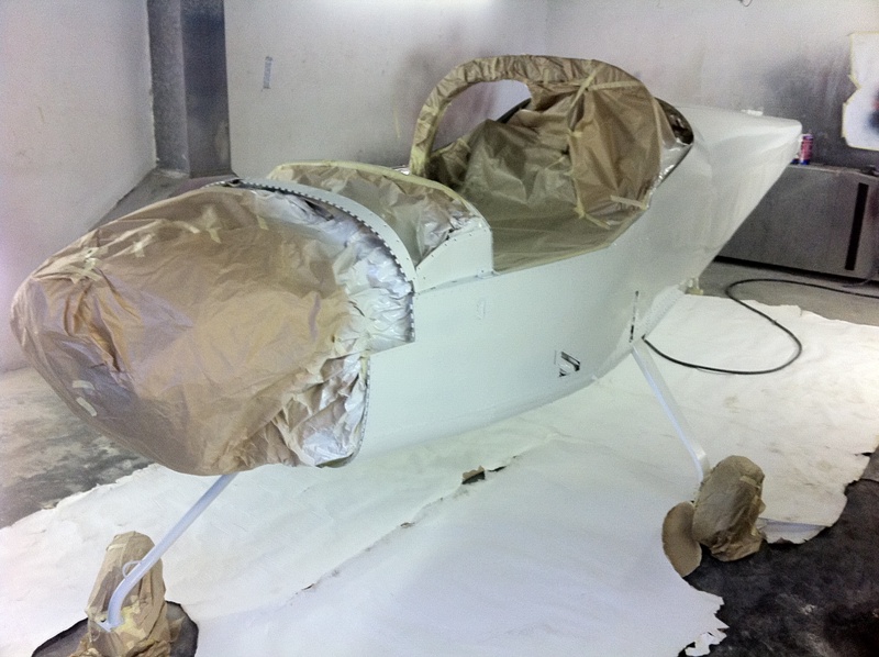

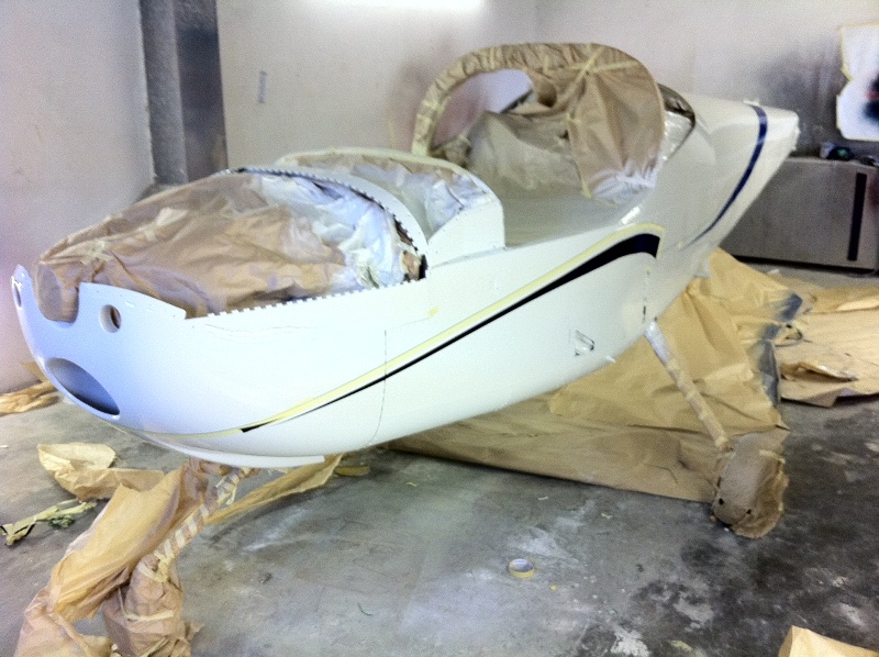

Then we packed the fuselage on a trailer ready to be sent to the painter today.
PS: we got our personalised registration number too
ZU-XII
ZU for South Africa and a Roman number - 12
Our group already fondly nick named her "Sexii" too :D
Great job!
This is great! I've been following your posts and am happy you're seeing good results. Before you know it you will have it in the air and everyone will be arguing over who gets to fly next.

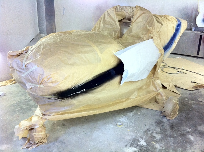

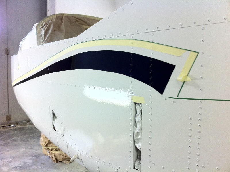

No comments yet...so here is Paint Teaser #2...
The fuselage is also been painted all white yesterday before we add her make-up

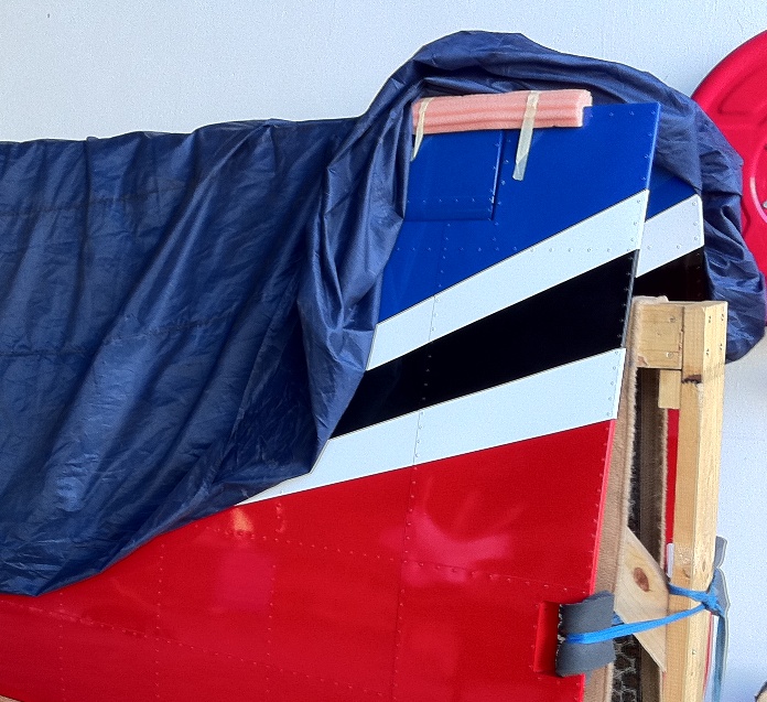

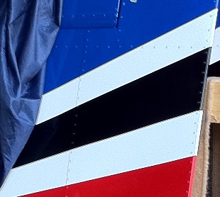

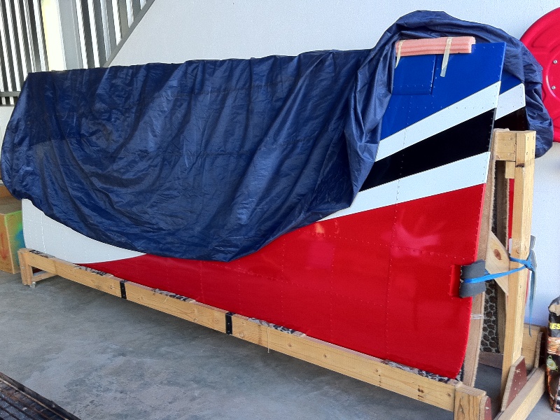

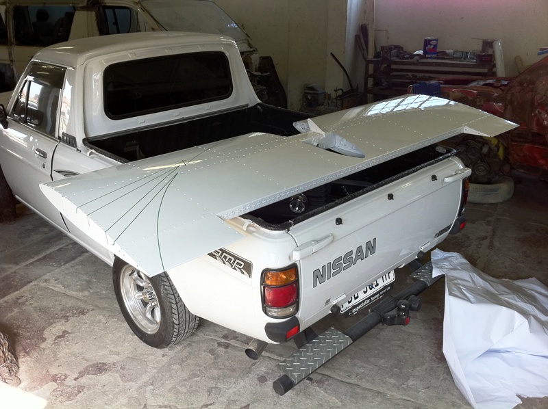

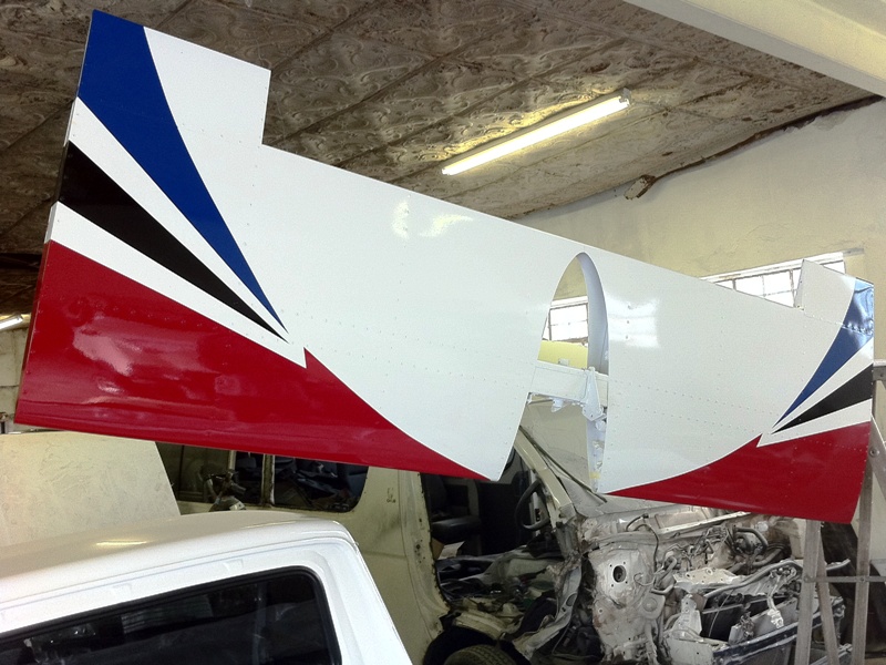

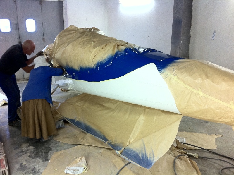

Today the weather played along so the painter made some progress on the fuselage. ZU-XII aka Sexii is getting her make-up done, here are some more teasers...
Then one more for today, tomorrow I'll post some more...
PS: Sorry! for more pics of the wings you'll have to wait for the weekend, since I dont have any more pics of them...SOON all will be revealed...us 10 guys are having so much fun now that is almost done, so indulge us! :D

This one is too funny and can't wait until tomorrow...
This Little 1400cc pick-up-van with a serious tail wing :D
Ha ha it was the perfect spot to mask out the paint lines for the H-stab but it looks funny now looking back at the pictures:p
Rudi
Good Morning,
I talked to the painter early this morning and he says we can come to collect Sexii later this afternoon, he should be done with the Fuselage :D we cant wait.
Anycase here is Friday's Teasers below...taken with my grobby cell phone in a dark spray booth just before dark last night.
Rudi
Nice paint job
That looks fantastic Rudi!
Who is painting it for you?
I am in the process of planning the paint job on my RV-8 and am looking for a reputable painter in Gauteng.

Glad to report that the engine started on first turn and she purrrrsss...
I leave it to Rudi to upload a pic or two.
1st flight very very soon!
:D
:D
Hi Gerrit,
I can do one better, follow the link for the first Engine Start Movie you took.
"Sexii" 's engine took instantly and purrs like a kitten.
The video also shows our entire airlplane paint design, with a 360degree walk around. Hope you guys like it...Watch up till the end to see our exitement!
Here is the link to the UNEDITED Video, it is HD so scale the Youtube video to the resolution you want best is 1080p and FULL SCREEN.
http://www.youtube.com/watch?v=AW2dN5dCJ6w
Here are some more pictures of the event Gerrit took,
Our Panel
The Big Vans Grin Ready for the start...Wow that is a big grin and we haven't even flown yet.
Concentrating hard wathcing the Temps and Pressures.
