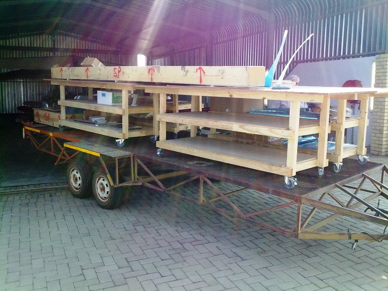

History: Day Zero 18 April 2010
RVators,
If you remember 10 South Africans are going to put a RV12 together and then learn to fly on it (Yes we can do it in South Africa). 9 members do not hold pilot licenses and will use our creation to do their initial training on. It is a dream come true in an affordable way for them to build and earn their wings...

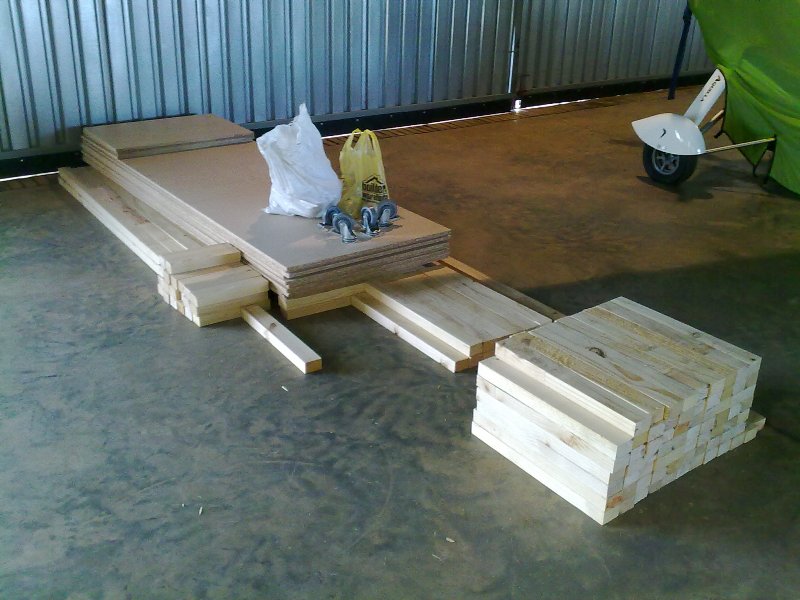

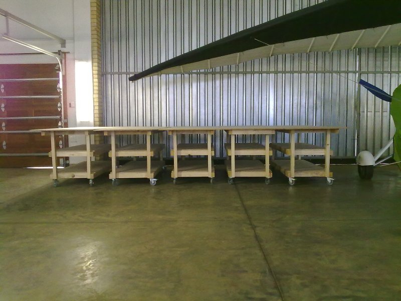

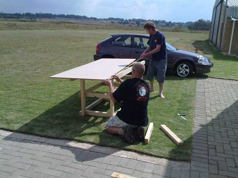

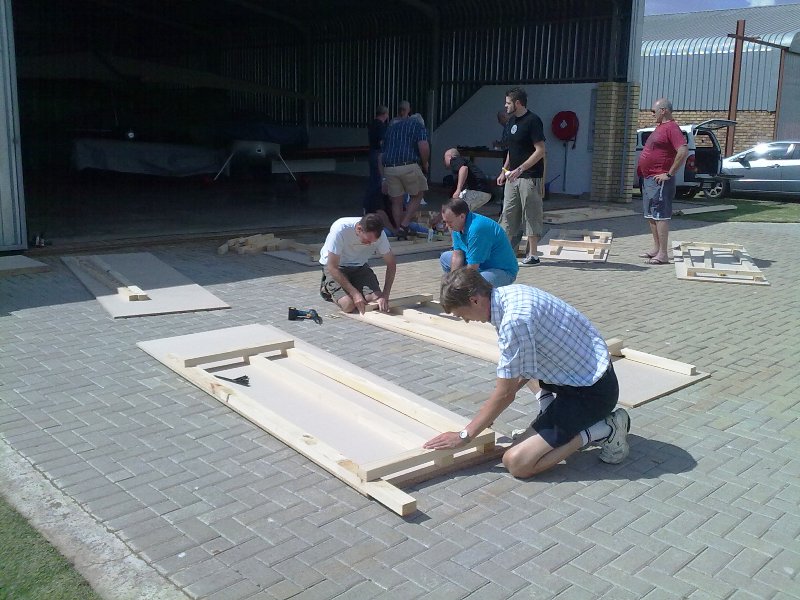

Our RV12 Enthusiast build group had our first Build Sunday. We called this Build Sunday ZERO since we did not do anything on the airplane, (We are still waiting its delivery) but we did complete some preparation work. This Sunday we had an Aircraft Build Theory presentation in the morning. We had 4 guests (non build group members) that attended and interested in aircraft building. In the afternoon we completed 5 Work Tables, 1 for each pair of members, because multiple sections will get build at the same time, we need a lot of tables.
It was a great experience and everyone worked hard, we completed all 5 tables in only 3 hours! With all the boring stuff out the way, we can?t wait for our kit to arrive somewhere in middle May?Sign of good things to come.

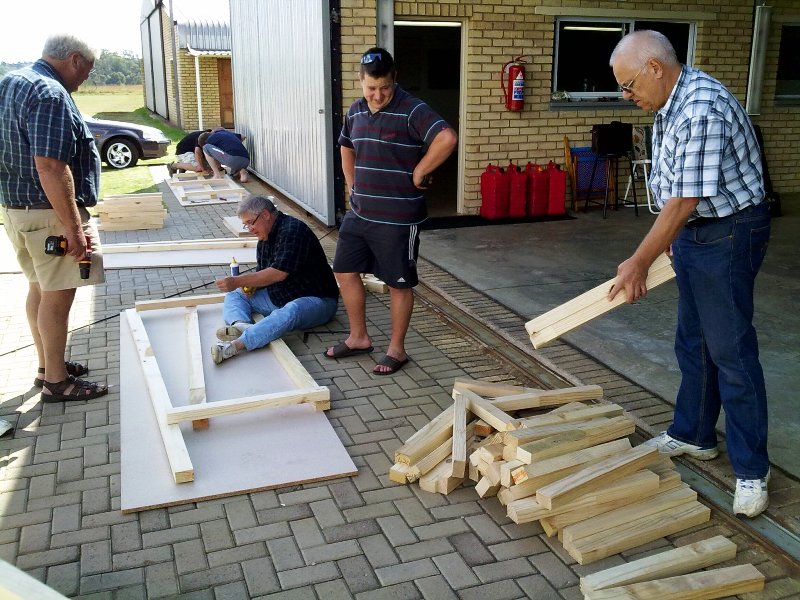

The pile of wood precut to size

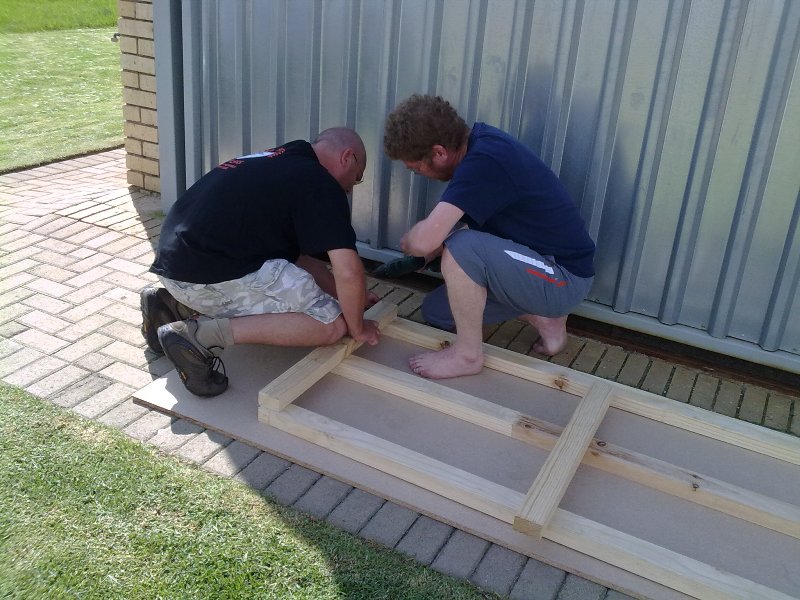

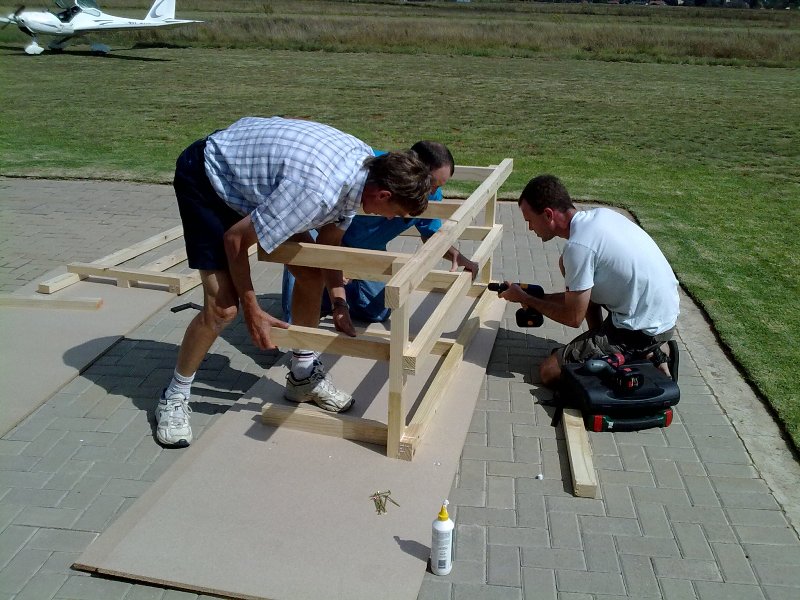

Starting with the sides in front of the hangar on a nice sunny day, working on the underside of the table top for a nice flat surface.
Some of the onlookers coming to investigate what we were doing, looking at the pile of wood were skeptic.

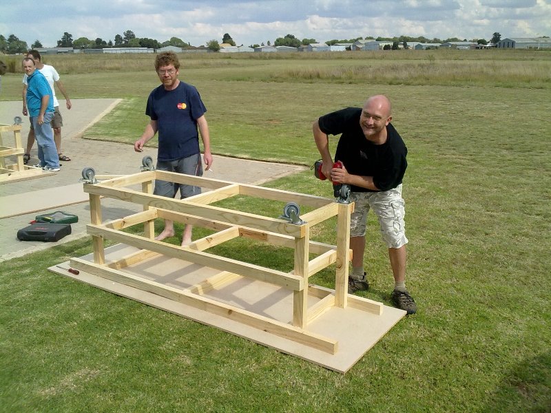

Get comfortable, bare feet and all

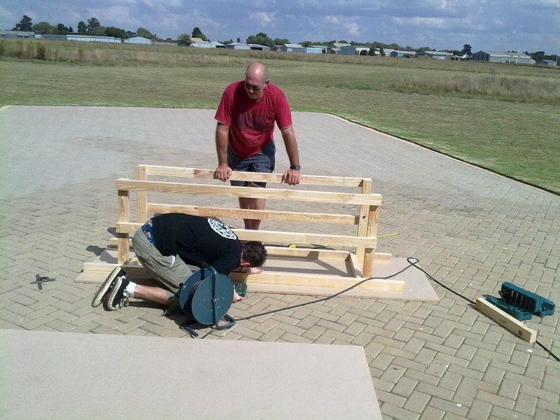

Sides are done now for some cross bracing

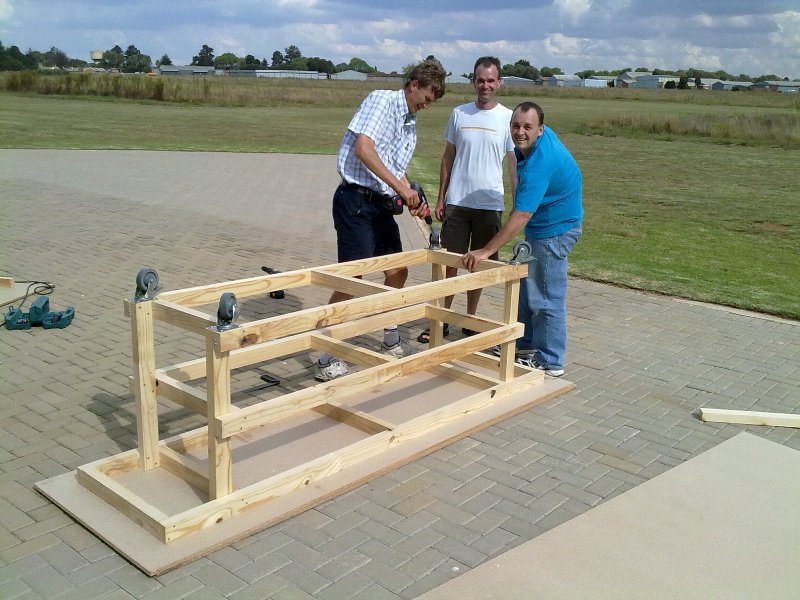

The structure coming along nicely, on your knees to get it done.
Ready to fit the table top
Fitting the castor wheels.
Getting comfortable!
...<SNIP>
History: Day Zero Continue
<CONTINUE>...

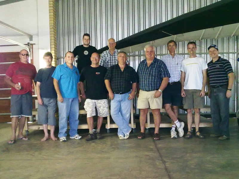

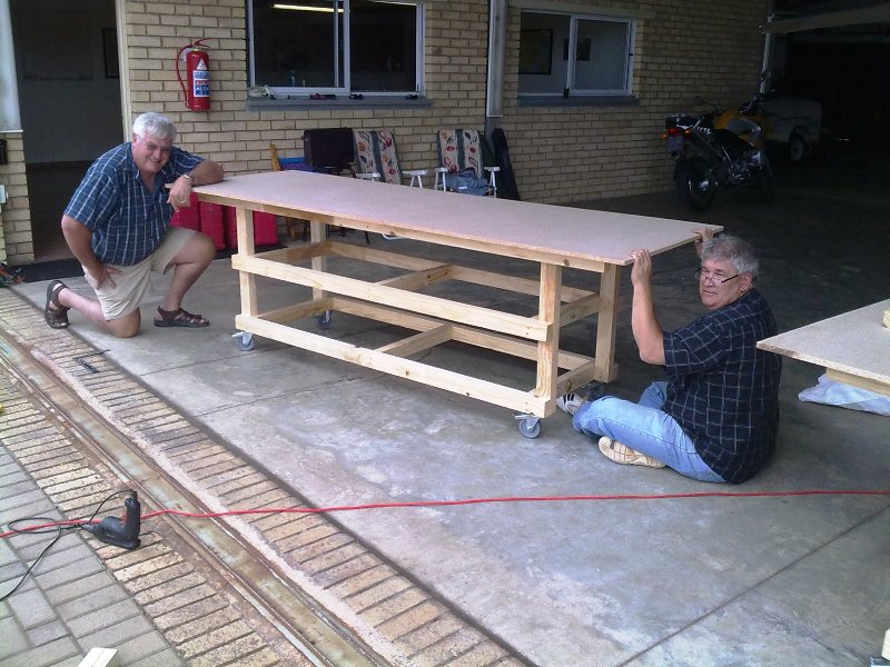

All 5 tables done!
The first group photo, me on the far right.
Now we just have to wait until the first kit arrives, somewhere in May, till then...

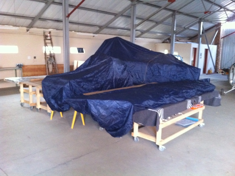

History: Day 1 : 5 July 2010
RVators,
We had our first build Sunday, none of these gents built an airplane before. We started at 8AM and by 4:30PM they had lots of hands on first experiences and had an Airworthy Vertical Stab to show for it.
The SA RV12 Build Team
Next Build Sunday is in 2 weeks time.
Rudi

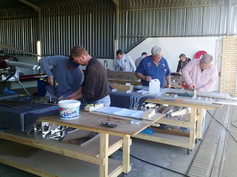

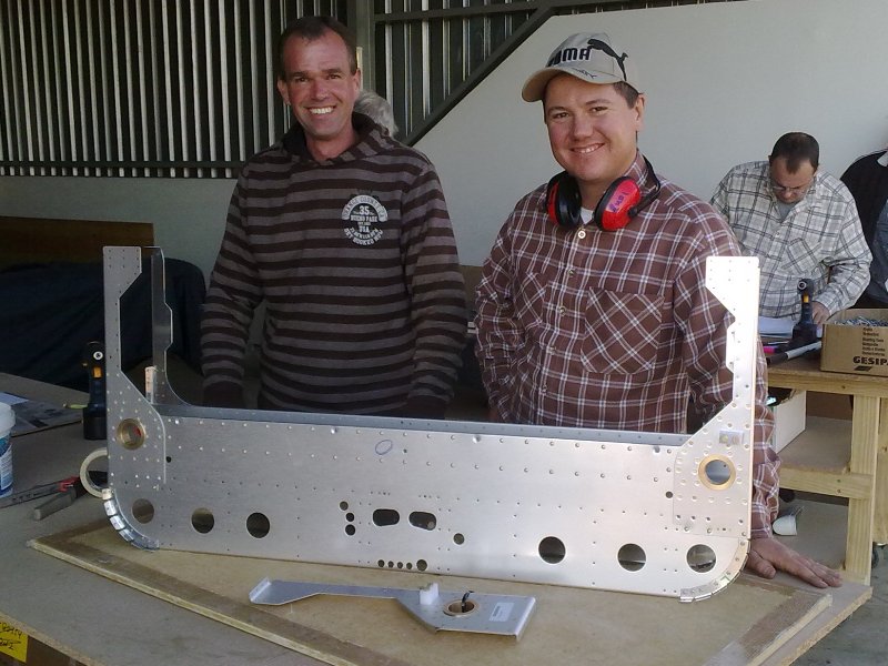

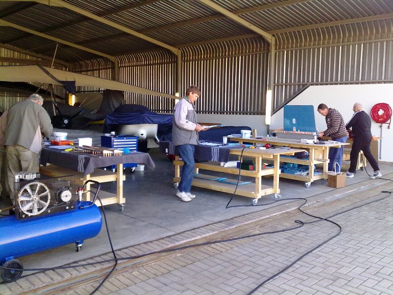

History: Build Day 2: 16 July 2010

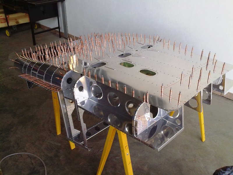

BUILD SUNDAY #2
We had 4 of the 5 teams present. This is the first time the team had to work on their own parts, with me assisting when they run into ???
End of day Result:
100% completed Rudder
100% completed Center Section

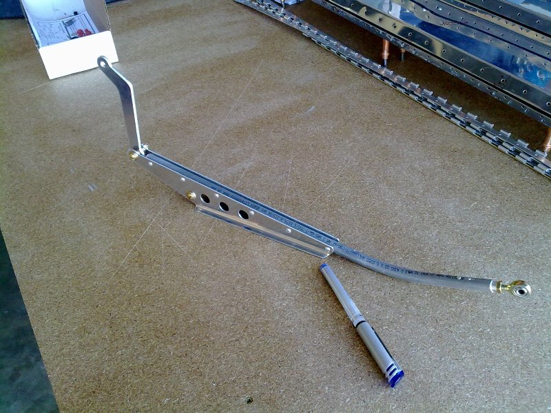

100% completed Servo push rod
33% completed Trim Tabs
33% completed Tailcone
On to the pictures...

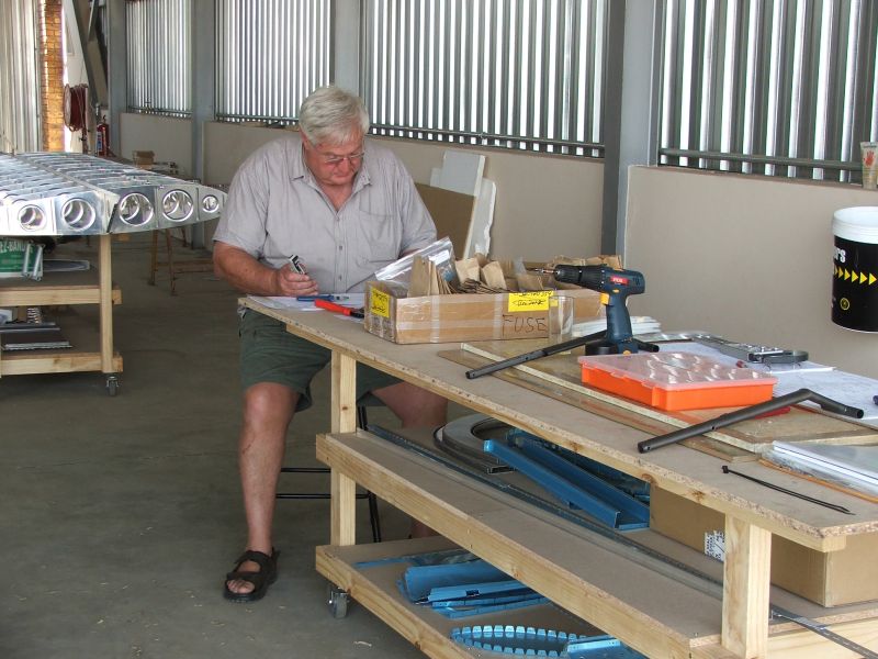

Wouter and Leon busy with the Rudder

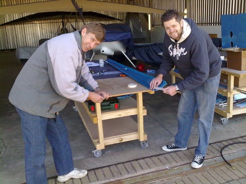

Jan and Justin busy with the Tailcone skins
Julius and Martin busy with trim tabs and trim servo

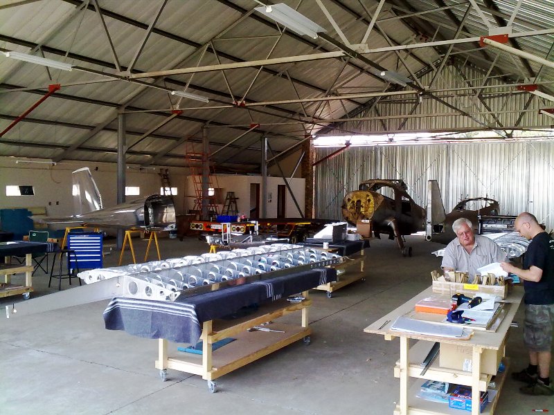

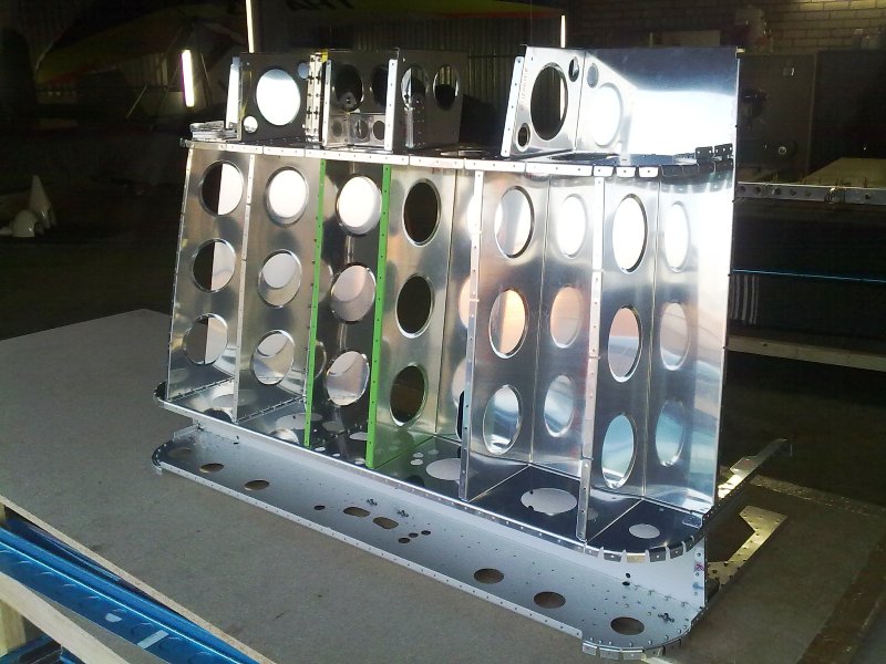

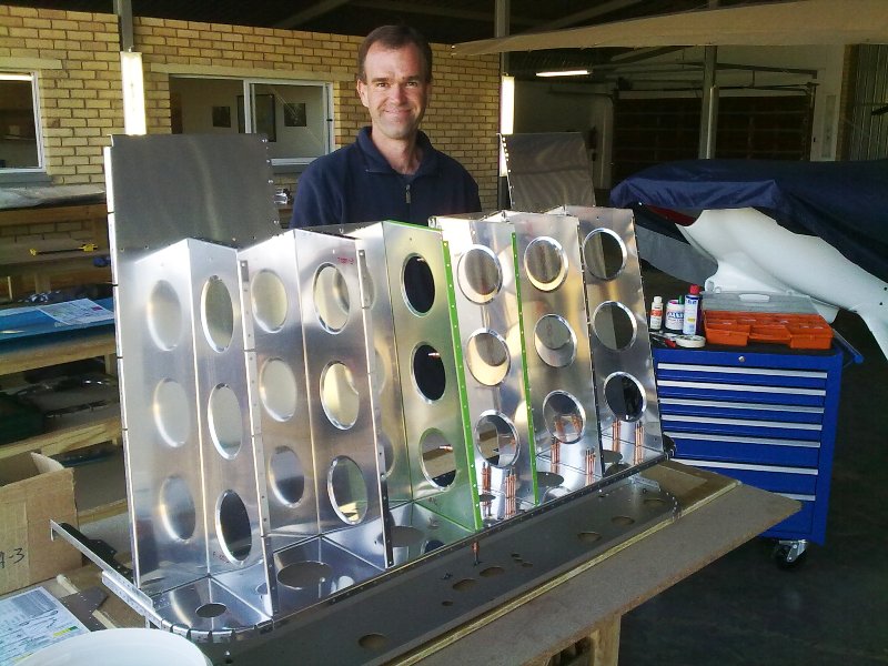

Peter and "I behind the camera" busy with the center section, the hart of the fuselage and wings
A hive of activity, each team busy at their own table

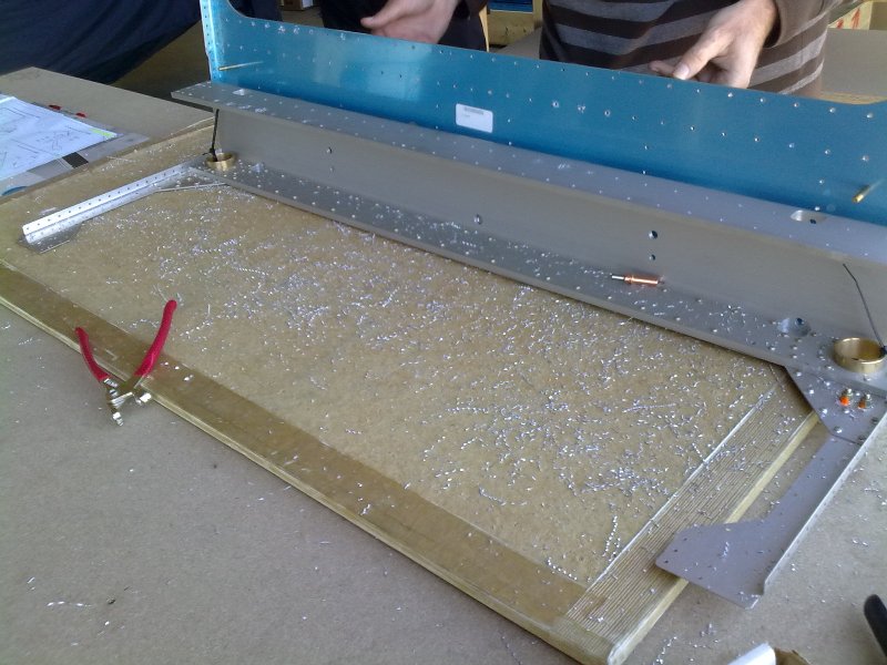

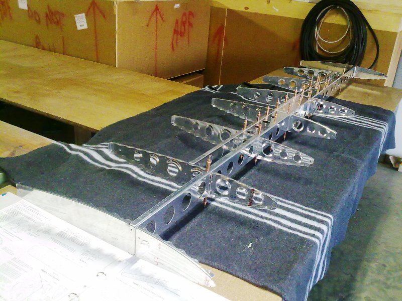

The center section took lots of drilling and countersinking into that thick piece of aluminium, check all the shavings.
The Rudder Complete
Trim Servo Push rod complete, these gents look like they enjoy it.
Close up
The center section complete
Next build day is Sunday in 2 weeks, till then...Regards Rudi

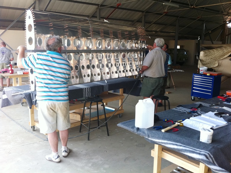

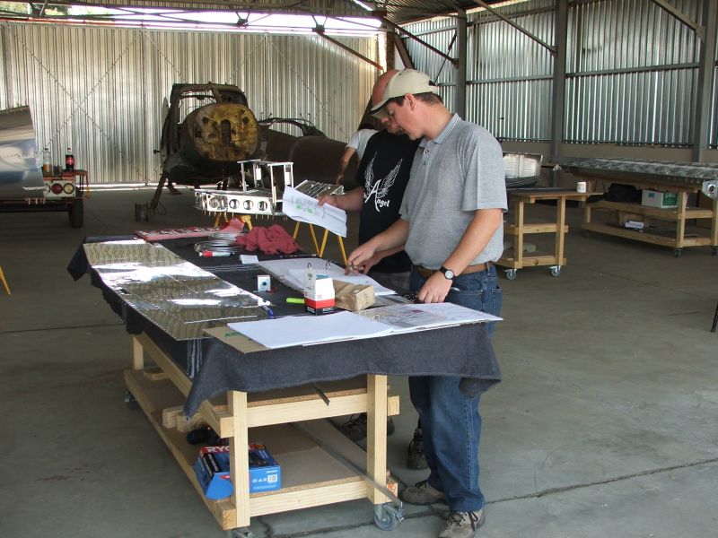

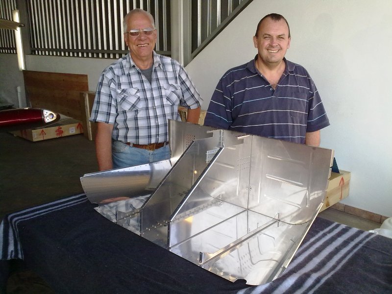

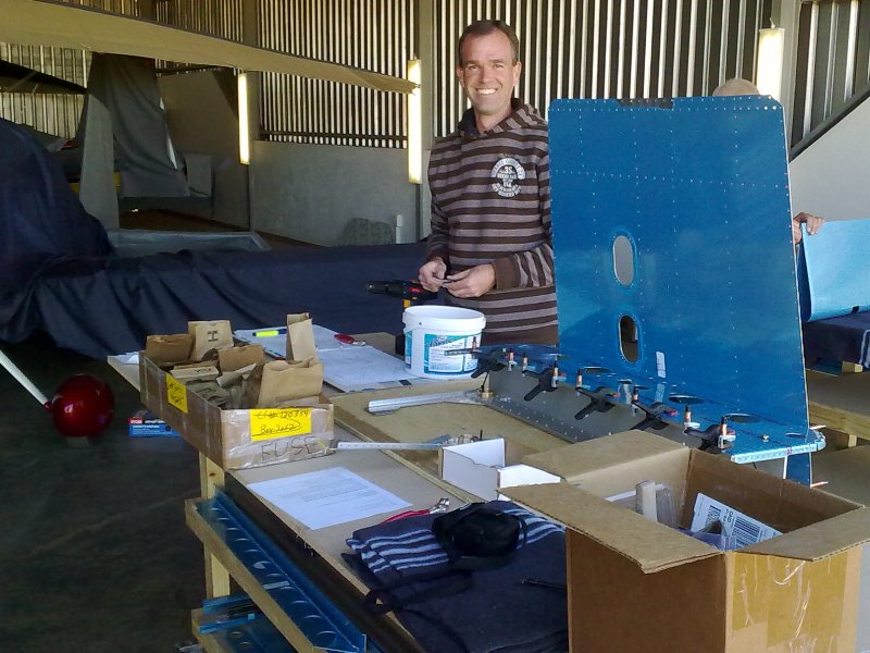

Build Day 3: 1 Aug 2010
Build Sunday 3:
All 5 teams were present.
End of day Result:
66% completed H-Stabilator
66% completed Tailcone
100% completed baggage floor area and baggage ribs

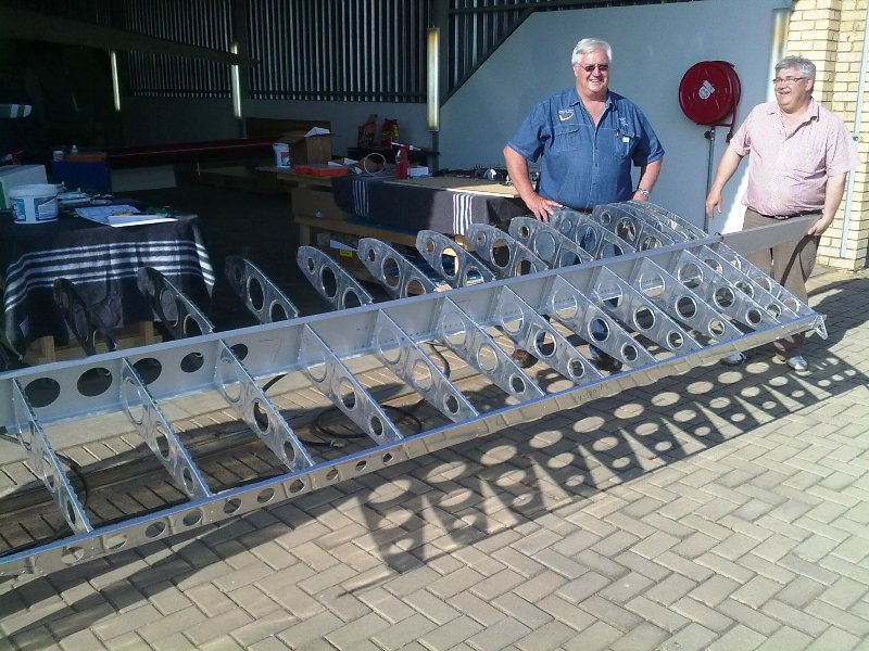

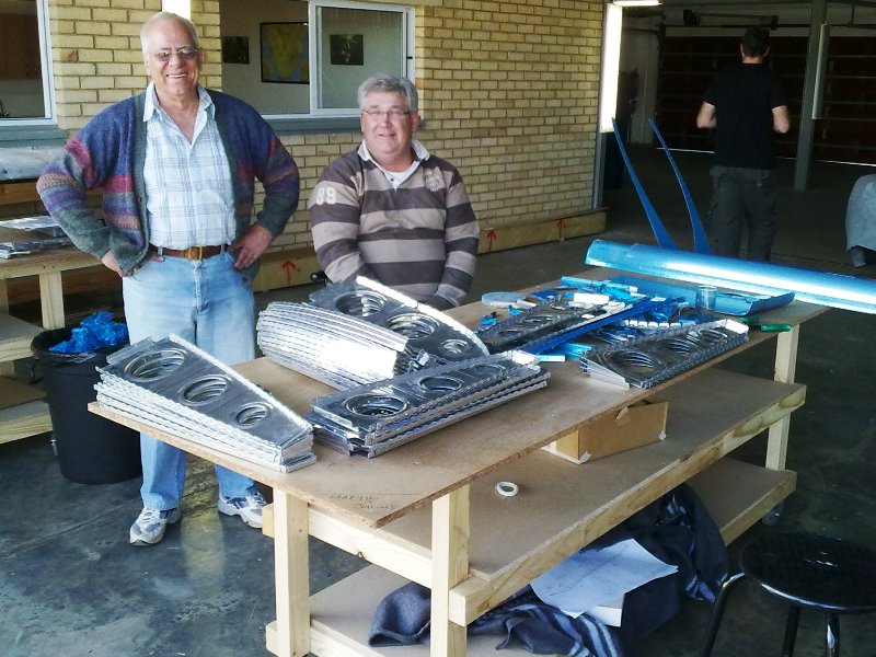

100% completed deburring ALL the wing ribs
50% completed seat floor pans

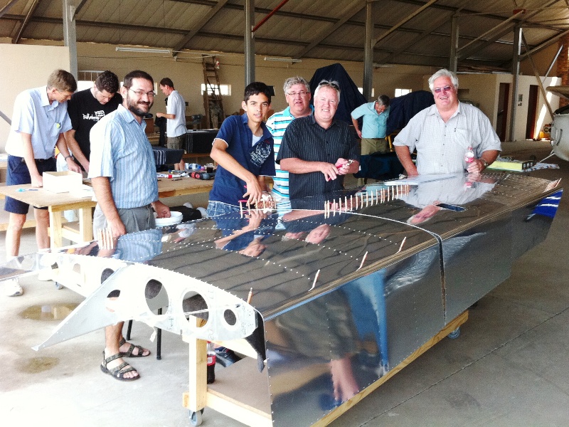

Wouter and Leon busy with the H-Stabilator, you are seeing the main spar box for it.
Peter and I busy with the baggage floor and ribs that attaches to the center section we finished last time.
Jan and Justin busy with the rear tailcone bulkhead where the stabilator hinges. An intricate and strong piece of work.

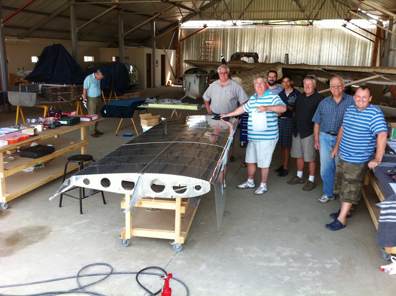

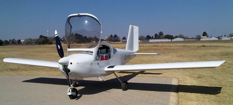

Then we had a "surprise" visit from the only flying RV12 in South Africa. THANX ALAN!
Jan and Justin & Father inlaw starting assembling the tailcone. Gerrit and Alan in the background busy with floor seats pans

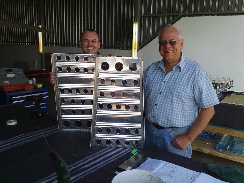

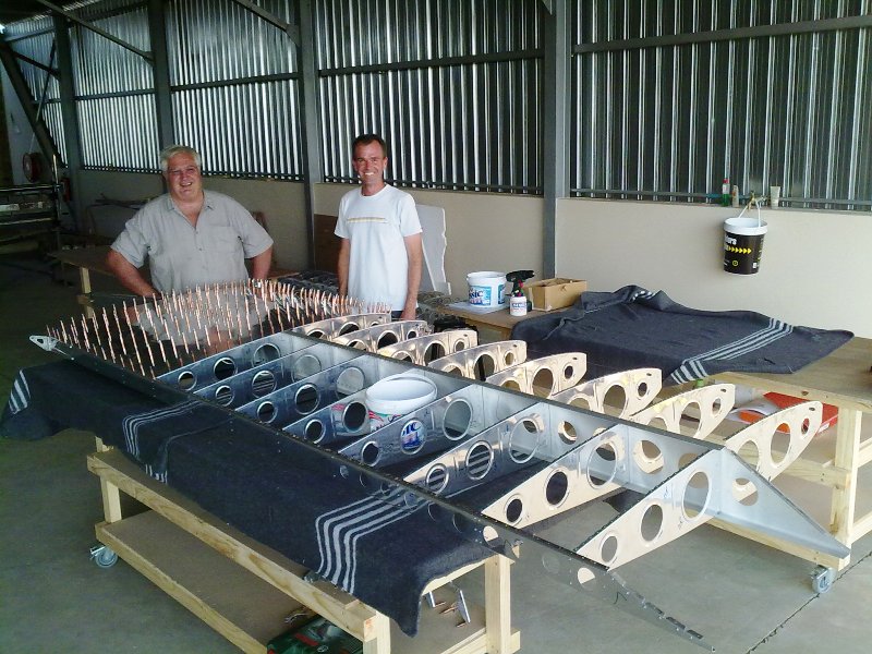

Leon overlooking all the wing ribs that Martin and Julius deburred the whole day long :twisted: I think they had enough of deburring :lol:
End of day Peter and I finished the baggage floor area

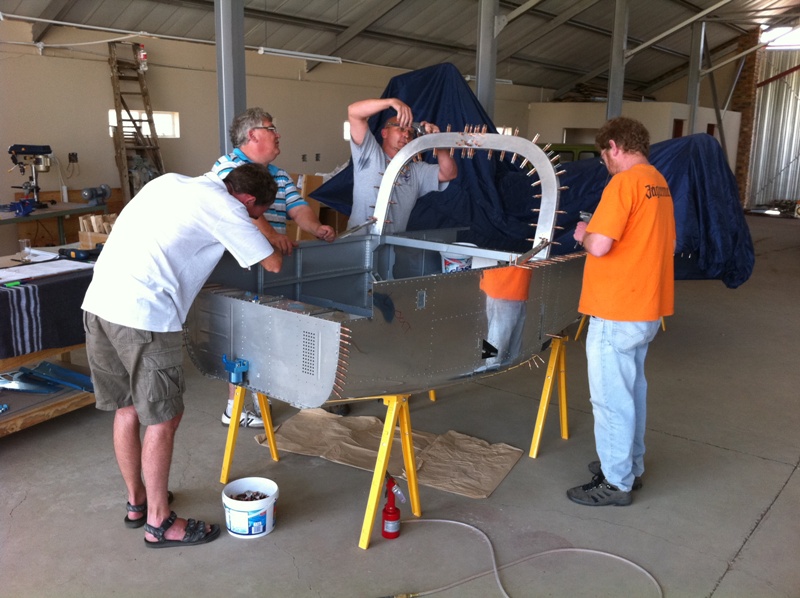

End of day Leon and Wouter finished the H-Stab Skeleton, well almost we have 2 bad parts
End of day the tailcone being skinned

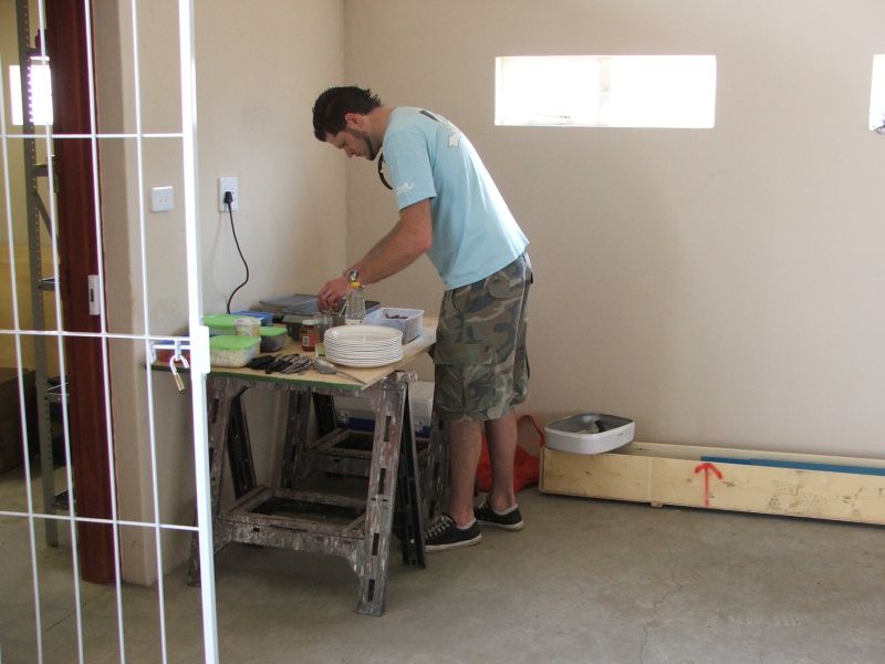

Official build day is big affair, we appoint a Chef for the day, everyone gets a turn, and they try and impress us with their culinary capabilities during lunch. :D

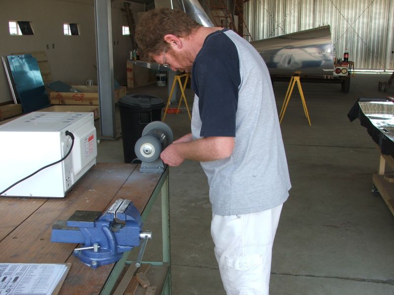

It's a lot of fun. It sounds like a factory too with 2 bench grinders, a pencil grinder and a drill going singing sounds together. :D much more sociable than building alone.

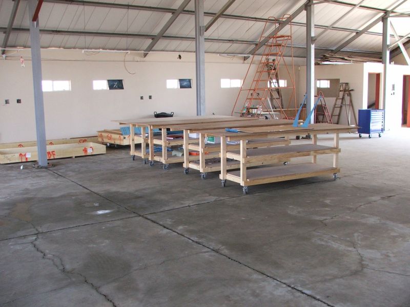

Tables
Rudi,
Do you have the drawings for the tables ya'll built? I am getting my shop ready for my -12. Used jigs on my -6 so I need to build some.
Thanks in Advance.

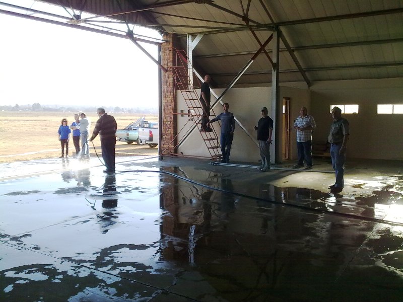

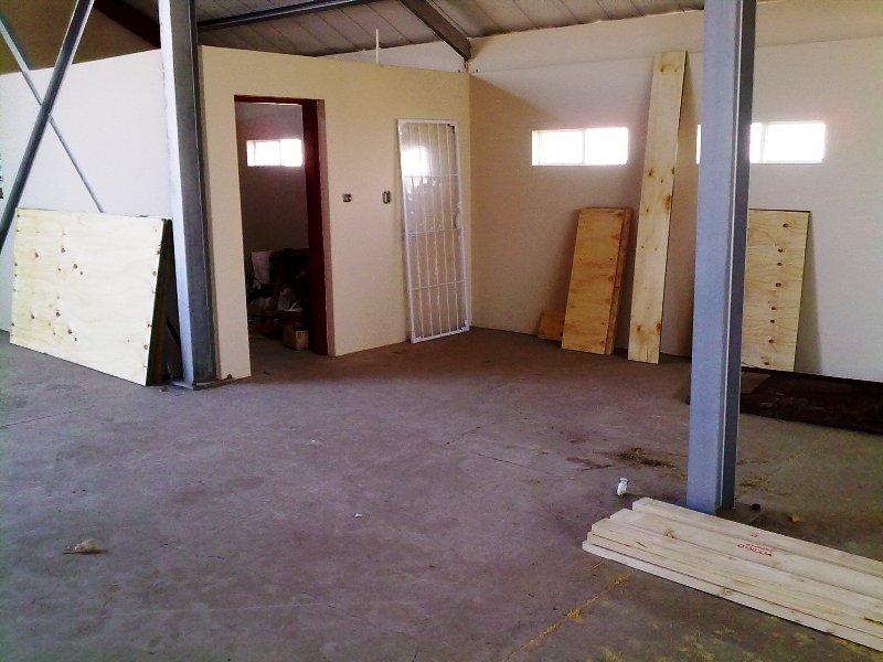

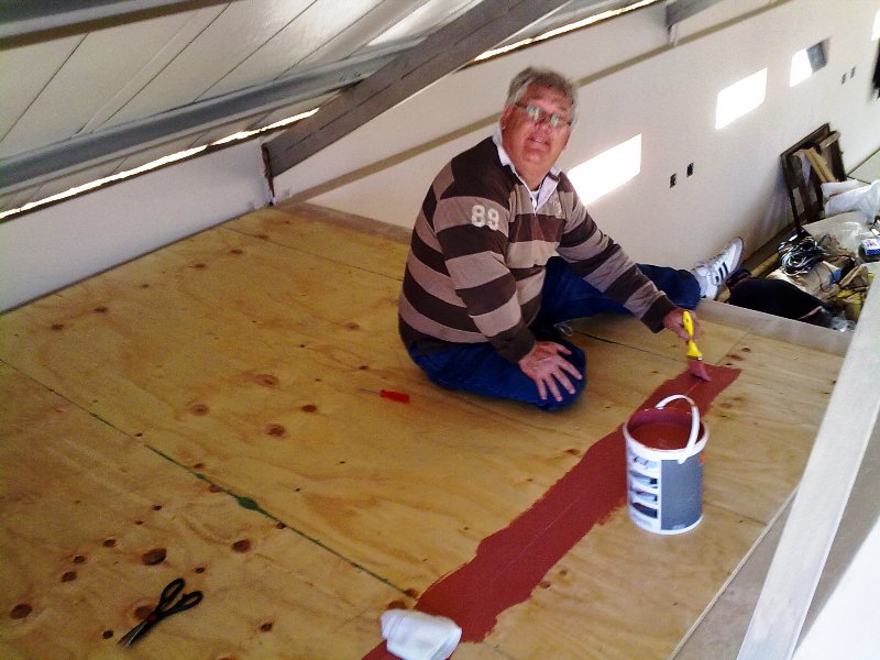

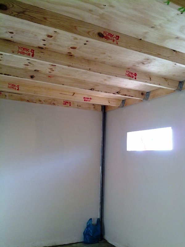

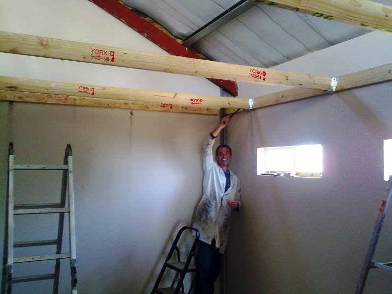

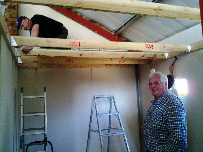

Helping build a hangar and future build home

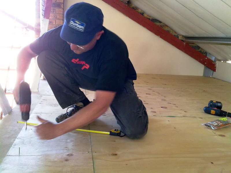

This Saturday we assisted a couple of guys with their hangar that will make the home for EAA 575, and where we want to move to soon to complete our RV12 build Project.
Our tasks for the day is put a strong roof on the store room, strong enough to support it for a storage area on top

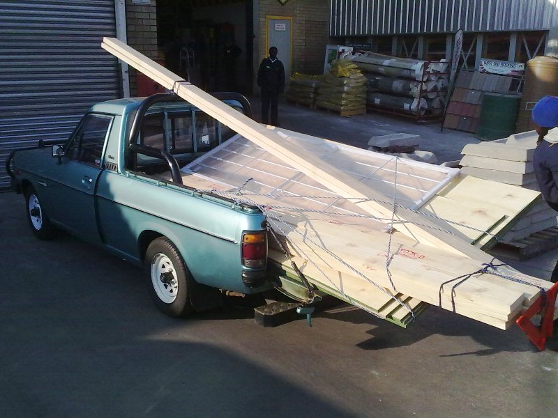

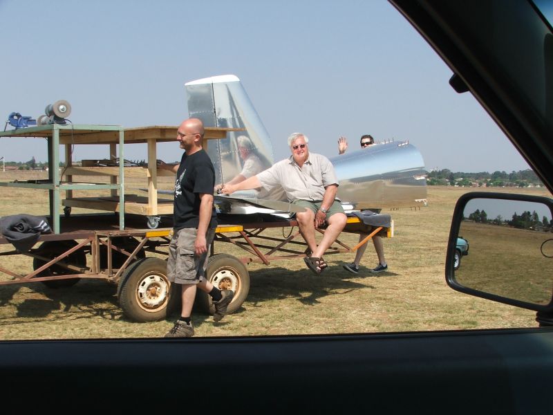

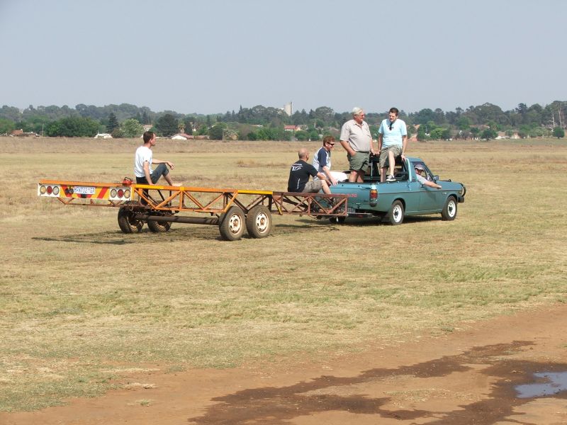

Raw Materials loaded on my 1400cc work horse. This little pick-up has transported many Airplane kits before...
Delivered in front of the said store room
Wall plates and alternate cross beams going up, Peter looking handy with a Hammer!
Julius just after handing the top plywood ceiling with brute might to Gerrit on top screwing it down. Peter finishing up the interim beams that matches where the plywood top seam and joint is.

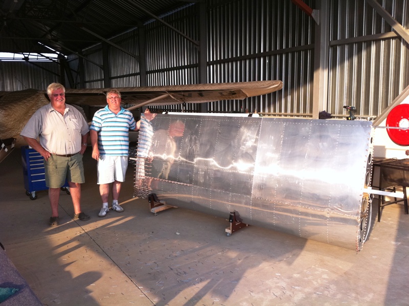

Gerrit continuing screwing down the plywood ceiling
Martin sealing the joints to keep the dust out the store room
The final product the roof installed and sturdy for almost any load on top to increase storage space.
We ended the day with a BIG CLEANING session, we washed the hangar out to try and get rid of about a years worth of building dust that accumulated during the construction of it.
It is almost ready for occupation, just need the power connected and alarm and armed response installed...soon very soon we will move.
Kind Regards
Rudi

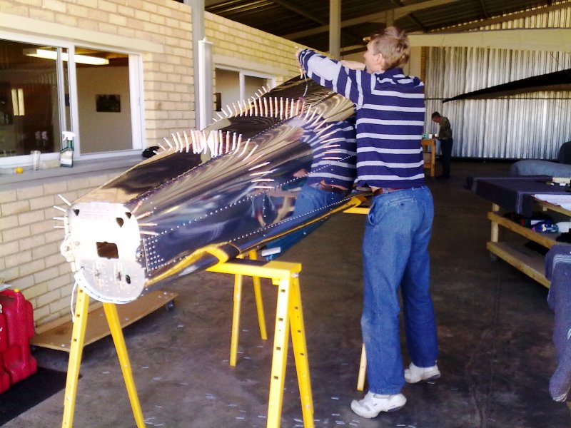

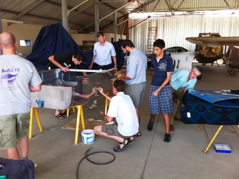

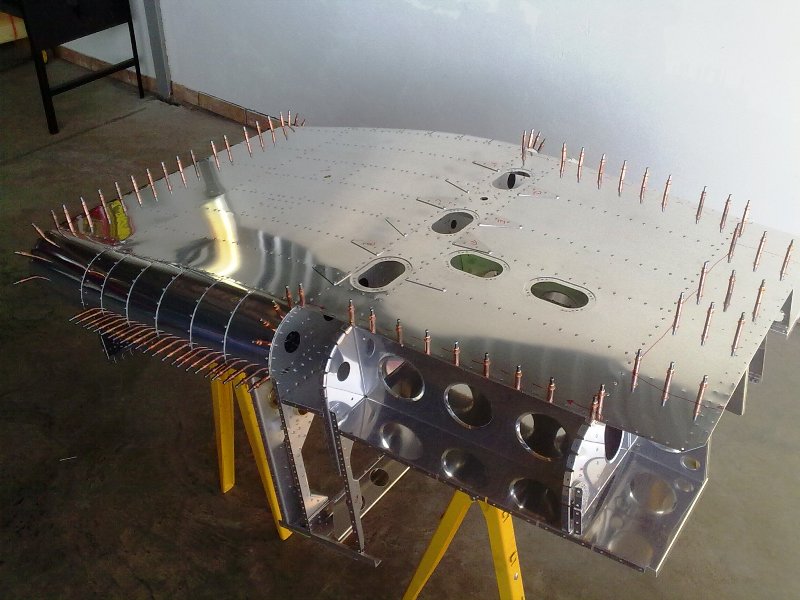

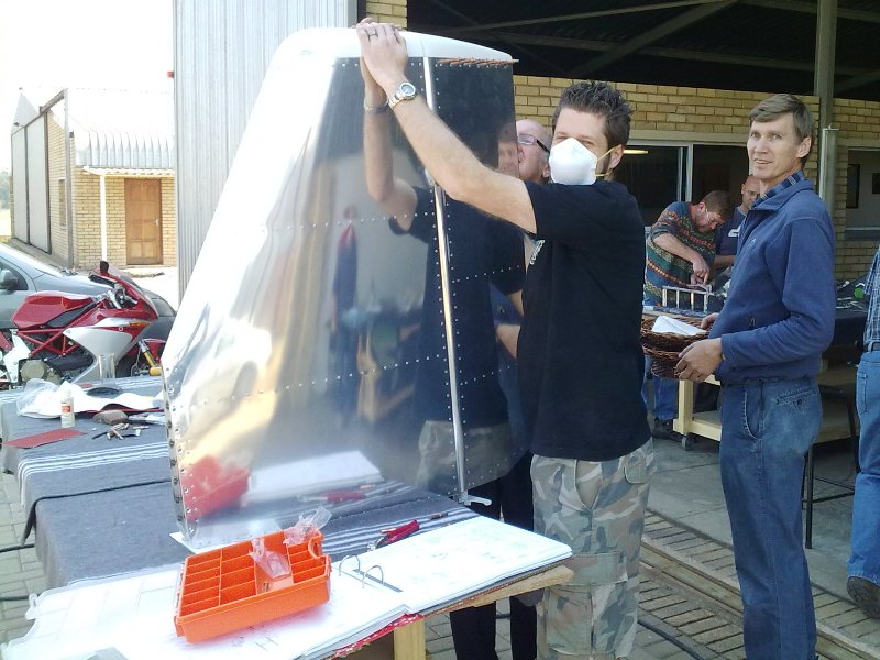

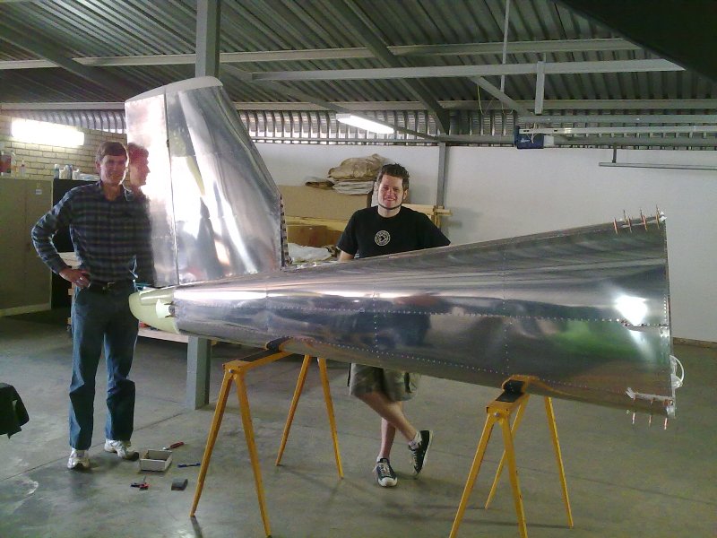

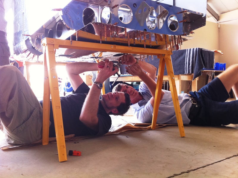

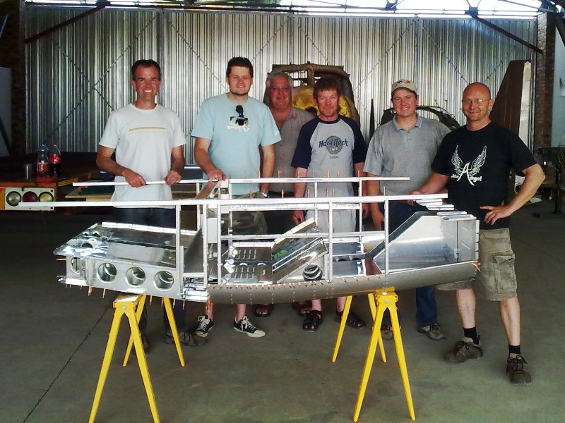

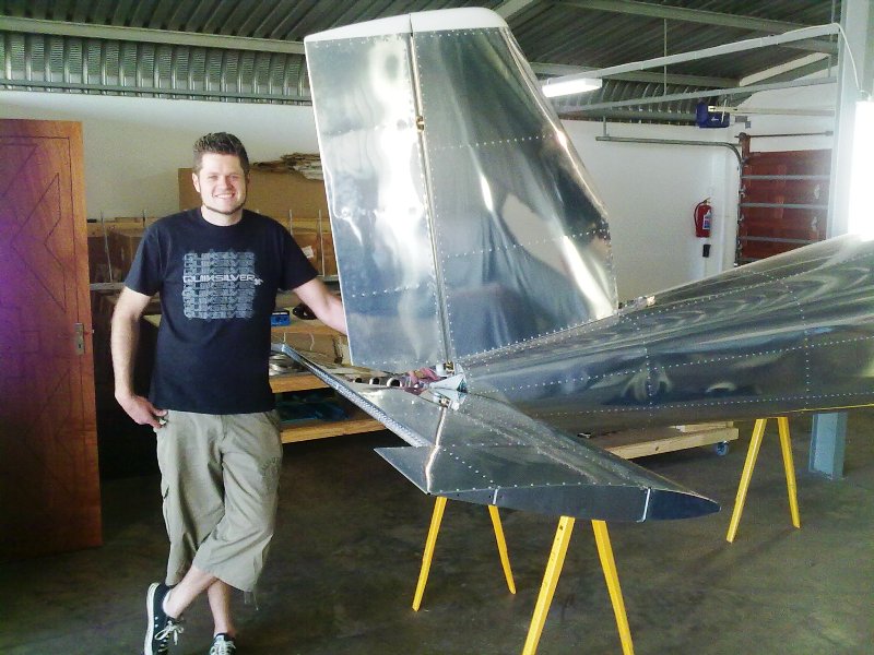

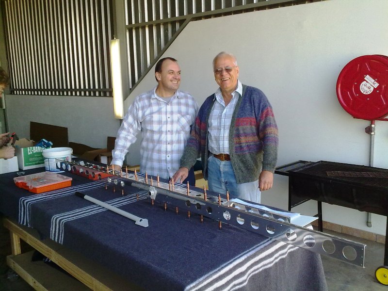

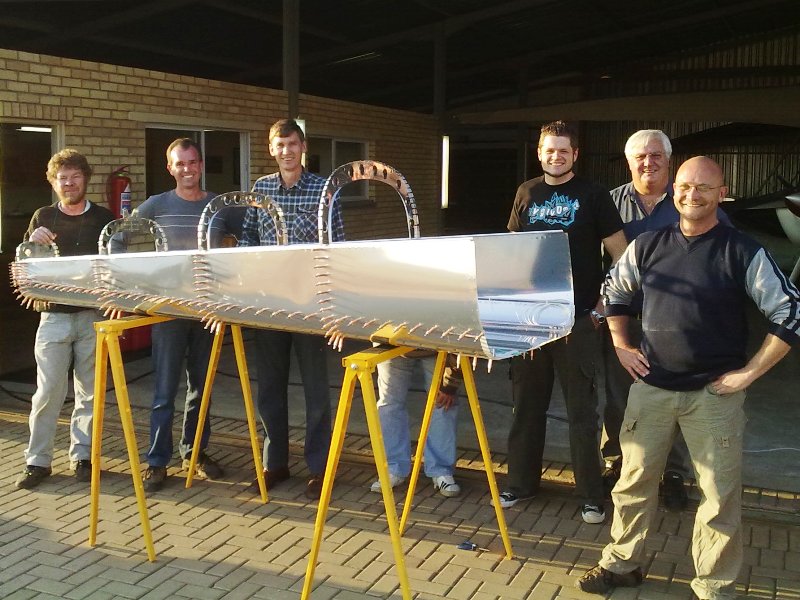

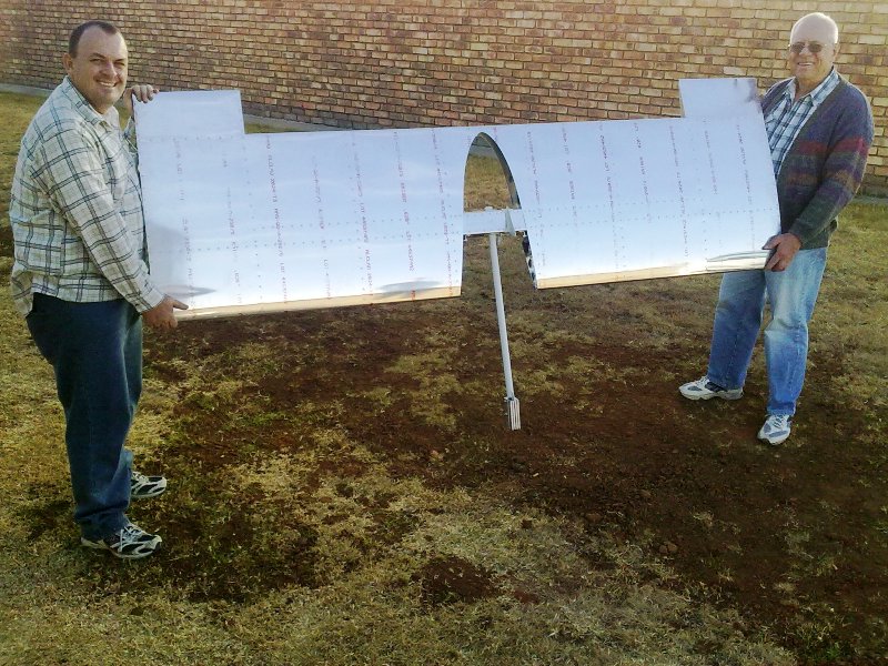

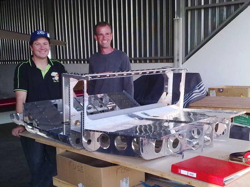

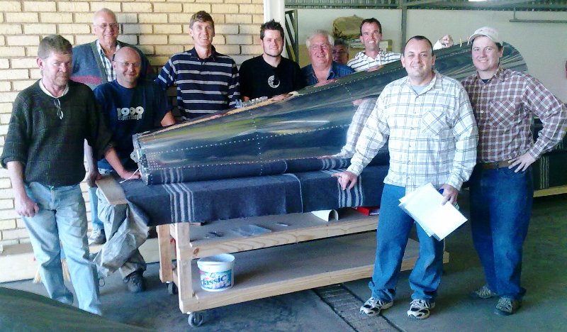

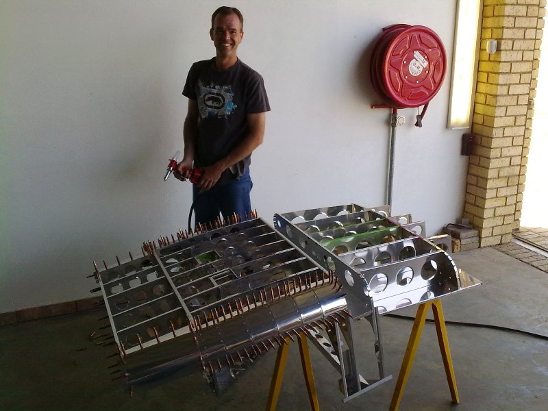

Build Sunday #4
Build Sunday 4:
End of day Result:
100% completed H-Stabilator
100% completed Tailcone
100% completed Wing Spar Assembly
100% completed Trim tabs
90% completed seat floor pans

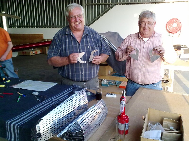

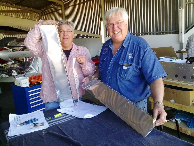

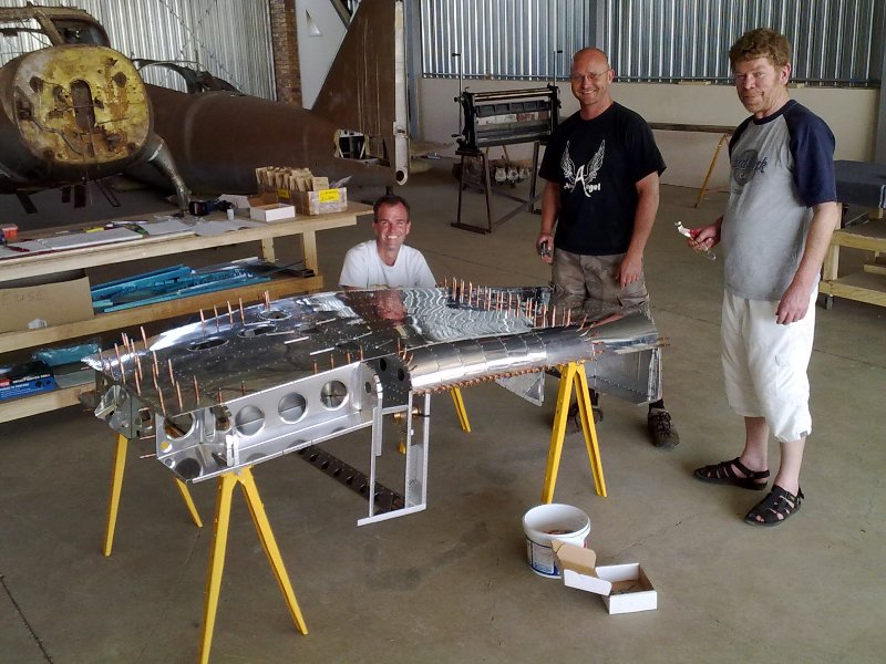

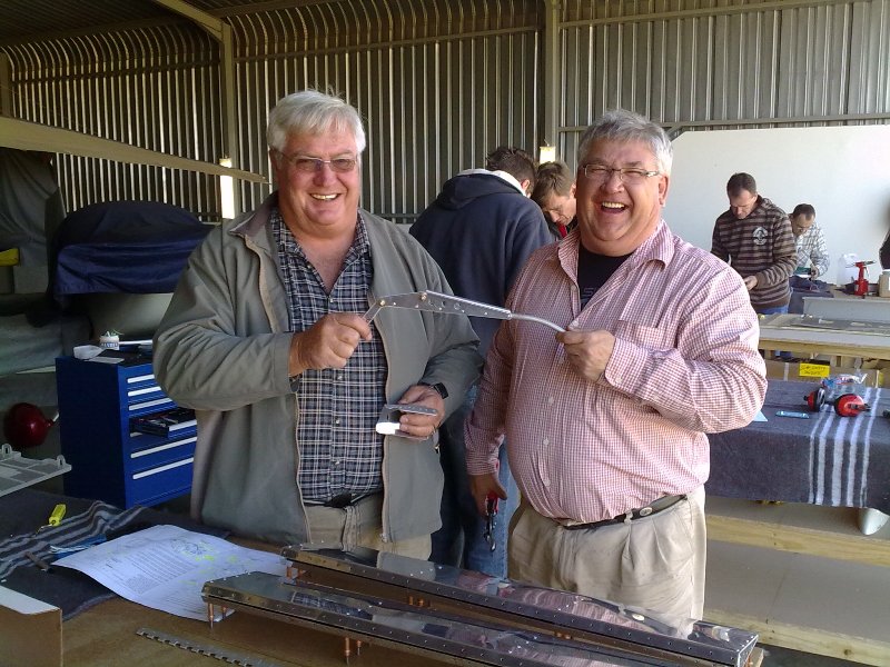

Julius and Martin finaly completed the trim tabs, after they got their replacement parts!

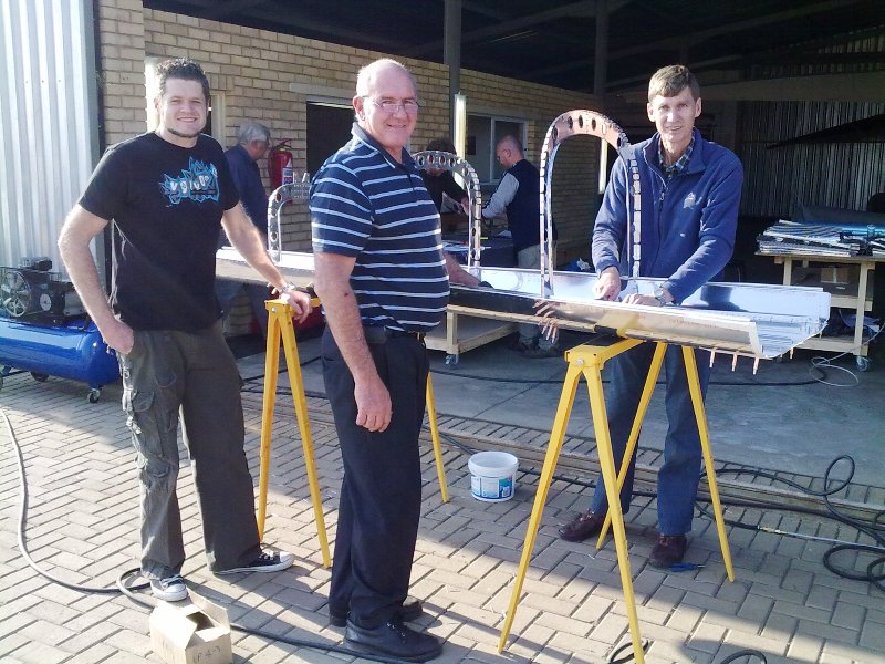

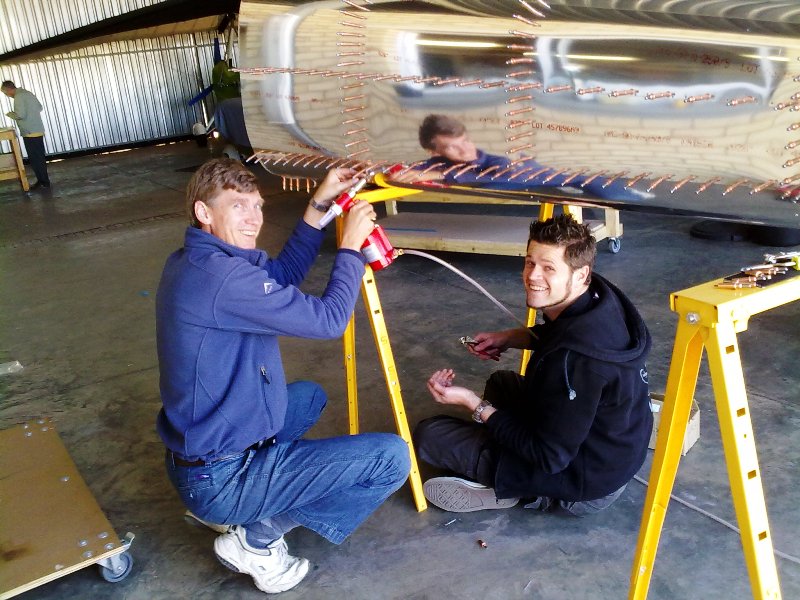

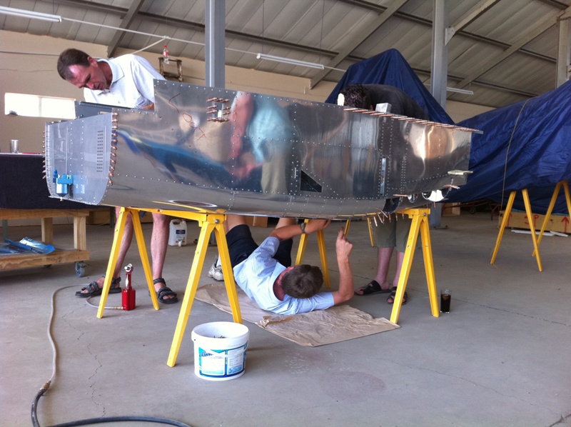

Justin and Jan riveting up the tailcone
Leon and Wouter riveting up the H-Stab skin
A hive of activity...

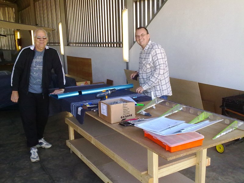

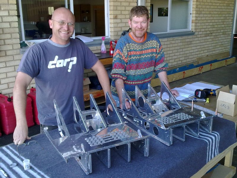

1st Table in front: Gerrit and Alan busy with the seat assemblies
2nd Table: Julius and Martin with the wing spar assemblies
3rd Table: Peter and I busy with the fuse center section
Last Table: Wouter busy with the H-stab and Hentie(visitor for the day) looking on.

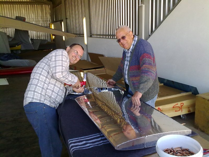

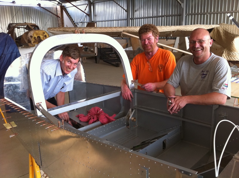

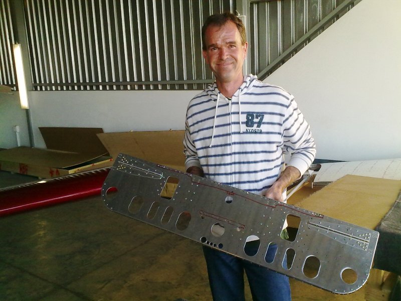

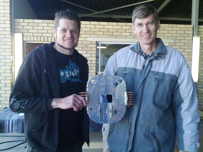

Peter with a fuselage bulkhead that will attach to the front centersection...lots of nutplates and solid rivets in this piece

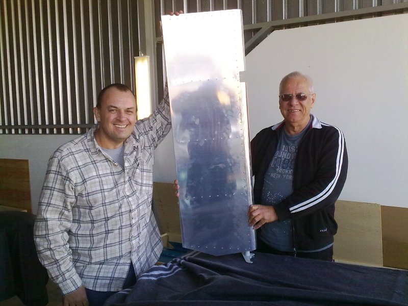

Wouter and Leon with their completed H-Stab and counter balance weight installed
Jan closing up the tailcone

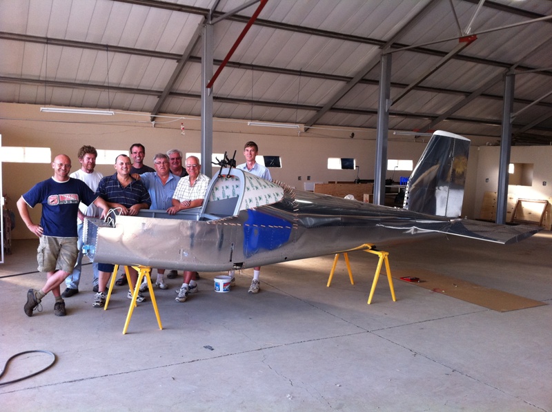

Jan and Justin completed the tailcone, we stole some of their glory and posed in front of their masterpiece for the closing group photo of the Sunday #4

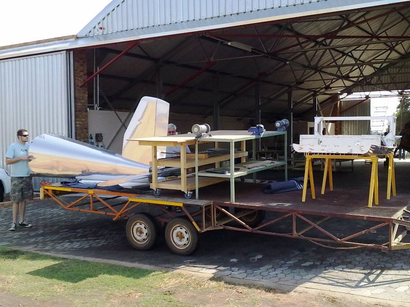

Unfortenately yes, problem of living in 3rd world country with high employment rate, alarm is linked to response unit who is armed to scare would be criminals away, standard practise here if you want your goods insured by insurance company. Would be criminals are usually after tools and accessories they can sell easily on black market. Unfortunately they have figured out hangars are an easy target at night when no-one is around. :mad: But this is not what this thread is about, so let us not dwell on the negatives NUFF SAID...:D
We hope soon to move to EAA hangar for more convenient building space, as soon as they have the necesaties in place :)

Jan and Justin fitting the tip fairings and hinging the rudder
Gerrit and Alan finished the seat floor assemblies and then moved on to the longerons.
Leon and Wouter almost done with the forward lower fuselage
Myself and Peter extending the center section forward.

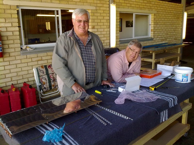

Julius and Martin with their pile of wing ribs and their flaperon hinges
Justin and Jan fitting the rudder and Vstab to tailcone and fitting the tailcone fairing

Peter and I started to rivet the middle fuse lower side skins
Then the bottom skin...
...all done
Wouter and Leon finished their forward fuse, here is the seat backs, and then they started on the rudder peddals
Julius and Martin finished one wing skeleton
Justin and Jan hinged and fitted the Hstabilator and almost done with the tailcone fairing

- Wing Skeletons complete and ready to start skinning the wings..

We were moving to another hangar (The EAA 575 hangar) on the same airfield. So a big flatbed trailor came in handy and we loaded it then drove it at walking speed with the builders next to it up to the new hangar. Moving 4 of our tables in one go, wing spar crate on top, and wing skin crate on the rear.
Starting to move into the new hangar
Going back in my little 1400 cc pick-up to fetch another load. This little 'bakkie' is a real little work horse for airplane building ;-)
I need to teach these new builders something about CG rules and calculations
Moving the Rear Fuse, 2 Tables and Middle Fuselage in one go
Julius taking it easy holding the Stabilator in position for the ride
Julius and Gerrit trying to get going in our new home
Pieter, Gerrit and Alan riviting the FWD fuse to the MID Fuse upside down.
Pieter inspecting Julius starting to skin the wing.

Julius studying plans
Justin cooking our lunch meal. Amenities are still very scarce in the new hangar home, but we could't wait to get more space, so we moved in before everything is ready.

Alan Deburing
Me and Gerrit discussing the plans
Team photo of the day with the fuselage side structures going up and the longerons fitted in place on top.

- Completely skinned the left wing

- Installed the rudder pedals and brake master cylinders

With the extra help the bottom left wing got skinned in no time at all. "Building an airplane is easy": said the visiting son to his father!
Then we skinned the fuselage sides. Dewald another RV12 Builder brough his VSstab to get some help and guidence while we were busy.
After skinning the fuse, Jan crawled underneath to work the fuel lines.
The Roll bar being fitted. In the background is our tailcone under blue covers.
Turning the left wing over and blowing out all the dust before starting to skin the top.
Jan and Justin flaring a fuel line
The Alan and Gerrit fitted the Roll bar and rear fuse/baggage bulkhead in position. Jan still fiddling with the fuel lines through the baggage bulkhead.
Martin and Julius finished skinning the left wing
Then end for day 8, all packed neatly away to wait for Sunday in 2 weeks.

The end of day team photo (We could have fitted the left wing into its socket, but we were concerned about balance on the saw horses)
