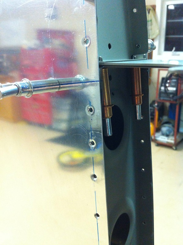

It took a while, but here is my flap hinge pin retainer. I would like to take credit for this, but honestly I shamelessly copied it from someone else. :D

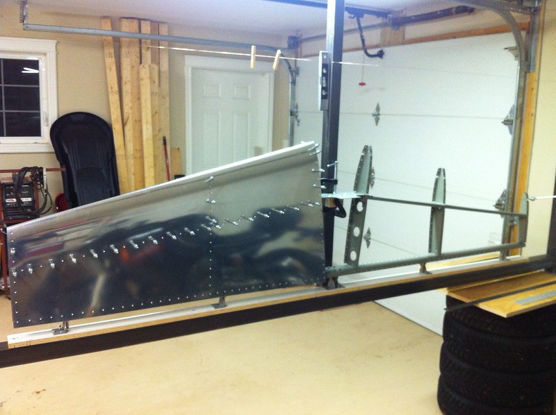

Finally some real progress to "finish" a wing
After a while without much visual progress, it's nice to be standing by an almost complete wing. I riveted on the lower skins alone, which wasn't too bad. I should get the feeling back in my arm eventually.:rolleyes: after finishing the lower outboard skin today, I temp installed the flap and aileron. Rigged aileron to neutral, and locked there via bell crank. The wingtip is just taped into place. Need to do the trimming around the aileron and mount. Still, it's very cool (to me) to see it like this.
Now on to the other wing and it's lower skins.

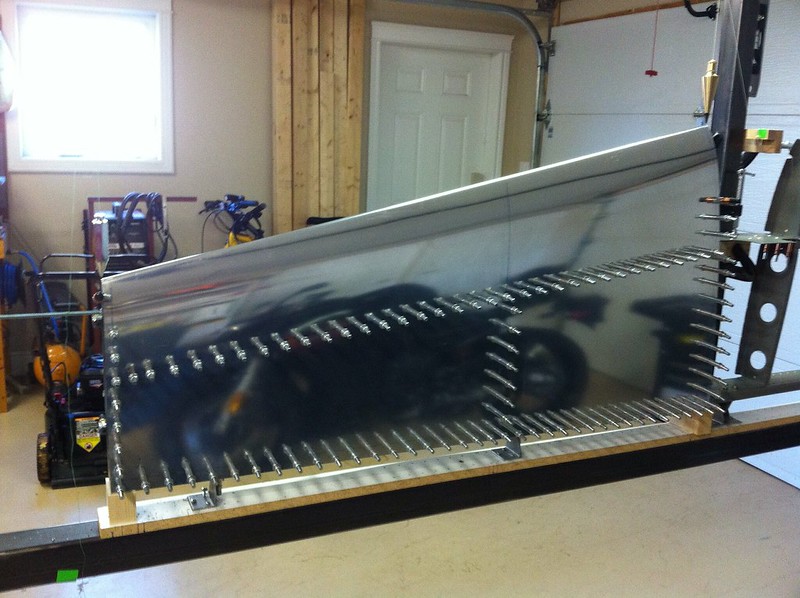

After a nice Christmas surprise package from the good folks at Cleaveland I have finished dimpling the horizontal stabilizer frame and skin. Getting ready to rivet some skins for good :eek: Feeling pretty good about that months of careful work and much figuring is coming to fruition.
Does anyone have some tips for "peeling the skins back enough (and holding them) to allow for bucking the rivets along the forward spar? I fit the skin today and it's quite still, especially towards the tip.

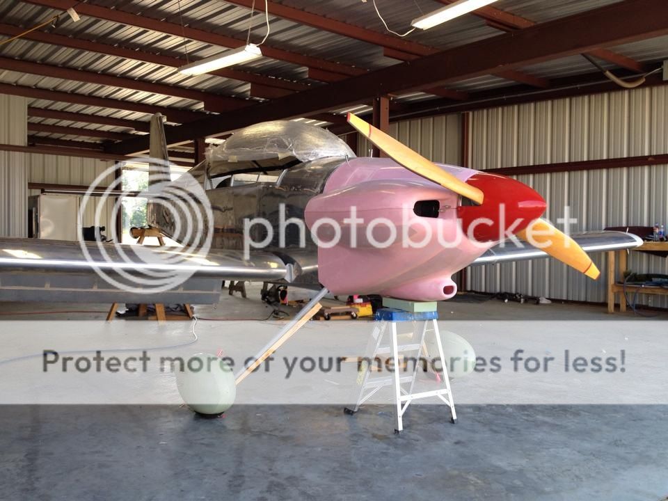

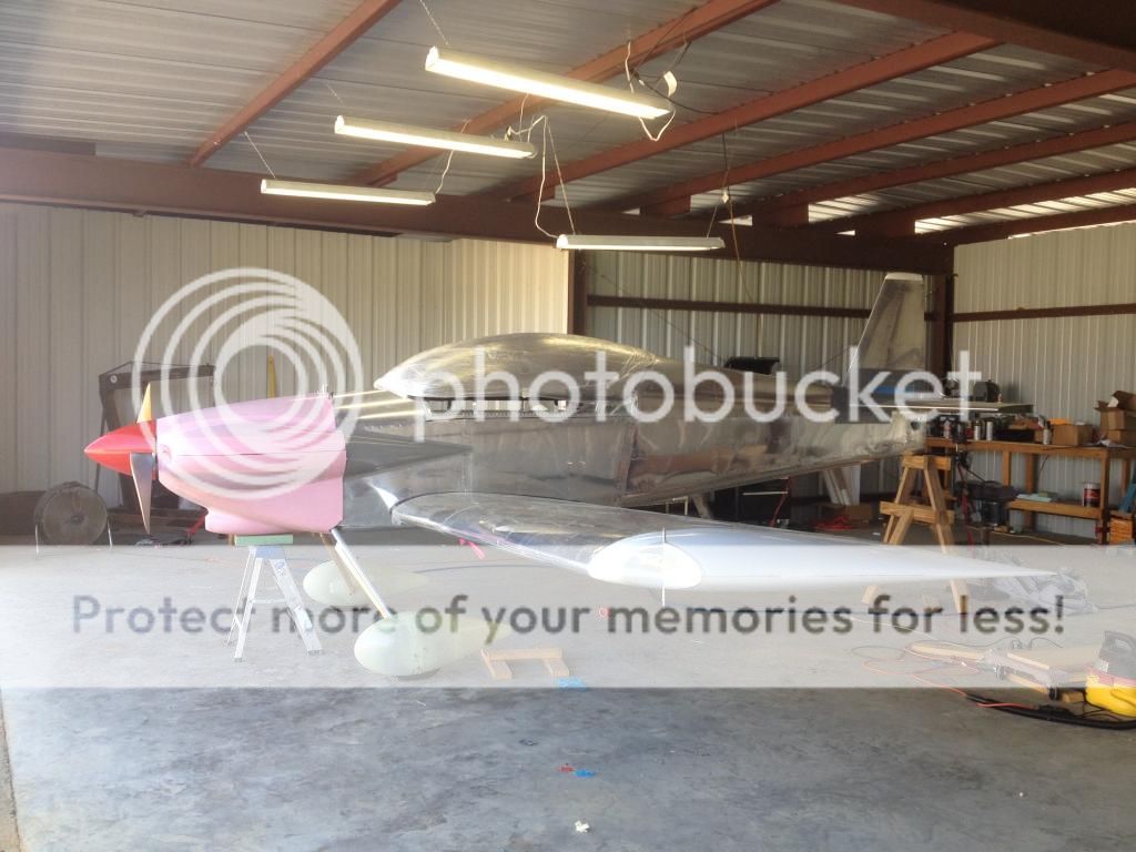

Canopy Complete
Yes, we do have a rollbar. It's just not installed yet.

My engine is almost ready to assemble. We decided to overhaul because the camshaft and accessory gears were badly corroded. It's getting 8.5:1 pistons to make it a 160hp.
