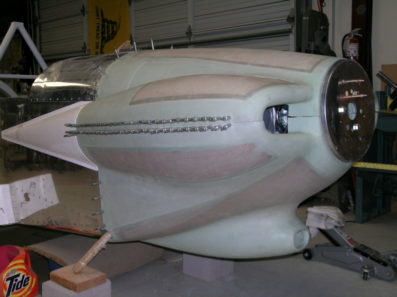

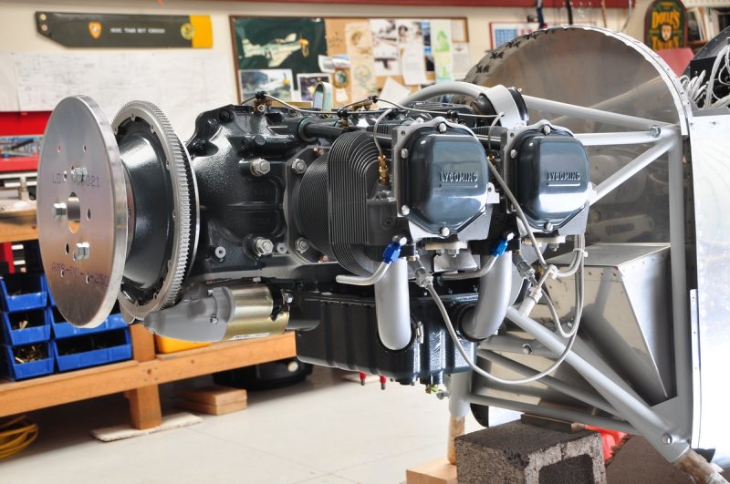

Engine (210 HP Lycon IO-360 parallel valve) is mounted.
Engine mount to firewall bolts are hardware store right now in case I need to pull the whole thing, AN hardware will go on for the final mount.
Now I'm fitting the cowling:
Times they are a changin...
Nice work Terry!
Man, Van's has sure come a long way in 25 years, my old vinylester cowling looked "cave man" in comparison. I suppose the 4" extended cowl is gone like the dinosaurs eh? I sure liked the "look"...
Nice!
V/R
Smokey
My "Cave Man" RV4 The Bandit 1989 kit. (lots of sanding:))
Looks nice. Wish I had that engine in my plane. I was wondering why the spinner back plate is so close to the cowling.
I don't have the prop yet.
I followed Van's instructions for a "Prop Simulator" and spaced the spinner back plate per the instructions.
There is about 1/4 clearance between the plate and the cowl.
I hope the spacing works out.
I should have the prop here in about a month or so - I'll wait on finishing the cowl to fuselage fit just in case I need to make an adjustment.....

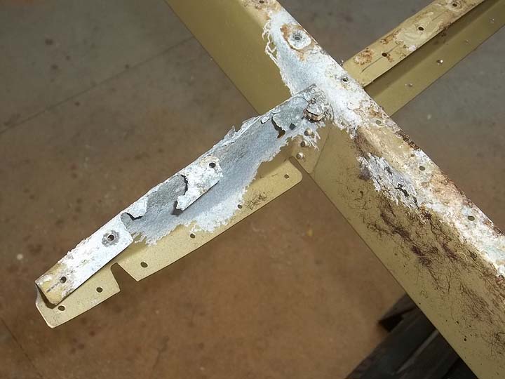

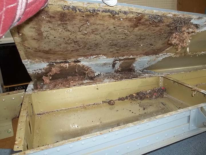

I recently purchased an RV-4 project from an estate sale.

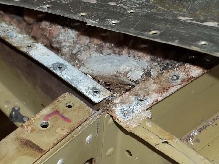

On the horizontal stab, I noticed some evidence of mouse activity looking through the lightening holes in ribs HS-405. Did not look to serious ( boy was I wrong) but I could hear some material flopping around inside as I shook the stab so I figured I better investigate.
Decided to unrivet a skin to check the interior.
The photos here show the stab as it looked from the outside and then what I found on the inside.
In the photos, the stab is actually upside down so most of the damage was on the bottom.
I did find a couple of mouse mummy's inside, lots of fiberglass insulation, nuts, and various other unidentifiable items.
The stab had been zinc chromated prior to assembly.
I think most of the damage may have come from the bodily fluids of the decomposing critters.
This aircraft had been stored in a garage with the tail on the ground for an undetermined amount of time.
Will order new parts from Vans tomorrow to build a new stab.

Geez, this is scary..:eek:
Good thing you decided to investigate a little more
Being one who had a mice's problems last summer, I sure will have a second look at my stabilazor assy..
I did inspect the wings with a Borescope but will do the same next chance I get with the tail assy...
I remember finding pieces of grass, paper towels etc.. at the bottom of the rudder but didin't think more of it but this sure put a new perspective of the problems...
I haven't found or caught any more mouse since I found the nest ( 3 of them ) full of new borns so I might be getting the upper hand after all..

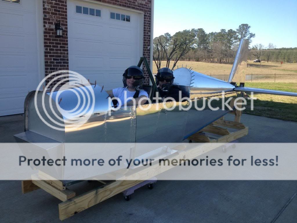

Slipped the surley bonds of the jig!
I finally have a canoe and plan to win the award for the slowest build on a -4: 1983 and counting!
Congratulations!!
" Slipped the surley bonds of the jig!"
I like that one:D
Congrats on this milestone.

Love it !
Now you can sit in it and make the flying noises!! A major milestone in building a -4 !...Took me 15 years to build mine, been flying it for 3 now, but the "canoe roll" was a very memorable day for certain.
