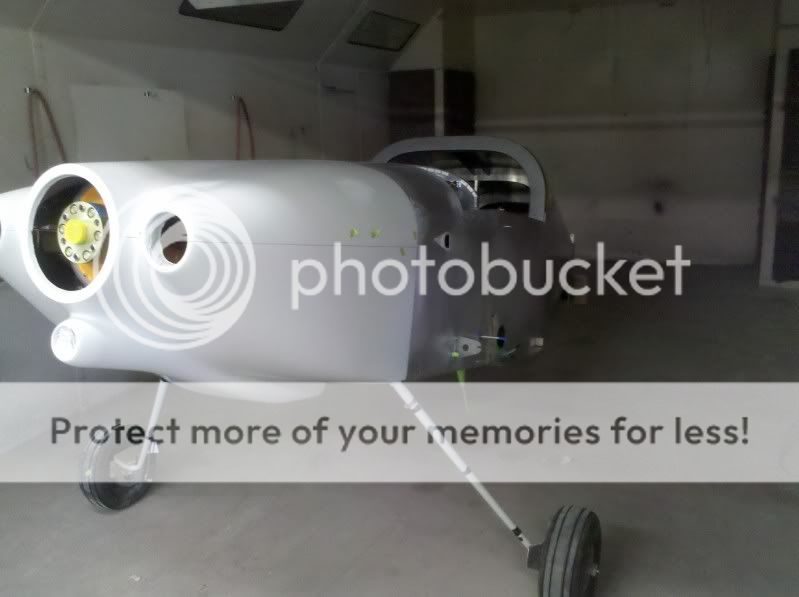

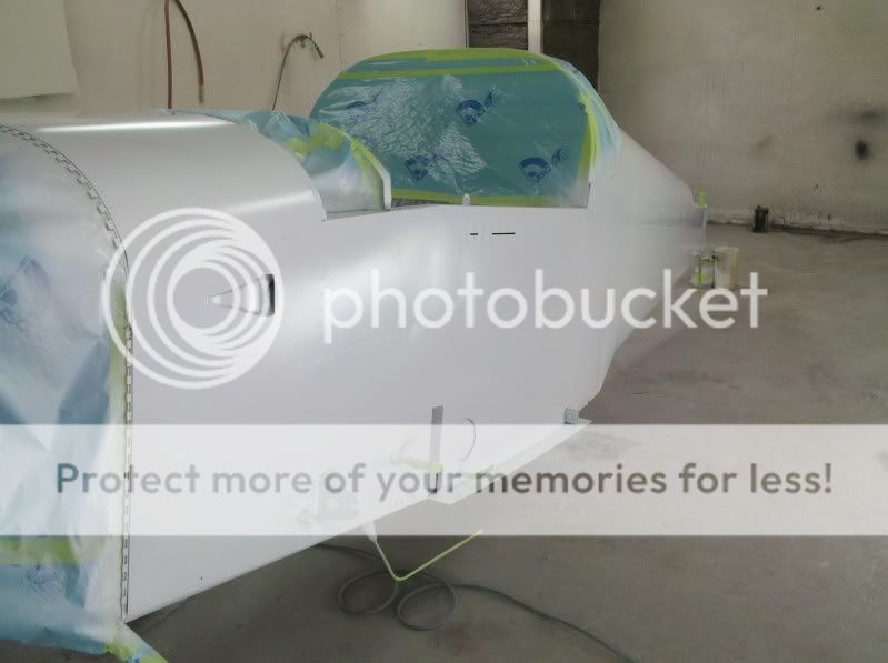

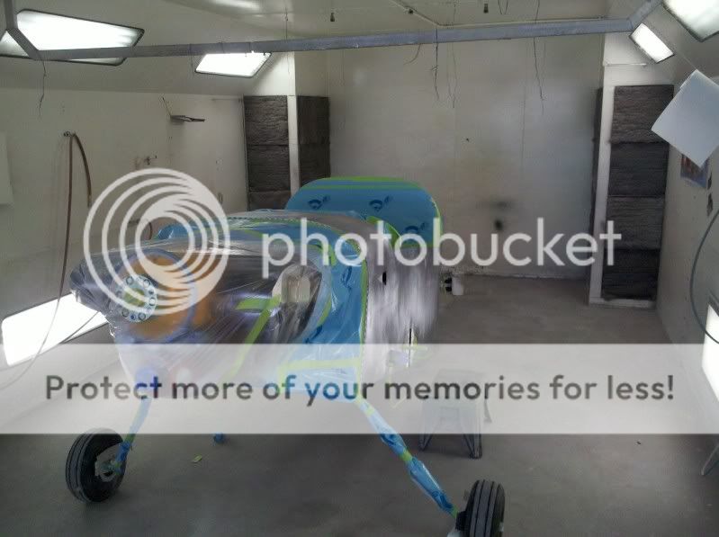

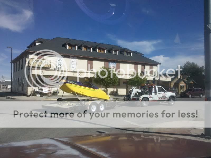

painting your own plane is not for the weak. I've painted cars before so had a pretty good idea how this was going to go. I toyed with the idea of painting in my shop, but knew I wanted a better job than myself and my tooling may be capable of. So 2 weeks ago I hooked up the ATV and towed N155BK off to a friends paint shop. I figured 2 weeks of hard work should get'r done, but reality set in. I'm taking up space in a working business and it closes around 5pm most days. + Fiberglass work on the wheel pants took longer than expected.

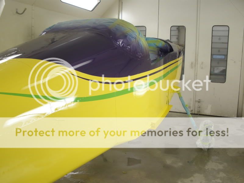

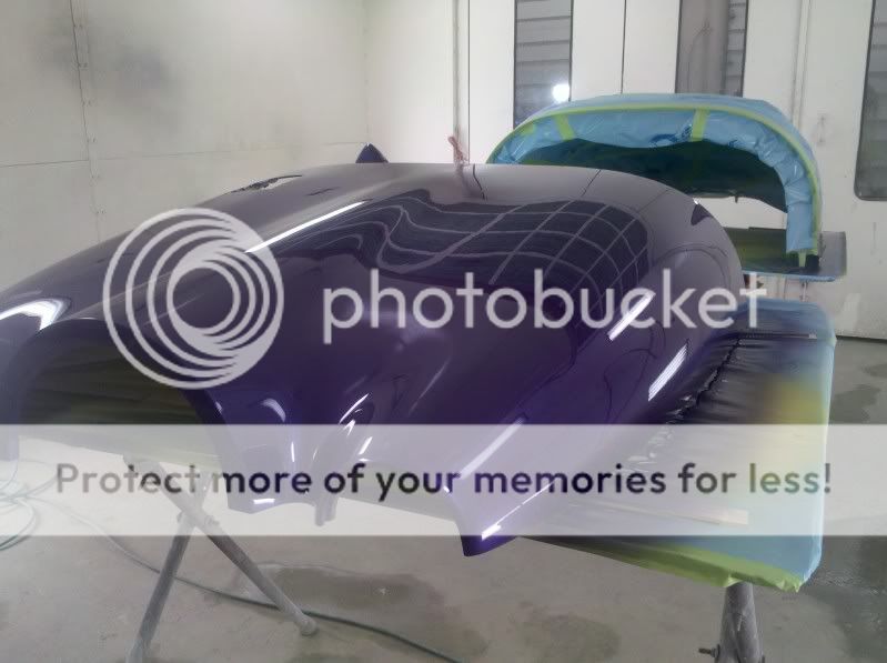

after the tips were blended and pinholes were battled, we shot some epoxy primer

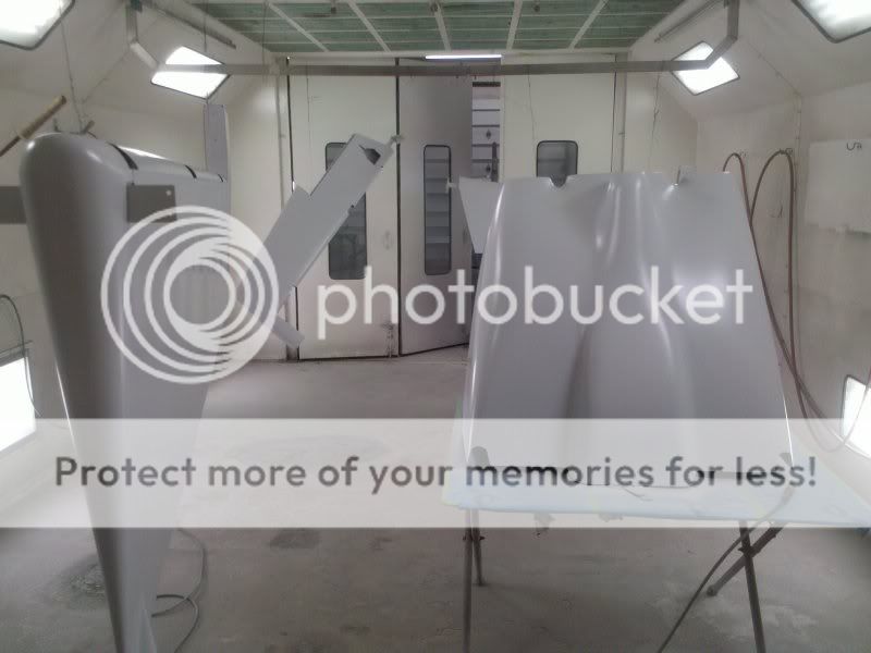

made sure the cowl fit was a go and then fit the upper fairings/gear legs. oh yeah found some pinholes

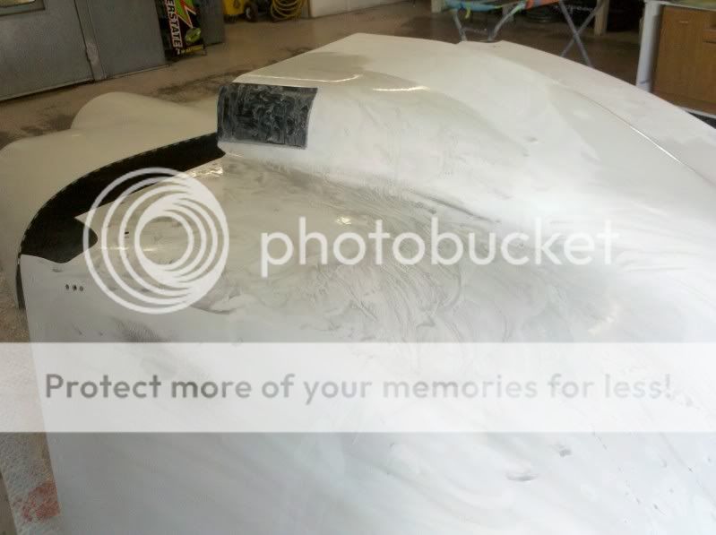

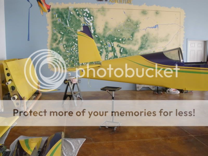

each piece gets a black powder dusting for guide to sand. my shoulder therapist would love all the sanding I did(great for the rotater cuff)

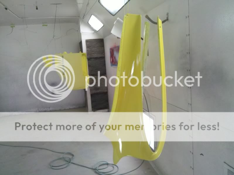

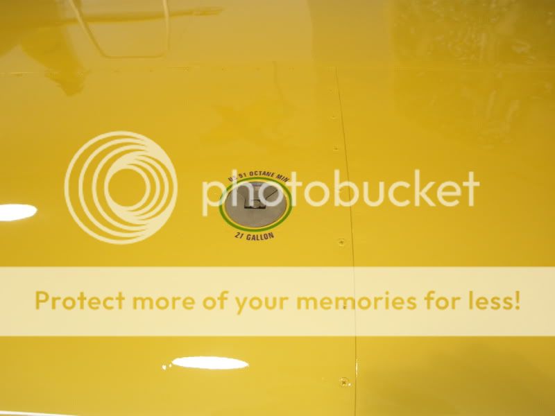

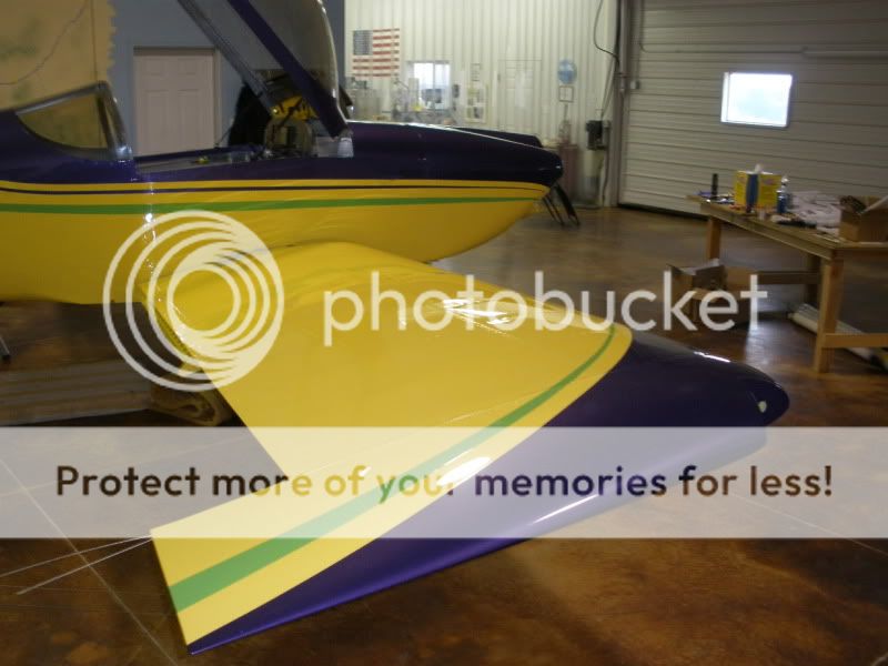

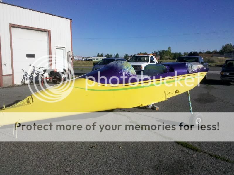

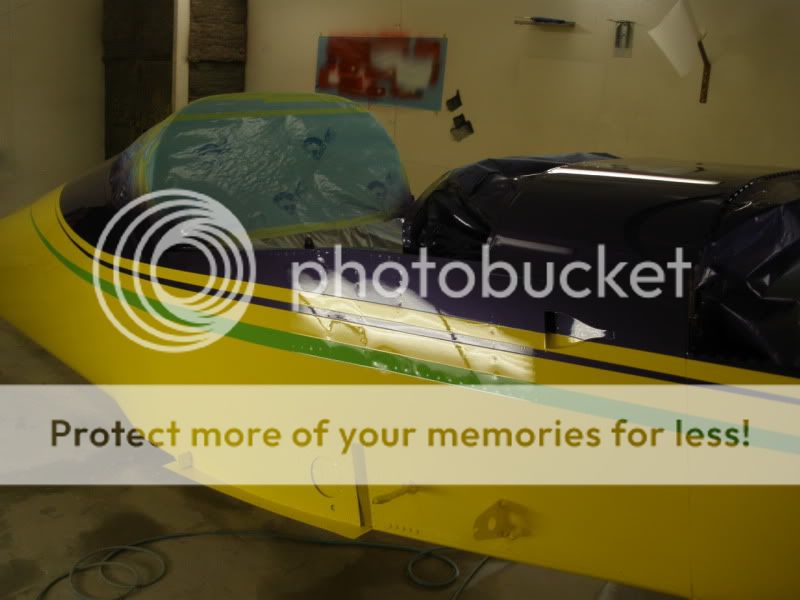

finally shot some yellow pieces on Wednesday

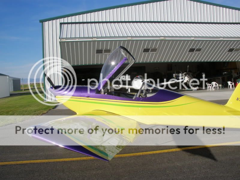

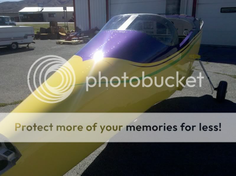

next 2 pics were taken today before and after of the fuselage epoxy coat.
I would guess we have 100+hrs so far and will finish the multi-color stuff next week. Whew!

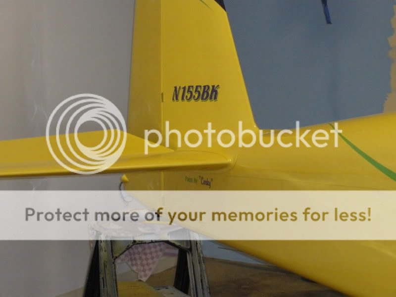

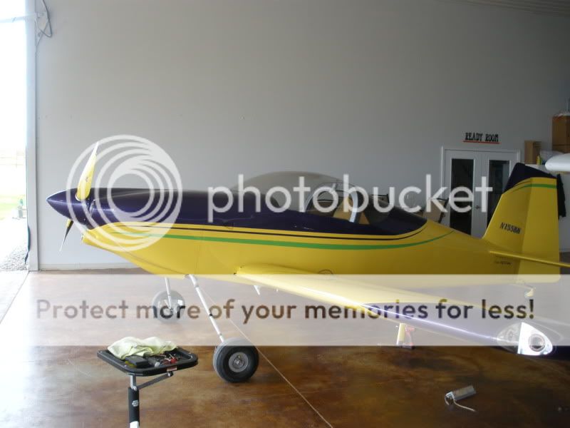

Shoved her outside this morning....wow am I dreaming...I ordered the tail kit Nov. '06.
love the colors and design... Exception of the yellow the purple and lime green are what I have in mind too... What kind of paint brand did you use?
Ryan, while normally it is not recommended to mix and match brands, We did.
1. Omni AU epoxy primer (PPG)
2. Nason Base colors (Dupont)
3. Nason Clearcoat Select (Dupont)
Plus the appropriate hardeners, reducers, etc.
Also booth temperature was held between 77-83*F for proper flowout of the clearcoat.
Amazing what a $800 gun in the hands of a guy with 30yrs experience can do.
The future of N155BK looks BRIGHT

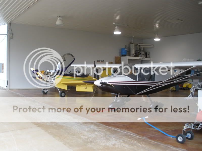

Aussie RV-7A
Another Aussi RV-7A out of the paint shop. Will try and post some pics here.
Enjoy:)

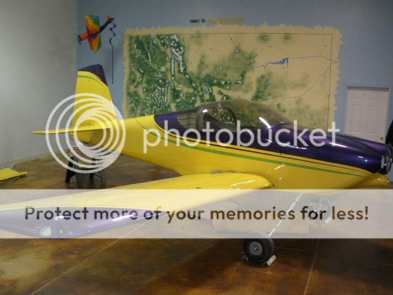

I think it is one of those optical illusion things. The paint lines and the canopy side rail give an impression of what level is an throws off my senses.
Whew! had me worried
nothing is level in this pic I just set the tail on a sawhorse to make it easier to slide the wing in. When all the holes were drilled and reamed everything was level every direction(checked many times)
