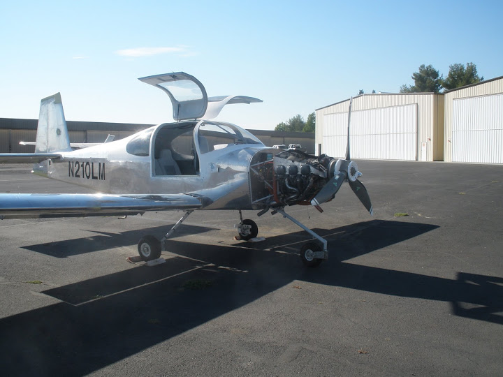

N210LM is now officially assigned to my aircraft shaped pile of parts, and the registration in in the mail as of yesterday.

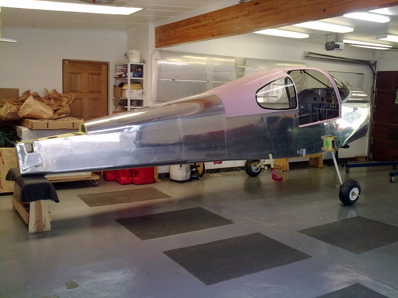

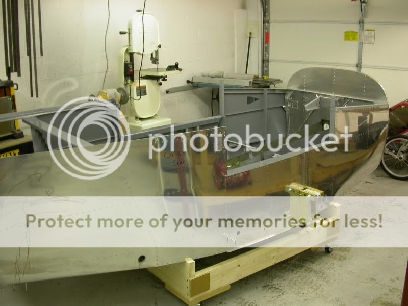

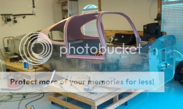

You plan all the hard work for Oct and March when you live in Houston. I've been holding out on fitting the cabin top for the majority of the summer. Now that the temperature and humidity are getting perfect I am getting the dirty work done.
I'm doing just a little bit of work every evening until I get it to fit. This is tonight's status.....
Getting closer.

Phil,
That cabin top is a lot of fitting and trying on.
It really is a lot of work to get it to fit properly.
Make sure you finish the inside of the cabin before grafting it to the "boat"
Keep it up.

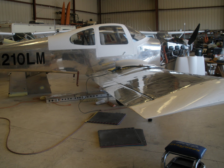

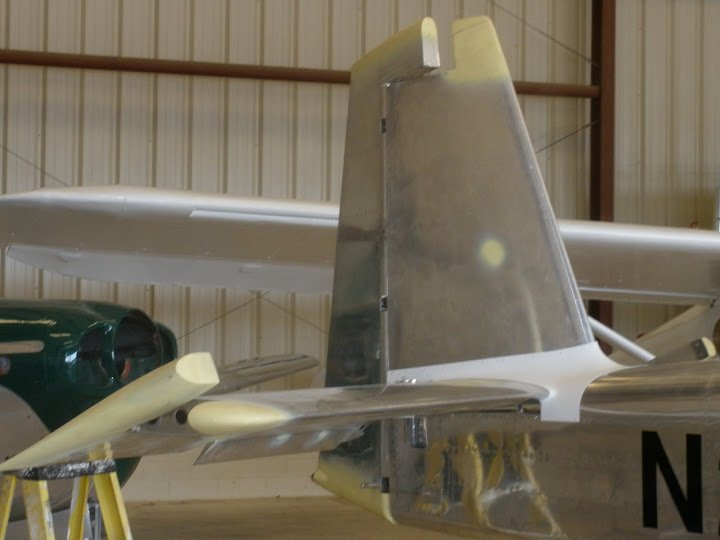

Wings on
Here are a few shots of the current status of the final assembly.
Wing all hooked up, flaps and ailerons and wiring etc, even the tip.
More of same, tail feathers go on tomorrow:D (Still working on the VTOL feature, C/G issues right now.)

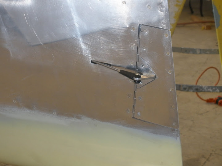

Close up of the rudder trim.
Amazing how installing 17 bolts can take two people all day.

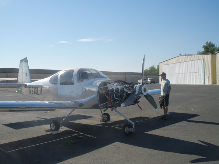

Airframe pretty much together and ready for inspection.

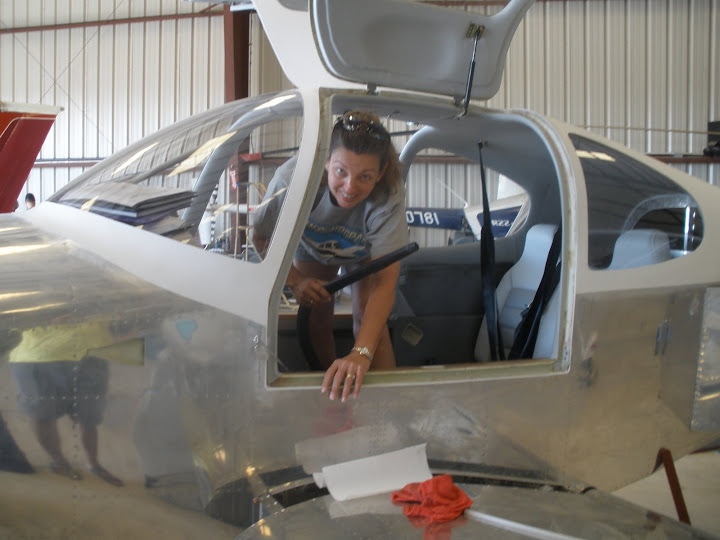

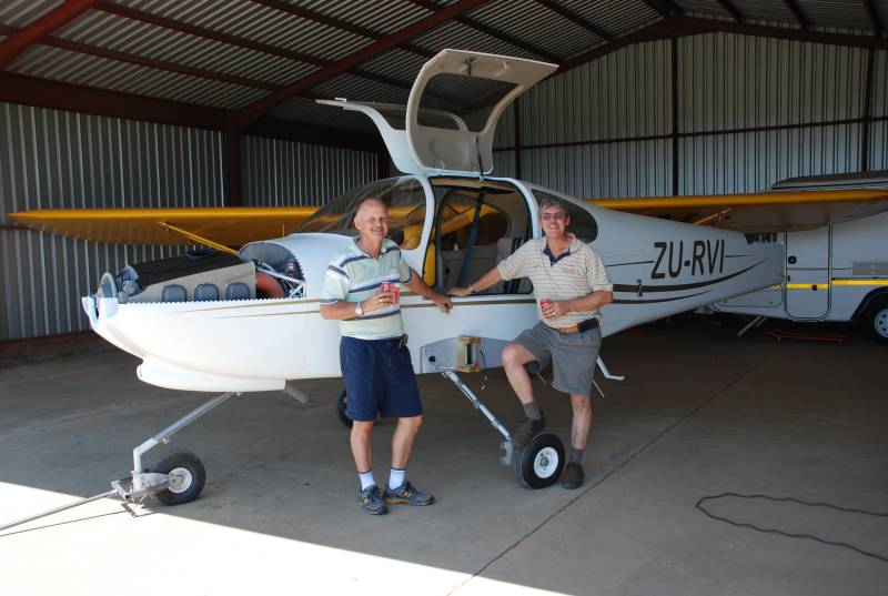

Here is Laura vacuuming out all the little hidden treasures that come out of hiding after the ride on the "scary trailer" as she called it.

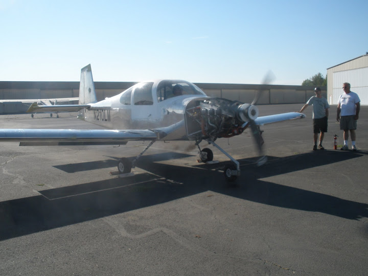

Time to run some fuel through the tank, flush out any goobers hiding in there.

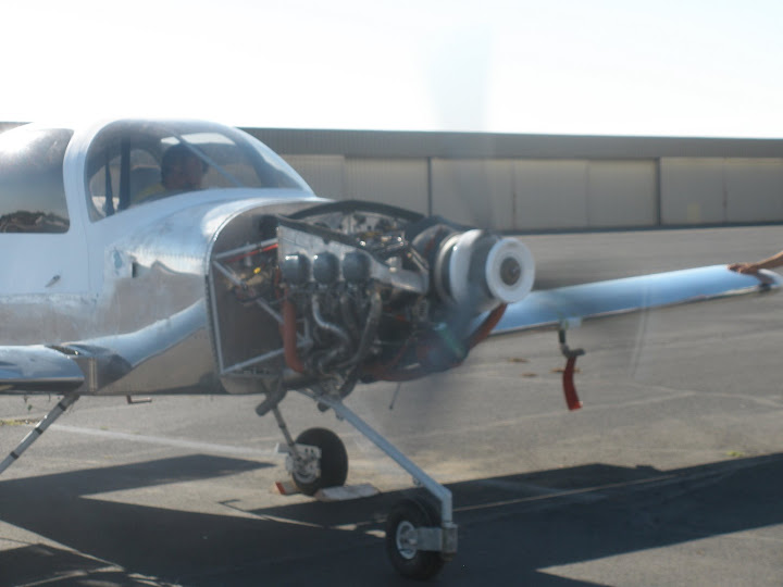

Both tanks flushed, fuel flow checked ---apx 30 gph---oil pump putting out to the pressure tap, guess it is time to see what happens when you twist the key:eek: Chocks down,
Pilot (??) committed.
Fire extinguisher at the ready-------
Too young to smoke.
Time for an adult beverage.
Engine smooth, Prop cycles just fine, temps OK, Tach not working, oil pressure too high---99---hopefully just a calibration thing.
Did I mention time for an adult beverage??

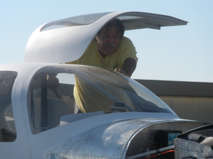

Started with upholstery
We have started doing the upholstery. Seats are done by the pros, but all the carpet fitting and cutting and side panels are home brewed :D

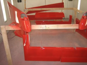

Just an interesting observation here. Where I am (South Africa) I have yet to see an RV doing the maiden without paint, etc. We tend to finish everything before that first flight. Don't ask me why.
Right now even the final paint is on every part. Just this Saturday a friend came by and talked me into some vanity boxes that I had to make for the RV10 - I admitted it was a good idea. So I have spent 4 hours this morning from 5:30 am to 9:30 am doing just that.
We are looking at another two weeks or so in the shop and then the big move. From there maybe two weeks more. Can't wait.

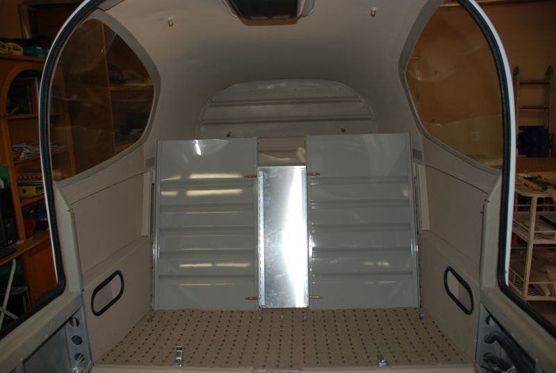

Moving on slowly but surely, working from the back forward :)
Note the vanity pockets in the rear side panels.

The flap covers hinges where the carpet and leather meets. Two reasons:- one is to make it much easier to remove the front seats during inspections and secondly to store the o2 cannula's in. And yes the two brass fittings are o2 fittings for the pax.
I really like your idea with the cover. Might still do it as it is really easy to implement.

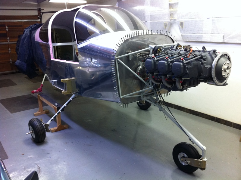

Firewall rivets
BE SURE to address the firewall rivets before you get too far along with the engine installation.
There are a few 3 or 4 on each side that are almost impossible to squeeze with the motor mount in place, and just about as hard to shoot/buck.
I waited too long to address these rivets, and wish I had not done so, I ended up tearing the side skin with the rivet gun, while trying to set the rivet at the top motor mount on one side of the plane.
There is a stiffener inside the skin, runs horizontal along the skin joint------this stiffener ends a bit short of the firewall, and when you place the rivet gun on these rivets, it can catch the skin between the end of the stiffener, and the face of the rivet set, this will cause the skin to be damaged ------ just about like being in a shear -----if you have insufficient force on the bucking bar.

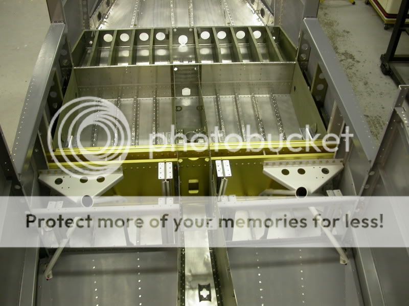

Section 29 done!

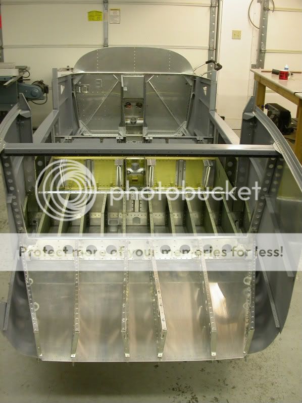

Whew. Began bending longerons and skins on labor day weekend. Just finished bolting in the landing gear weldments. I was hung up for a few weeks till I got a friend over to help shoot some rivets, so I worked ahead, and now sections 30, 31, and parts of 32 and 33 are done. But 29 was a bear, and am glad to have it off my back.
Sweet, Andy....
...when you put the steps in, take care to not allow any rotational movement. This issue was discussed here, not too long ago. I mention it because on my bought-flying -10, both steps have some rotational movement and it's almost impossible to do anything about it now.
Best,
Best,
Yep, but there is a fairly easy fix for that, as long as the floor is not yet installed.
Get a piece of steel tubing that is a slide fit over the step mount, and rivet a nut plate to the exterior of it. You could also weld a nut on if that suits you better.
The steel nut/ring only needs to be wide enough to hold the nut----half inch or thereabouts. Slide it on the step mount, use JB weld or similar to fix it in place. Nut down toward the belly.
Last step is to drill an access hole in the floor, in line with the mounting bolt, so it can be tightened later if needed. Or, in the rather unlikely event you need to remove or replace the step.
Get a round snap in cover for the hole.
Done:D

If you take a close look at your baggage compartment (Directly over the steps), I'll bet you find these reference holes. The plans have you drilling them and I'll bet the builder put them in. #30

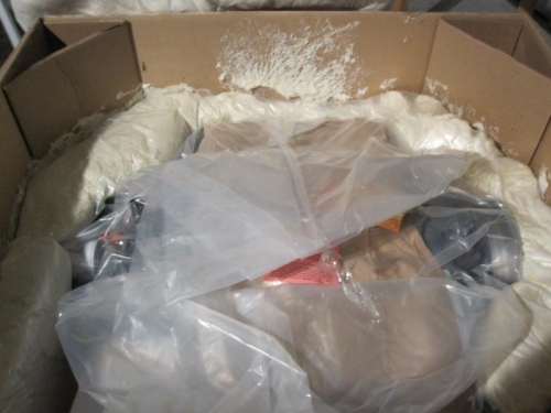

After many trails a tribulations, my Van's OSH special engine finally arrived. I won't bore folks with the delivery debacles. I'm just happy it finally arrived at 9:00pm on Thursday.
bob​
Look at the serial number!
Wow Bob, Look at the serial numner on the box.
I bet you are about the only one who now has a serial number that you can almost remember.
