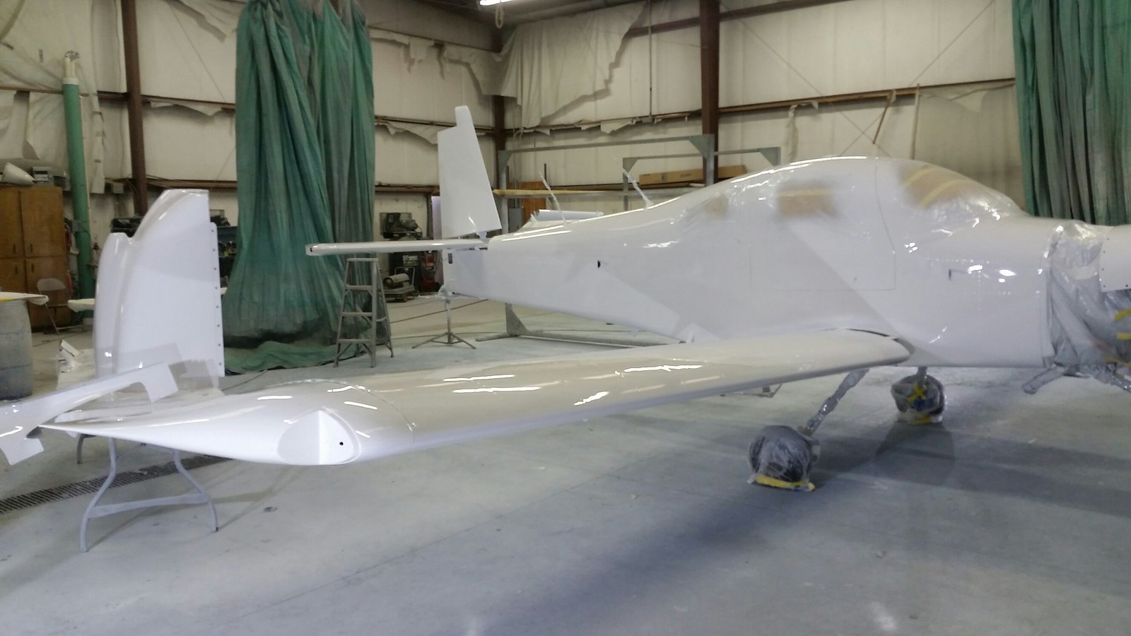

Painting underway!

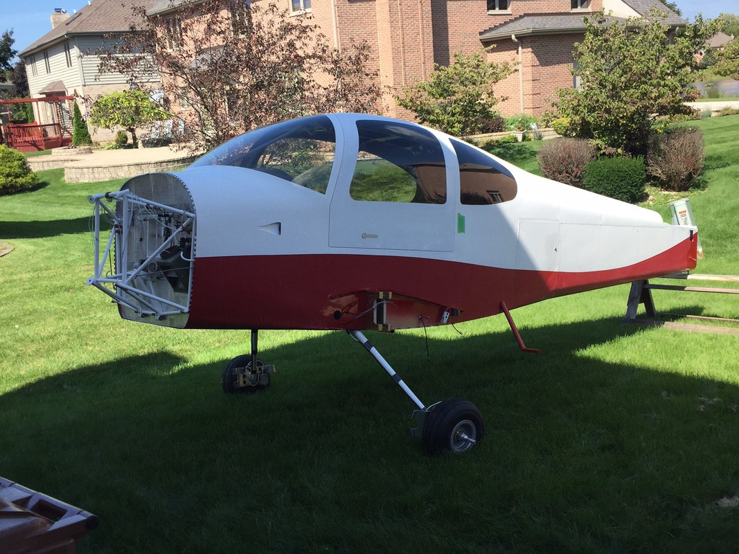

She's got her white base coat -- on to color!
Looking sharp!

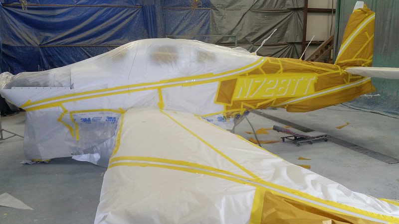

That's got to be really encouraging to reach that stage, Todd. Glad to see it happening; looking forward to the day on mine (and remembering my 6A at that exact stage 19 years ago). :)

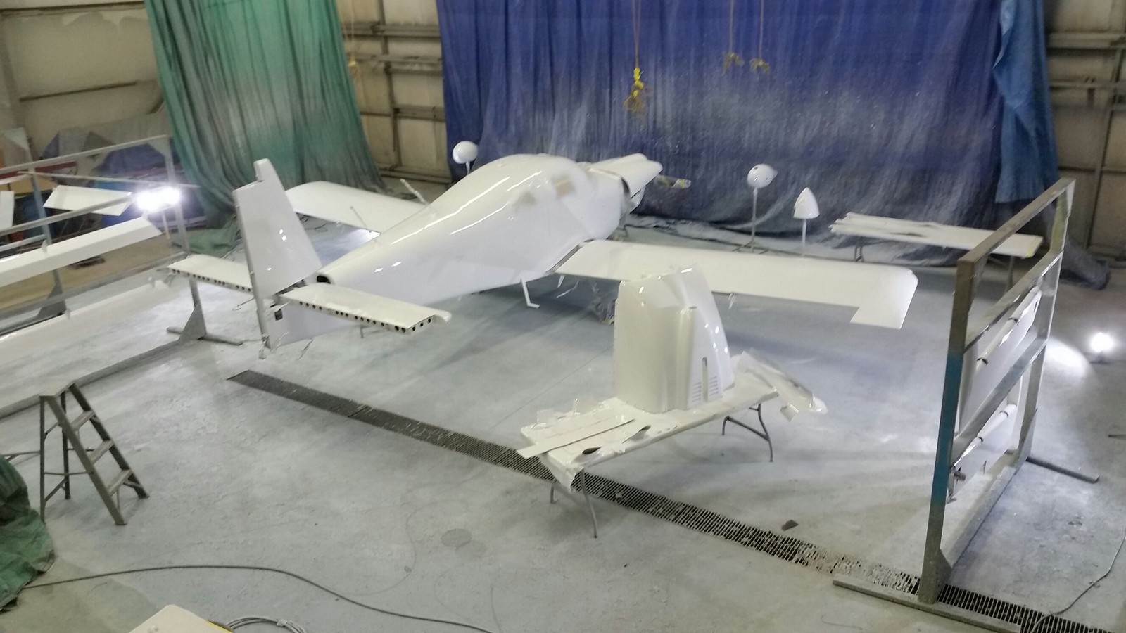

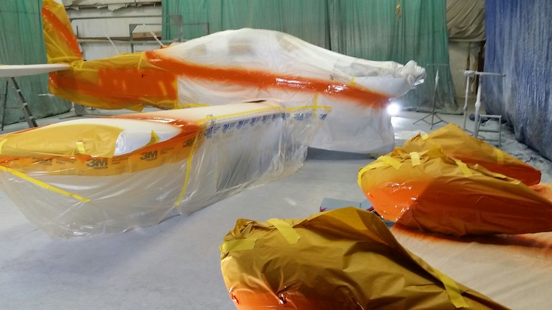

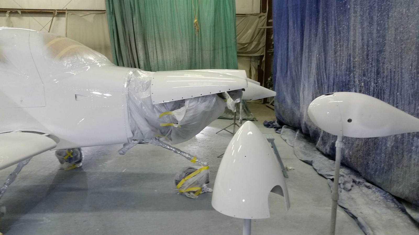

Update #2
So with the white base on, the stripes and N-number shadowing has been applied. After that's all dried, the color for the cabin, top cowl, and wing/emp flashes will get sprayed.

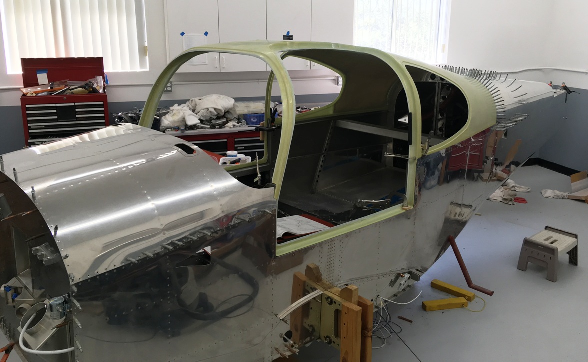

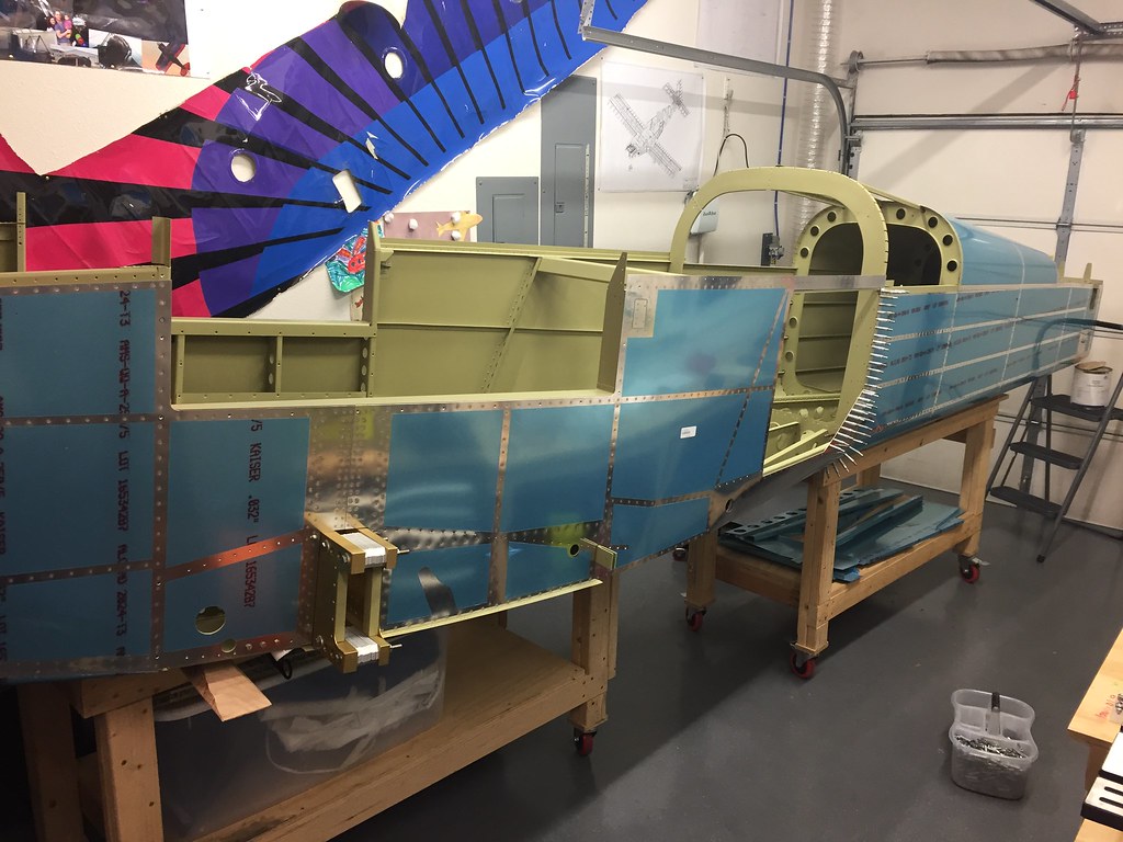

There are some points in the build process when various assemblies start to look like an actual airplane. This is one :)
Cabin top trimmed to fit after lots of cutting and sanding - ready for attaching holes to be drilled.
Often times, a guest at our house that sees the garage door open asks if I am building a canoe?
Its like taking photos of models. They look good in pictures, but when you wake up next to them.... woah - look out. The pax door sits about 3/16" higher in one spot. Have lots of fiberglassing to do :)

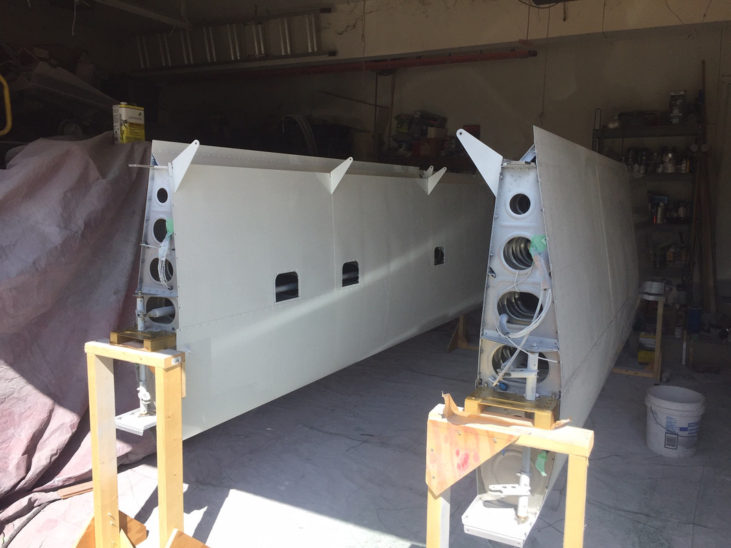

It has been a while since I posted something about my 10 build. Here is a pic of the project in it's current state. Sprayed the wings today and have only one more painting session for wingtips and cowl. Thank goodness the painting is almost done. A LOT of work for a project this size.
Just need to re-hang engine and finish off baffling and some misc FF work. Should be flying by November.
Larry
In this pic, the plane has been wet sanded, but not buffed yet. Also, need to re-spray the doors at some point. Had a problem with color matching.

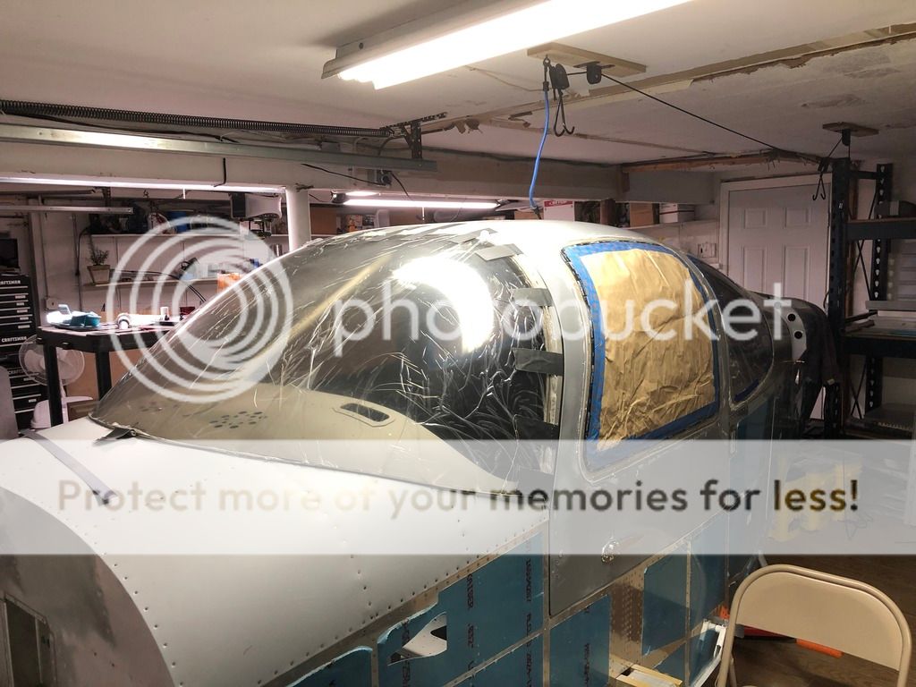

With the engine and nose gear on, I only have about 1" of clearance in the front and back in the garage. Not enough room to maneuver for painting.
Larry
Hi Larry your RV10 looks great! Do you happen to have any pictures of the paint booth you built? I?m about to paint my rv10 project in my 3 car garage but still thinking on how to setup a booth.
Bill
I used a 10 x 20 plastic car shelter from Pep Boys. Filters on one end and a fan at the other end. Sealed along floors and corners with gorilla tape, put florescent lights at all four corners. This was for an RV-7. Might be a little tighter for a 10.
Hi Larry your RV10 looks great! Do you happen to have any pictures of the paint booth you built? I’m about to paint my rv10 project in my 3 car garage but still thinking on how to setup a booth.
Bill
No paint booth. I almost made one, but was concerned about the fan pulling in the plastic, as well as the static issues related to plastic, not to mention building a door. I just put tarps over the floor and tools in the 2 car section of my garage. Left the door open 2' with a fan Having other garage door open helps some.
I had very little dust issues. I learned some time ago that most of the dust comes from the painter and not the booth. I wear a tyvek suit and it works. I would sweat several gallons, but its the cost of DIY. A nice side benefit is not having crunchy hair for 2 days from the clear coat. Some parts needed a wet sand and some were passable without it. I have learned that cut and buff is just a cost of painting something in your garage. Unless you're good enough to lay slick clear consistently, you're probably going to do it anyways. Grounding any aluminum parts also helps, as the high pressure spray creates static electricity, which attracts dust. I also spray water on the ground before spraying, though in the summer temps it doesn't stay there long.
a 10 x 20 booth will be very limiting, especially if the plastic is getting sucked in by a fan. Don't forget that you will also need a ladder to spray the top of the cabin top, plus a creeper for underneath. I would not have enjoyed spraying the fuse while constrained within a 10' booth. That leaves only 3' per side (before accounting for the plastic being sucked inward) and nothing at the front or back. You also need a door and if that isn't sealed, what's the point. Without a constraining booth, I was able to shoot the entire lot of empennage parts in one session.
PM me if you want to discuss details.
Larry
