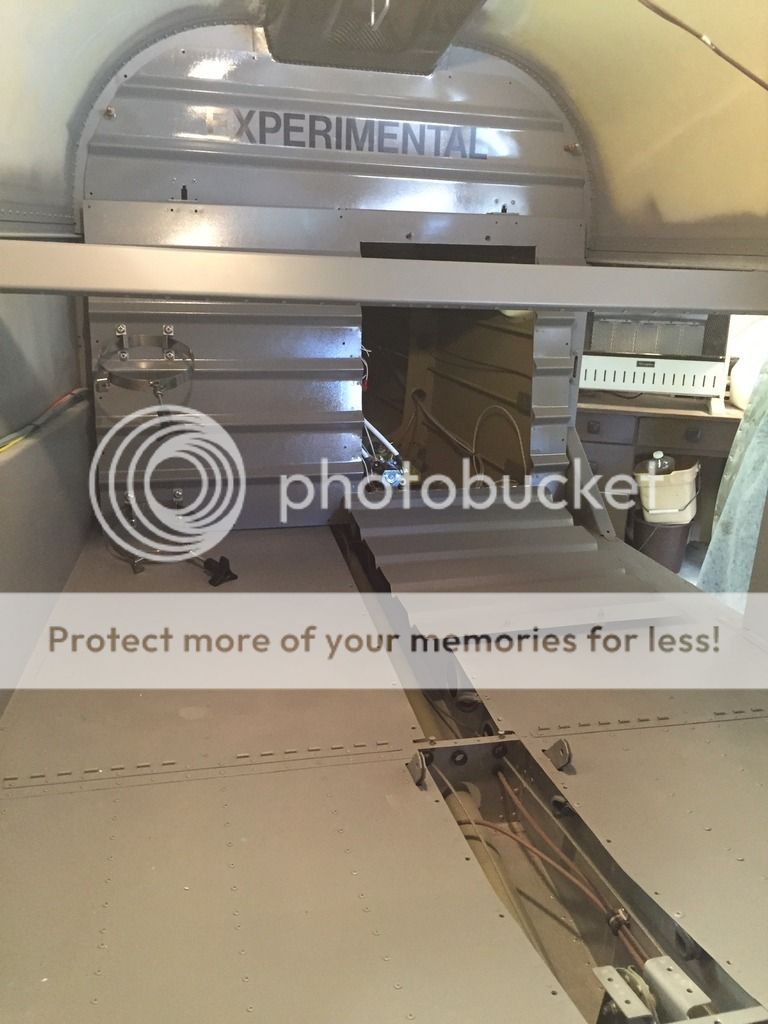

O2 Canister Location
here's a better look at the access panel
John,
Since I have an RV-7A and have never been inside an RV-10, perhaps I'm asking a dumb question... in looking at your mounting of the O2 Canister onto the rear baggage bulkhead (behind the rear seats), while in flight, how does the pilot or right seat passenger access the canister to control the flow of Oxygen?
Just curious... Thanx, Victor
Victor, go back a couple pages, there is a photo of his bottle in place-----it is a "Mountain High" setup, they have a remote control feature for the bottle.
http://www.mhoxygen.com/index.php/built-in-systems-o2/ip/46-eds-2ip-faa-cami-tested
What Mike said,
If you look on the panel, there's an O2 switch. It's tied to 3 small lines that come from the MTN High PCR regulator. Then I am using 2 O2D2s in my center console for pulse demand oxygen that will feed 4 people.

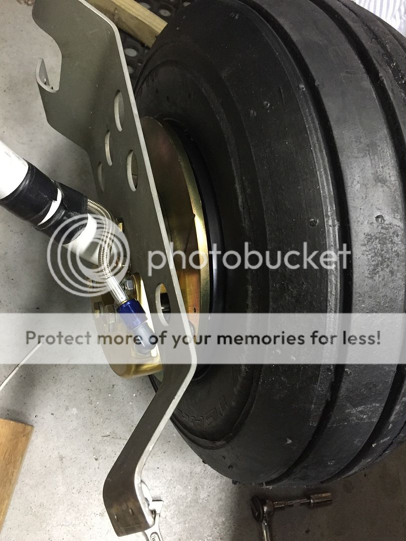

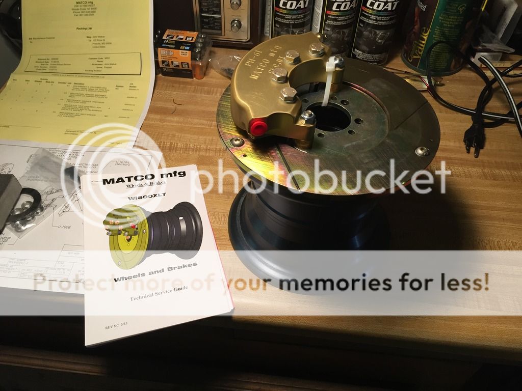

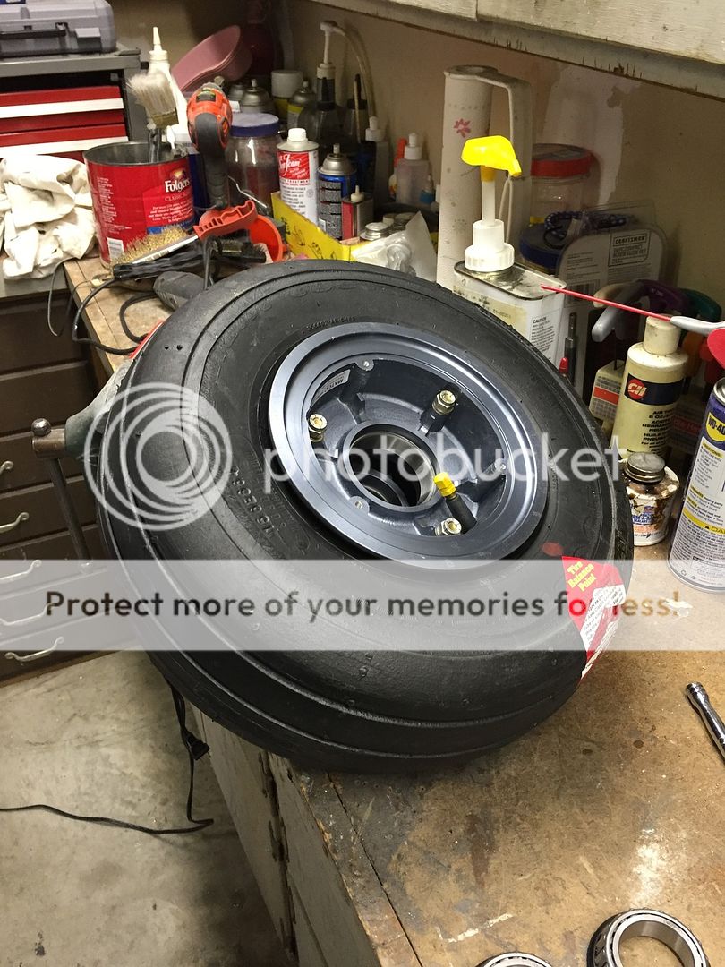

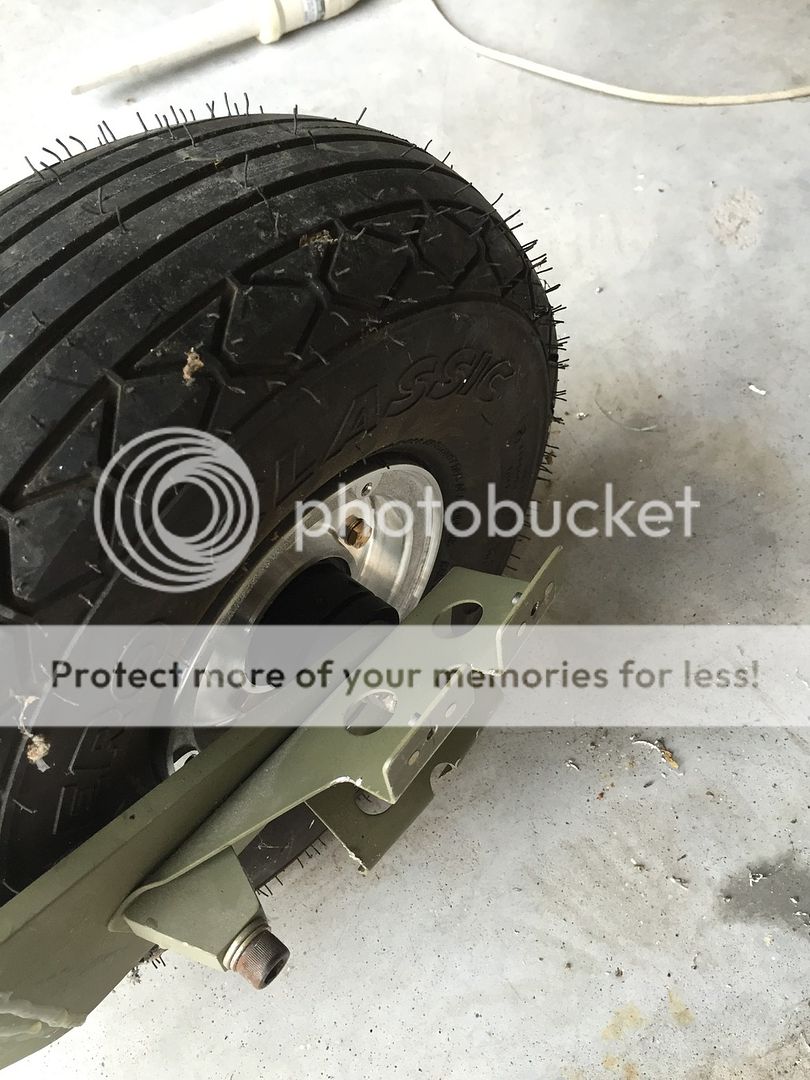

Did the Matco Wheel and brake upgrade (finally) as well as the front axel upgrade. They had been on my list since the beginning but were in the "can happen anytime" pile... Along with some new Desser tires (oshkosh Special) and The plane Around Fairing spacers...

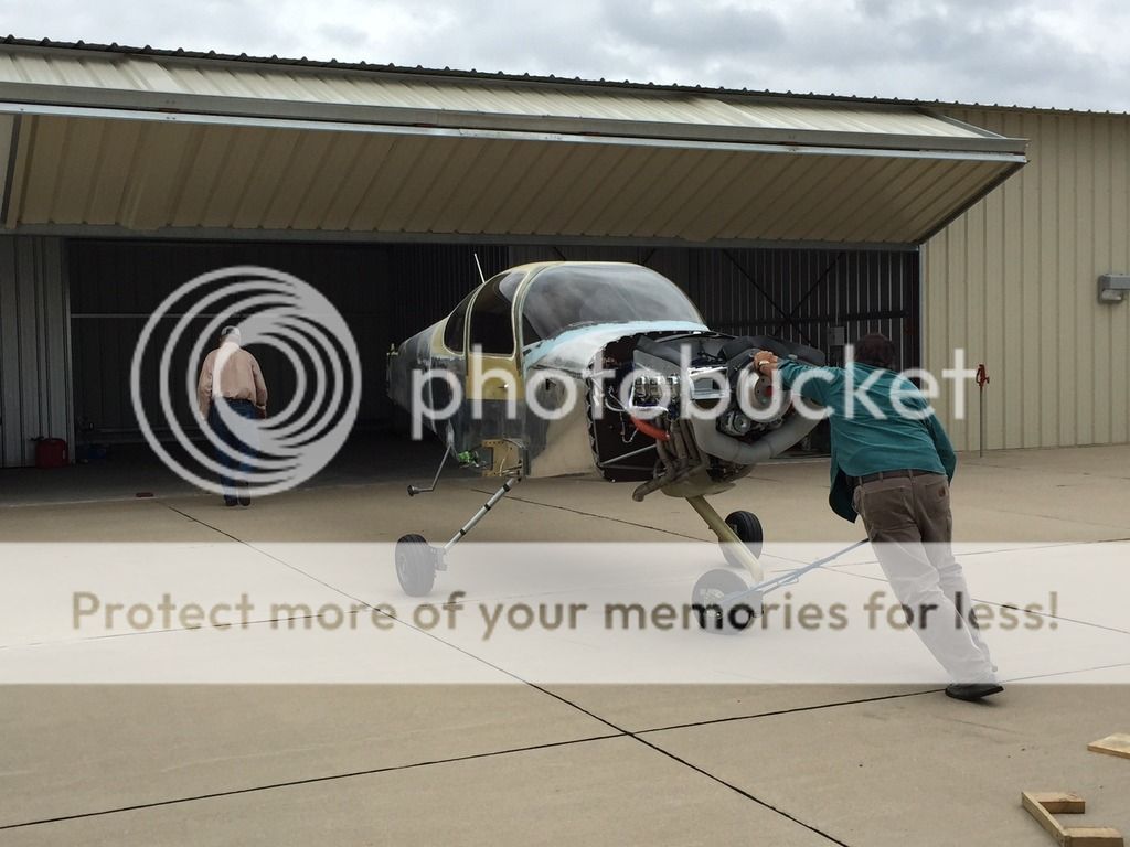

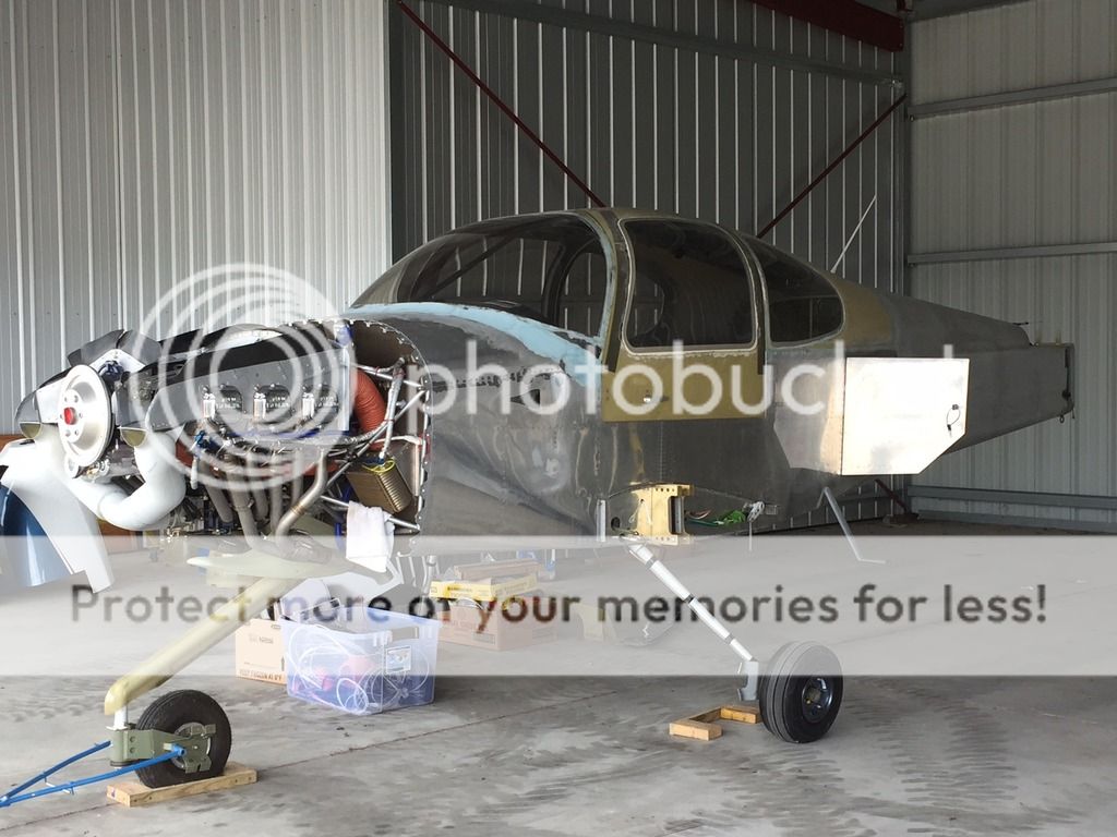

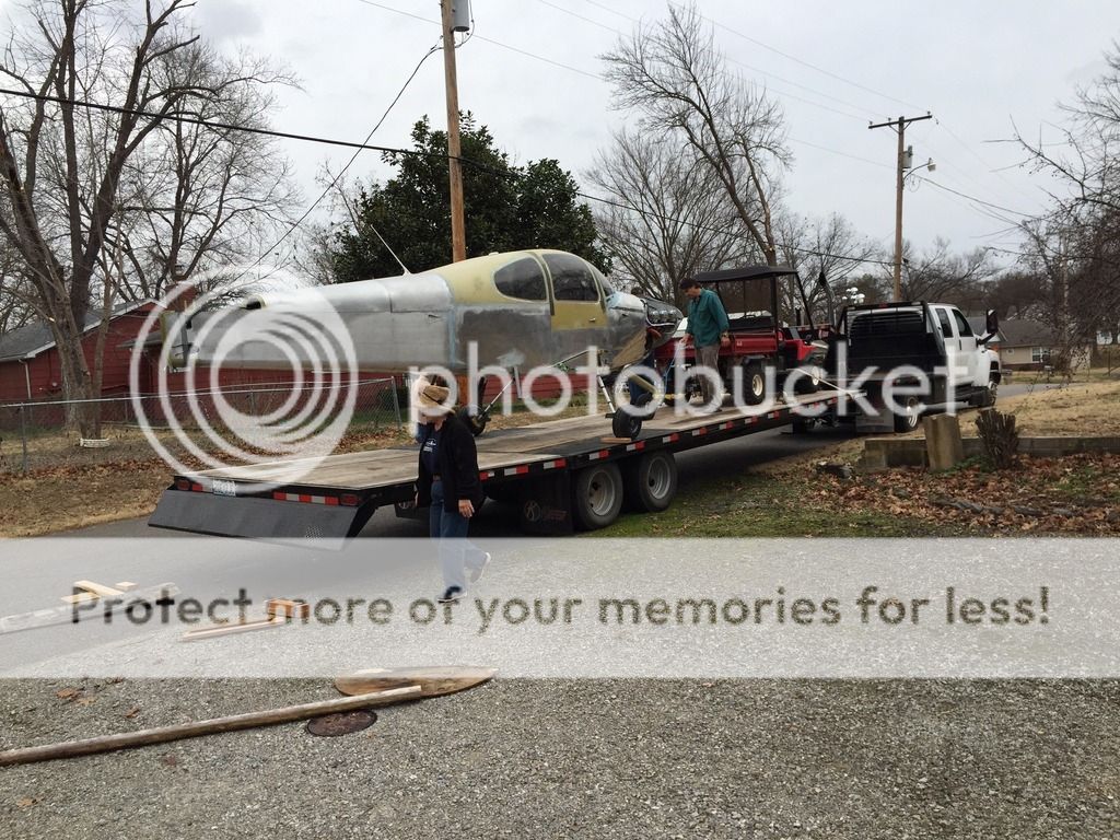

Then is was time for the big move the next day... Moved to Neosho (KEOS), for final assembly and first flight.
Leaving it's home..
Thanks for the help Al!!

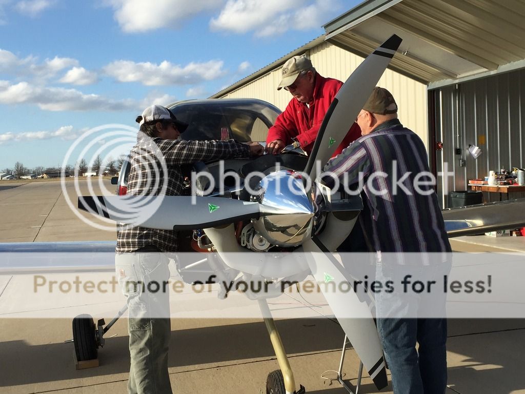

Then, only 2 days later... we got the wings on and we got to fire up the engine. Won't say it was completely without hiccups. Found some pilot error upon inspection... but once it fired up, it ran like butter. Just ran it enough to do a few tests. Still need to get enough RPMs to get the proper to cycle. That's be the next engine run.
Always good to have some A&P friends help out...
A shortened clip... Watching 5 minutes of engine running is not the most exciting...

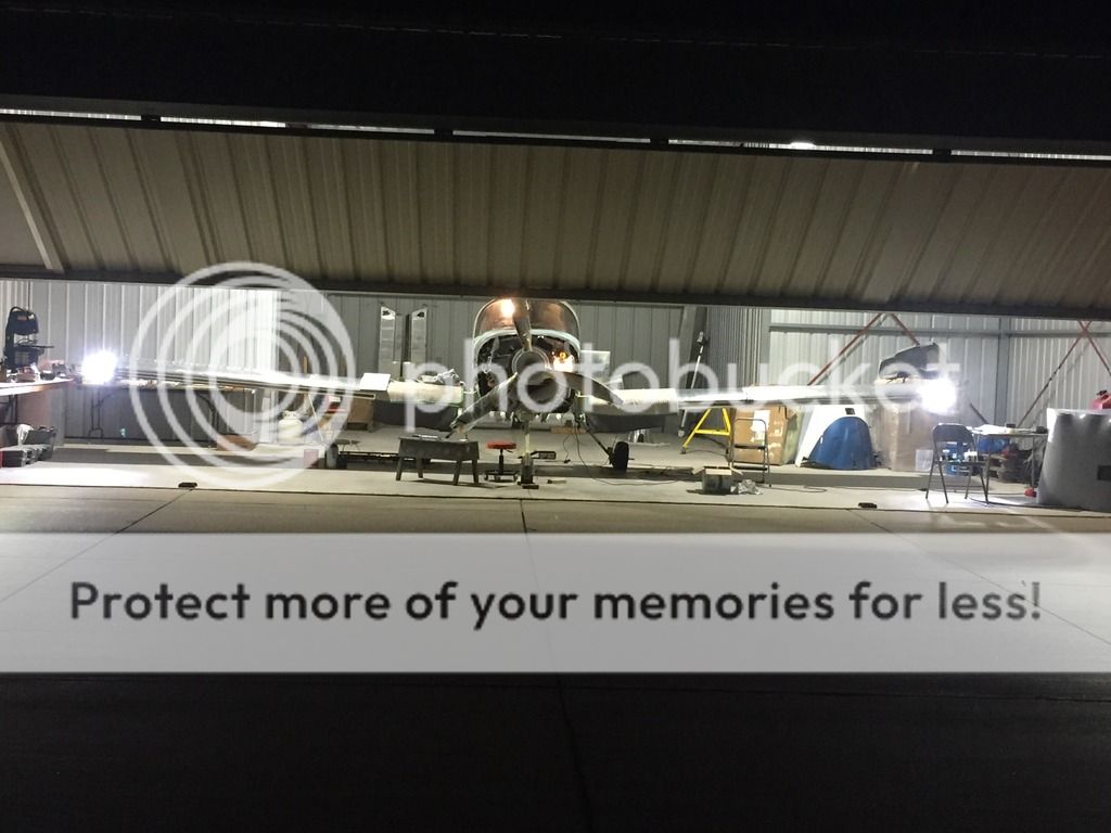

Very exciting! Getting really close. I particularly liked the night shot through the partially closed hangar door...

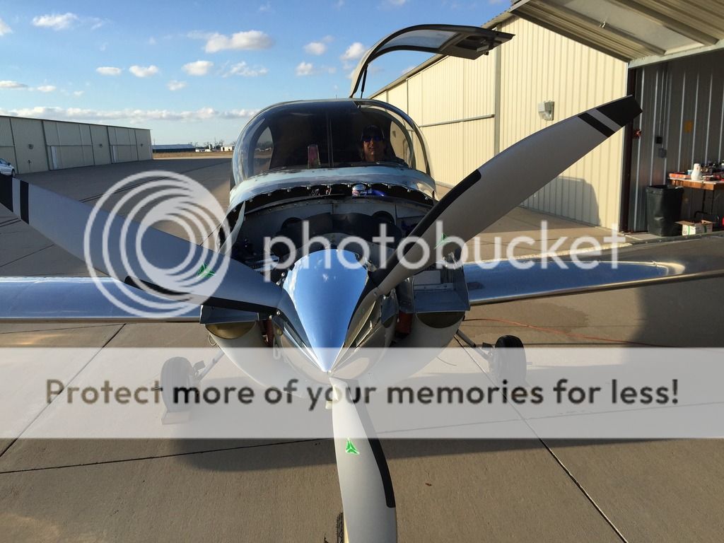

The air intake is part of the Show Planes cowl. I should have seen no AC compressor. That'd require yet another mod!
Looking good, man that spinner is awesome.
Just curious (not critical)... When I look at the routing of the SS brake line, I'm wondering if its fairly tight bend radius just prior to the swaged termination would impart a permanent pressure on the brake caliper, thus causing uneven brake wear?
I ask this because I just retrofitted similar SS brake lines to a certificated aircraft and experienced some challenges in routing the lines in a manner that allowed the brake caliper to be free floating.
That's one wicked looking prop - looks fast even when standing still!
It's not as sharp as it looks. When I unhook it the line sits right in the same spot. I put those lines in 2 years ago.

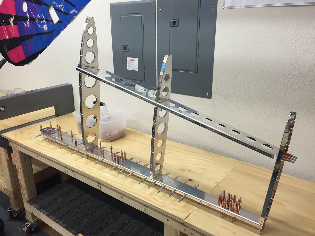

Day 1
4 hr, 31 min of actual building on the first day in the shop. I can't believe I have something that looks like part of a plane

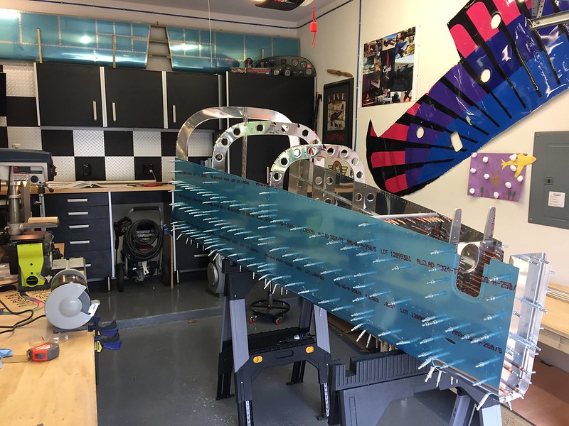

Just completed three great weeks at Synergy in Eugene, Oregon. We "quick built" a slow build fuselage. There was a Philipine QB fuselage there that we could use when the plans were ambiguous. We were also able to compare build quality. I think we did pretty well in comparison.
Obviously more expensive for me than the QB route, but I had a blast and learned a lot more than I would have simply ordering a QB fuselage.
Going back in late January to build the wings. In case you can't tell, I am a fan of Synergy. :D

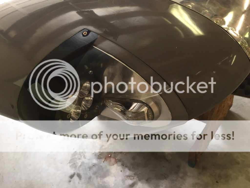

Do you have any pics of how you did your Baja landing/taxi light installation? It looks like they are adjustable up/down and left/right using spring loaded screws, but it would be great to see how you did it.
Antony

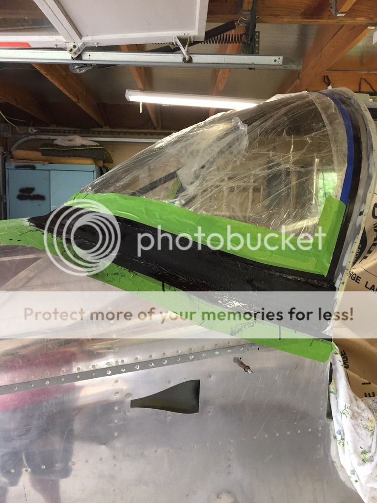

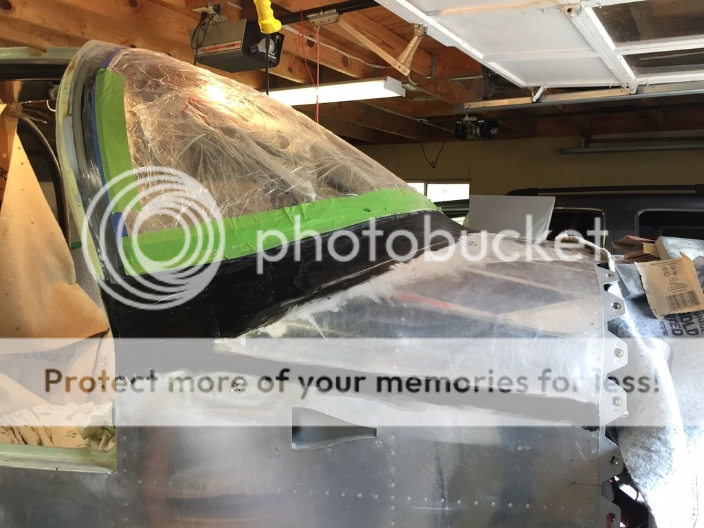

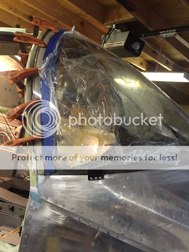

We finally put in the Windscreen, and built the fairing. Went pretty well. Good thing I researched it here. Would never have thought to dye the filer and epoxy black until it was too late....

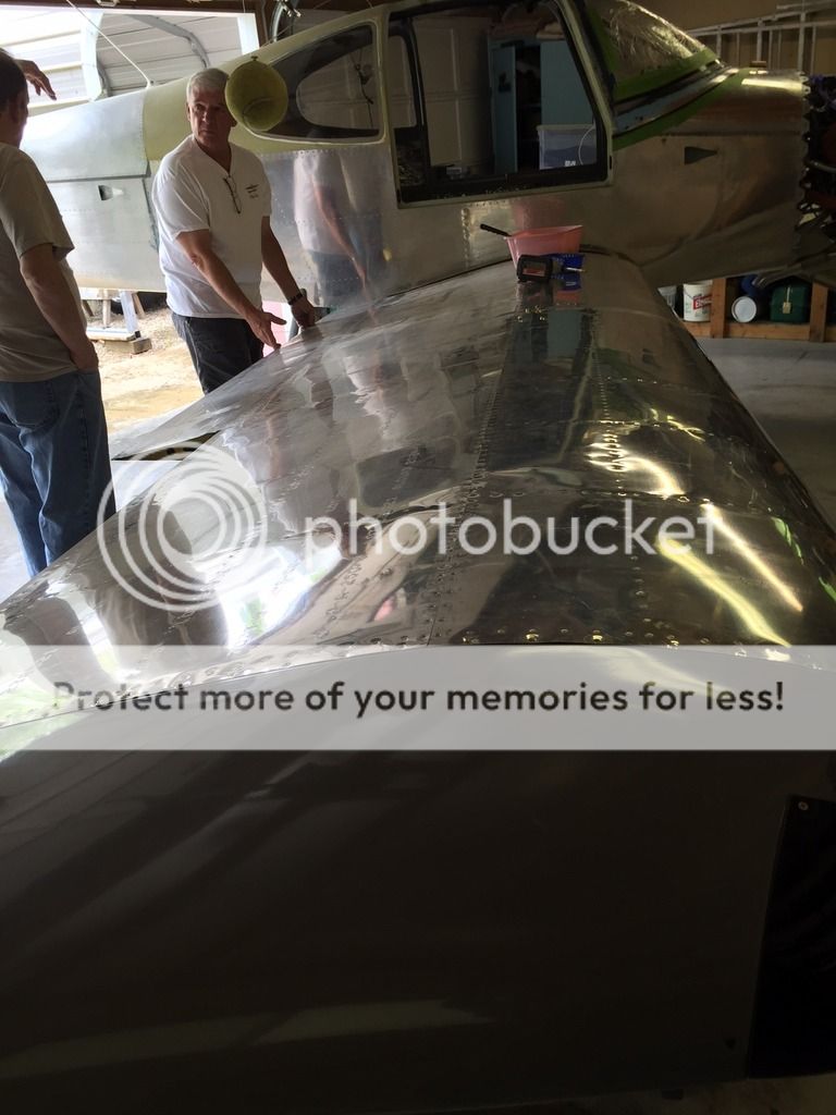

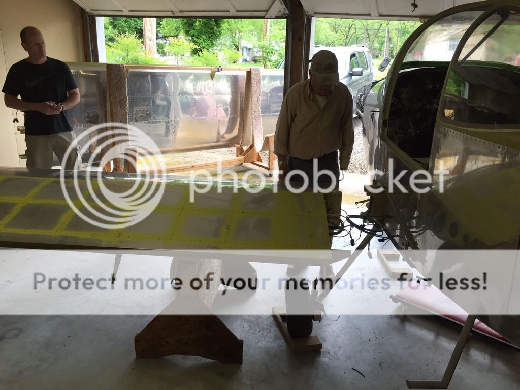

We also fitted the wings. So, that was kind of big deal. Actually went surprisingly easy. The plane got to get out of the garage and make Uturn back in.
Amazing that these wings left the factory in 2005 and the fuse in 2007, and they went together like butter. A lot to be said for Vans engineering and production.
Made and riveted in an extra bracket for the the windscreen. It disappeared under the fairing once it was all done.
Big thanks to the crew we had come out and help with the wings...
We figured out, between this crew we are responsible for 11 planes either built and flying or in progress... With Al and Shayne being the most repeat offenders...
Thanks to Al Smith (RV-6, Zeinith 650, RV-12, and currently a Zenith 750), Earl Starkman (25,000hr commercial pilot), Frank Klimek (Cub Replica and currently Sonex), Rick "Wingman" Wantz, Sonex), and of course, my father-in-law, Shayne (Sonex Waiex, Zenith 650, Zenith 601 and now the RV-10)

John,
Antony
I didn't document this super well. If you email me I'll send you what I have. But yes, I made a plate that attaches under the Baja Designs front face that essentially filled in the gap in the shape of the lens. Then I used 3 screws to attached it. It's three screes, going into three nut plates, with spacers and springs to get the right tension so that it's tight and still adjustable. Just by eyeballing it during the build I was within a few turns of getting the lights just right. I was actually shocked at the the first time I turned them on with the wings permanently attached and they were almost dead on....
In the end I painted the lenses (actually vinyl) so you can't see the guts behind the light.
I will say that I'm super happy with the results. Obviously I stole the idea from other guys. I'd been using these lights on my offload trucks and motorcycles, but hadn't thought about this use.... They are truly badass lights... and ZERO interference with the coms..... My wife say that when I'm out flying at sunset, she can tell it's me from the hangar (a LOOOOOONG WAYS away) because my landing lights are so bright....

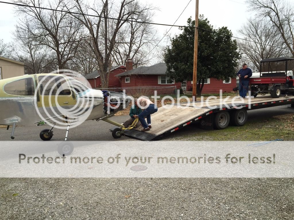

The time finally came this weekend when I ran out of things to keep me busy in the garage. I had already cancelled the tow truck once before, realizing that the time wasn't right. I'm glad I did. Since that first postponement, I've probably put an additional 70~80 hours into getting everything wrapped up. That would not have been fun to add all that on to what's left to do at the hangar.
The tow truck showed up Friday morning. The driver was a little too confident for my comfort level with getting the plane tied to the truck. I checked everything several times, but still was nervous. The drive to the airport is 20 minutes across town from my house. Did you know that it is possible for a person to hold their breath for 20 minutes?! Ya learn something every day! :p
