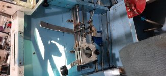

I have been sidetracked and needed to spend a bit of time fixing up my old brake, and then can move forward with the install and more updates.
throttle quad
After a few days of messing around with my brake, practicing installing and removing rivets, dimpling, etc., (playing with the new tools) I am happy to report the quadrant is finally relocated. I needed time to over analyze it apparently, but, after drilling the first hole through the skin (s) :eek: (and into my hand, missing my backing block), the rest went well and with no more bandaids. I now need to put some supports in for the cover panels, cut the pass for the trim lever, etc but after thinking about this one little job for months, glad it is relocated. Proof I cannot build a kit from scratch! Not enough hours in a lifetime at the rate I work! :rolleyes:

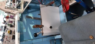

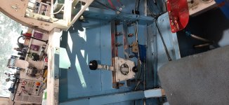

I made some more progress on the quadrant relocate. I positioned and connected the throttle and mixture cables to check out alignment. Looks like it will work out nicely.
I have to admit, I am enjoying the project more and more, now that I am learning a bit. Not ready to order a kit yet though... :rolleyes:
I picked up some poster board to use to lay out panels here and there. It looks like it will work well. It holds a crease. So the white panel shown is my first look at how to finish that panel off.
I figured the fuel valve was a little task that needed to be addressed so got it out today and took a look at it. It was very hard to turn, like, really hard. (previously posted about) After disassembling it, and scooping out the crud!!, , I decided to just replace it. So that makes that task easier. ;)
I have seen the floor storage in some models and I think Van's has it in their optional plans. I saw it somewhere and it looks handy (tools, fuel sampler, etc. ) But, in my case, I will need to rebend or replace the aluminum fuel tubing to get it out of the way. I have the inputs for my fuel tank levels in my engine monitor, the EDM350 so I can remove the fuel gauges. This will clean up that area quite a bit.
I thought I posted these pictures before. A little late but your installation looks pretty good! I can see a bead blaster cleaning up that quadrant a little....:p

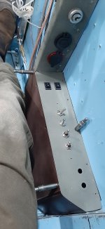

It has been quite a while since I updated. Progress has been slower than expected, which seems the norm.
I did up the switch panel and covers on the right side. I went with 2 rockers for Master and Alternator, but toggles for the other switches. One is avionics and the other three are just lights. I decided to put the fuel pump switch next to the fuel pump valve. This seems to make sense to me versus mixed in the light switches. Not much else in the aircraft. Pretty basic.
I did more or less finish the quadrant area but need to reposition the trim cable to allow for the rear rudder pedals install. I bogged down on this. The trim cable was replaced by the seller. Not sure what the builder had in there. I see the routing is anything but straight and some bulkhead holes are in less than ideal locations. I am not sure if I should make new, central holes in an attempt to align and reposition the cable for my mod, or just leave the ones that I do not need to move as is. The damage is done, in my opinion so to make another hole in a bulkhead just so it looks better, in an area that is not at all visible.....:confused: Some holes do not have grommets so I will want to pull the cable out, enlarge the hole slightly and install a grommet. One in particular though is particularly close to the skin. That one might make more sense to either make a new hole, or use a clamp and go beside the bulkhead. I know not the norm, but save another hole in a bulkhead that already has a poorly located holes.

Nice progress! Yes, it always takes way longer than you think. Figure out how long a project will take, double that and it will take longer. I'm putting a splitter in for my EGT/CHF and just figuring out how everything plugs in is taking me forever.
You MIGHT consider making a cover of some sort for those cute little rocker switches as, if something hits them, you will lose power and wonder why. Just a thought....
I was toying with that too. Figured I would see how it goes ie get a feel for it when I start flying. I was concerned with toggles being next to the USB and Aux power ports, and them getting flipped accidentally. Also, as suggested here, make things safe if the situation gets a little hot, so I figured rockers are very different than toggles, so the feel would be different. Typing that now though, not sure what situation would become tense that would involve any of the switches. Maybe smoke from electronics so I would want to hit the avionics off quickly till I troubleshoot. I suppose hitting the master would solve the smoke issue, but cause others.....:eek: But yes, a cover or bar in front is an option and one I like.

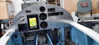

Still motoring along. I have the instrument panel cut, fitted and most holes cut for the instruments. In the old panel, the ELT panel was in a horizontal configuration (landscape?) but I want to install it vertical. Does anyone know if one can buy the stickers for the front? I am not opposed to installing it with the wrong sticker for now as I know I have seen them but can't come up with the correct google search words. I only find the whole panel.
As for the rest of the project, not sure what to report. It seems I am working on it but must be behind the scenes stuff. Removed brake lines and had stainless ones made up, ordered new snap bushings to reroute the trim cable mentioned earlier but waiting on those. Installed some cover plates in the bottom where old antennas were and had just been duct taped over. Cleaned up firewall (old grease, oil, crud. That was satisfying....:cool: )
I do want to take it off of the landing gear next to sandblast and paint the legs and engine mount. It looks like if I mill a 2x6 down to 1 1/4" x 5", it will fit above the torque tube. I could then just rest this on short saw horses or tall axle stands. I figured on marking the board and then drilling it off the plane so as not to damage the holes for the wing spars but figured I would ask if anyone has suggestions here? Not much weight in the plane now with engine and wings off, canopy off, etc. But, as usual, I don't know what I don't know so very open to input.
I will post some panel photos shortly, once I have more to show.
I found that where I wanted to put the ELT panel was a little too snug so I decided to go somewhere else in horizontal mode. Won't need to replace the sticker :)
Panel
Test fitted the instruments in the panel. It is still a work in progress but good to see the instruments fit. I placed some a little too close, which made bracket installation tough, but it worked out ok. The one remaining spot is for a clock on order from Aircraft Spruce.
As mentioned earlier, the right spot was intentionally left clear so that occasional and temporary use of an ipad, phone, etc will not interfere with instruments. I am considering putting my fuse panel behind it and installing an access door in that spot.

Nice! Good to get that panel where you are actually going to SEE it! Keep up the good work and letting us know....:)

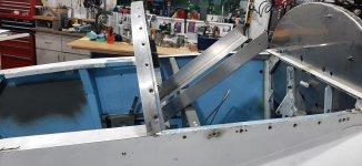

support for fuselage

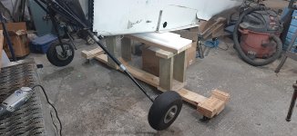

As mentioned earlier, I need to take the gear and engine mount off. Someone had suggested a board through where the spar goes but looking at it today, will just a low platform centered on the wing spar bulkhead and the one ahead of it be enough? I am thinking a foam pad on a wide sawhorse. Like a small table....
With the engine off and not much else in there, there is not much weight on the two bulkheads that i will be sure to catch. I just want to sandblast, inspect and paint the gear and engine mount. Having said that, I would hate to wrinkle anything of course.

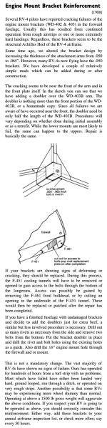

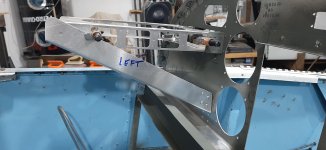

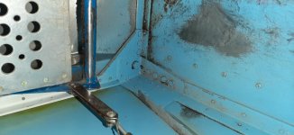

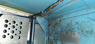

I have been working away on the project, despite the lack of updates here. The trim cable has been slightly moved and snap bushings installed through the bulkheads. New side panels from 2024 made to replace the mock up soffit material ones I had in place, brake cylinders removed, and cleaned up. I will be installing new pads, and discs.
I removed the engine mount and gear yesterday. Unfortunately, in addition to the wrinkles previously discussed, I found cracks in the firewall. I have found previous threads on this topic and the jest of them, of course, is further investigation to check the weldments, etc. I may be replacing the firewall. I have sent photos to Vans already for their input but suspect that they will tell me what we have heard before. Although the firewall is not considered structural, the cracks may be an indication of previous excessive stress. Will see what happens. This is as far as I have gotten so far. Well, more little stuff, but nothing exciting to report.

Regarding the firewall, Van's has suggested just stop drilling the existing cracks. Another friend suggested the same and then of course sealing them up. How hard is it to change out the lower firewall, should I decide to go that way? It looks like most rivets are accessible at this point but don't know what I don't know....

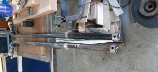

I also found one gear leg bent slightly. I sent an email to Langair about with cross border shipping, etc., it may be better to straighten it here in Canada. Is this something any well equipped machine shop could do or is there more to it than just press it. I read in a thread here about a 20 ton press so that should be no problem in my area. We have some good industrial machine shops locally.

Looks like you solved the “ sawhorse” option for supporting fuselage with motor mount and gear off ….any pictures of your solution ? Thanks
Fuselage
Yes. I did not do the wood spar idea just because I do not want to mess with the spar bolt holes. I also wanted to keep the idea of mobility while being supported, should I need to move the project a bit. So I just made some platforms that I secured to my existing dolly and put foam under the bulkhead which the spar passes through. I tapered the foam a bit after finding it kind of wobbly against the contour of the belly. I will not be climbing in the plane like this. I had only planned on it being like this long enough to inspect and paint the mount and legs. Unfortunately, it might be longer than I had hoped. Sigh....

A couple of thoughts for you...
We had an RV-6 that landed heavily many years ago and the result was two bent legs (among other things). The owner replaced both legs and I can tell you it wasn't fun to try and re-drill those top bolt holes. It took me an age and more than one drill bit. The risk of getting the hole a bit off is also another detraction from installing a new one because I'd be pretty certain your legs will have been hand-drilled, not jig-drilled at the factory like they are today. No sooner had we got the aircraft flying for him and he went and did the same thing again, but this time he took the legs to a machine shop and had them straightened. That aircraft is still flying today, 30 years later, with those legs installed.
In respect to the firewall cracks, although its a lot more work for you I suspect that it would be easier to remove the firewall and take the opportunity to beef up some of the structure you would then have easy access to. Clearly if the leg is bent the aircraft has had a bit of punishment, but it seems to me that the RV-4 is a bit light in that area and could do with some upgrades. I suspect that if you pull that firewall out you will find some other bits in behind there that are also cracked and need attention. You've gone this far... you might as well go the whole hog!. :) Easy for me to say... I'm not the one who is in there doing it. :)
Its going to be a great machine once you've got it back in the air. Good fun!
Thanks Mike for the input. I was able to find a friend with a large press that has no problem deflecting the leg so we started straightening it yesterday. I had spoke with Langair beforehand about straightening it. If I was in the states, I would most likely have sent it to him, but the added costs and time to ship from Canada set me on the path to attempt it here. Mr Langair gave me some input on the process, which was helpful, and my associates are pretty good in the field, so I think we will be able to take the bow out of it. I will report back. We just ran out of time yesterday.
As for the firewall, I also heard back from Van's, about replacement, and they reiterated that for a non builder, such as myself, it is quite the task to replace the firewall. They are not encouraging it at all, which suggests to me that perhaps I should not get into that. I agree 100% with you, but may have to compromise with a very thorough inspection of the associated parts. I am going to look at the job again to decide.
We were able to straighten the bent leg today. I would give it 90-95%...;)
It was certainly intimidating watching the counter bend (aka force) required to end up with an effect on the leg! I wish the press had a gauge on it but it did not. I always thought the legs looked "spindly" but seeing what it takes to take a bend out shows how strong they are! It also makes one wonder how the heck it got bent without doing more damage than previously discussed. Reinforces that I should and will be checking everything well....
My compressor has been down so I stripped the engine mount with a stripper which removed mostly, the paint only, but some primer. But, it did reveal the welds and so far, they all look good. The compressor is fixed so I can sandblast and start painting stuff, meaning reassembly is in the nearer future...
I am leaning towards not doing the firewall, but some more, indepth inspections are required before I commit one way or the other.

The engine mount is out for magnaflux inspection. If it comes back good, then there is one wear spot I will address, and then start painting and reassembly. Woo Woo!
I think your corner weldments are 2nd gen... just had a look at mine, kit #2062 delivered September 1988, and see that the lower corner is not one piece, but rather of a 2 tongues type.
Not sure, but I think to recall that material thickness was also increased.
Thanks Dan
I heard/read there was an upgrade on thickness of material used. You also have the side gusset plates and it looks like another plate on the firewall side that I do not have.
I am thinking you built according to plans or did you add mods that you were made aware of at the time?
Gotta admit I can’t remember for sure if those triangular pieces were in the plans, or mentioned in the RVator, or simply one of my mods… long time gone :eek:
Funnily enough I recall manufacturing them and bending the sides to match the longeron’s angle on them…
Maybe someone with a better memory chimes in?
I was just looking at the plans I have on hard drive and they show revisions up to 1996 but I see no mention of the larger gusset plates.
So, maybe the RVAtor....
Regardless, they seem to make sense and it is a good time to do it. I guess that is the next task.
Mid 90"s kit "new style"
While my RV-4 serial number is 2667, that was the early 90's tail. My fuselage kit was delivered around 1995, and I have the "new style" folded and welded longeron weldments. The original type had the split corners. The triangular gusset I have seen more than once, but don't believe it was ever in the kits, and I didn't install them on mine, and I payed attention to every Rviator I had..if I was building now, I'd probably put them in even if they are aluminum, as that lower corner takes a beating.

  • 2 more pics, 1 showing the weldments before paint, the other one showing the reinforcement plate from the outside
  • and the reference I found in the digital version of the RVator
Update
At this point, I am shying away from making mods to the weldment areas. Upon inspection of them, they all look good so whatever repairs were done seem well done. In talking with others, some say do it, some say don't. But since Van's does not support the installation of extra support, I feel like it should not be required. A good idea yes, but not required. That may change as the project goes on.
The engine mount was found to have a few slight cracks in it so it was sent for repair and more inspection. Waiting on that. While that was out, I was looking further at the bulkhead top piece behind the panel (F402C) It had been butchered and reinforced with smaller pieces of angles. I decided to fab a new one as per the plans. I had to dance around the previous rivet holes in the two vertical pieces for the new rivets, but feel better about the proper bulkhead in that location. I don't know how to calculate the strength of the pieces that made up the old one, but figured this one is better. You can see it in the photos below of the panel conflicts.
Until....that lead to conflicts with the panel which I designed not knowing that the bulkhead was incorrect or to be changed. I now have a conflict with my radio supports and the engine monitor. Good grief! :mad:
For the radio supports, it will simply be a matter of changing the location of the angle supports or making gusset plates instead of using angled pieces.
But the EDM350 rests up on the new bulkhead, and interferes directly with one of the connectors so this one needs more serious changes. My easy option is to interchange the engine monitor and one of the AV30's. Or, make a cover plate and change the configuration of the panel where the clock and EDM350 go. A third option of course is to install the EDM350 in that large area that I left clear so as not to interfere with a tablet. And fourthly, make a whole new panel....which ain't gonna happen...:eek:
What would you do?
