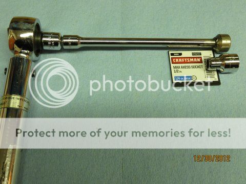

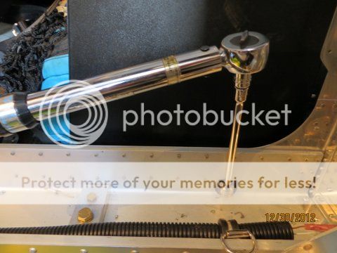

I just came up with an easy way to check the landing gear bolt torque
without removing landing gear fairings and F61275 cover plates etc, if
torquing from the bottom. I don't like using the crowfoot wrenches when
torquing from the top. There must be a better way.
I found a special extreme access 1/2" socket from Sears that I modified by
grinding both the bottom and top away as show in this photo. I then ground
off the male square part of a 1/4" 6" extension and brazed the two parts
together. I used a 1/4" to 3/8" adapter for my torque wrench. Works well.

Just what I was looking for! I refuse to torque them from the head.
Problem is, I cannot quite understand what you did and how you did it. Can you elaborate or expand your explanation a bit for us that are slow?
It looks like he made a very short socket that is able to get onto the nut in the confined space available. Good work John Sheffels.

Great idea JS. If you want to go into the socket manufacturing business, I can guarantee you at least one customer.
How to do it
1. First you need to purchase a Craftsman ?? MAX AXESS socket, a ?? x6? extension, and a ?? to 3/8? adapter. Cost is about $12.
2. As viewed from the 2nd picture, use a bench grinder to grind off the narrow neck of the left side of the socket, down to the beveled edge.
3. Grind the large right side of the socket approximately halfway, as show in the picture.
4. Grind off the male square part of the 6? extension.
5. Place the 6? extension into a vise with the ground part up.
6. Place the socket over the protruding part of the 6? extension.
7. Adjust protruding part of the extension so it is just slightly below the round inside edge.
8. Braze the socket to the extension.
