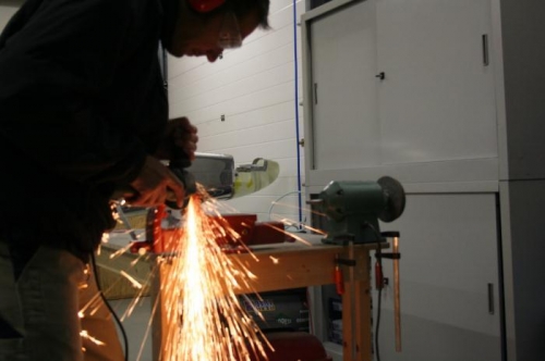

Step 32: Add bevels to the four corners of the U-1202 Outboard Main Gear Attach Brackets.
Has anyone done this yet, and if so, how? My first inclination is to take the grinding wheel to it, but my first inclination is almost always wrong.
Problem here is that I don't have a Plan B.
I taped off the 1/4" and used a grinding wheel. I polished the corners with a file and the scotch brite wheel.

grind the bevels
yes a grinder works great.
they parts get hot easily taking off that much material,
so go slow, I didn't quench mine because I didn't want any hardening of the material, I just did it slow.
then polish with scotchbrite prime and paint
http://2.bp.blogspot.com/-GH07KTZ49YQ/UHUK_e8IaII/AAAAAAAAAWE/hwgKOamWej8/s1600/IMG_6649.jpg
