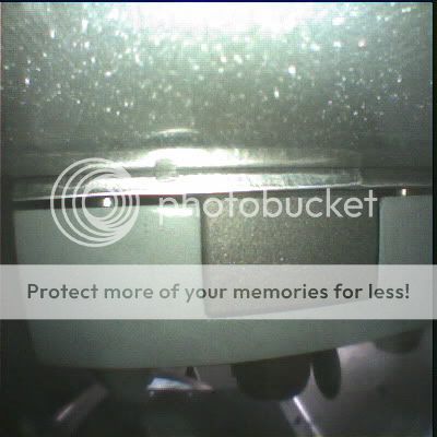

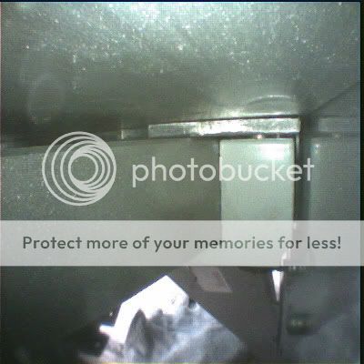

U1203 / U1202 Gaps
In working the gear SB today, I decided to take a look at U1202 and U1203 using a 3.9 mm VJ articulating video borescope. All of the bolts have been seated and torqued per the SB (no weight on gear). The AN6 bolt in the U1203 is a -23.
As you can see in the photos, the U1203 is fully seated thur the AN6 bolt area, however there are gaps between the U1203 and the U1203B plate at both AN4-22 bolts. The same gap appears on the U1202 - U1202B combination at the AN5-20 bolts. The gaps are uniform on both the port and starboard sides, as well as fore and aft.
Has anyone else seen these gaps, as in are they normal, or have I missed something in the assembly?
Thanks.

U1203 / U1202 Gaps
Thanks for the quick reply.
I read the "full contact" part of the SB as the U1202 contacting the U1202B wear plate and F1204 channel. I was expecting no gaps unless the U1202 was not properly torqued or one side was hung up on a rivet head. Perhaps a nominal gap value could be defined as a check.
The gaps in the U1203 are not mentioned in the SB or revised p35-03 (rev 2). Again, it may be helpful to specify a nominal gap value as a post installation final check.

Nope, it means check that the U-1202 is in full contact with the gear leg. The way to confirm that being to verify the gap is equal at each end. No nominal gap measurement is really needed since all you need to know is that there should be a gap, and that it should be equal at both ends.

John -great pics! 2 questions - do you think you could have marked the lower wing edge skin for "shaving" on initial removal if you had these pictures, and avoided the reinstall for that purpose? And, what special tools were needed? I have the same right-angle chuck and two step drills starting at 1/8 inch. I do not have a "long" bit other than a #30.
Thanks so much John for recording and sharing the process. It sure helps us who are anxiously awaiting our turn at it.
