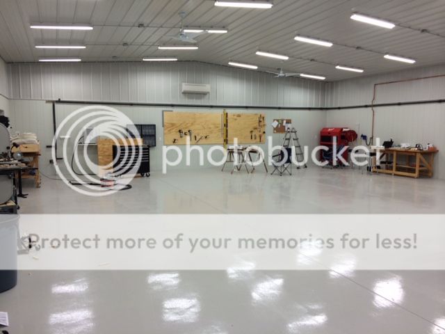

Andy,
You're welcome to borrow a little room from me. I normally keep the shop around 60 degrees. I'm guessing I'm 20 - 25 minutes north of you.
I'm just starting on a 14. Could use a bit of advice, tutelage, and would share a cup of coffee.
Send me a PM if you're interested.

Andy,
Fred
Fred...:eek: Does that extend to Canadians? I'll come use your shop!!!:D
