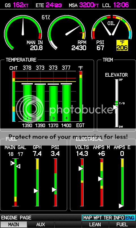

I got some screen shots running LOP, but left the cards in the airplane. Hope to post them soon.
LOP screen shot from the other day, with the throttle pulled back my EGT/CHT spreads really even out. 8000 feet density altitude, around 85 F on the ground. 50-80 * LOP, my EGT's peak right about 1450. With the increased OAT's I haven't noticed the decreased CHT's of 330 I was seeing at 40* OAT.
With the mid 80's my CHT's/oil temp has been on the rise. I believe I did a decent job at sealing with the baffles etc, any tweaks I've done to the baffle sealing didn't show any noticeable difference. Thanks to others on VAF I decided to make a cowling exit bump/ramp.

I'm back in business!! Everything was put back together, weighed and test run in time for lunch at 4:00.....
So far everything seems to checkout properly, I still need to calibrate the AOA and tweak the autopilot settings. Kinda surreal watching the autopilot capture an LPV approach with the boxes I wired in an airplane I built cruising down to 200 feet. For this guy it wouldn't be possible without the people that make up and visit VAF everyday, many thanks to many people.
