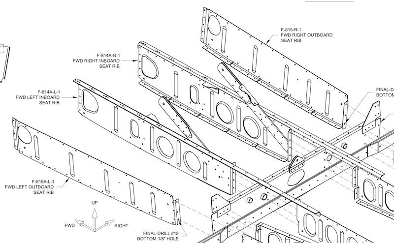

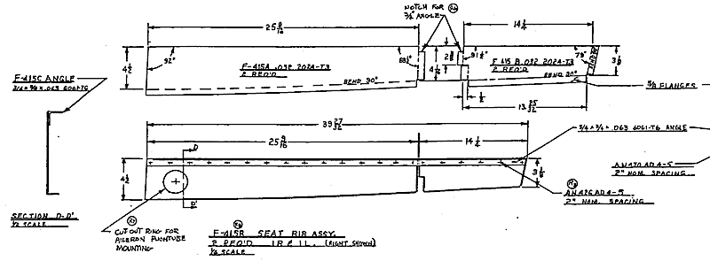

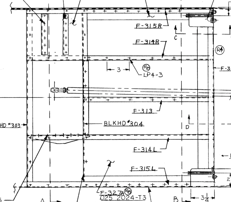

I always thought that pan was there in case you wanted to wear a "sit on" parachute for doing aerobatics. Might be worth incorporating "easy removal" into your design.
I won't be wearing the old-style seat-type parachute. If I wear one at all, it'll be a back cushion type. And the seat pan change is permanent.

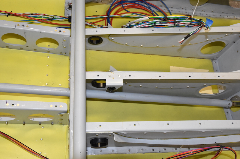

Frankly, I don't see what the fuss is about. Here are the RV-8 seat ribs, for example:
And closer to the RV-3B heritage, here are the RV-4 seat ribs:
The pictures are also lurking here and here.

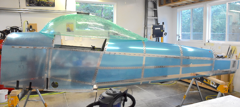

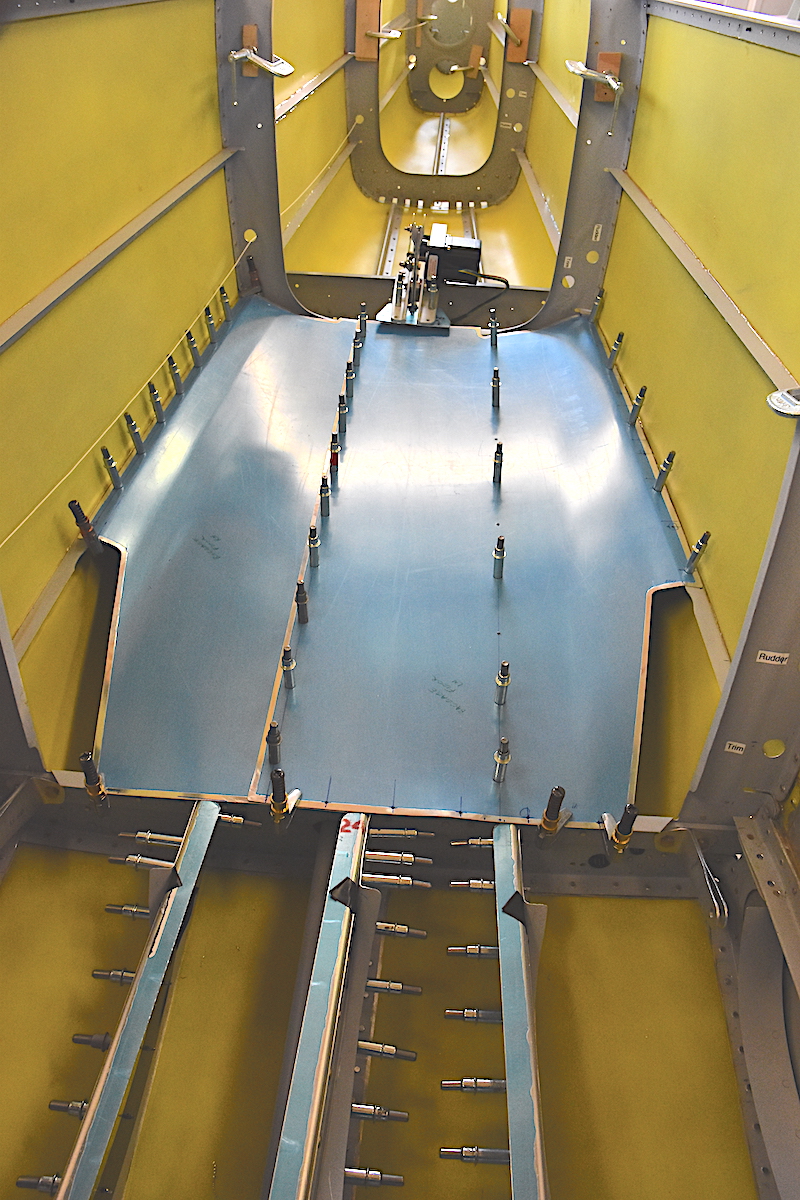

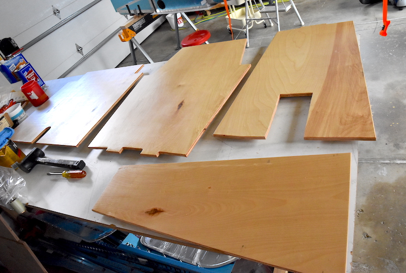

I bolted the engine mount on again and rigged the right gear leg and pilot-drilled it to 1/8?. This photo shows the drill guide I used - I made it. Later, Rick drilled and reamed it out to .311, and the close-tolerance straight pin is a tight fit.
After double-checking that the seat pan and baggage floor patterns that I?d made actually fit, always worth doing, I cut them out. The baggage floor is in two pieces to make them easier to remove. After some work the pieces are deburred, bent and clecoed in place. The flanges were bent before the overall curves, and those were bent before I drilled the holes.
I didn?t mean to, but the landing gear and the floors are going on at the same time. Actually they take turns, but they?re both up for attention now. At the moment, the floors are getting some work.

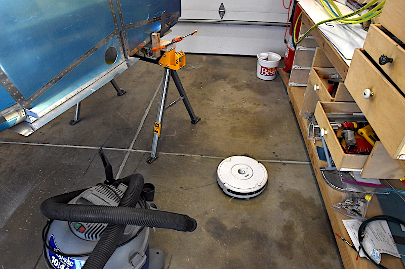

Thought you?d like to see one of the shop tools in use. The shop vac in the foreground is probably the most common tool that I use since I hate to track aluminum into the house. Once in a while, though, I let the Roomba robot vacuum run around and get the bits I miss. I replaced its battery and it seems to go on forever now.

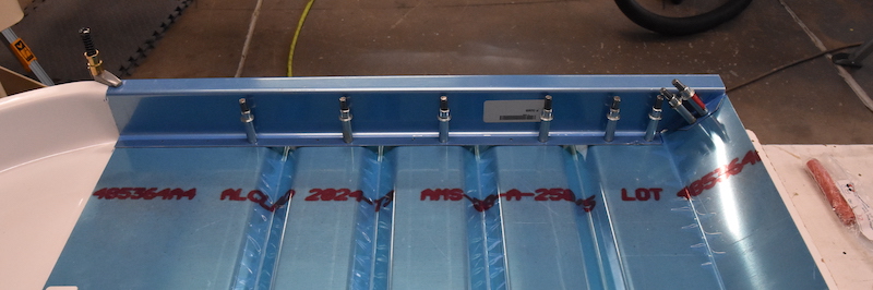

Now both the seat and the baggage floor are pilot-drilled.
After this, I removed these and drilled the substructure for the nut plate mounting screws. No photo on the holes, and the hardware is on order. I did remove the flat seat ribs and added the nutplates to these, as it was easier to do that then do them in place.
With both landing gear legs drilled to the engine mount, I located and pilot-drilled the U-403 brake mounting fitting to the axels. Then, Rick and I drilled its mounting hole. The drills used were, in order and in inches, 1/8, 3/16, 1/4, N and finally the .311 reamer. I forgot to get a photo, but there wasn?t anything especially noteworthy about the set-up. Rick made some aluminum vee-blocks, which did a fine job gripping the axle. The 1/8 bit was in the pilot hole, which was just deep enough to locate it. We eyeballed the bit for verticality, rotating the axle as needed, and then went ahead and drilled it.
The landing gear is all going back to storage as I won?t need it for a while. The reason all this took place now was merely because it was easy to align to the fuselage at this stage. I?ll all in favor of making things easy. Besides, it's so much easier to rotate the fuselage when the gear legs aren't on it.

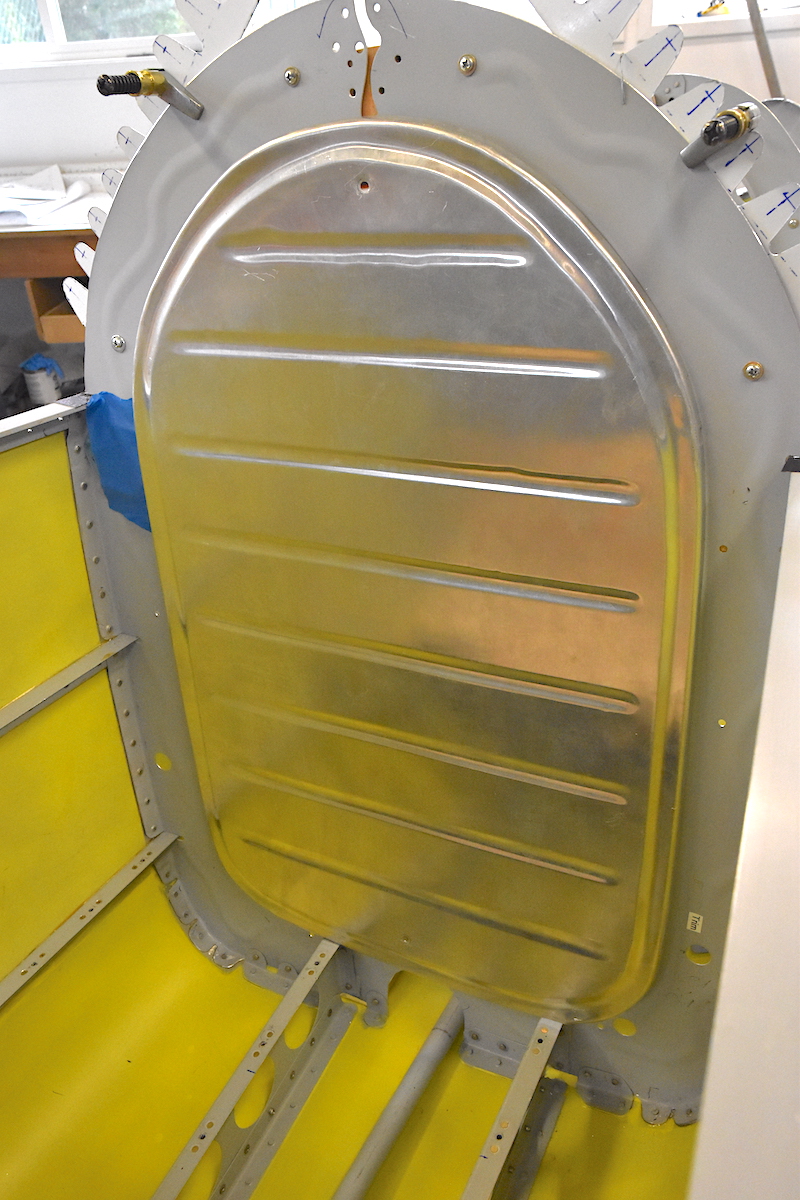

Here is the final seat riblet being glued in. I’m using a small heater to keep the epoxy warm and speed the curing.
Since that photo, I riveted them all to the factory seat ribs.
All the seat and baggage floor nutplates are finally riveted in. I thought that I’d need blind rivets throughout and ordered them for the job. But there’s enough access on most of the nutplates that I could squeeze regular rivets instead. Didn’t even use oops rivets. Instead I dimpled the nut plate tangs and dimpled the flanges of the ribs and bulkheads. Wasn’t a problem.
Well, not all of them. Some did need the blind rivets, those are done, and one location needs a one-lug nut plate, which I don’t have yet. But all the rest.

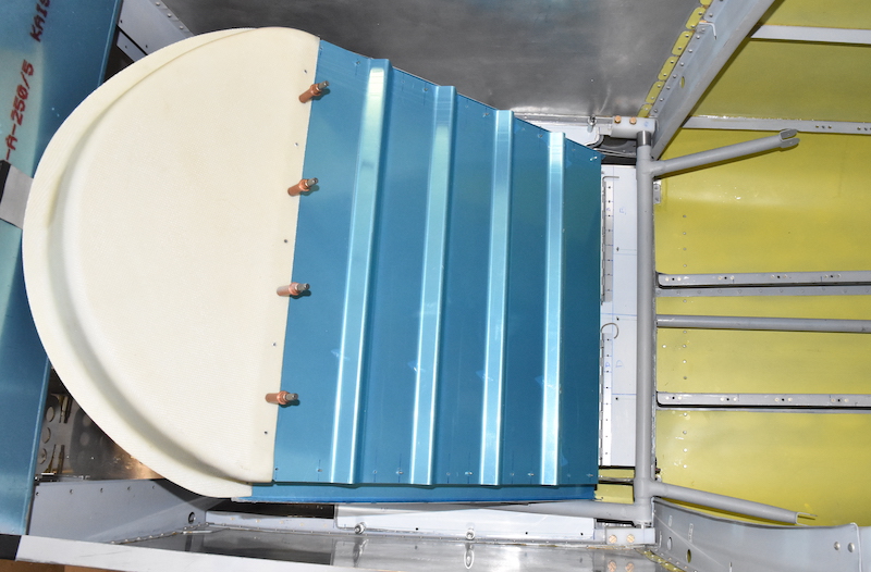

I formed the bottom ends of the seat back and drilled the pilot holes for the sides. That all was fun and went pretty quickly. Turns out that the formed fiberglass sear back top doesn’t fit very well. The bottom is bowed and the sides are too deep, and all that was on record in a build log about ten years ago. No change in the glasswork since. My kit is 2012, for reference, and even then it was a few years.

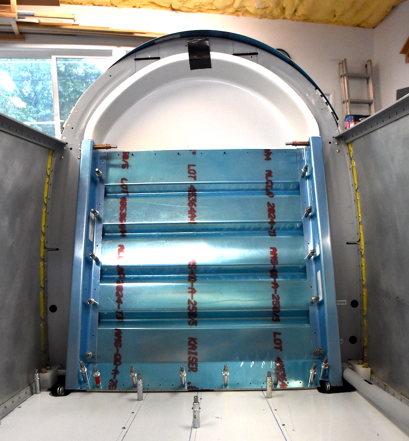

The seat’s positioning will need to be carefully done. In this photo, the flap weldment is simply placed in there in about the right position, and so is the seat. These will need to move around slightly, but it does give you an idea of the fitment situation.
Later, I bolted it down to ensure it's correct location, and discovered that I'd located the LH seat belt anchor in the wrong position - the flap handle interfered with it. Look carefully at Drawing 24, in the lower right corner. The two anchors are spaced differently, and I hadn't caught that. Email is in at Van's asking for advice.
One thing I was worried about turns out to be a non-issue: how to locate the holes in the fuselage bottom for the flap rods. With the flap handle in the full up position, there's absolutely no doubt where to start cutting. The fuselage is practically begging "here, cut here!" Later, though.

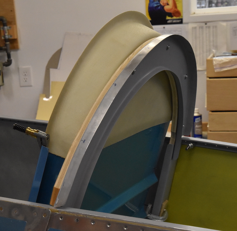

The seat back top is the white gel-coated fiberglass. I understand that the pink fiberglass is a newer generation, and the gray ones are the current newest. But for the RV-3 small parts, we get white. Regardless, it’s all doable.
More importantly, the as-received and as-drawn seat back seems to be 2.5” to 3.0” too high, also mentioned in a build log. Here it is from the front.
And from the rear side.
This is about where the seat back top needs to go. It should nest in the seat bulkhead like this.
To get that position, the seat back’s position will need to be carefully arranged.

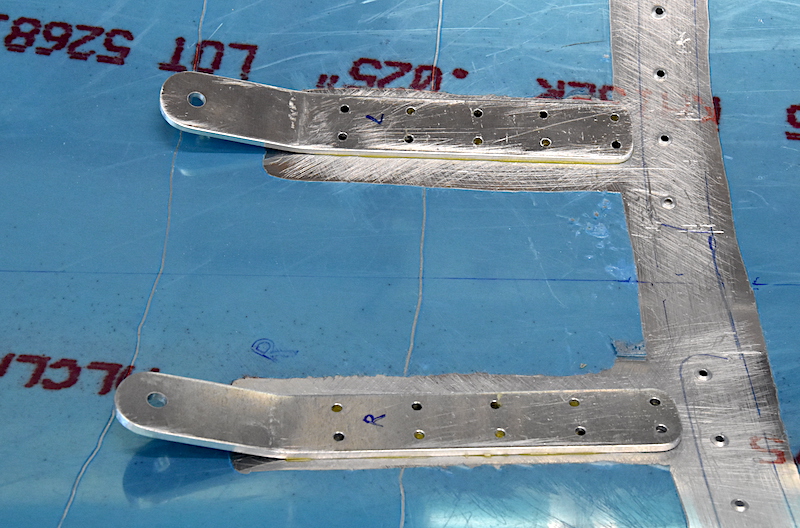

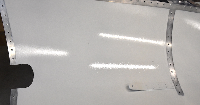

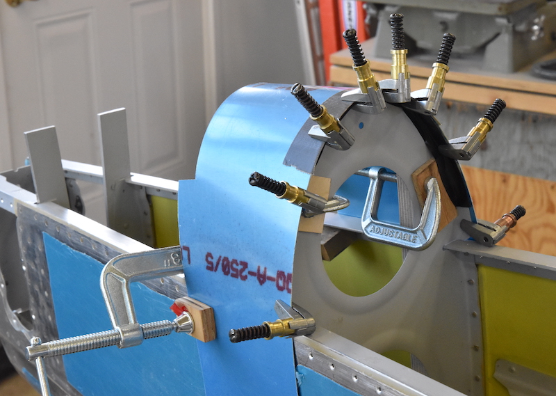

Mostly I?ve been working on the flanges of the bulkheads for the top tailcone skin. The skin is F-323, for reference, and it?s .025 thick.
As Paul Dye noted during the construction of their RV-3B, the top sections of the tailcone flanges don?t really fit. At the longerons, they?re too narrow, all of them, and elsewhere they?re either too high or too low or poorly curved. First, I tried to correct the F-305 seat bulkhead and then the F-309 bulkhead, the aft most one that this skin attaches to.

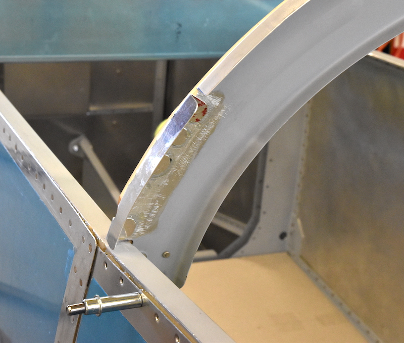

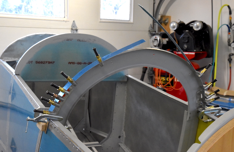

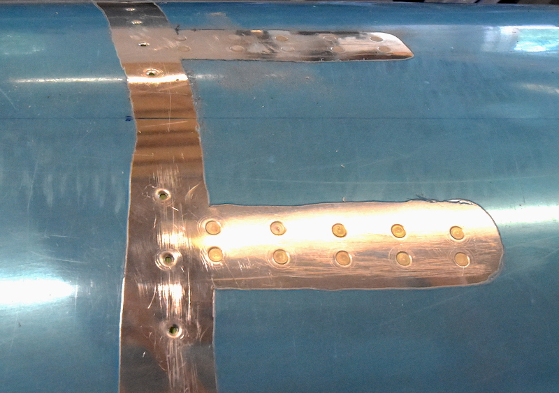

Here?s the before and after photo of the seat bulkhead flanges at the longeron. The rest of that bulkhead isn?t too bad, and will be accepted as is.
The aft canopy latch goes through this one. It goes right through that gap between flange segments.

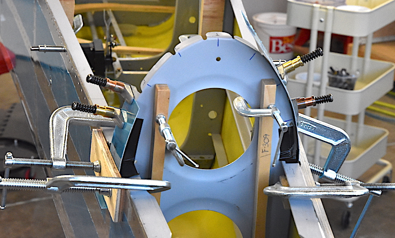

Then I did the F-309 bulkhead flanges. These needed thickening, not much, and rounding. I started with the areas adjacent to the longerons and filled the small gap with a thickened G-flex epoxy. It?s the same epoxy I?m using elsewhere with some flox and aluminum powder added for hardness. All it is, is a bit of a shim.
That worked out so well that I did the same thing to add some roundness to the too-straight flange segments. You can see that the topmost flange is essentially flat. I arranged the aluminum form so that it faired to the fuselage shape and at the top, faired to the seat bulkhead forward.
The blue vinyl is a decent release surface all by itself. To make certain, though, I put a couple coats of paste car wax on it. It came off with no problems.

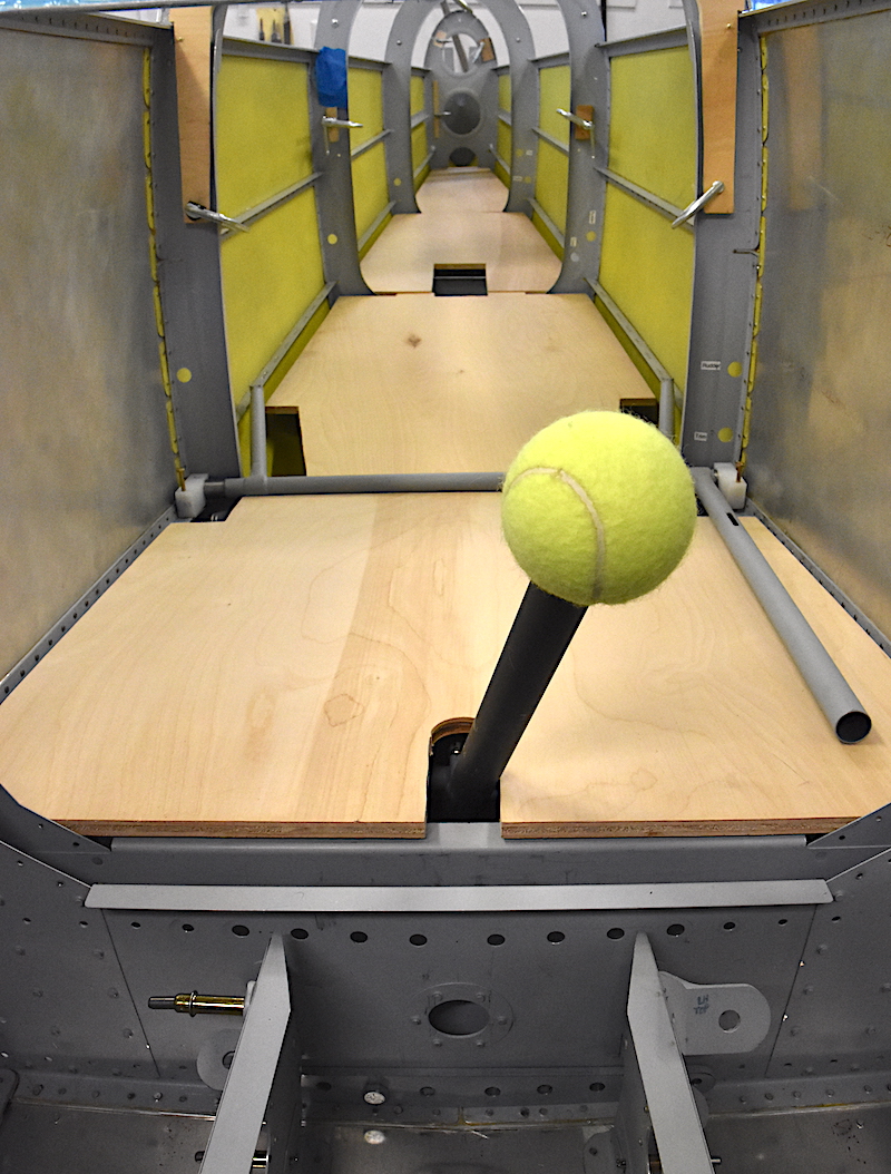

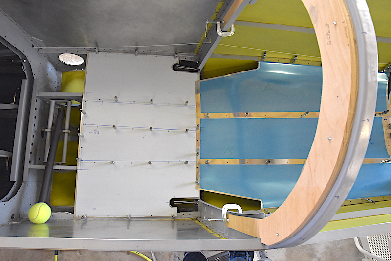

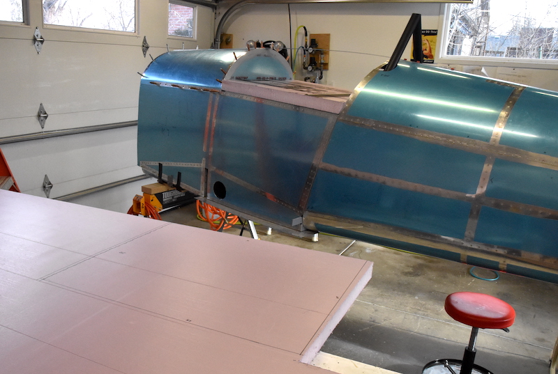

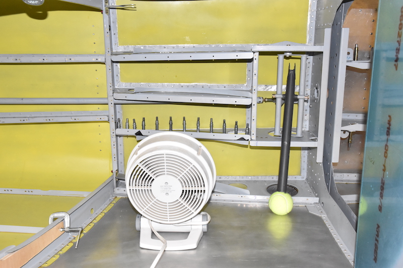

The plywood work platforms that I?ll need to squirm into the tailcone are all cut out now. I realized that although the flap weldment is not yet installed, the work platform needed to clear it when it was installed, too I had to trim it. Having flat seat ribs makes supporting the platform a lot easier in that area. Remember, on this airplane the seat pan is removable, so the platform could be handy one day.
The tennis ball protects the area around the control stick when the stick moves around. This sometimes happens when I roll the fuselage around. With a 1? hole the tennis ball goes right on.
So far I?ve only got part of one of the new flange strips cut out.

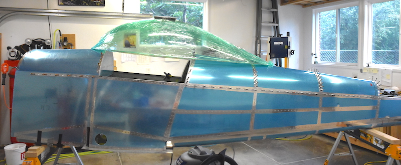

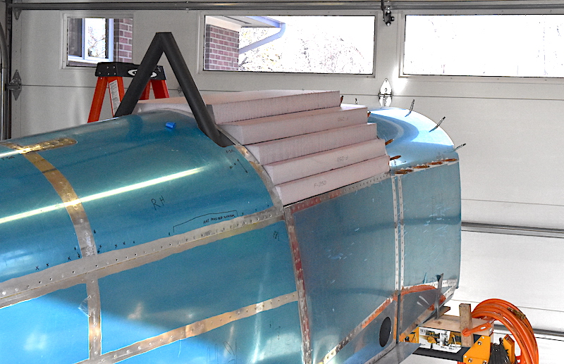

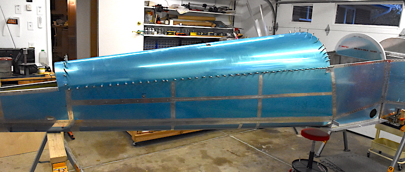

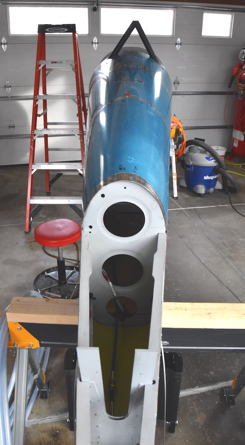

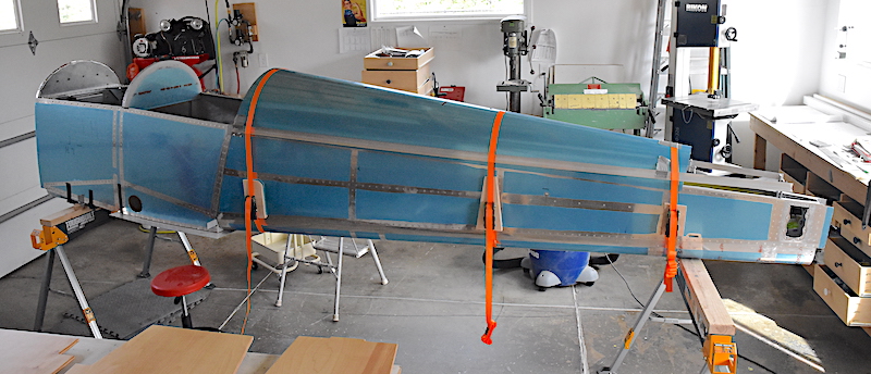

I strapped the tailcone top skin in place and was mildly surprised that it?s big enough. And even better, with some straps and cheap angles, it fits without needing rebending - the first curved fuselage skin to do so.
Here?s what the cave looks like. You can easily see where the new flanges will go and why they are needed.
Unfortunately the work platforms aren?t completely finished yet. It?s unfortunate, because I believe that the top skin is currently where I?d like it and I?d like to back drill some holes, and it takes climbing in the cave to do that.
You know, I?ve been thinking that I missed an opportunity to make the platforms fit the sides. If the fuselage was rolled on its side, there would be more width but less height and it might be easier to back drill the rivet holes. On the other hand, they'd be useless once I got the wings on, wouldn't they?
The work platforms got a final coat of finish after I took the photo, but it?ll be a day before they are dry enough to work on. I?m using Minwax?s polyurethane varnish. I?ve got plenty of experience with the product, with several of Minwax?s line, actually, and am happy with it. Their products go on well, cure quickly and are durable. And the best part is that I had a can on hand from a different project.

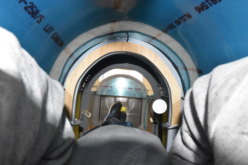

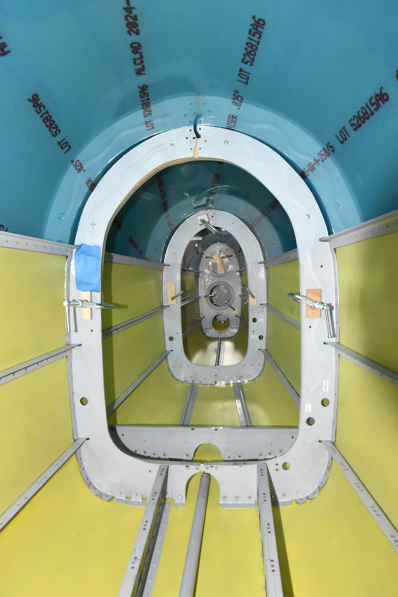

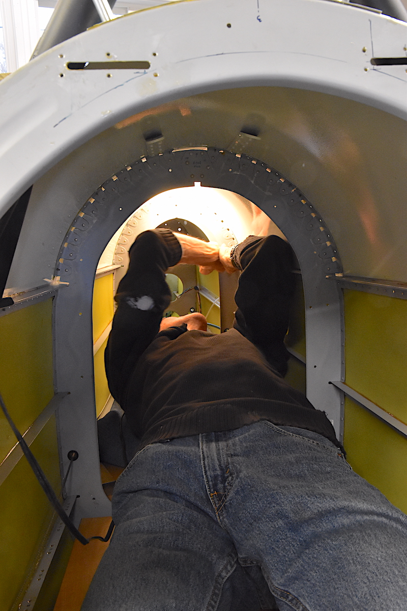

Deep In the Cave

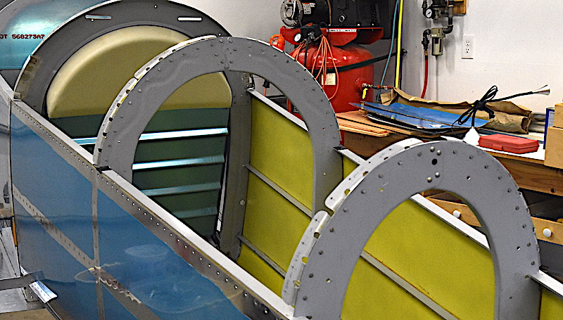

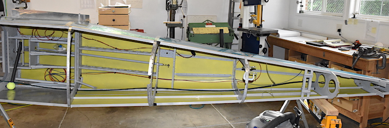

Got to say that it?s getting narrow in here. The cave is the tailcone; I?m in it as far as the F-309 bulkhead, where my shoulders are wedged. The gray things on either side are my elbows and arms as I was holding the camera over my head. We?re looking forward.
The bright white circle is a lamp. It?s off right now but its reflector did a good job with the camera?s flash.
You can see the back side of the F-308 bulkhead, then the seat bulkhead, and out in the open, the instrument panel. It ought to be apparent why RV-3 builders need to remake the fuselage bulkhead flanges. And if you look closely, you can see that the F-308 bulkhead still needs to be joined - it?s splice plate is made and drilled but not installed.

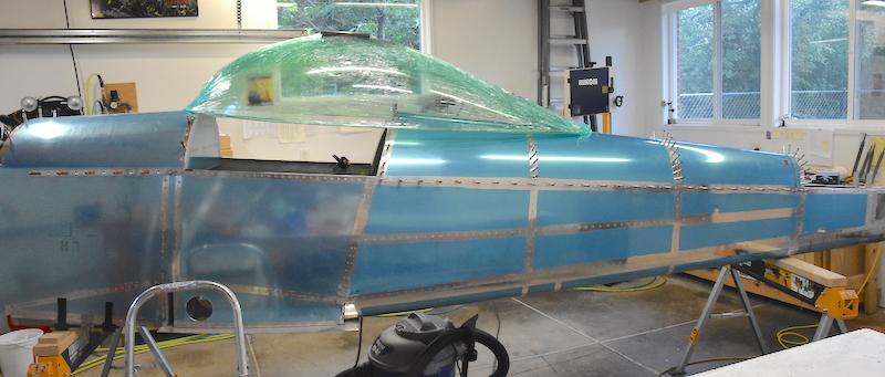

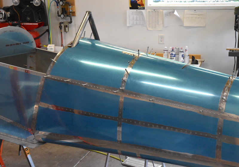

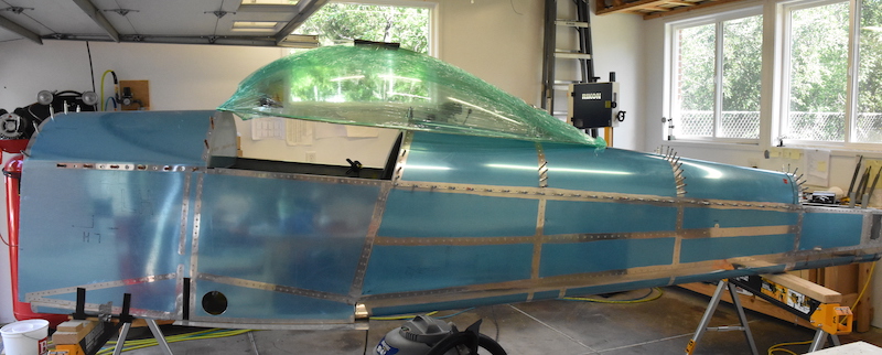

Right now, the top tailcone skin is clecoed from the front back to the F-308 bulkhead.
Just thought that you might enjoy the view from the cave.
The photo is also here.
Dave
Tonight, I crawled into the tail area of the fuselage to back drill the rivet holes from the front and back bulkheads and the longerons into the top skin. Since there are no flanges on the middle two bulkheads, F-308 and F-309, all I did was the perimeter.
From the work platforms, I could drill back to about the static ports, maybe slightly farther. For the aft-most, I figured that I could round up one of the neighbor kids. It turned out that with a longish bit in the 90 degree angle drill, and some effort, I could drill the aft-most bulkhead and the nearby longerons through that bulkhead.
Yes, somewhere deep in the cave, I made a blood offering to the gods of the sky. Did not plan that.
Some trimming will be required.

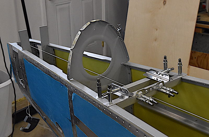

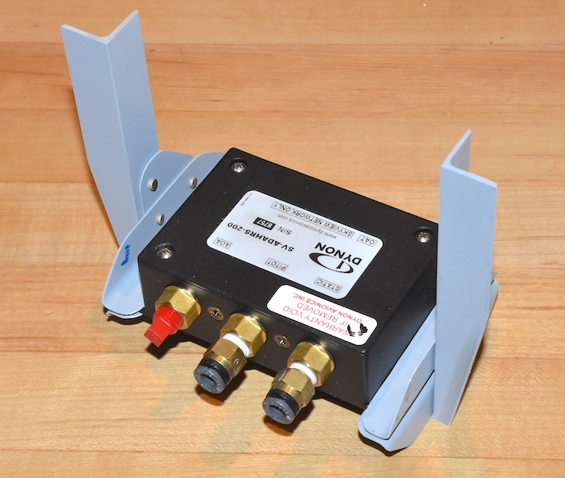

With the help of my mentor, I made a list of things that need to be done before I glue the turtledeck on.
1. Cut the slots for the shoulder harness. They need to clear the as-yet undesigned canopy frame.
2. Install or at least prep for the transponder antenna. Install the transponder mount if access will be restricted later.
3. Make and fit the baggage compartment aft bulkhead.

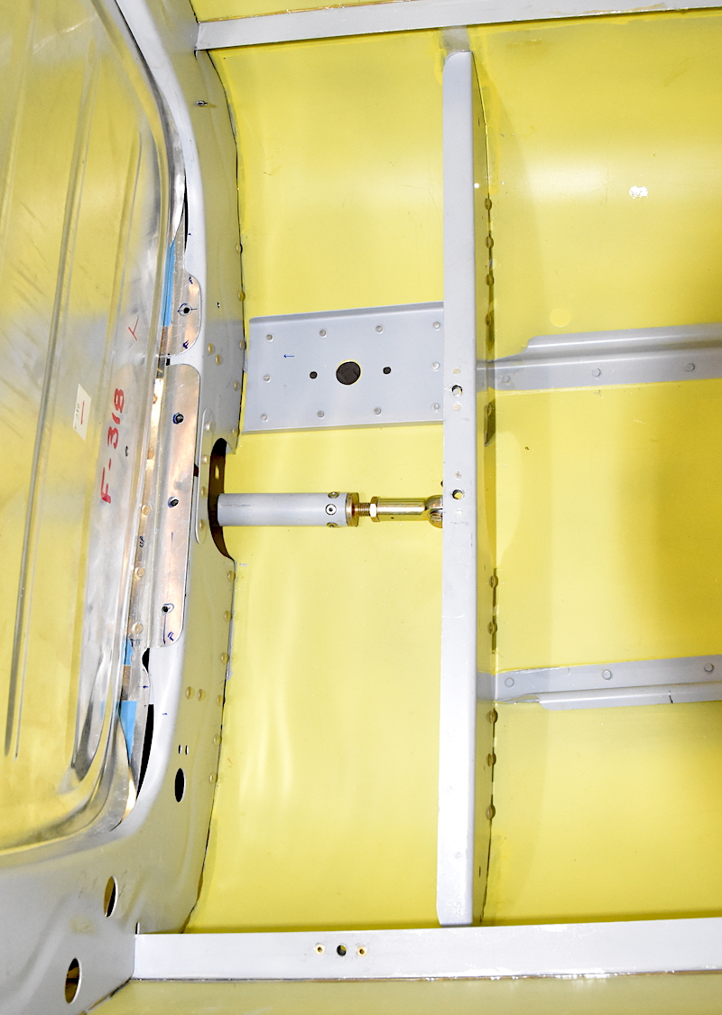

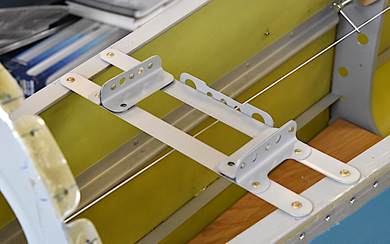

4. Install the ADAHRS mount and maybe the ADAHRS, too, depending upon access.
You might recollect the ADAHRS brackets I’d made earlier.
It was intended to rivet these brackets to the aft face of the F-308 bulkhead, fairly high, so that it would be out of the way for cave access and away from magnetic interference. Turns out that while it would function fine there, mounting it to the 1 degree alignment accuracy would be a very iffy proposition, perhaps more frustrating than fun. I’m only building this plane for the fun of the project, so I need to design something easier to align. As the project progresses, my frustration tolerance has not increased. I’m just more used to it. It looks as if I can get the ADAHRS close enough to the tail for access through the F-309 bulkhead, the one at the top front of the aft shelf, if the elevator pushrod isn’t in the way, which I think it might not be. It appears to go through the next hole down. The ADAHRS would be accessible through the bulkheads’s top lightening hole.
After considerable hand-waving and playing around with pieces of angle, I came up with an ADAHRS mount that has the reliable alignment I wanted and continues the slide-in removal feature of the first version.
It is easily removable through that top lightening hole, as hoped.
The photos are also here, and here, too.

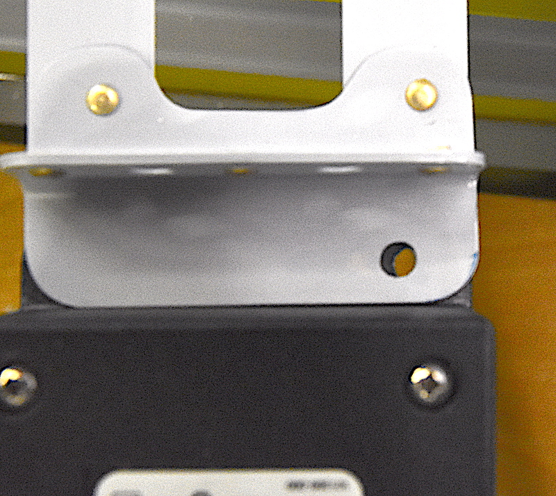

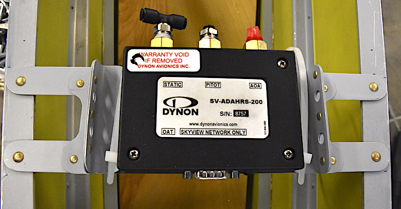

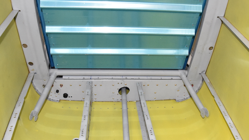

The ADAHRS mount is complete and aligned. This photo was taken after riveting.
You might have been wondering how I?d hold in in place, and assumed I?d put screws through the holes on the flanges. That probably would have worked but it wasn?t my plan. I felt that it would be too hard to install a screw and a nut, probably nylon or brass, with one hand working through that bulkhead hole. If you look into the hole on this photo, you?ll see that it?s terribly misaligned.

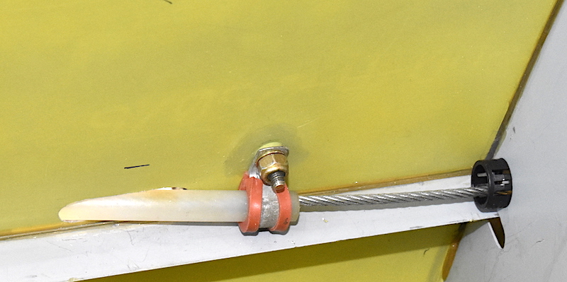

The misalignment was intentional. The idea is to thread a ty-wrap through it, around the front of the unit, and snug it up from the back. This can be done, I tried it, but it isn?t all that easy. But it works. The ty-wrap pulls the ADAHRS forward against that front stop, which serves both to locate it in yaw and position it longitudinally. There?s a ty-wrap on both sides for a little extra security. This is shown with loose ty-wraps in the next photo.

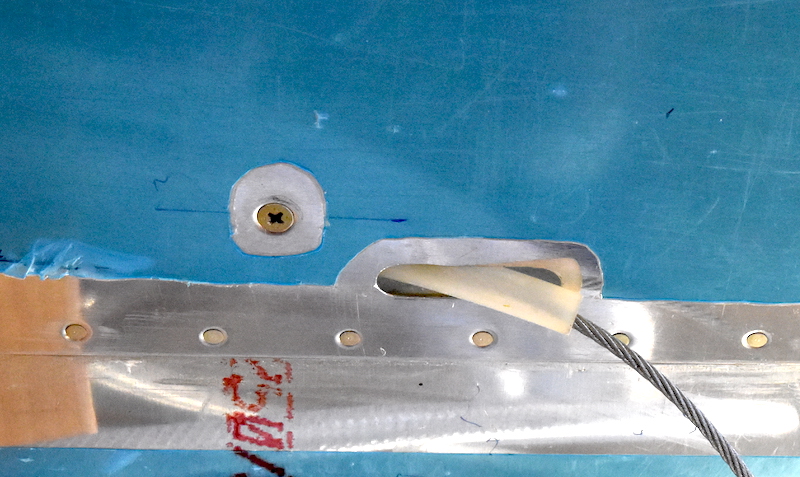

The left-hand seat belt anchor was mislocated originally. I moved it inboard to a new location, after getting some advice from Support. Thanks Van?s - seven years after buying the kit, they?re still supporting a discontinued model.
And finally, I figured out where to put the outside air temperature sensor. I understand that there are as many opinions about this as there are RVs, so I took my mentor?s advice, and placed it on the F-310 bulkhead, at the forward end of the aft shelf. It?ll be under the tail fairing and easy access to the nearby ADAHRS.
The secondary photo hosting is at here, here, here, this place, and yeah, here, too.

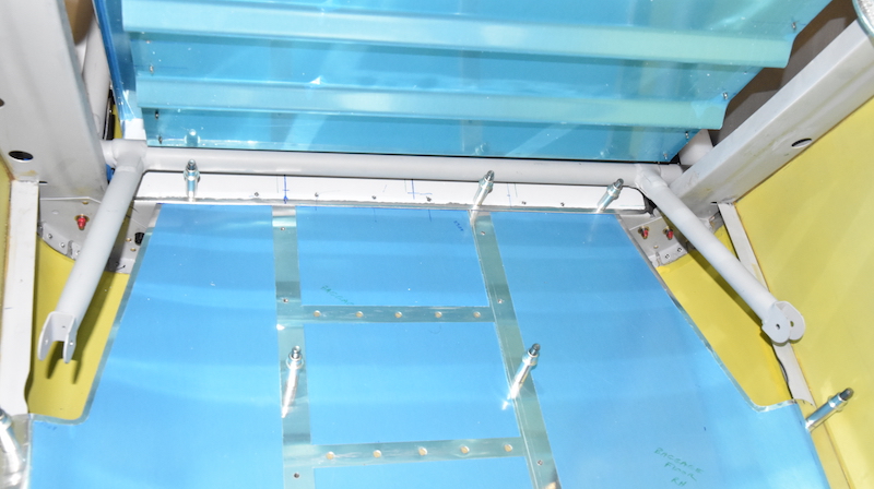

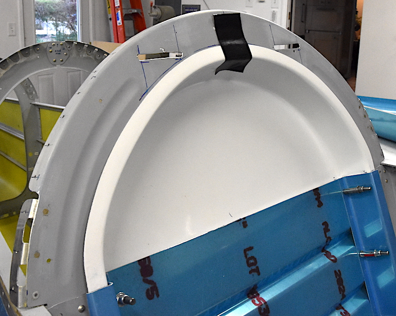

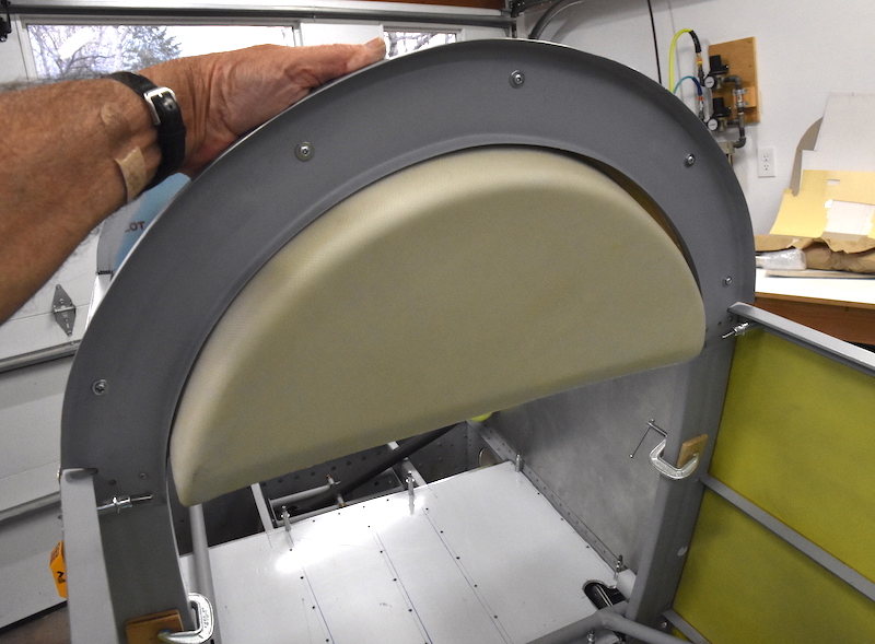

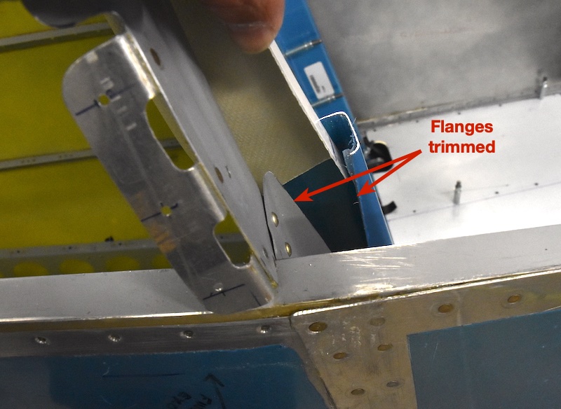

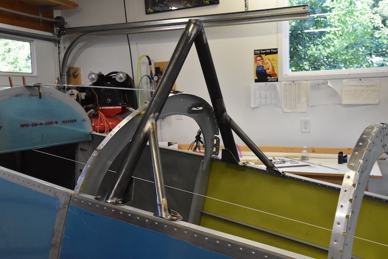

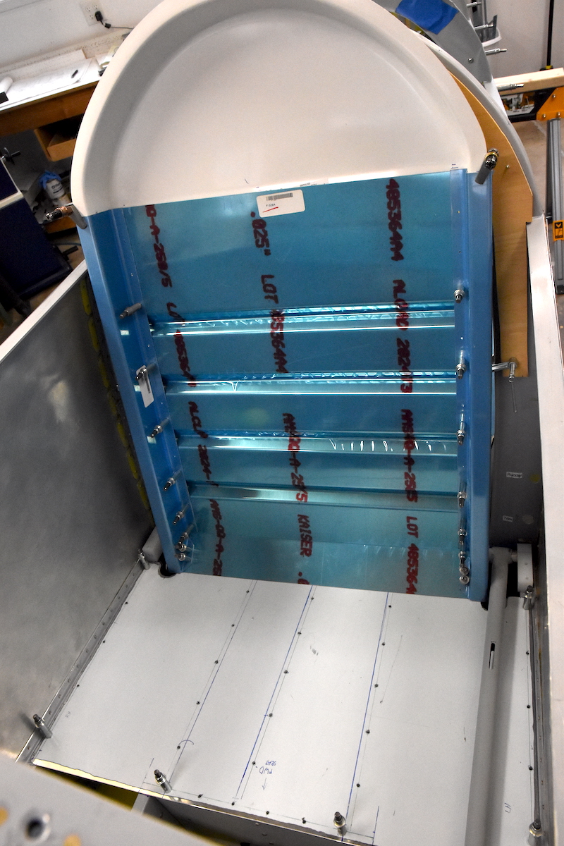

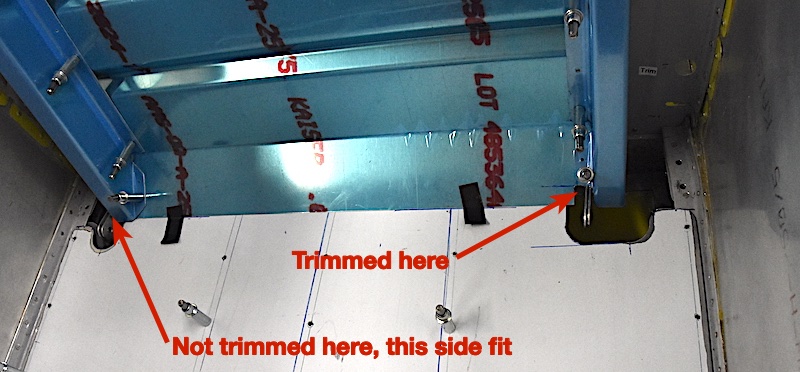

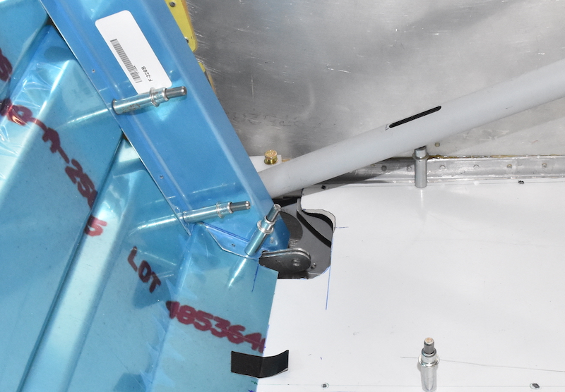

With the seat belt anchor relocated, it was time to adjust the seat back so that it clears. A slight bit of carving on that 45 degree flat area and that was done. When I went to fit the piano hinges, I found that the good extruded kind had mysteriously lost its pin. A replacement pin is on order.
The upper end of the seat back side rails needs trimming and the inside of the seat bulkhead, too, to allow the seat back?s fiberglass top to fit into the upper part of the seat bulkhead. For a relatively simple part, the seat back sure wants a lot of miscellaneous fitting. Worth mentioning is that the top of the F-328A seat back is approximately 2 1/2? too high and also needed trimming.
Here?s the bottom. Only the left side needed trimming, the right was fine.
This shows the flanges of the seat back rail and the bulkhead. Both need further trimming.
After placing the fiberglass F-328C seat back top in position, I was able to draw the area of the bulkhead top in which the shoulder harness slot gets cut. You might remember that I?d left that till now just in case, following one of the RV-3B Build Commandments: Do not do anything until you must. The other one is: Do what you can early because you might not get access later. Yes, these conflict with each other, part of the fun. In this case, waiting was worth it.

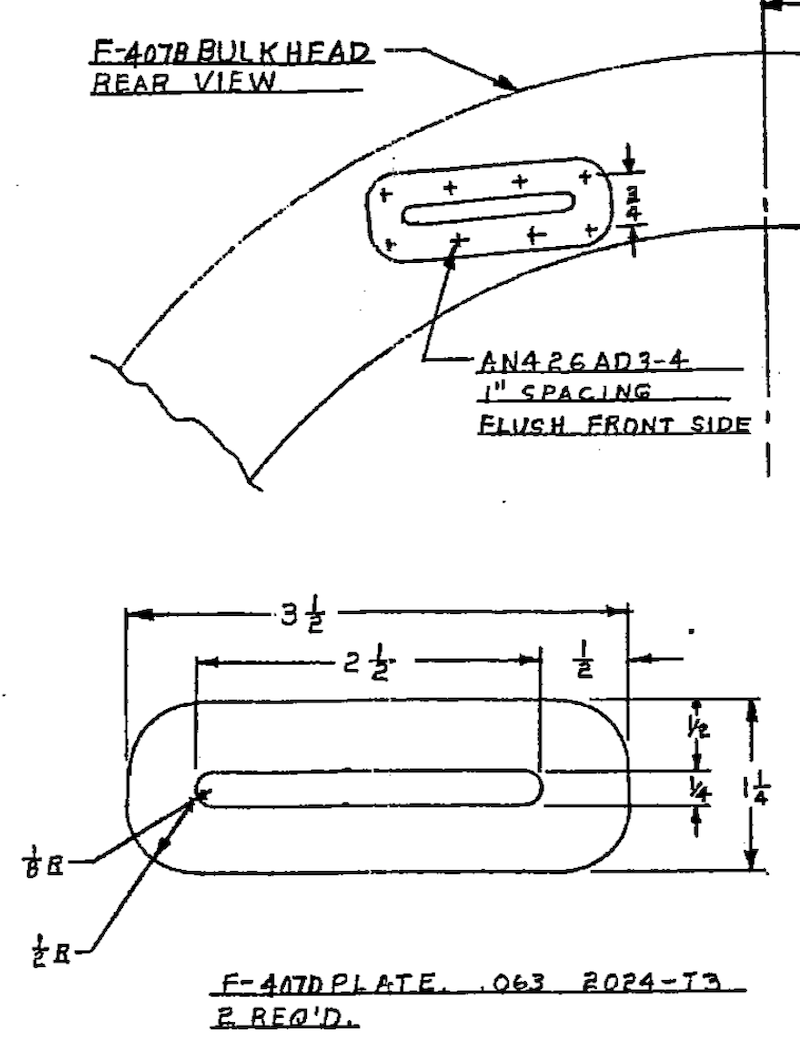

The shoulder harness slots are detailed on drawing 21. The local reinforcements looked annoying to make. The RV-4 plans show that part in more detail as F-407D, which is a DIY part. If you want to make the part, follow that drawing. It?s not on The List of parts that Van?s sells, being a DIY part on the RV-4, too. ?The List? is their nomenclature, not mine, if you?re not familiar with their parts ordering system. Fortunately I?ve got the RV-8 plans as well as the RV-4 plans, thanks to their handy flash drives. The equivalent RV-8 part is F-807D-1, for $2.40. Hoping it?s the same part, same fit, I ordered a pair. We?ll see.
This shows the F-407D detail.
I placed the slots horizontally rather than aligned with the curve of the bulkhead, thinking that my shoulders, sag though they will, are closer to that than to the bulkhead curve.

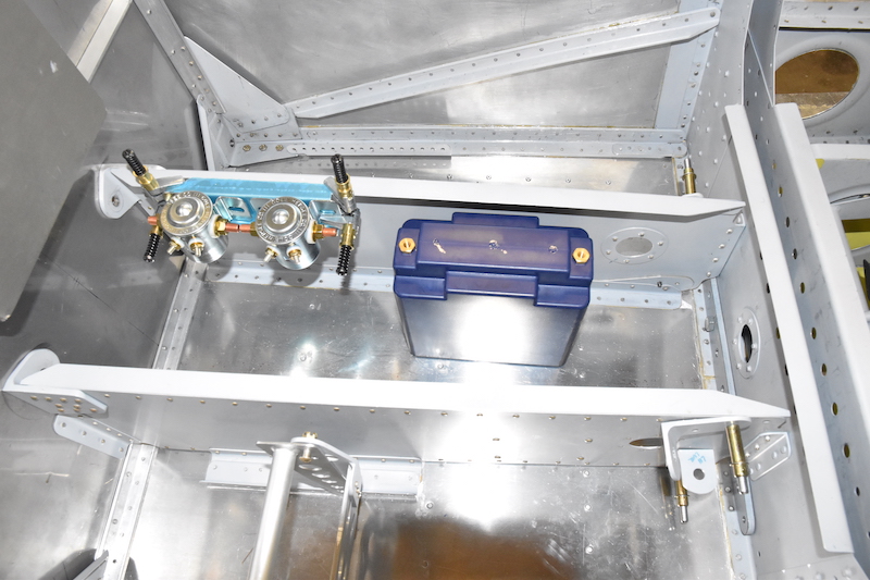

A while ago, I?d made a cardboard mock-up of the EarthX battery. More recently I found that they sell an empty battery case, so I bought one. Good service - it came the next day; they are somewhat local. Tried to find a place to fit it and hold it down, a place where it and the contactors are reasonably close and not immediately adjacent to fuel lines. Have a partial plan but it?s not this one. This was one of the options I did not choose. It placed the parts within a few inches of the fuel lines.
That?s the firewall and its recess to the left, with the spar bulkhead on the right. The battery case is resting on the forward floor. One rudder pedal is just visible at the bottom. The contactors are shown upside down, as I learned after I'd taken the photo. They are rather close together only because the bit of scrap they're clamped to here, was that long. This was just to assess the location and mounting.
