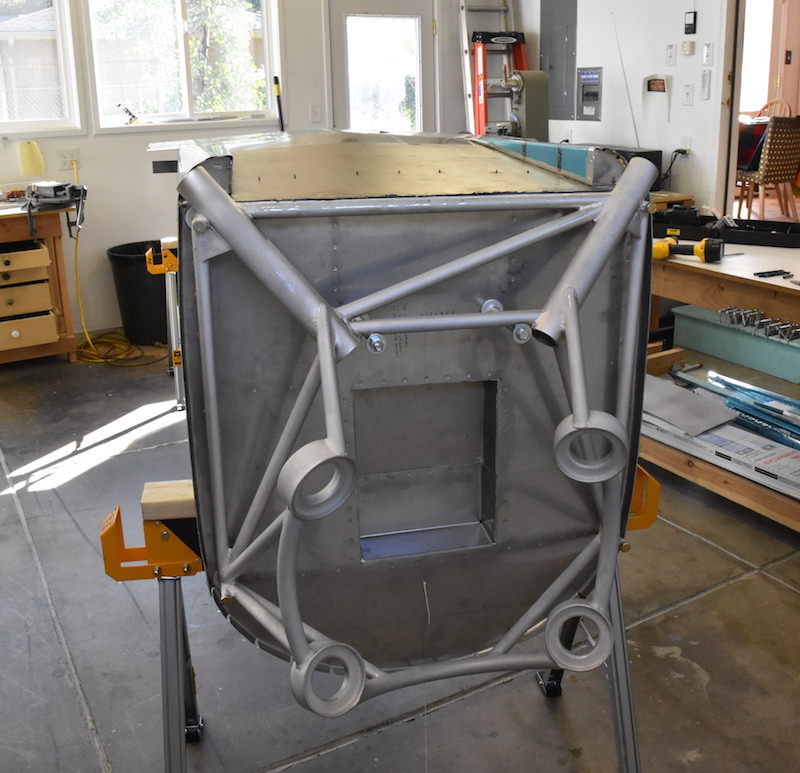

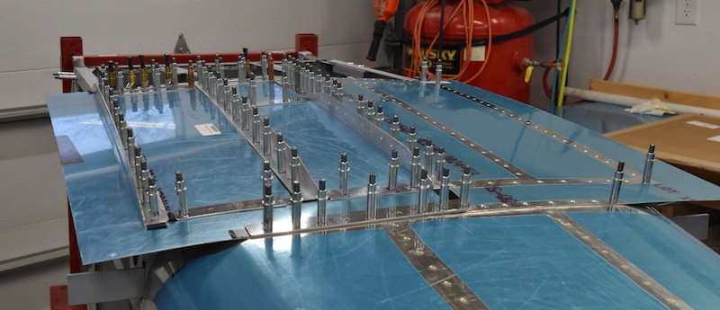

The things I've done in the last month are small stuff. I'm getting ready to attach the next long side skin, and while it's still off, wanted to do some of the smaller stuff. These are things like riveting those bulkhead flanges that I made to the bulkhead's webs. These are finally done, along with a few less exciting things.
Since I'm waiting on a few things before gluing the side skin (it's the right one this time), I started on the belly skins under the seat. There are two of these, F-322, and they overlap both the spar bulkhead and the seat bulkhead, with two rows of rivets each. Drawing 23 shows most of the rivets, with Drawing 24, section A-A, as a supplement. Still, the rivets between the F-304 bulkhead, that short one in between the two center seat ribs, and the skin aren't mentioned anywhere that I could find. Here's a top view of the seat structure from Drawing 24, showing the bulkhead. Not being the bottom view, the rivets that are shown don't apply to the external skins.
I've been locating and drilling holes in the fuselage frame under the seat and in the skin. The right-hand skin there is now mostly drilled and clecoed. It needs some trimming, and yes, I know not to cut out the skin in the area aft of the rear spar.
I've been going so slowly that I thought a bit of motivation might be appropriate. I know that a lot of us put up photos of similar airplanes or sketches of paint schemes that they like. Other people display model airplanes... the list is long. Since I like, never, pay much attention to self-help posters, it occurred to me that the back cover of the 2017 Van's Aircraft calendar might be just the thing. By the way, friends, that cutaway RV sketch in the background is an early view of an RV-3, just as it should be.
We'll see if it speeds things up.

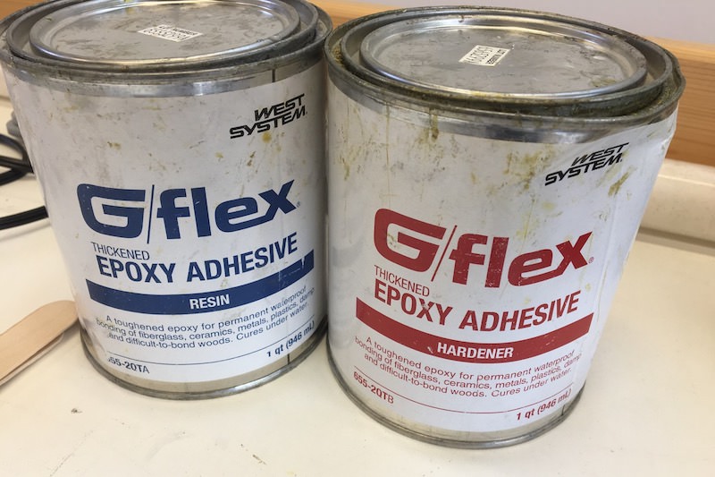

I got a PM asking a) which version of Gflex did I use and b) what about adding aluminum powder to the epoxy and c) what about aluminum shims?
I used the Gflex 655K stuff. It's the thickened variety. I bought, I think, a two quart package. With no additional additives, it doesn't sag on a vertical surface, at least in the thicknesses I've used. It's the right viscosity, right out of the can.
I've tried adding aluminum powder at about 5% to 10% by weight to the mixed epoxy weight, and that did add viscosity (which didn't help anything) but also made the epoxy noticeably more brittle, so I discontinued it. It also seemed to diminish the adhesion. My goal adding it was to make the epoxy have more stiffness in compression, which it did, but wasn't ultimately an overall improvement. Now I use the epoxy straight with no additives.
My mentor will not accept a gap thicker than about .015" without aluminum shims. I try to do the same but that's a difficult thing to control well on sheet aluminum parts. Once in a while, not often, I have a shim on top of another shim. The glue does a good job of keeping these intermediate assemblies in place. In fact, that's where I really like using it: to keep parts in place during bigger assemblies.

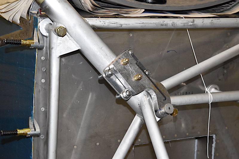

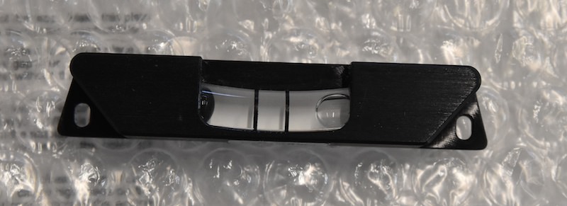

One thing I wanted to include on the panel is a decent slip indicator, one that's physical like the ones in a turn and bank instrument. But I didn't want one of the huge ones that seem to be available from the major vendors. I ordered an S0093-2 from Rieker, Inc., and it arrived. It's very light and tiny, maybe 2" long and about as big diameter as a pencil. Here's Rieker's stock photo. Mine has a white background. Cute little gadget. The ball is highly dampened - I think it'll work very well.
This, the 8-day clock and the airspeed indicator are the analog devices that will be in the panel. I expect that with these and my old last-century non-electric eyeballs, I could probably get the plane down successfully if the electrons decide they've had enough fun and want to take the rest of the day off. But I do hope that they stay on the job.

Here's that photo of my slip indicator. The housing is plastic, contributing to the very low weight.

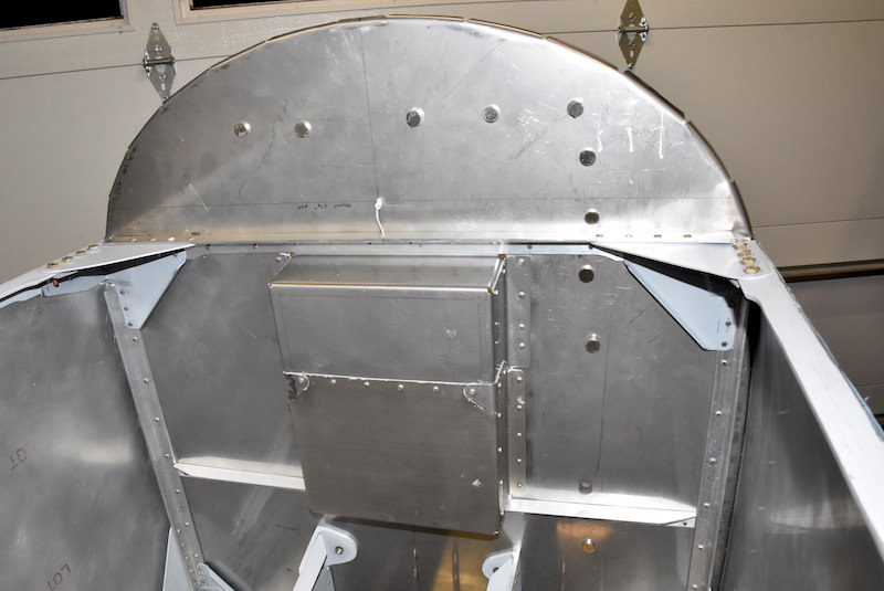

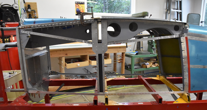

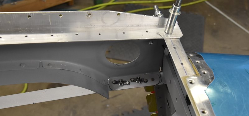

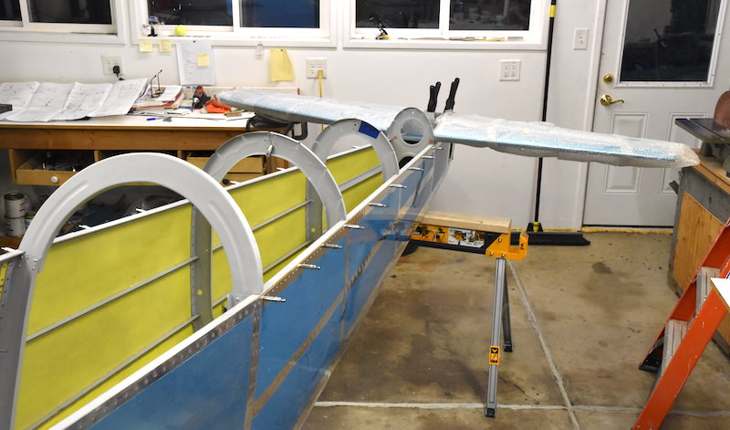

The right-hand tailcone side is now on for the final checking before gluing. There's still some prep to do before I get that far though.

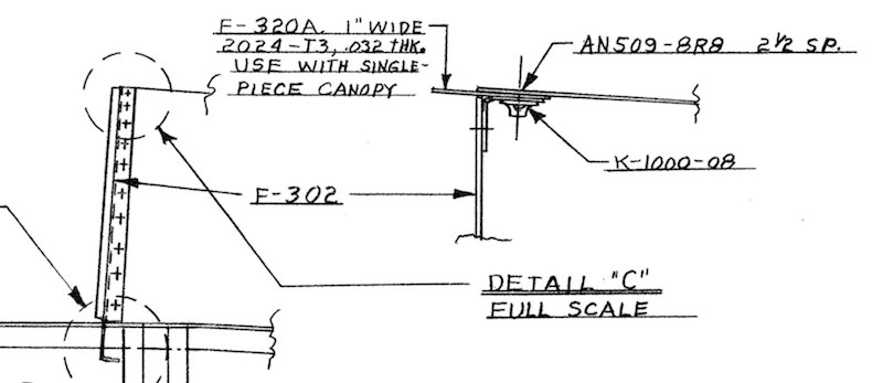

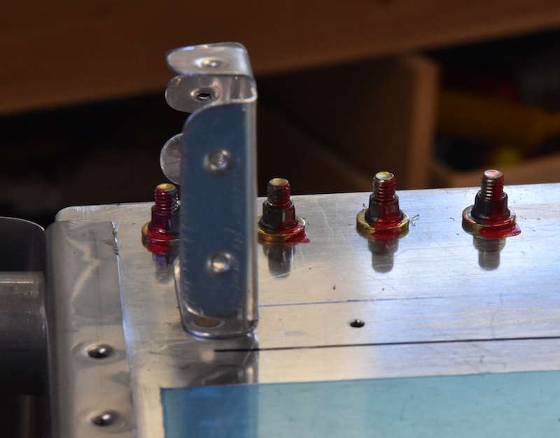

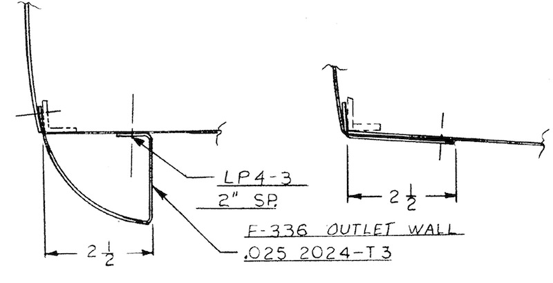

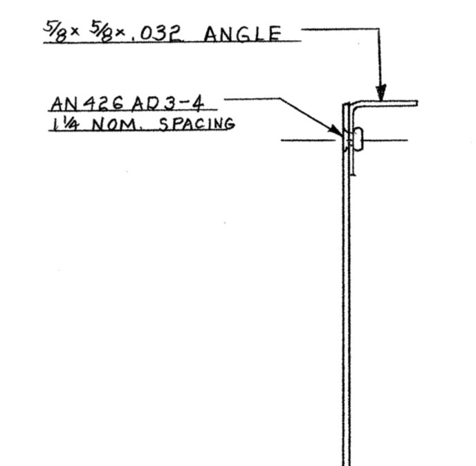

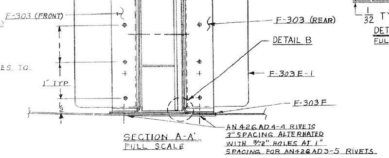

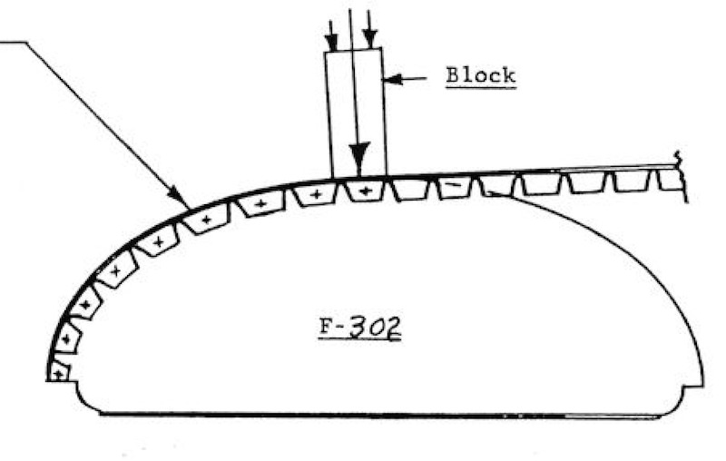

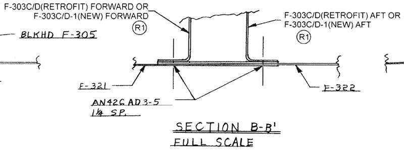

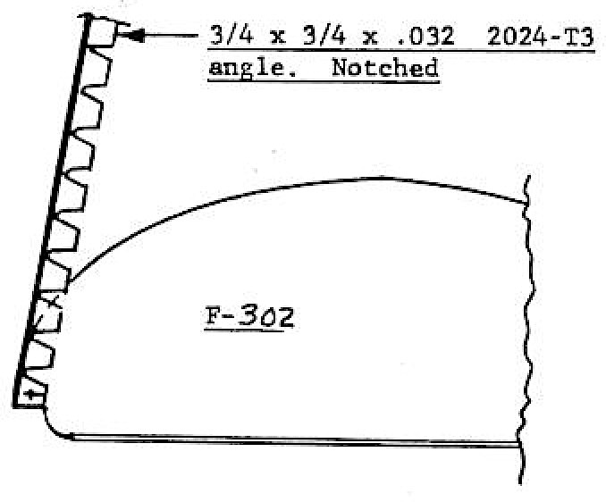

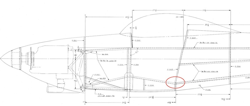

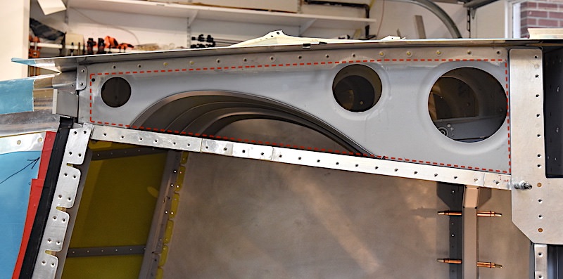

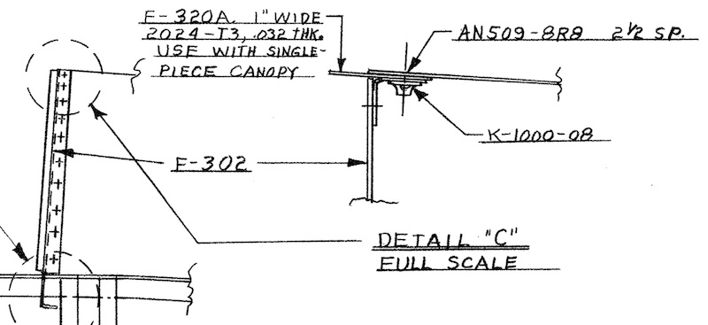

The F-303F strip in the spar bulkhead center section has, for some time, had the AN426AD4 rivets installed. I understood these to attach this piece to the bulkhead pieces, with the AN426AD3 rivets for the skin splice while the skins themselves didn't have these rivets. I looked at the drawing, below, again, since those skins are next, and decided that I was mistaken: the AD4 rivets definitely appear to go through the skins as well as the F-303F strip and the bulkhead halves. I drilled those out and match drilled these holes through the skins, after replacing the left-hand skin because of insufficient rivet edge distance on the previous one.
The area is also shown on detail B-B, Drawing 23. Note that the rivet spacing conflicts with Drawing 11. However, Drawing 23 is all about the skin riveting while Drawing 11 is all about the spar bulkhead. I think that a reasonable interpretation would be that 11 controls the locations of the AD4 rivets and 23 controls the AD3 rivets - but it's conservative to use the closer spacing:
In my case, it's moot - the holes are already drilled.

At the time (in an previous post) when you mentioned setting those F303 strip rivets I did wonder why you did that, couldn't see that it would compromise anything anyway. I did give my #30 reamer plenty of use when I riveted the floor sheets on mine as the 4 layers that come together here did make hole alignment for easy rivet insertion a little difficult.
Your fuselage is looking very nice Dave, looking forward to seeing it flipped.
At the time (in an previous post) when you mentioned setting those F303 strip rivets I did wonder why you did that, couldn't see that it would compromise anything anyway.....
I did it because it kept the two spar bulkheads located correctly with respect to each other, sort of as a tooling aid. But in retrospect, that wasn't necessary.

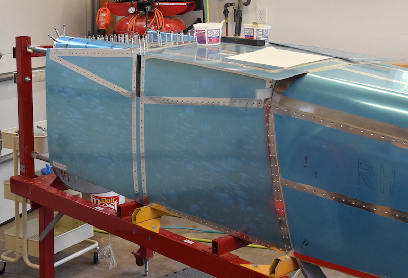

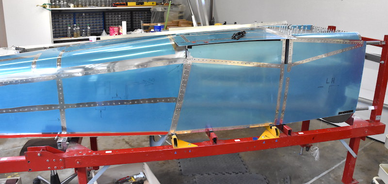

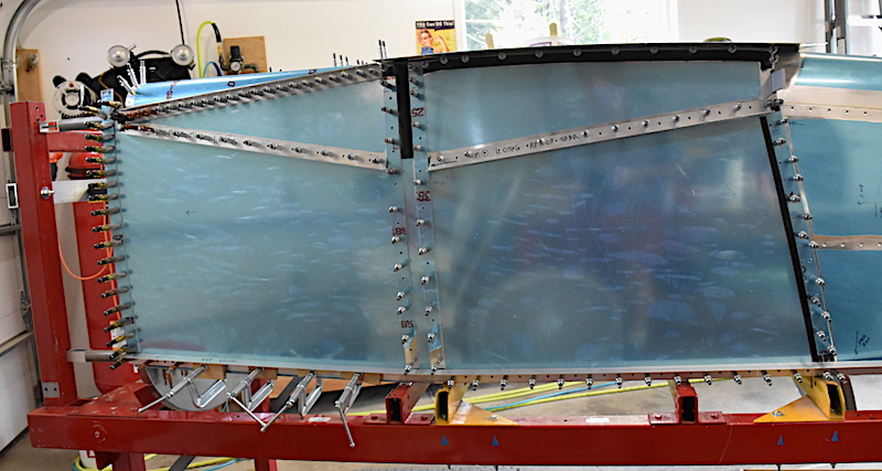

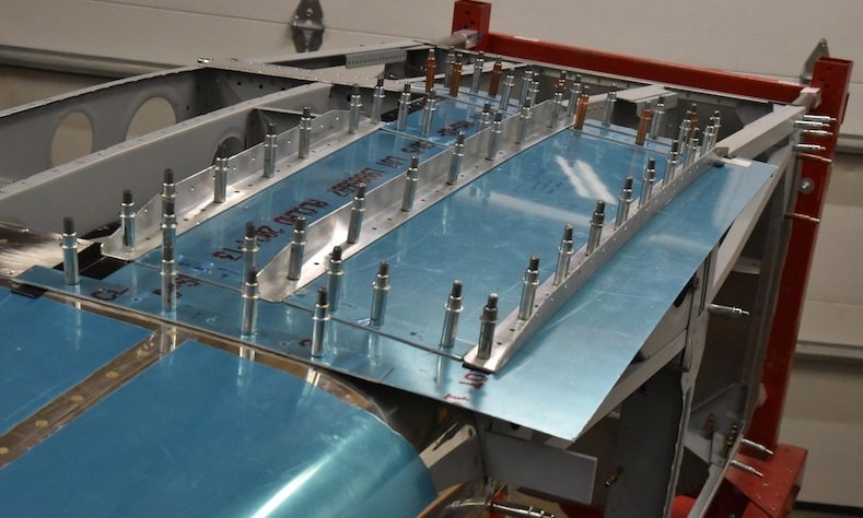

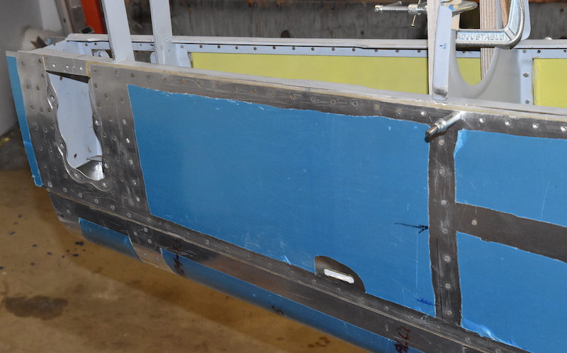

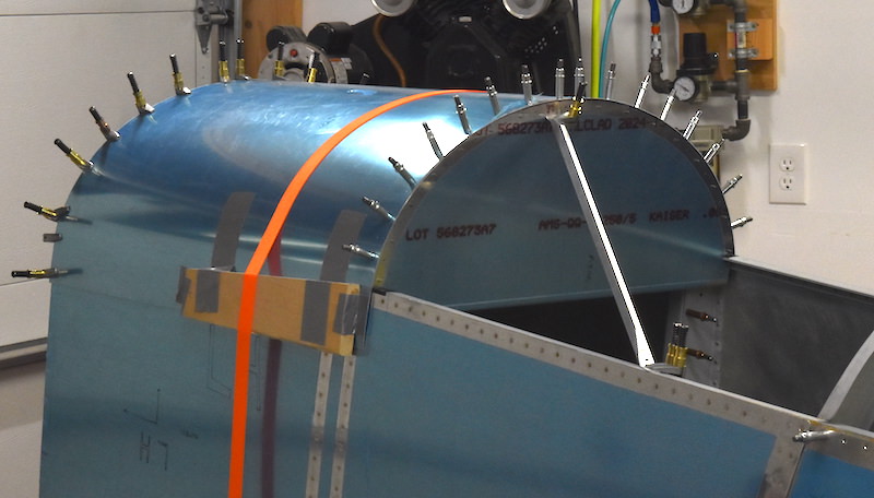

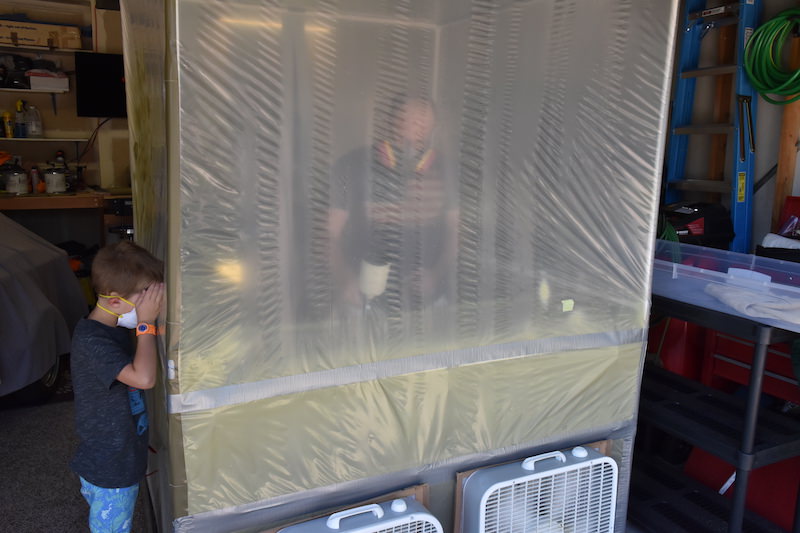

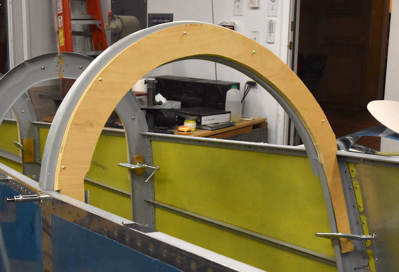

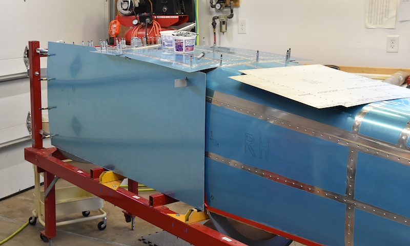

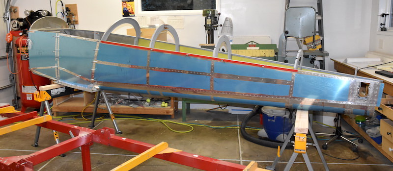

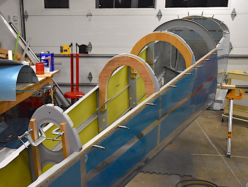

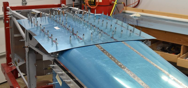

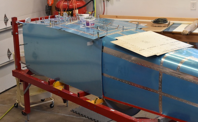

Glued the RH Tailcone Side
I gathered together the same crew as last time, experience counts, and we glued on the right-hand tailcone side today. Like before, we used thickened (this version comes prethickened) G/Flex epoxy along with an exoskeleton framework that will come off when the glue sets far enough.
But that's in the near future.

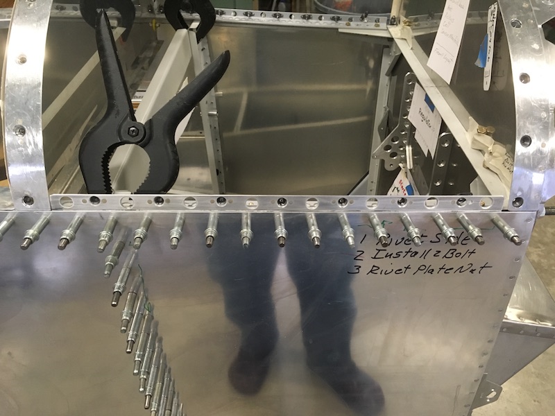

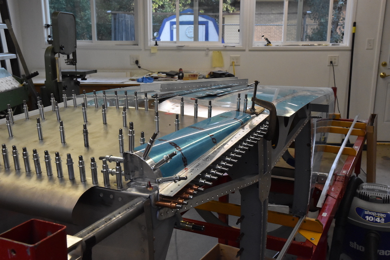

Today, we spread the glue, put the skin in place, and clecoed on the exoskeleton and filleted the glue along the inside edges of the bulkheads and the longerons against the skins. In fact, that's what Dave is doing in this photo.
After a few hours, while the glue was still tacky, I removed all the clecos and replaced them with fresh ones. The original ones had been oiled so that they wouldn't stick but the replacements weren't.
One of the benefits of adding this overall process, of gluing the skins on, to the general RV construction, is that it provides hours and hours of prep work. It's a good way to absorb excess spare time.

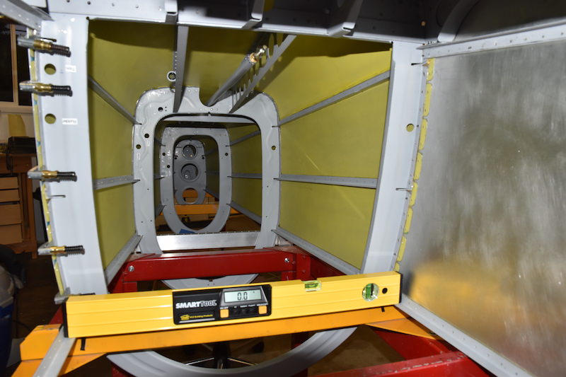

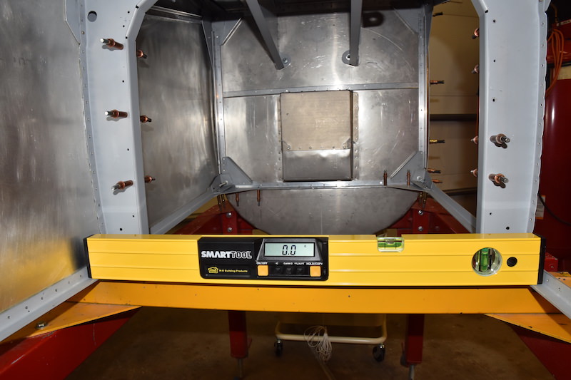

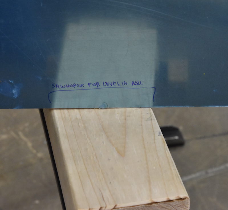

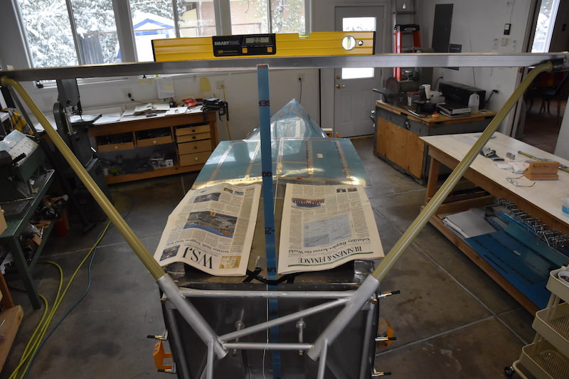

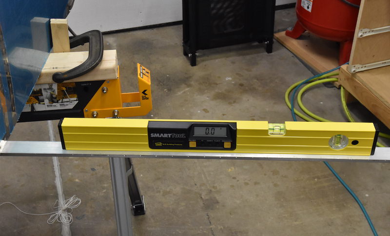

One of the steps before the actual bonding was double-checking that the fuselage is still straight and true in the jig. Got lucky there: it hadn't changed and was still in rig.
If the photo disappears, try looking here.

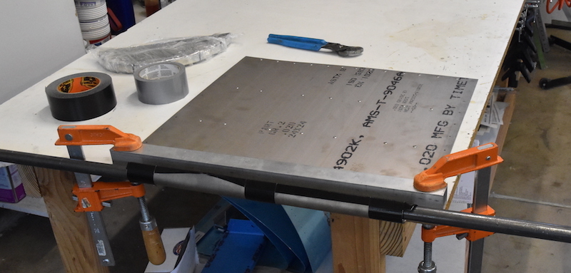

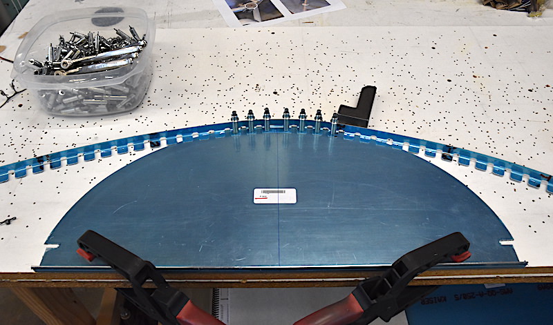

I'd ordered a new F-321 belly skin and it arrived. My original one from the factory was just a tiny bit short; not knowing whether it was the factory or my particular fuselage, I just ordered a new piece. I ordered 25" x 26" x .040" and it'll clearly fit okay.

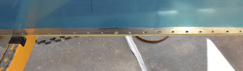

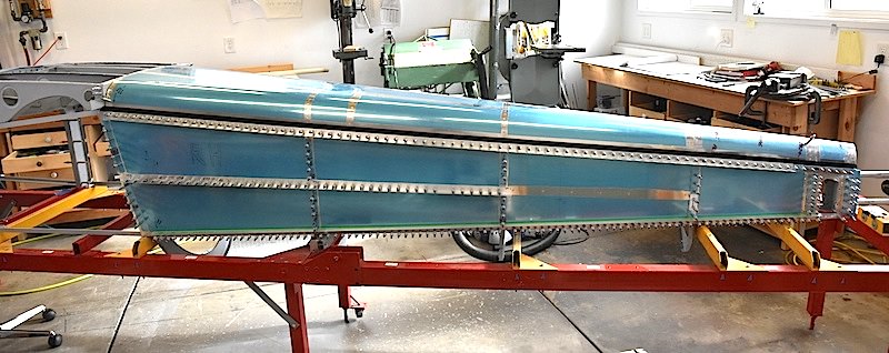

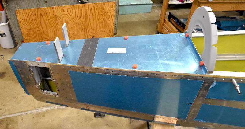

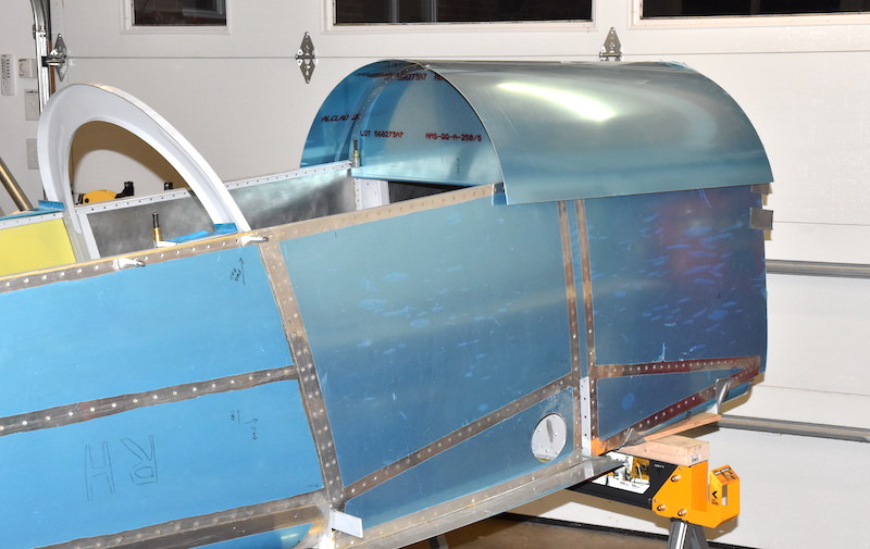

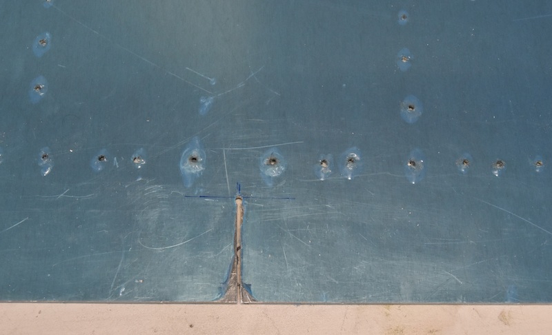

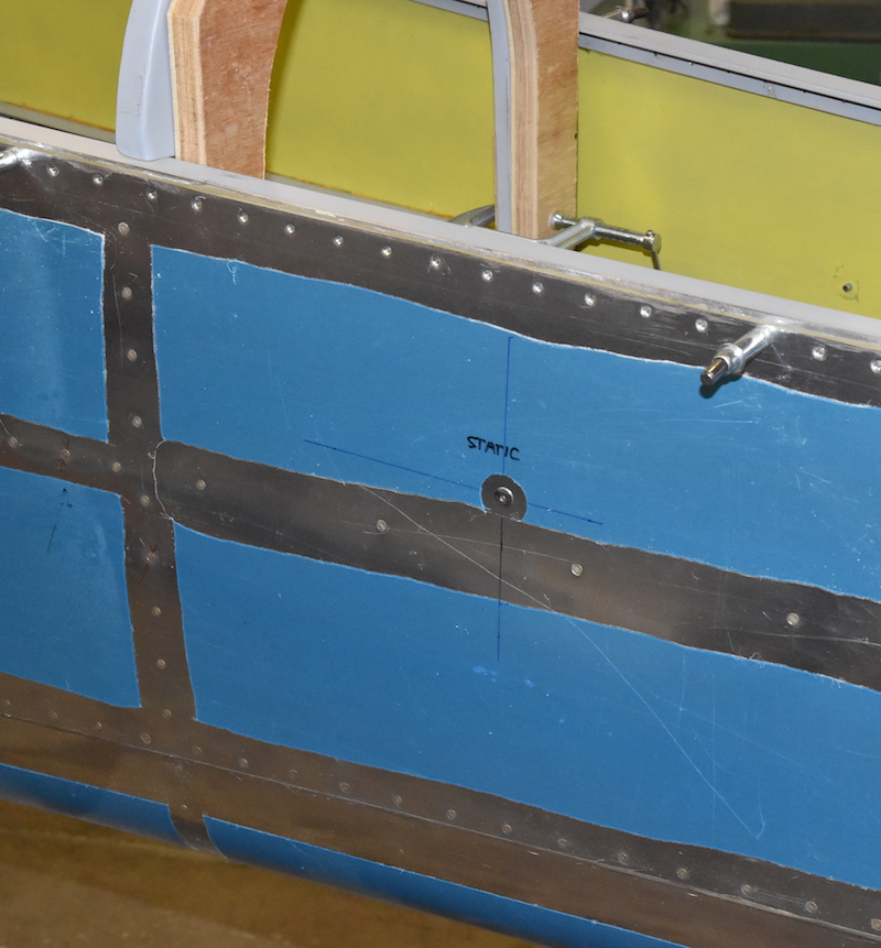

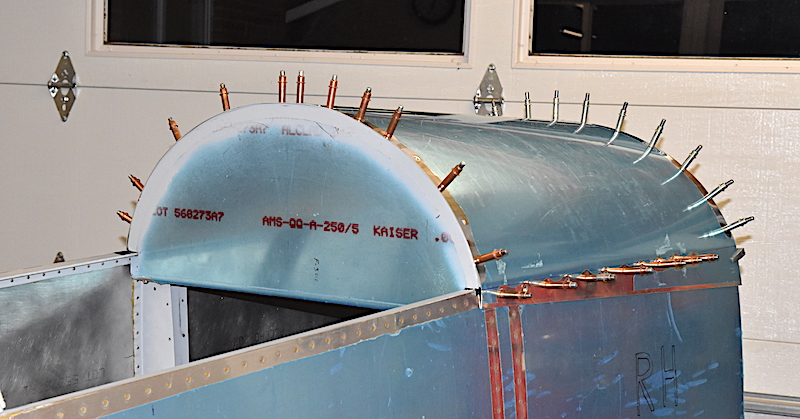

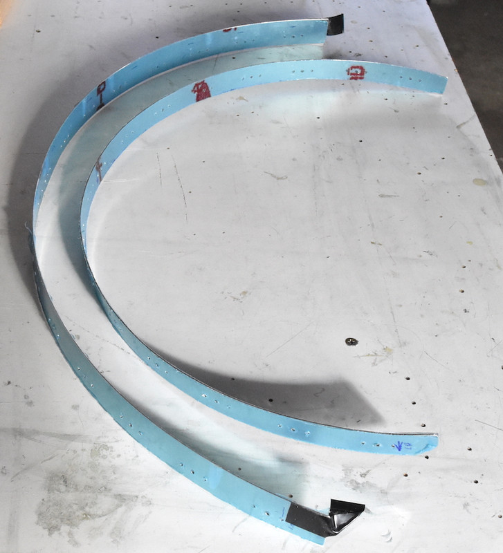

The exoskeleton is now off the side. Even without the clecos, it hasn't fallen off the fuselage, so I suppose the magic worked again.
I had made one mistake, though. The exoskeleton at the top longeron, which you'll remember is at the bottom of the inverted fuselage, immediately adjacent to the jig as is the longeron, has some squeeze-out that I didn't remove soon enough. With the exoskeleton off, this flashing was very apparent. Here's a bit of it. It's that tan band under the aluminum.
If I'd trimmed it off the evening we glued it, all would have been fine, but I didn't. I removed it the next morning but it needed a Vixen file.
You can also see some glue that oozed through a rivet hole and another that got filled up. We were a bit generous with the glue, apparently. I don't put a cleco in every hole, since the idea is only to make the surface smooth and hold the skin on in the right position. After I took this photo, I spotted that and it came right off. In any case, cleaning up the rivet holes and countersinks generally is pretty easy.
This side came out better than the left side.
The alternate-hosting site has this photo, too.

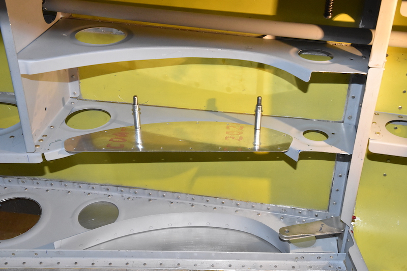

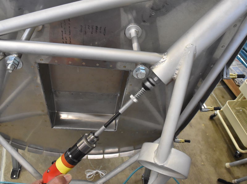

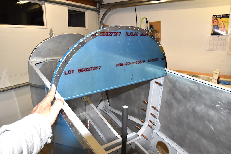

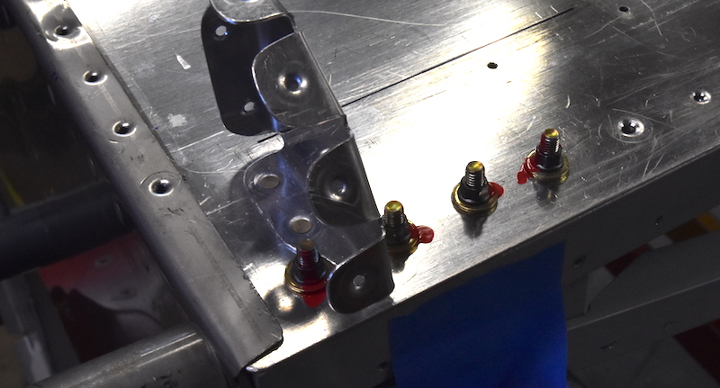

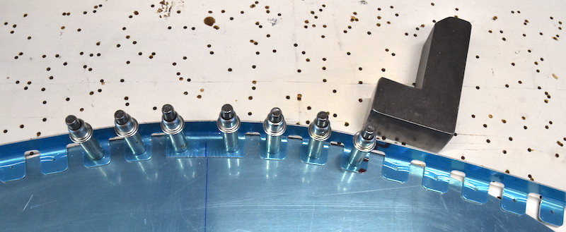

I finally reread the manual for the areas I've been working on. Should have done that earlier, as it would have told me the correct way to assemble that spar bulkhead strip that I had to unrivet. The manual says "The rivet holes through the skins and the bottom flanges of bulkhead F-303 should not be drilled until both skins are in place."
I agree with this with one exception: if you drill through the bulkhead flanges first, then when the skins are in place, you can back-drill through the skins using a 12" bit, and there will be no difficulty locating the holes on the skins. Just watch out for edge distance when you're locating the holes on the flanges and when you set up the skins for drilling.
Also, note that some of the rivets are -4. When you're doing the drilling, if you don't go bigger than #40 at this time, you'll save yourself some time. You can drill those holes to #30 before dimpling. Just don't forget.
I glued the strip on to the flanges. That'll let me remove those clecos during the fitting of the forward belly skin.

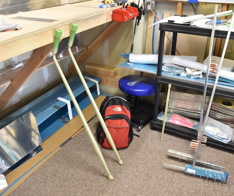

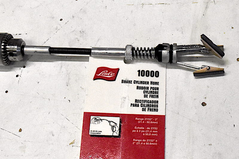

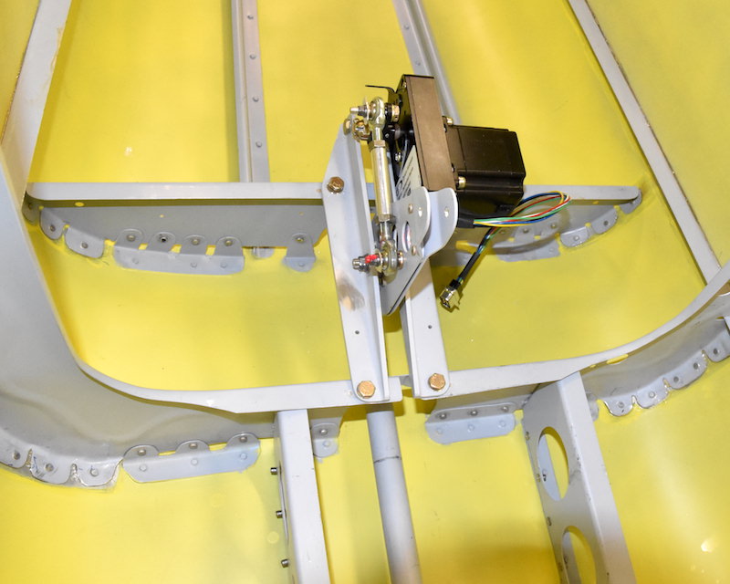

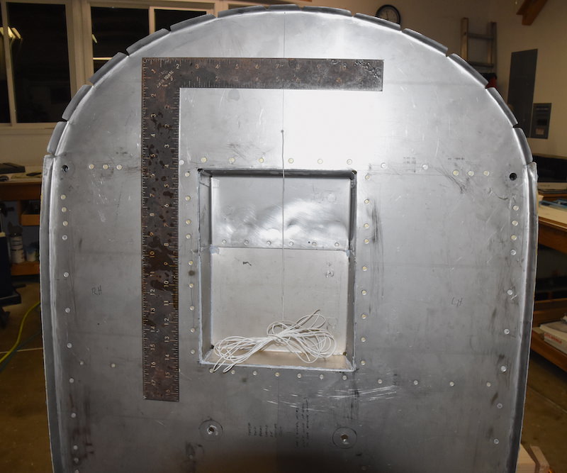

A machinist friend made the button at the end of the manual flap handle and cut the slot. The bearing blocks for this are ready now, too. The plans don't show it but the manual correctly says to install nutplates under the bearing block mounting angle to facilitate easier maintenance. Since my seat rib flanges were running low on edge distance (the extruded angle is ample) I made a small plate to rivet the nut
The photo also reveals that the exoskeleton angles for the seat pan skin are done. I had to use my shrinker/stretcher to get the correct curve in these.

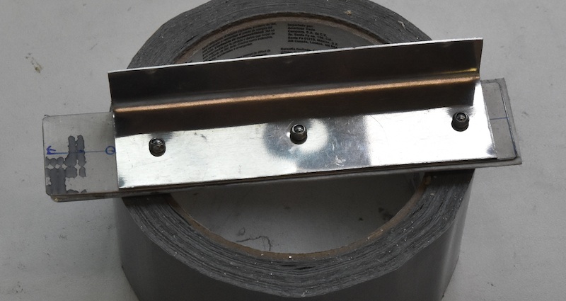

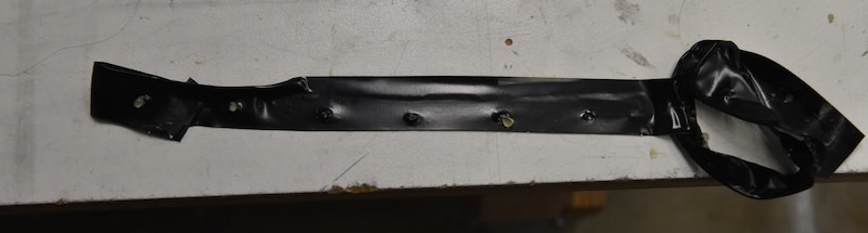

Here's a bit of tape that I removed as part of the process when I glued the right side skin on. Clecos protruded through the holes and carried glue along with them. I pulled the tape off and the glue came along with it, nice. Since the clecos themselves would push the tape away, I poked slits through the tape in each of the cleco locations before gluing.
The alternate photo hosting site has these photos, too. The first one and the second one.

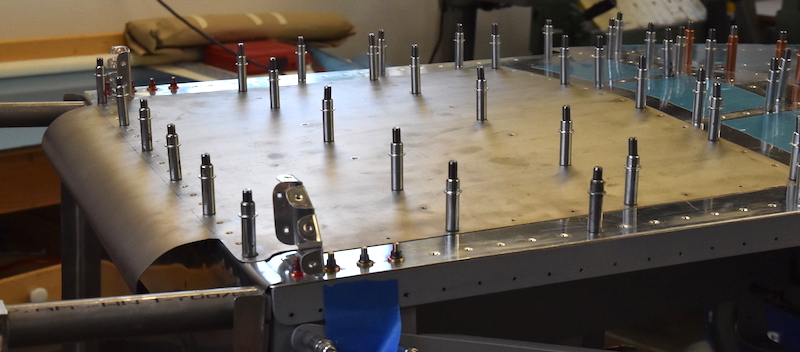

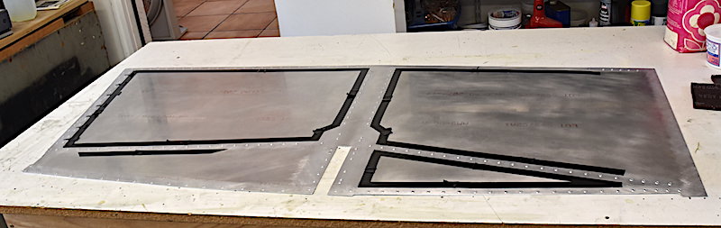

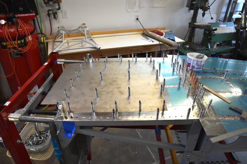

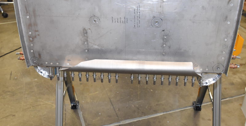

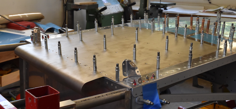

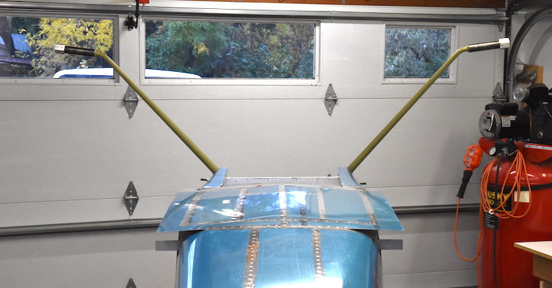

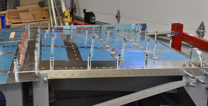

The left-hand belly skin under the seat is now glued on. Here it is with the glue curing, the exoskeleton in place, and the tape freshly off. Removing the tape is one of the first things to do after the clecos are in (the first ones are wiping off the cleco tips and filleting any joints).

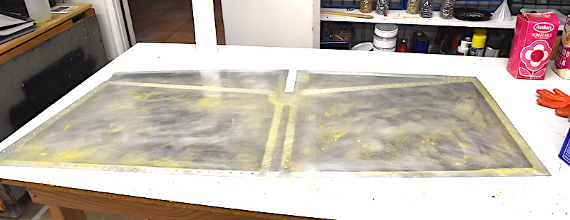

Then I made the exoskeleton for the right-hand side and did all the prep. As of today, this skin, too, is glued on. This photo shows the same status as the first photo but on the right side. Note that some tape is still on, under the exoskeleton.
While I was close to the details, I resolved to correct a bad area on the very bottom-most longeron just aft of the firewall. I hadn't positioned these correctly on either side. Initially, I thought that shimming them would suffice, but the more I thought about it, the more I leaned towards simply replacing these. Haven't done that yet, but that's coming up on my list.
The arrow shows the gap. This is the left side; the right side is worse.

Forward Belly Skin
Working on the forward belly skin, F-321. This one is the .040 piece that goes to the firewall.
The first bit of work I had to do was to correct the bottom edge of the forward lower longerons and the F-312 (mine aren't stock) ribs so that their aft edges fair to the seat-area belly skins. I'd made them too high. Fortunately I had enough material to do these things.
I put a description of this on the RV-3 Clarifications page.
After that, I had to bevel the forward edge of the forward belly skin to fit between the firewall bottom cross-piece and the firewall lower flange - wish that were wider, but it's not.
Then I could start clecoing the skin on. I worked from the going front aft and things went well enough until I got to the spar bulkhead. That has the wing dihedral angle in it so that the bottom of the skin isn't flat. Since the forward belly skin is one-piece, that meant that there's a compound curve going over the bulkhead flange.

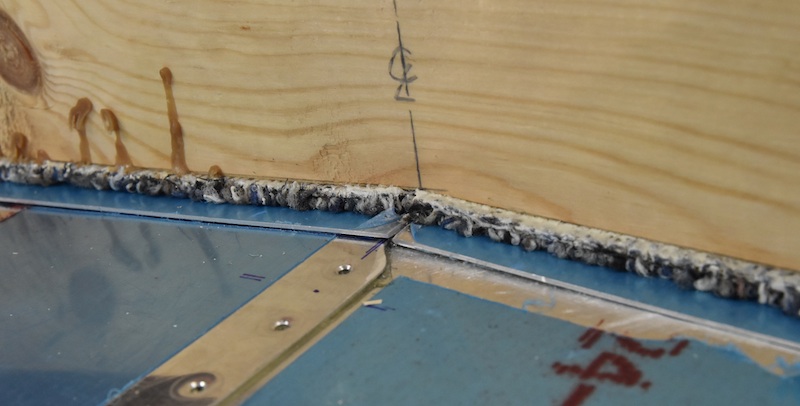

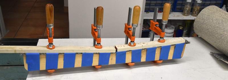

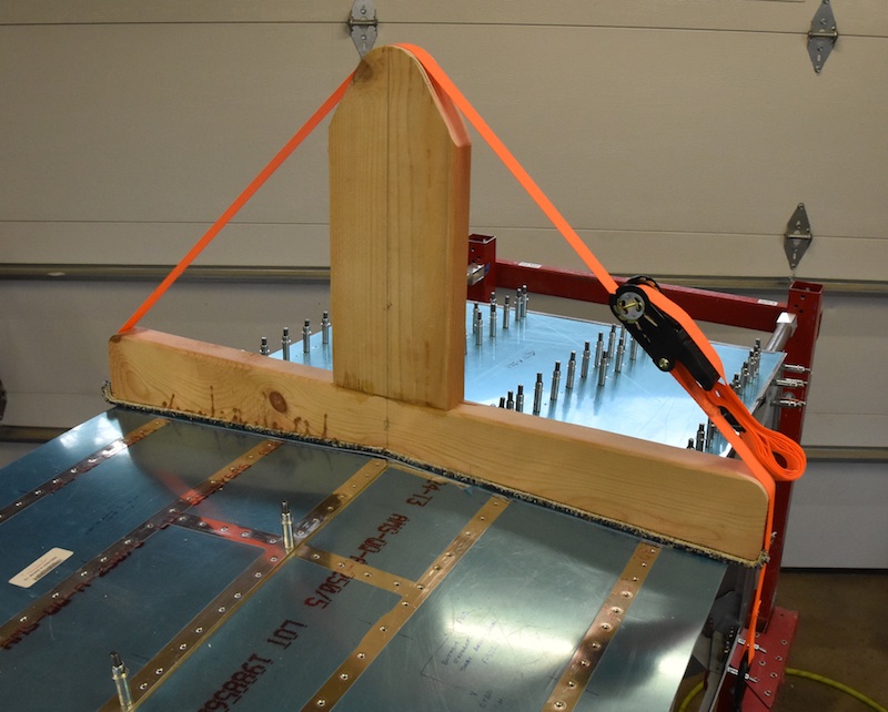

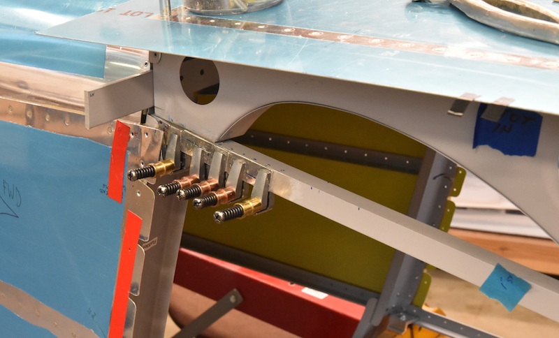

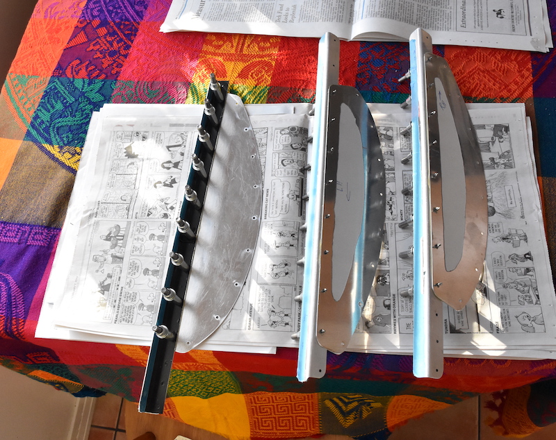

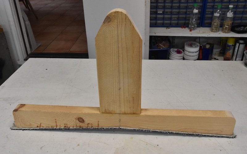

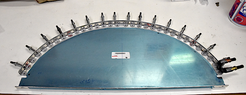

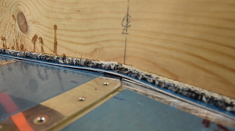

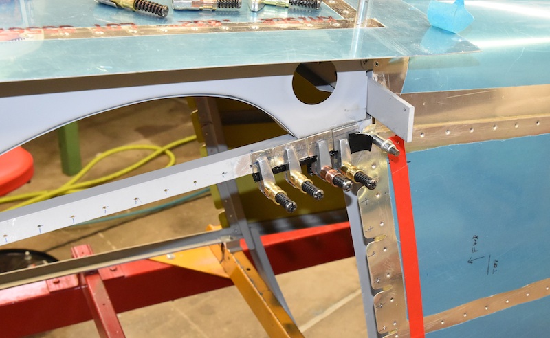

I made a tooling piece and suppose I should call this a Howe fitting like the ones I used on the wing. Same sort of affair, held on and pulled tight with straps. Fortunately the .040 skin is relatively robust and it pulled down without trying to buckle.
Putting the carpet on the fitting, with a much-used roll of carpet on the right,
And then I added a post in the center area, where I wanted local pressure.
The skin overlap at the center of the spar bulkhead, where the seat belly skins overlap, left a bit of a gap under the F-321 forward belly skin. I glued on some shims and they're curing now. I can strap down the Howe fitting when they're set.
The photos are also at this place and this one too. Just in case.

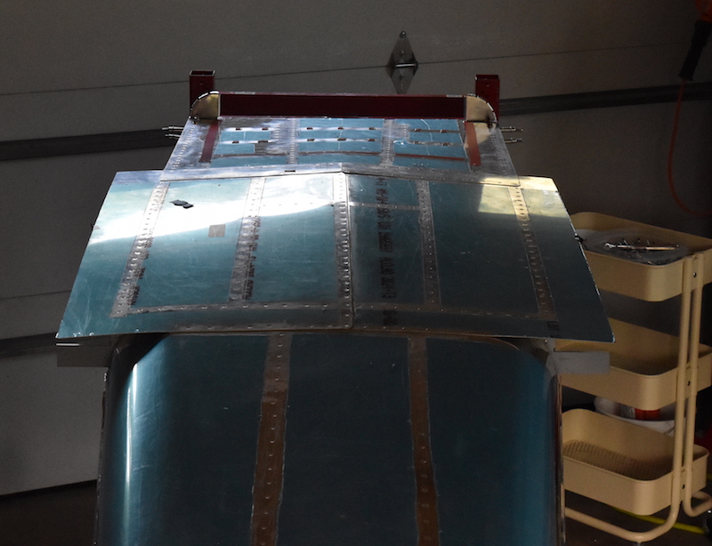

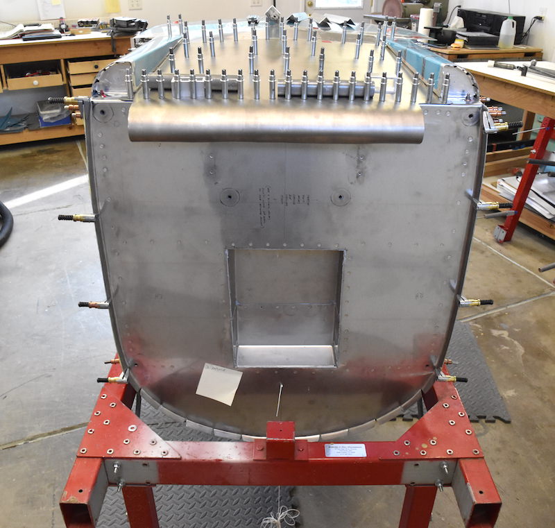

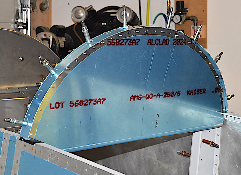

I clecoed the forward belly skin back on and used straps to tighten the Howe Fitting in place over the spar bulkhead. That is, it's "over" because the fuselage is being built upside down, but as far as the airplane is concerned, it's under the belly.
The compound curve due to the overall geometry still produced a ripply in the skin. I could not find a way to position the Howe Fitting to avoid that, even using shims. This shows the ripple.
With no other alternative, I consulted my mentor, who said that he'd cut the skin to relive the ripple. I decided to try it. A colleague in Australia had sent me a photo showing that he'd done it too; plus the RV-4 plans show something similar in the same location.
The cut was made using a Dremel cut-off disk and took a very short time. It's about .050 to .060 wide and 1.72 long. The hole at the end is for stress relief and is reamed to #30.
Here it is in place. Bottom line, it works. The ripple disappeared.
Now I wish that I hadn't thrown out the nicely drilled exoskeleton for the spar bulkhead after gluing on the seat belly skins. But it's a small workshop and alas, I did that.

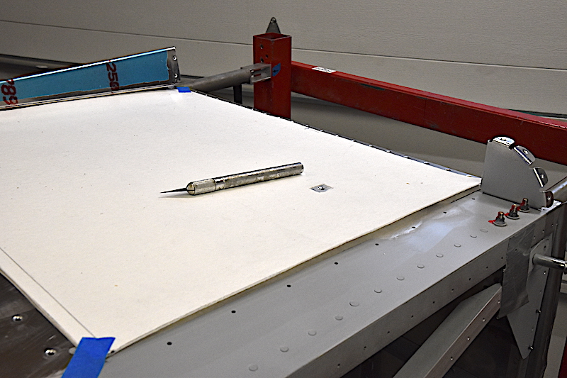

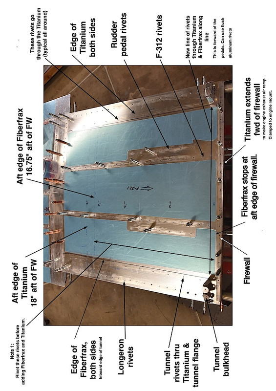

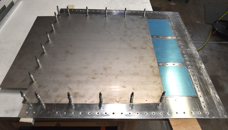

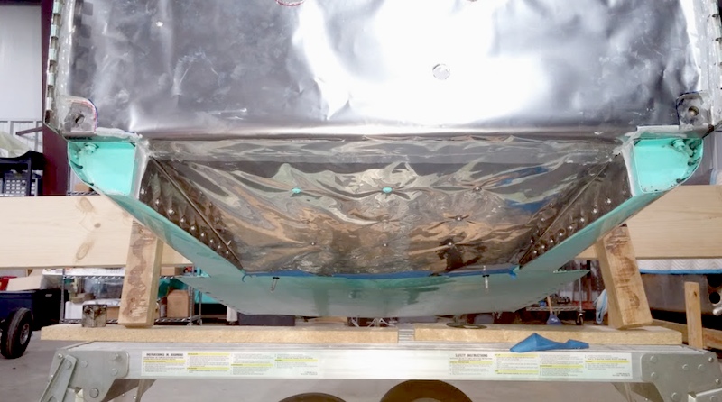

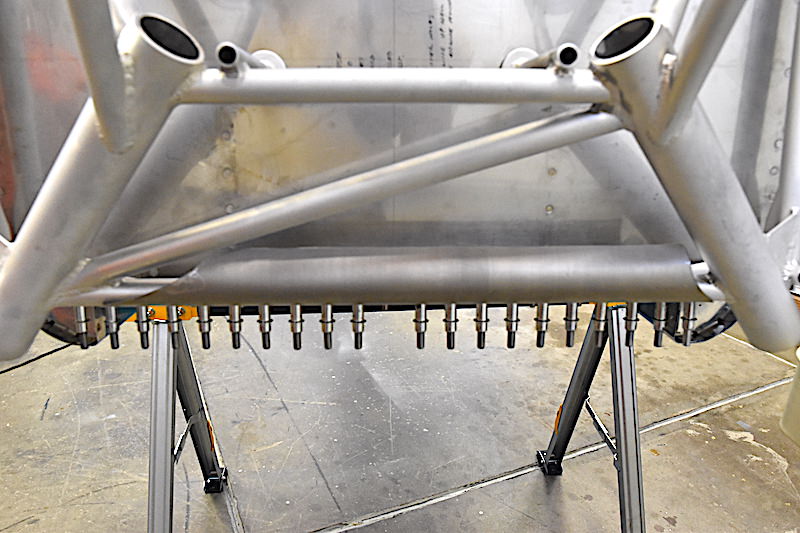

With the tunnel shells and bulkheads drilled and fit, it was time to consider the belly insulation and fire protection. The insulation is 1/16" Fiberfrax and the fire protection is .020 Titanium. I chose that because the FAA recognizes .016 Ti as acceptable for firewalls and .020 was available from McMaster at a reasonable price.
Most people who do this use stainless steel foil. KatieB used that foil, for example.
But I got to thinking that the protection is more than from heat; it's to guard against actual fire under the belly behind the engine hot air outlet. The belly is aluminum, .040 thick to be sure, but still aluminum. I decided that primary firewall protection should be added. Hence the .020 Titanium.
At one point, it looked as if the Fiberfrax and Titanium sandwich would both go between the tunnel shell inner flange and the belly skin, and made this test piece to see how much the Fiberfrax compresses after being riveted with LP4-3 rivets. The side view shows minimal compression.
When looked at in the right light at the right angle, though, some dimpling is visible in the simulated belly skin.
Later, I riveted an AN470AD4 rivet in one end and that seriously did compress the Fiberfrax.
Therefore: the Fiberfrax should not be part of the structural connection between the skin and the tunnel. I decided to stop the Fiberfrax by the inboard edge of the tunnel shell. This led to some rivets on the belly going through the Titanium and others not. It appeared easy to screw up (still does) so I made this guide.
One issue is that with the Fiberfrax stopping at the inboard side of the tunnel shell, and the rudder pedals above the tunnel shells, what about insulation there? But I think that the tunnel shells themselves will give me some insulation, and if I add a bit of the Titanium to the inner wall, it'll be somewhat protected, for a short while anyway, against flame. With no Fiberfrax on the inner walls, heat on the Titanium can work through to the aluminum tunnel shell. No problem for normal flying but in a real fire situation, they could melt. Still, that'll give me some protection for a while.
The photos can also be found -
here,
here,
here
and
here.
Dave

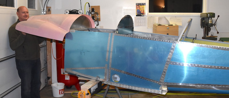

After making the titanium belly overlay, I clecoed it in place. Forward is to the left. That overhanging part is to allow for a rounded entry for the air exit.
Then I glued the belly piece, the aluminum one, on to the frame. We'll get to that photo shortly.
With the belly on it was time to rough-fit the forward side skin. I started on the right-hand side. I had assumed that the cut to fit the overhanging seat belly pan would be difficult and it wasn't too hard. It was just a matter of marking the edge of the belly skin, fitting, repeat. Another part that I'd thought would be hard was locating the rear spar stub, which pokes through the side skin.It wasn't so bad, either. I drilled holes at either end of the cut-out and then used my Dremel to cut the slot out.
Did you know that I've already worn out my first Dremel-like tool? Now I'm on a name-brand one, and frankly preferred the older one, a "Master Mechanic."
Here's the rough-cut of the right-hand forward side skin in place. You can see that I went slightly too far on the bottom of the rear spar slot.
And here's a photo of that forward belly skin I promised you, plus the untrimmed bottom edge of the side skin. The rectangles on the belly are there for the double-flush middle rivets to the titanium overlay. These are also stand-offs to ensure that the Fiberfrax doesn't get compressed by these rivets. The rivets are double-flush so that they don't interfere with my feet in case I leave the floor uncovered.
I'd taken the opportunity of the above photo to mark the side skin for trimming. Here it is trimmed and unfinished. You can also see the titanium overlay, now dimpled, resting on the fuselage out of the way.
When people say that the RV-3B isn't prepunched, this is what they mean. This side started as a rectangular piece of aluminum, cut slightly oversize to allow for trimming.
You might note that several skins haven't been riveted yet: the right-hand tailcone side skin and the belly skins forward of the rear spar. These need to be riveted before these forward side skins get glued on.
The photos are also hosted here, here, here, and here.

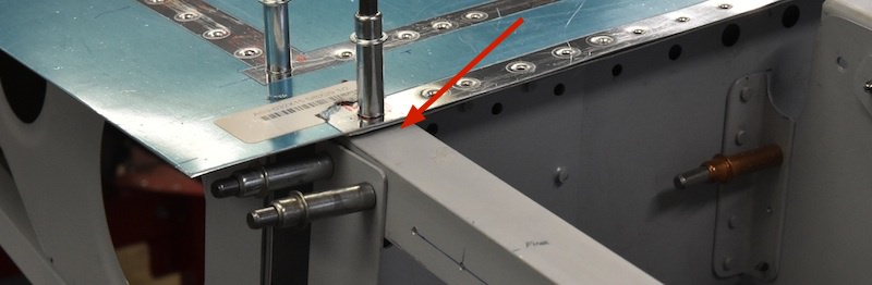

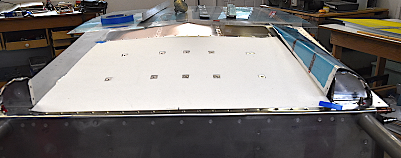

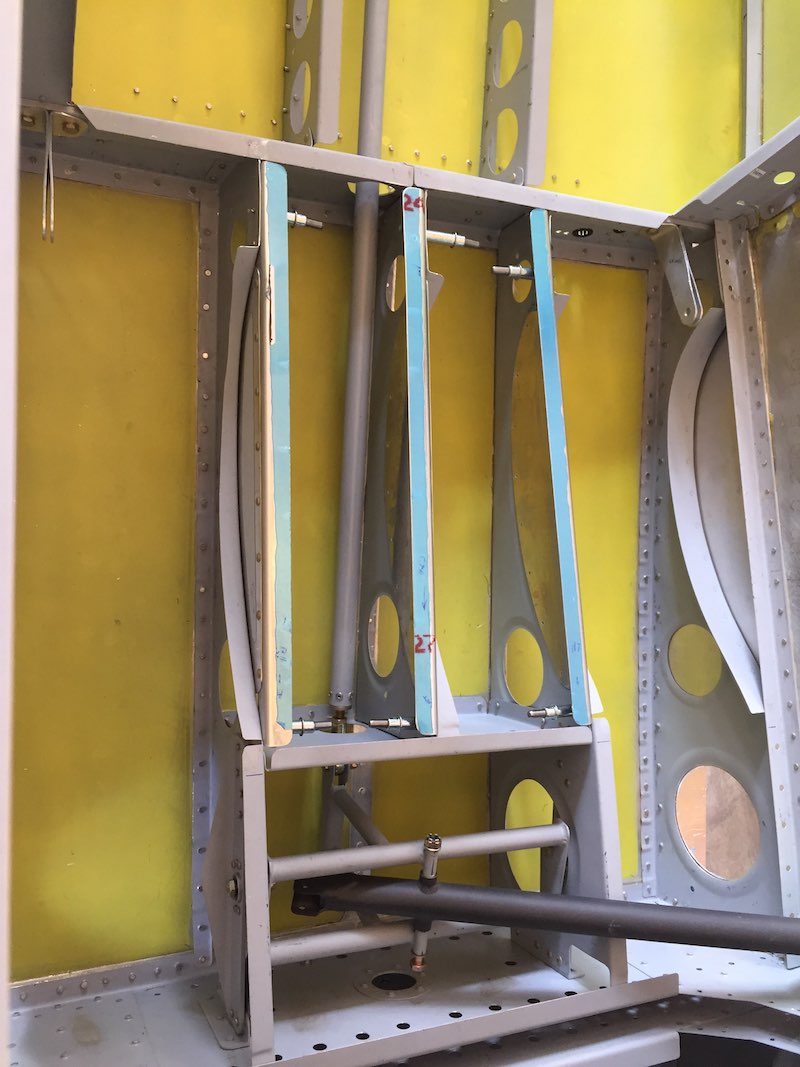

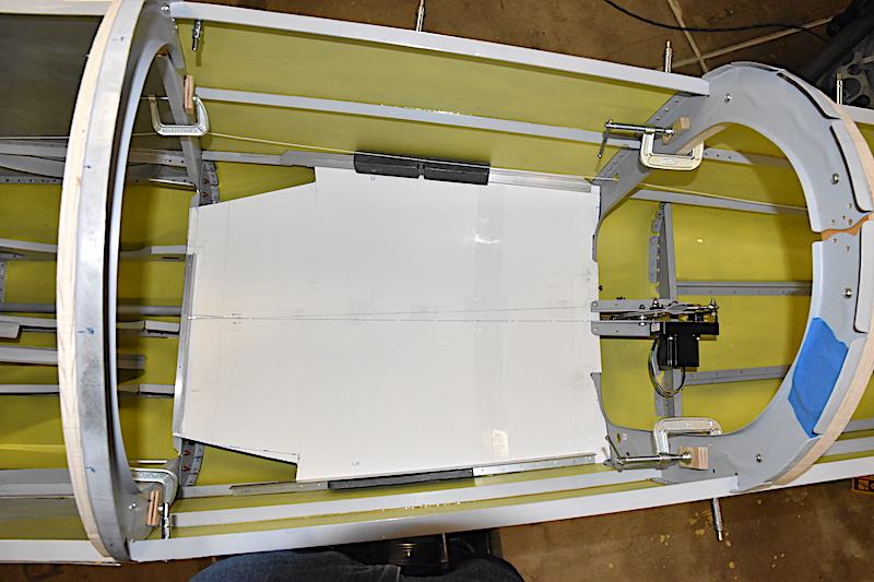

Here's the titanium belly overlay in place. Nothing unusual about this except that the .063 spacers in the middle area under it are forcing it to lay in a mild compound curve, since the perimeter lays flat on the aluminum belly. I just clecoed it on so that I could verify that indeed, this works.

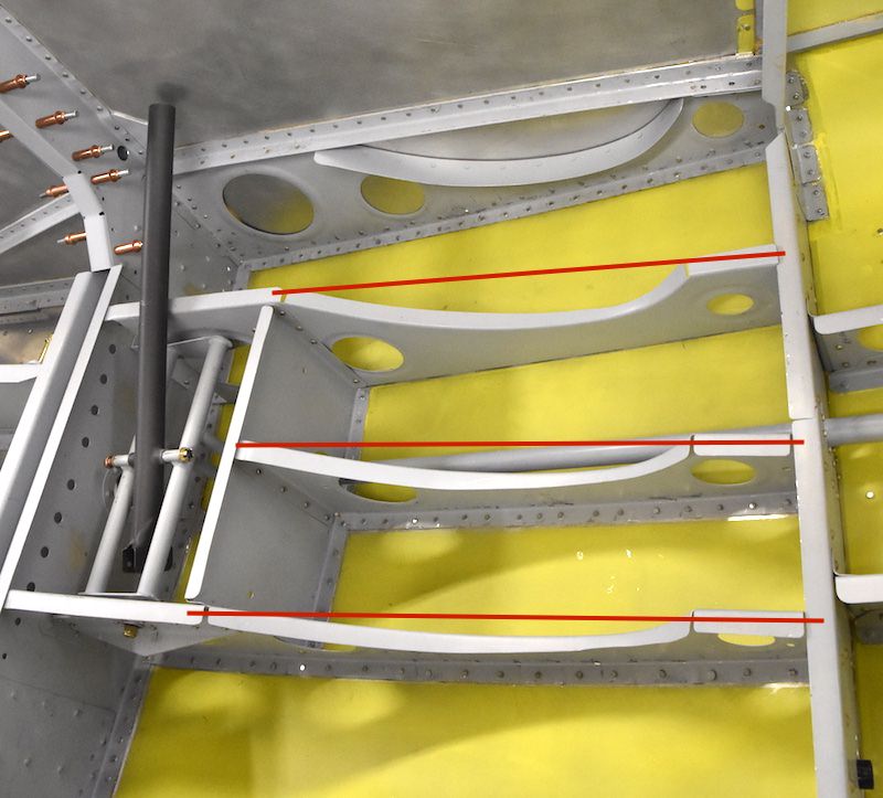

Then it was time to start shimming the area at the seat bulkhead where the bottom longeron and the angle that goes by the seat area all intersect. The design is somewhat crude there and I ended up with a bit of space to shim on the angle at the seat. This is the area at the red ellipse below.
If I ever build another RV-3, I'll pay a lot more attention to this area during the construction. And no, I don't have a solution that you can implement on yours. Please understand that since I'm not a great builder, that I could have simply screwed up -- but I don't think so; this is not the only one of these to need something here.
I'd bent the angles, somewhat, to allow for this, but there was still some space to fill. So I clamped an angle on the outside of this area and measured the gaps. From that I selected some shims from my scrap pile, cut them, abraded them and cleaned them, and then glued them on. Here they are with the glue still wet and the clamps still on. First the right side.
And the left side,
I anticipate that these will be sort of a starting point, with more shims necessary. But I won't know that until I've cleaned these up.
The photos are also here, here, here and here.

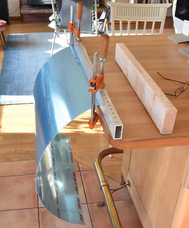

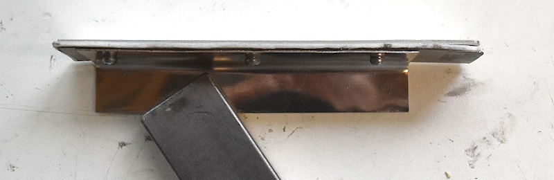

The Titanium layer on the forward belly has a portion that needed to be rounded to be part of a more efficient cooling air exit than the stock design. In this view, it?s already partly bent. I just grabbed one end of the pipe with Channel Lock pliers and rolled it up. The pipe, of course, was taped to the Titanium.
Then I rolled the initial curve into it the same way as we roll the empennage surface leading edges.
Getting a pipe with a fatter diameter, I was able to give a more gradual aft radius.
This is the final shape, except that I expect I?ll need to do some trimming when I put the engine mount on.
The front bottom of the belly has some nuts and bolts that attach the engine mount fittings. I?ve got these nuts torqued. The reason they?re being shown here is that the tunnel shell will eventually get riveted over them and they?ll not only be inaccessible, they?ll be hidden from sight. However, if absolutely necessary, an access hole could be put into the tunnel bulkheads, which are now pilot-dried for that.
The alternate hosting has them here, here, here, here, and here.

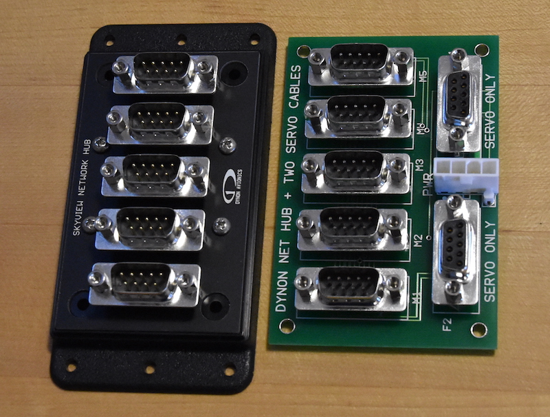

I’d gotten one of Gil Alexander's Skyview network hub printed wiring boards and the rest of the components, all connectors, made it a kit. I don’t need it yet but I thought that I ought to build it up now anyway. A friend of mine builds electronics equipment prototypes so I asked her a couple of assembly questions. Rather than an answer, she just told me to bring it to her lab. She then soldered the connectors to the board for me. I have to admit that she did a lot better job than I’d have managed, using tools that I don’t have. Here’s Maria Toscano-Leary soldering the SV hub kit.
Here’s the network hub side by side with Dynon’s version. The main difference is that Gil’s includes the two autopilot connectors directly. The white connector on Gil’s is a provision for the power and ground wires to the autopilot servos. There were no assembly surprises.
I'm still working on the electrical layout and haven't actually decided which I'll use yet. With the panel being both small and intended for day VFR cross-country, I might just go for the lighter one, after I make some sort of enclosure for the sides and bottom of the kit hub. Right now I'm thinking of a wrap of electrical tape....
