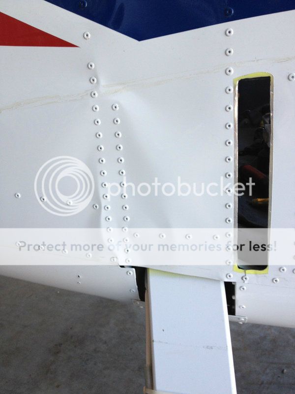

We've been ascribing the wrinkled skin cases (very few) to hard landings, even though it seems very hard to see how the gear could move aft far enough (at least 1/2 inch in my case) to crimp the brake line. I was playing around this evening doing steep turns, stalls, chandelles, etc. (all within the definition on non-aerobatic) and noted two things:
1) speed builds up to the top of the yellow arc very quickly going downhill, well above manuvering speed and
2) as we all know, the -12 rolls very quickly and easily; the higher the speed the greater the roll rate.
If I've read correctly, most of the damage seems to be on the right side, where you'd expect the most stress to be in a rolling pullout to the left, the way most of us would do it with the left hand on the stick. The stab is carrying a large down load to pitch the nose up while the vertical is carrying a large load to the right to push the nose left. Rolling pullouts impose the maximum loads on the empennage and fuselage. I was working in the USAF Structures Test Lab during a test to see why a B-58 had shed its vertical tail in flight. When we applied the loads for a left rolling pull-up, sure enough the tail/upper aft fuselage separated (broke off the the right) before the calculated limit load was applied.
It would be very helpful to know if the pilots of the damaged airplanes had been doing any maneuvering, stalls, or even flying in very bumpy conditions before noting damage to the fuselage. You wouldn't have the exceed the airplane's positive/negative G limits if in fact positive G's were accompanied by rapid roll at the same time.
Not saying, just thinking. To me fuselage deformation due to combined application of vertical and lateral G loads seems more reasonable than just due to vertical loads of a hard landing-- especially a "soft" hard landing.
Is it possible to find out what the pilots were doing before the hard landings? Again, I'm not even implying that anyone would have been exceeding the roll/pitch limits for non-aerobatic flight.

A few more thoughts
A few more thoughts
The fuel tank on the right side of the aircraft adds weight and stiffness right behind the spar.
If the channel is rotating back ( back flange up 70% front flange down 30%) most of the stress would be at the front of the fuel tank.
The left side would have a larger area to flex and absorb the loads
A skin doubler from the back of the spar about 12" back and the size of the wing rib on the outside would add a strength to this section and would not be visible behind the wing.
And in my view the channel is rotating.
I will not rivet this area on my side skins until vans reports their findings,
And for the people that have damage removing the rivets in this area, taking out the wrinkles with a body dolly and a hammer and installing the skin doubler should be easy.
