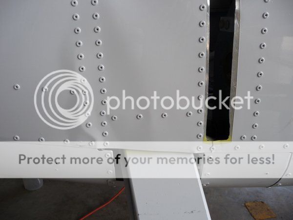

Symptoms:

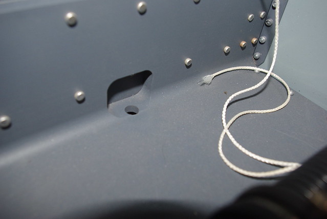

Cracks radiating from forward outboard landing gear attach bolts in the center section aluminum “C” channel web
Cracks more likely on right side.

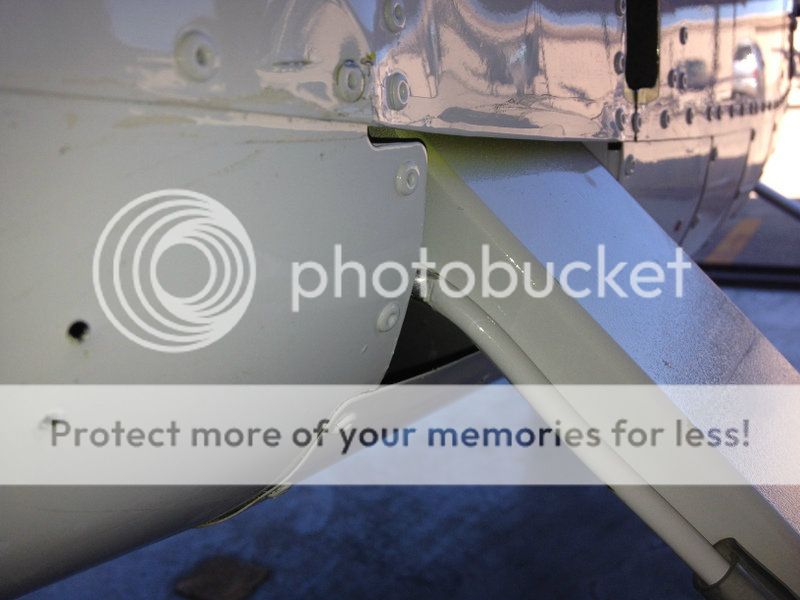

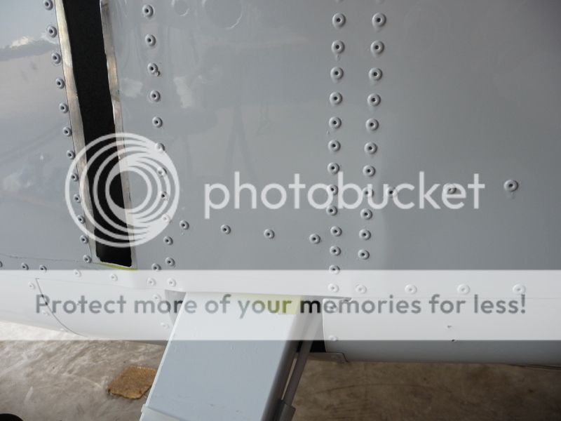

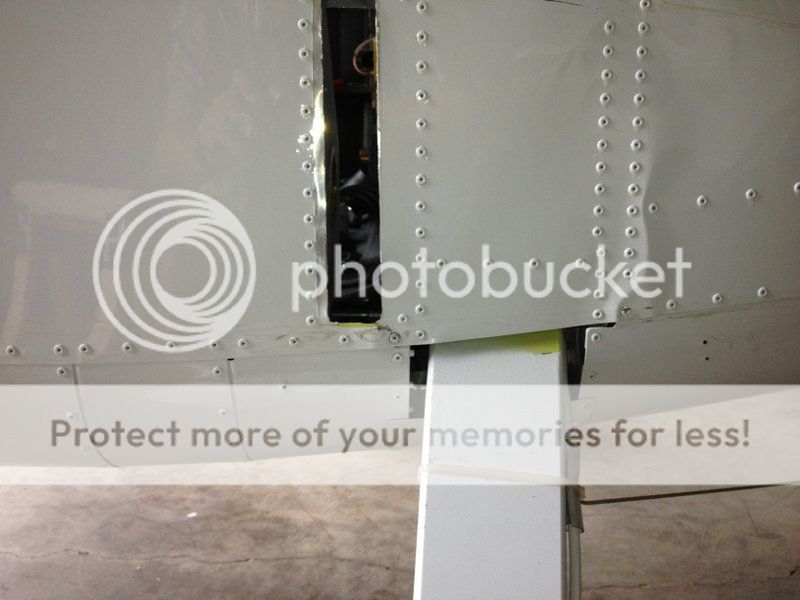

Skin deformations about the landing gear
Crushed brake lines from contact with aft skin where gear leg passes through skin

Hard landings, a torque stress? *Mechanism(s) is possibly the tail cone rotating down due to momentum and/or gear legs rotating aft due to impact.
Possible solution to skin damage:
Land better

Repeated impacts could be the mechanism of these failures. *Each individual impact could be less that that required to deform the skin, but could over time work harden (and thus more brittle) and eventually crack the “C” section web. *The source of these impacts is probably pulsating longitudinal forces on the wheels. Loose attachment bolts (facilitate impact transfer of energy), higher landing speeds (more energy), heavy braking (that causes shutter), not smooth runway surfaces, and gear legs that do not absorb longitudinal forces, would all contribute to impact forces being applied to the “C” section web.
Possible solution to Cracks:
Redesign landing gear to deal with longitudinal impact forces. Out of the builders hands.
Add reinforcements to “C” section web to mitigate impact forces.
Fully seat gear attachment bolts. *Ream holes, lube bolt shafts, seat (hammer?) bolt heads fully, remove powder coat (insure metal to metal contact). Add in non-thread resistance to torque values and torque to high end of range. Check bolts regularly.

That said, I REALLY would like for Van's to let us know if drilling access holes under the belly to allow checking the bolt torque on a regular basis is acceptable. If that section of skin is already being stressed I don't think I want to put more holes there.

4/11/12-N712BK left side showing very minor skin ripple aft of 2nd row of rivets. Note small skin deflection above forward edge of landing gear and at rear edge of wing spar cutout. This is the same appearance as I remember from the 1st Condition Inspection other than the airplane had been painted.
4/11/12-N712BK right side showing wrinkle behind 2nd row of rivets. Slight deflection of skin above forward edge of gear and broken skin at rivet below spar cut out. Again this is what I remember it looked like at the 1st Condition Inspection.

9/11/12- Removed wings and found additional damage to the right and left side around the landing gear legs.
9/11/12-N712BK left side wrinkle has become more pronounced and there is a skin crack out of the bottom rear corner of the spar cut out. It appears that the brake line may have touched the rear skin but there is no dent.
9/11/12-N712BK right side wrinkle aft of 2nd row of rivets is more pronounced. No change in the crack through the rivet hole below the spar.
9/11/12-N712BK right side looking forward showing dent in brake line.

I think it's pretty amazing how similar some of this damage looks compared to others. I just hope Van's has a team working on this for the sake of them and the builders. Transparency would benefit everyone involved, and the sooner the better.
