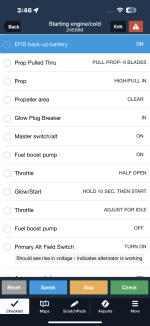

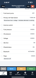

For instance - Start up procedure is a bit different. Here’s a couple screen shots of my start up list on foreflight:
You’ll notice ‘new’ items such as the Glow Plug, and missing things such as there is no “adjust mixture”.
In the air, the plane handles like an RV. No surprises there. On the ground, all is good although the larger wheels (not related to the deltahawk engine) make seeing over the cowl in the 12-2 position a bit of a challenge. Nothing an occasional S-turn doesn’t handle. I do think the larger wheels give a smoother taxi ride, and they look good.

Curious about the purpose of pulling the blades through (does '9 blades' mean three full crank rotations?). I asked about this at OSH last year wondering if the inverted Vee was susceptible to hydraulic lock like a radial and got the impression that DeltaHawk didn't think it would be an issue, so maybe there's a different reason like moving excess oil back to the sump (like Rotax 912 series prior to checking oil level) and/or priming the pressure side of the pump?
Also after engine start the checklist first reduces the throttle to idle and then afterward turns on the Idle Governor. Would it be easier to turn on the Idle Gov first so you can pull throttle to idle without inadvertently killing the engine?
Regarding ground visibility over the nose, it's not just larger tires...this prototype installation has a huge spinner, longer cowl, and higher/more blunt front end than the IO-390 installation, so I would think that must be a factor as well. Still hoping with the Rev 2 installation they can lower the plane of the top cowl to match the plane of the forward skin along with reduced spinner diameter...that will improve fwd visibility, especially in the taildragger (and probably improve aesthetics and reduce drag as well).
Check6,
On the prop being pulled through - it’s priming the oil pump. However, we’re not sure it’s even needed for that. Mostly, we’re just erring on the side of being cautious. Pulling the prop may disappear from the list - but, for now it’s there.
As for the idle gov and when to engage it - we need to be at a high idle fuel setting to start as the engine needs a bit more fuel to catch, then when stabilized, engine is brought down to a normal idle and the idle gov engaged. I’ve tried it both ways - that is engaging the idle gov before start or afterward. It definitely starts easier when it’s not engaged until after cranking the motor to life.

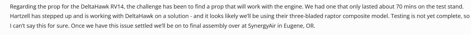

Nice ! What prop did you settle on? Root cause of the first prop that did not work?
Gotcha.
That prop testing (referred to in the previous post) was all before we finished the build or started the flight testing.
Don’t recall the models exactly, but DH had a bit of a problem w the metal props and the harmonics of the prop. But, in the end, Hartzell steppped up and brought their props down to Racine for testing on DH’s stands and confirmed the 3-bladed raptor composite was a good fit. So much so that they are giving the warranty to DH buyers that they give everyone else.
All this said, DH is still talking with other prop manufacturers with the goal of providing a few choices to builders.
Lastly, I can say I’ve been very pleased with the Hartzell so far.
