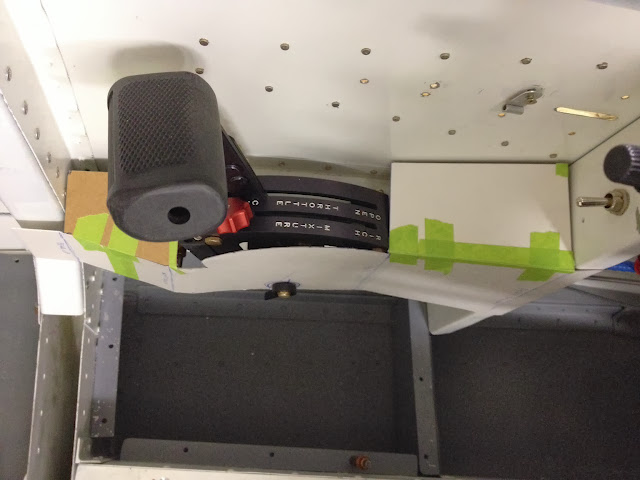

After a few weeks supporting formation flying, I am back to building. Like everything else on this project I keep over-thinking about possible solutions, hence the name DILEMMA for my plane. All I wanted to do was to install the remote ELT switch. I tried different locations then came up with this one after garage flying it for a while. It is out of the way of throttle operations and allows me to keep flying in an emergency. The remote switch is attached to a bracket under the side panel (not shown in pics).
That sure looks nice! I have read the first 8 pages of your thread, if you would do it again, what would you do different?
Thank you for the kind words.
Would have built a rocket. All joking aside. I would do many many things differently. Some are documented on the link provided on post #1. Too many to list.
The next one will be better.
That's a big one...

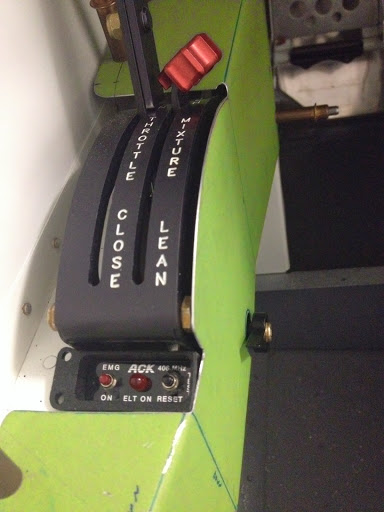

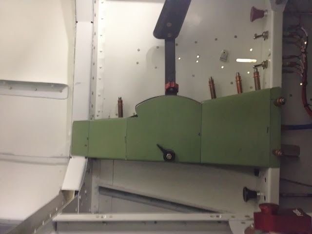

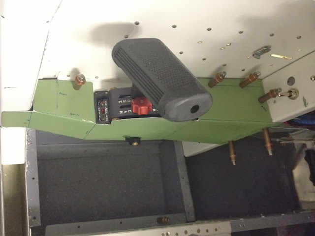

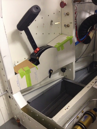

Axel,
I have to say that's the closest to an F16 Throttle handle I have seen on an RV yet, nicely done!
http://www.aerotronicsllc.com/f16throttlegrip.htm
V/R
Smokey
PS:All it lacks (as you know) is a bunch more buttons and switches...:)

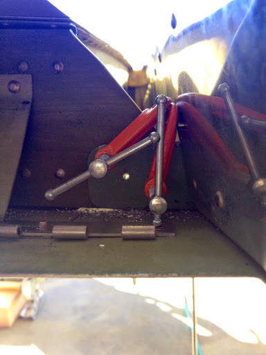

Drilled the elevator horns (took forever) and set up the elevator rudder travel angles/stops. I still need to fill the tips.

Progress is looking good, but I have a feeling your wheel pant extensions are only going to last one or two landings...
That is not the final wheel pant configuration. Will let you guys know how it works out.

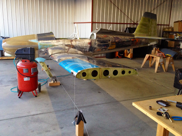

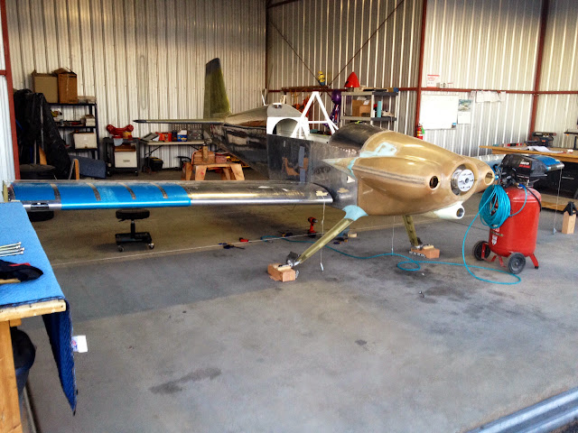

With the big move completed and the new shop set up, time to start working again. Last Sunday I was able to set the aircraft level on all axis. I put the main gear on 4X6 wooden blocks to minimize aircraft movement. I also made a platform for the tail wheel. Once the wings are on, I will level/check everything out again.
Last night I cut the control stick hole on the spar. Hopefully I can do the other wing tonight. The plan is for Dayton to come down on Sat and help me set the wings and drill the aft spar. I keep having nightmares about the 5/8 the edge distance on the aft spar.

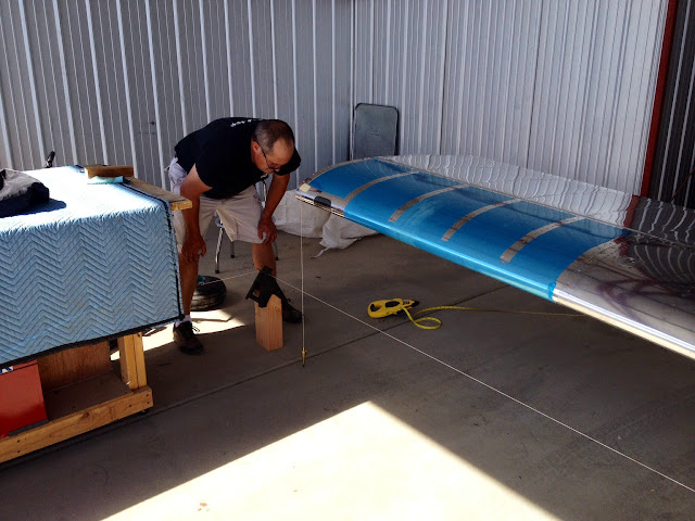

This weekend Dayton came down to help me set the wings and drill the 2 aft spar bolts. We spent all day on Saturday making sure the wings were squared, and the sweep and incidence were the same. We drilled a pilot #30 hole and walked away. We came back the next day and drilled to the final size.
Thank you Dayton. Would have taken me way longer by myself.
One step closer. Below are a few pics.
With Dayton's help, I'm guessing that your wings are aligned to .001"....at least!
Great to hear you've got the wings on - keep up the momentum.
