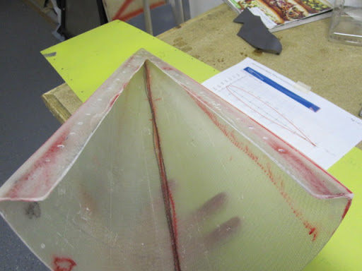

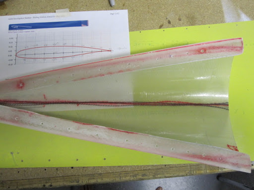

Your workmanship looks great, I'm curious as to how you?ve attached the cheek cowls to the fuselage sides. From your pictures I can see a line of rivets parallel to the cheek cowls, I'm assuming this has something to do with how they are attached. Keep the progress pictures coming.
Derek,
with all the discussions going on regarding builder mods I am wondering how much more I will post about my plane. Especially since most of my pics on this thread are of work in progress.
Break break
Thanks for the complement on my workmanship. Unfortunately, the line of rivets you see around the cone does nothing. The rivets are simply plugs for previous holes I made while I was trying to fit the old cowl cheeks. I was hoping not too many people noticed:( The cheeks will be attached from the inside via pop rivets (gold clecoes on pic #1). Hopefully the attached pics give you a better explanation. I am not done yet. Still have a few more steps to go. I am trying to figure out how to insert the cowl hinge pin from inside the plane via the cowl cheeks.
Now I see
Thanks, I like the way you've mounted the cheek cowls, when the time comes I'll be doing it the same way.Very neat.
Cowl Cheeks
What is best about this setup is you can install the rivets from the inside so the factory heads protrude into the cockpit.
The standard way has the pop " bucktails " on the inside which can catch your hands and looks way ugly. It also fouls the trim lever which in my instance is a very long one which I will have running on a non scuff calibrated arc on the inside of the cockpit hopefully set up to cover as many of the holes as I can.
I might wind up using proseal to glue them on.
Maybe I am being over prissy about cosmetic details. Those rivet heads are gonna annoy me otherwise I just know it !! ;-)

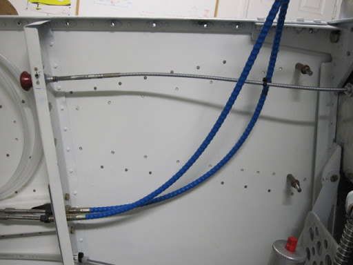

I have been working on the FWF oil and fuel line for a long time. With the help of Brett at Bonaco I was able to mock up my lines. Here are some of the pics. I went to the hardware store and got poly tube. I used the poly tube and the hose ends to get the correct lenght and routing for each line. After I was happy, I sent the poly tube and drawings to Bobaco.
Here are some of the lines installed. The pics make the lines look closer than what they are. It depends on the angle that I took the pic.

Now you've done it. The trial hose using poly is so cheap and simple I feel like a moron (again). I often assemble one fitting on a length of hose, route it, and mark the other end. Your way is better and costs next to nothing.
