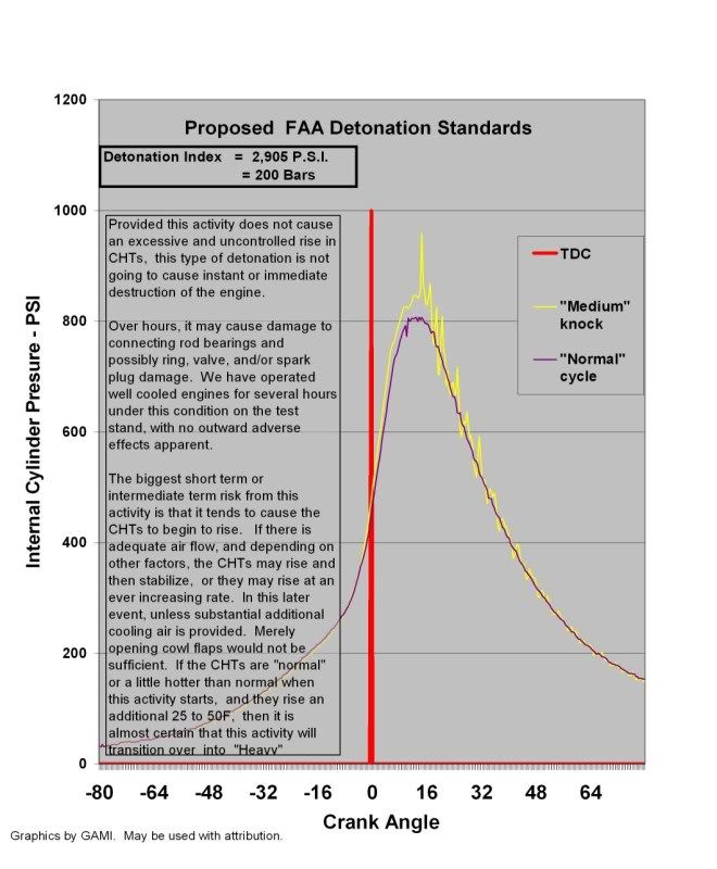

At least some of those little "local pockets" of unburned combustion mixtures have exactly the right mixture of fuel and air to be just a hair-trigger away from exploding.
And … if the fuel is the wrong octane, or the spark advance was set too soon, or the manifold pressure was too high, or the cylinder head temperature was too high ... then one or more of those little "local pockets" of unburned fuel do just that ... they "explode."
That is what we call "detonation".
Each explosion creates a shock wave that travels at the speed of sound (remember, the speed of sound inside the cylinder, at somewhere near 4000 degrees, is very much faster than at a standard day!) and bounces off the walls of the combustion chamber every 1/5th of a millisecond or so (giving off a 5KHz "ping" that you will not hear in the cockpit). Each of those explosions creates a very sharp rise in pressure and sets off a shock wave, which vibrates back and forth across the cylinder. This shock wave can be just the right amount of additional pressure to cause some other little remote local pocket of fuel and air to, in turn, explode, adding to the problem.
As detonation grows more serious, it will become audible, and this is the pinging you'll hear from that old auto engine on the uphill grade. Remember, you will NOT hear it on an aircraft engine."

Moderate Detonation:
