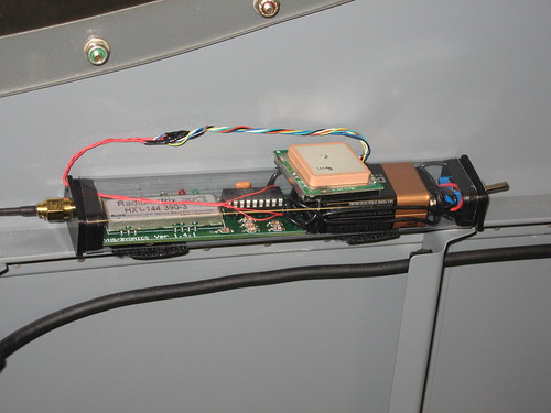

I didn't have time to take my wingtip off and run new wires before my upcoming summer trip, so I rigged up this totally-standalone tracker, using the Micro-Trak 300, a 9-volt battery and the new, tiny GPS3. All this contained in the MicroTrak shipping package, attached to the longeron in the baggage compartment with velcro, and with their lightweight antenna taped to the window.
I also mounted a power switch on the other endcap.
I calculate I should be able to get about 10 hours per battery, haven't reached the end of a battery yet. I'm getting pretty good tracks out of it, though there is some obvious blanking from the fuselage in certain areas.
The GPS3 is also cool because it has TTL output in addition to normal serial output, so you can use it for other projects too.

Not much to say beyond my initial post, all major parts are from Byonics. 9V battery passes through a switch, which then feeds a Micro-trak 300. The Micro-trak also has a 5V output that feeds the Byonics GPS3. The GPS3 data comes back to the micro-trak via a single data wire. Transmitting through their $9 whip antenna.

Seeing your APRS setup and how well it worked (even with partially obscured antennas) pushed me over the edge and I ordered the same radio and gps. I had been on the fence but that was just too sweet.

Which antenna
Paul,
This looks interesting. I'm interested in doing something similar but have a question, which lightweight antenna did you use?
