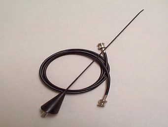

18 inch vs 19 inch whip
Sam,
The Micro-Trak whip antenna is shorter than 19 inches for two reasons: 1) The RF path from the module to the end of the board adds about an inch to the RF path, and 2) Experiments with the spectrum analyzer showed that thats the length that worked best for 144.390 and 144.800 (The European frequency for APRS) frequencies. My antenna design, like my new power supply module, is the result of literally dozens of minutes of extensive R & D in what my friends call "the bat cave". In all seriousness, the design was intended to be cheap and effective: I stole the basic idea from those toy RC cars at Radio Shack....For the gentleman looking for a more robust antenna for portable use, I suggest something like the Diamond R77 dual band whip. He is also less likely to put his eye out.
Pete's antenna is going to have 3dB gain over a whip, effectively doubling your effective radiated power. I would suggest glassing Pete's antenna into the wingtip, and going to a an external whip for going walkabout. Adding a "rattail" ( a 19 inch long strand of wire ) to hang off the antenna connector is a good way of increasing the effectiveness of the whip antenna, although its not pretty.

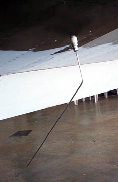

Wingtip J-pole
Hi Guys,
I am having good luck with the J-pole in the the wingtip. The prototype J-pole was not tested or tuned at all, but seems to work pretty well. This antenna design would ideally would be installed vertically, so curling around the front of the wingtip is a compromise. I have hit digipeaters 160 miles out, so it does works.
I do think I get a bit of signal blanking from the airframe, so a few packets are lost depending on the direction of flight. This is not an issue with a belly whip.
The J-pole, driven by Allen's 8 watt retina scorcher should hit digis from coast to coast and keep the cabin warm like a microwave....;):p A sample environmental impact statement will be sent with every order.....

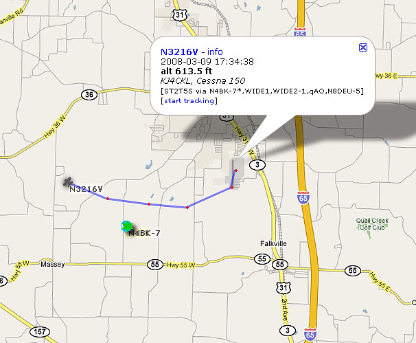

Another Data Point
I put my tracker in my Cessna 150 until the RV is done. Bought one of the Byonics whip antennas. Taped up inside of windshield. Tried it out yesterday and got OK performance until my 9V battery died. Got one hit on the ground and the next one on climb out. A HAM friend noted that I did not have a ground plane and suggested that I attach about an 18" wire under the jam nut (ground) on the SMA connector and stretch out across glare shield. I plan to give that a try next. Also plan to power off aircraft power through cigarette lighter jack.
Alan Jackson
Counterpoise
Hi Alan,
That wire is known as a counterpoise and acts kinda like the ground plane.(I think) it creates a simulated 1/2 wave whip and should perform better - let us know how it works.
It might just be that the 150 is too fast to track:p....... We all flew sluggers and and they are great trainers for RV's:)
Alan Jackson
Good to see you in the air, Alan!
Looks like you hit a repeater 41.8 miles away before the battery gave up the ghost. :)
Does flying the C150 mean you have to monkey with the beacon interval??? :D
Stations which heard N3216V directly on radio over the last 48 hours:
W4GPS-7 5.2 miles 211° 2008-03-08 12:56:44
K4GIG-7 41.8 miles 215° 2008-03-08 13:02:00
KE4ROC-7 9.3 miles 279° 2008-03-08 13:02:30
N4BK-7 5.6 miles 243° 2008-03-09 17:34:38

The design goals for the J-pole were ease of construction and install, reversibility, good performance and modest price. I think we did pretty well against all the goals. The J-pole allows a clean, reversible(no holes) install in the wingtip. We hit digis pretty well, and my twins (with my help) will make you one for $20. Will it beat a 1/4 wave whip for all out distance, I'd have my doubts - Maybe Sam and I should do a cage match flyoff........
I have my antenna mounted so it curves around the front of the airfoil, to give it a bit of verticality(is that a word?).
When I need some extra APRS punch, I just point the -9A straight up and let the awesome power of the O-320 do its thang) (that was a joke).......

Well I have almost completed getting an APRS system ready to go. All that's left is taking the test, and mounting the antenna.
I acquired an old Comant COM antenna (CI-122) since I wanted one that looked like any old standard antenna with a streamlined base. When I contacted Comant (and Rami) about shortening the antenna for use at 144.39Mhz, both companies said their antennas incorporated matching networks and that if I shortened the antenna that these coils and capacitors might prevent the antenna from working well, and both suggested buying their high priced antennas made for that range.
So, I tore into this old antenna and ripped out the guts of all the coils so that all I had was a nice base, and a metal whip. My next step is to cut the whip, and then solder back on a BNC connector and then I'm ready to go.
The question is, from the above thread, it sounds like there is some length that is given up within the transmitter traces...like maybe almost an inch. (Refer to the posts regarding 18" antenna length) And then of course, there's the theoretical 1/4 wave calculation of roughly 19.45" that I could go by. So if maybe Allen or someone could comment, where would be the ideal place to cut this antenna off to make it as roughly accurate as possible....for us anal folk? I'd like to do the best I can, anyway.
I had some SMA connectors for RG-400, so I used a scrap of RG-400 about 18" long and made an antenna cable that is SMA to BNC. Now I just have to put my BNC connector back on the antenna. There IS a small 1" wire lead soldered to the inside tip of the Comant antenna, and I'm assuming that I should count that length into the equation as overall antenna length. On the other hand, the antenna rod is partly inside of the streamlined base of the antenna, which is metal.....so perhaps some of that should NOT count, as it can't effectively radiate or receive when it's shielded by the metal base? So should I measure from the tip? Refer to http://www.comant.com/prodpages/ci122.html
for the look of the antenna.
Care to comment?
Tim
Antenna length
Tim,
On the MT-300, when you have an antenna mounted directly on the unit, the approximately one inch of RF path on the board is nominally subtracted from the antenna length, which is why the cheapie Micro-Trak whip is about 18 inches long. When you remote the antenna, the trace on the board acts less like a radiator, allowing you to use an antenna more closely cut to the theoretically perfect length. I suggest going slightly longer and trimming it down if necessary. (For the truly power mad, you can use a Wattmeter and trim the antenna to optimum length while using a PC to force a test tone.) If you want power, buy the MT-8000 FA! I think its safe to say that the consus of he group is that at altitude, 300 milliwatts is plenty, but on the ground, its not so hot.

...that I have taped to the rear window of my Tiger works quite well in the flatter Eastern US states...
http://www.mail2600.com/cgi-bin/track.cgi?call=N12GA&days=7&hours=0&tiny=1&elim=0
Wasn't too good at 2500 ft AGL in the Roswell or El Paso areas (go back another days track) , but that may be due to lack of ground stations...:)
All I have is the cheapest Byonics antenna that is a fine wire taped to my rear window.
Quite good performance considering.....
gil A - in rainy Burlington, IA - for some reason, I wan't transmitting from MO to IA....:(
Byonics MT8000FA antenna 90-degree adapter
What is the name of the mini cable connector that connects the Byonics whip antenna to the tracket unit? It looks gold plated. I would like to get a 90-degree adapter so that my tracker unit (in project box) can sit on top of my airplane's pane and have the antenna stand vertically. Thanks!
Mike
Pete, Thanks for the SMA connect info. Order one and then saw that my local Radio Shack sells them. Oh well.

I mounted mine in the left wingtip of "PapaJuliette". Did not have another wire there that was convenient so I used the nav light power as others have.
The thing that I noticed is that there **IS** some coupling into the NavAid autopilot servo that is mounted out there in the wing (or is it the head unit in the cockpit?).
When the APRS transmitter fires and the sutopilot is on, there is a very slight turn to the left I think in my case. Not bothersome but noticeable if you are paying close attention.
I can also hear a little in the radio but did NOT get any complaints while flying CLOSE some some of my friends during practice for OSH. Did NOT have it on during the "actual event".

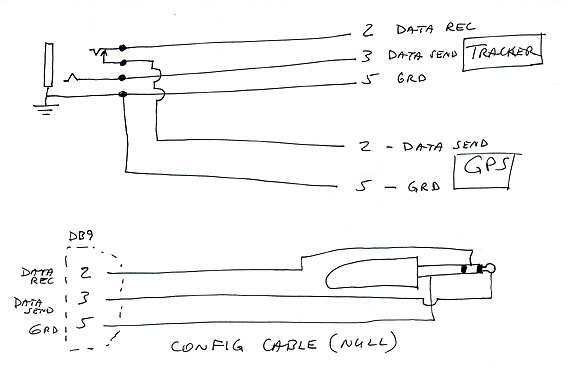

Mike, something I've considered if ever doing a wingtip APRS install is a way to easily program the tracker. I haven't spent a lot of time thinking this through but why couldn't you put an 1/8" stereo mini-jack (TRS connector) in the underside of the tip and wire it to the serial in-out of the tracker? This would allow you to fiddle with the programming without having to remove the wingtip. (plug tip to tracker pin 2, ring to pin 3 and sleeve to pin 5). Just take the laptop to the plane, power up the tracker, plug in the config cable, and tweak the tracker as desired.
The GPS needs to vacate the data "in" pin of the tracker during config, and this could be handled by wiring the jack to disconnect the GPS when the plug on the config cable is inserted into the jack. If the jack was located way up under the wingtip it should be nearly invisible, and a little rubber plug could be fabbed to keep water out of the jack.
You said you wanted to geek out.............. ;)
Yes Sam you are exactly right.
Would require a special plug.
Who knows what the nomenclature on it would be? You know SPST or what ever?
Oh and I received my antennae from Ryan Howell today. He sent the antennae before I even sent him the check. Guess he figures he knows where to find me:)
Now who knows a plug that will do the trick here?

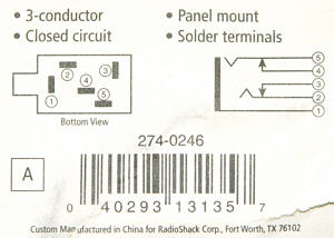

Looks like your local Radio Snack could fix you up:
http://tinyurl.com/5mgns8
You want the type of jack that is used in audio applications where the speaker is disconnected when the plug is inserted. Put the GPS data feed in the "speaker" circuit so the GPS data gets disconnected from the tracker when the config cable is plugged in.
I believe circuit "D" is what you will find in the common "stereo audio" version of the TRS connector. This connector will disconnect the left and right speakers when the headphones are plugged in. You only need one "speaker" circuit for the GPS data line.
Digi-Key should have a higher-priced unit, and no doubt your local avionics shop will have a closed-circuit jack in their parts bin. But hey! We're cheap! Go with the Shack. ;)
Here is how I'm seeing this circuit:
Be sure you apply peer review! (I worked in the yard this afternoon and may have gotten too hot.....mainly check to be sure I got the null part of the circuit correct)
WARNING! I haven't tried this mod, but so far don't see why it wouldn't work.
yes ths will work just fine. Good drawings Sam.
Im going to mount the plug in the wing tip trailing edge support rib. Move the aileron, plug in jack, geek out.
I have rigged the test harness for the jack and it works. Plug in jack, opens the gps connection, closed serial connection from computer. Perfect.!
