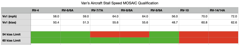

Here's a little spreadsheet I put together for Vans aircraft qualifying based on Vs1 of 54 kias and 60 kias. I took the numbers from information published by Vans. (https://www.vansaircraft.com/wp-content/uploads/2019/02/speeds.pdf and https://www.vansaircraft.com/service-information-and-revisions/n-rv-14-v-speeds/)
I realize that these numbers are only estimates and that for EAB aircraft each builder determines the actual v-speeds for each aircraft during testing.
For better or worse, my POH doesn't even list a Vs1 at max gross. Does that mean it can never be flown by a sport pilot under these new rules?
The person from the FAA that did my inspection didn't even look at my POH. He did do a thorough inspection of the aircraft and found a couple of items that I had to fix.
So the current proposal seems to leave lots of ambiguity when it comes to EAB.
Is there an aircraft that has a max cruise of 250 kias and a clean stall of less than 54 kias? That seems unlikely.
It seems that this proposal is very much targeted at high drag production aircraft. Low drag aircraft like Vans with large relative flaps will have a hard time qualifying.
I would much prefer to see a Vs0 stall speed of 54 kias, than increasing the Vs1 stall speed to 60 kias.
I realize that these numbers are only estimates and that for EAB aircraft each builder determines the actual v-speeds for each aircraft during testing. And I don't believe that all these numbers are required at inspection time. If I remember right the only numbers my inspector required were Vx, Vy, and Vs0.
The best option is to comment on the NPRM and explain why changing the stall speed to Vs1 will not affect the “safety” of the new standard. Alternatively request an increase by a few kts (even 2 kts) so a large number of RVs are included. RVs are well below the 3000 lb limit and do not pose a hazard. LSA rules were invented to limit the hazard to the general population from wayward aircraft.
A few knots would probably get all but the RV-10 and 14 in. I’m probably dreaming, but why not get these two models in under MOSAIC as well? I’m in a partnership in an RV-3 (which meets the new criteria) and I think it’s fair to say that the 10 and 14 are safer models. Don’t you think? :D

Just a quick note about stall speeds. The stall speeds that Van's lists on their website are not the official stall speeds for these ariplanes. The official stall speeds are listed in each aircraft's log when the airplane is signed off for phase II. All of these airplanes are a little different...maybe during phase I testing, the CAS at stall for your airplane was a couple knots slower that what Van got?
MOSAIC specifies stall speed in CAS. Van's lists stall speeds in IAS. The builder during Phase 1 measures stall speeds of their aircraft in IAS. So some effort will need to be made to measure instrument and position error to get from IAS to CAS.
