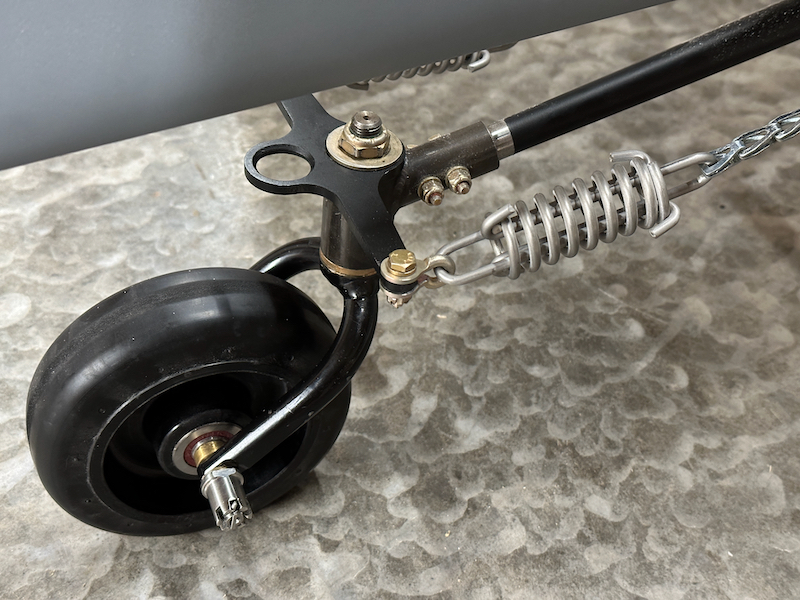

Anybody have a good idea about how to install the tail steering springs/chains using those wire clips? I had a difficult time installing them a few months ago, and yesterday I had to remove them while removing my rudder for painting the airplane. The clips are hard to pry open, and I know I’ll end up scratching my new paint job. There must be a right way to do that, but I haven’t figured it out yet. I’m afraid if I pry the clip open wide enough, it won’t spring back. Plus they rust pretty quickly. Trying to find some sort of chain link (like the threaded ones) that will fit.
I may end going with a steering link if it can be modified. My tail stinger is a cut off original bent tail spring type original to RV4&6 that I modified for a full swivel unit, so it is a little shorter than minimum steering link size. I prefer the way the two springs handle though. If anyone has a good way of installing those clips, please share.
IF we were based close to each other, I would show you.
It is difficult for me to type up the procedure but I could do it in a few minutes.

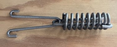

I used AN42B eye bolt on the spring. The compression spring come apart easy and can be slid on one of the spring parts that make it a compression spring. (I forget the name and cannot find the name of the parts right now.) Slide the 'retainer' through the spring and slip the AN42B on the 'retainer' then slide both parts back through the spring.
Maybe the above words will 'click' and give you an idea on how to make the compression spring work with the least number of parts. Tomorrow I can walk out to the hangar and take / post a photo. Ready for bed and do not want to walk out to the hangar right now.
Thanks Gary, a picture would tell me what I think you are saying. I know what you are saying about the compression springs coming apart, and was able to do that while trying to figure this out. In my picture above, there are two different sets of springs. The ones on the right are the ones that I have been using. The springs on the left are just some extras that I’ve had laying around for a while, and they are slightly bigger. On the smaller ones, the retainer clips will not fit down through the center of the spring. On the larger - and stronger - springs, the retainer will fit. And I’m guessing the AN42B fastens to the tailwheel control arm on the aft end, and also another AN42B on the rudder bottom horn on the forward end - with a nut and washer. A picture would say 1000 words.
How I did mine
Scott, here is mine showing how they should be orientated . i made small angled tabs that are loosely bolted to the tailwheel and to the rudder arm giving the chains a better angle to operate. It is IMPERATIVE that you safetywire the loops at the small end of the clip to the spring and chain. This will keep them from slipping sideways and spreading open, which leaves you without steering, and dragging a chain..(ask me how I know).I have the original non-full swivel tailwheel which in my opinion gives the best control of any tailwheel set-up, but unfortunately you cant push the plane backwards.

Thanks for the pictures gentlemen. I like the metal tabs and also the AN42B bolt will work too. Trying to get those chain clips on the thicker tailwheel control arm or the rudder arm without scratching the new paint on them, or spreading them apart so far that they don’t spring back isn’t going to work. A thin tab will be easy to install. How did you keep those chain clips from rusting? The galvanized sash chain didn’t rust and neither did the spring, but those clips rusted before I was through phase 1. I might try 1/8” SS quick links from HD:
https://www.homedepot.com/p/Everbilt-1-8-in-Stainless-Steel-Quick-Link-3-Pack-44384/205882906
480# working load limit.
Or give the clips a flotation test in the nearest body of water.
Wow - I like that idea even better. I might have to buy a $45 crimper from HD for the cable, but maybe worth it. The bottom of the river is a good place for those nasty clips…..

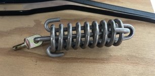

Scott:
Here are the photos without a lot of words.
I had chains like you but found that after 300-hours, they would stretch and need a link removed. Removing a link, they are too short for my liking. After replacing the chain twice, I copied another guys setup and used cables. The cables will last at least a couple thousand hours before they need replaced. The 30-year old compression springs from Van's worked best. The new ones that Aircraft Spruce had were shorter and more difficult to get the hardware through the coils.
My setup as replaced last year.
Following is a show with little tell on how to get the AN42B installed on the compression spring.
Hope this helps and gives you some ideas along with what others have posted. There is more than one way to accomplish this. I tried to have parts that wear that could be replaced before they became unsafe.

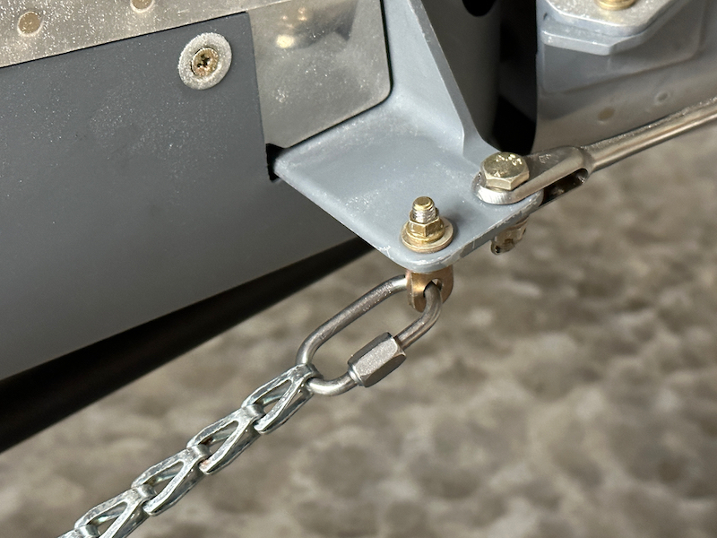

Closing the loop on this for the benefit of future readers... Dan is of course right, a pair of AN115-21s worked fine for me after I opened them up a bit. The best way I found to do this with minimum mangling was to take a large tapered punch and gently tap it through the space between the ears until they would easily fit over the steering arm, then use a nut and bolt to squash them back flat.
For the forward end, I bought some of these quick links to attach the chains to eyebolts on the rudder horn. They look like they will do the job, and I will be happy to avoid the cheesy little clips that have caused me trouble on other aircraft.

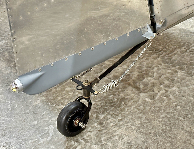

This thread was a great help - here's how my installation ended up. I used AN42B-4A eye bolts and AN115-21 cable shackles as described previously. The removable links at the forward end are Maillon Rapide Links, manufacturer's part number 7350SF-1/8. These are rated for a 440 lb working load and a breaking limit much higher than that, plenty for this application. I put a bit of blue Loctite on the threads to keep them closed.
I’m concerned about the torque/twisting loads on the rudder arm from the AN42B eye bolts. Why not use those cable shackles that are on the Tailwheel arm, and use them on both ends of the chain?
In my case - the success of the many builders who have already used eye bolts here with satisfactory results.
Matt, place the rudder against a stop, and see if the tailwheel fork is still locked to its arm. It should be necessary to stretch the spring to put the tailwheel into swivel. In service we do that with a brake tap.
Yes, it's just short of unlocking with the rudder on the stop. I knew to check for this based on your previous posts on the subject, so thanks for that!
