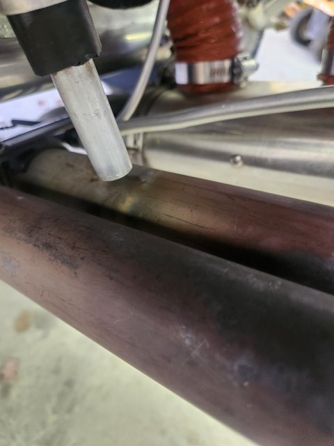

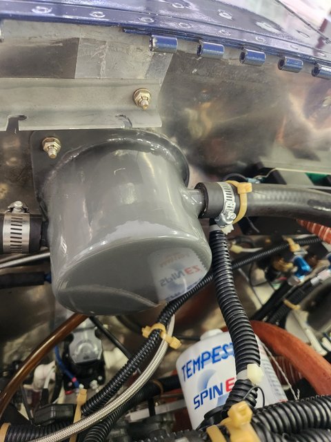

Antisplat installation on my RV-10 with modifications due to issues with carbon clogging of the breather tube.
The good, the bad and the ugly:
Hooking up the breather end of the hose to the exhaust, definitely draws a bit of vacuum on the crank case. I measured and verified this before and after installation. (the good) In 700 hrs of operation I cannot find any detectable leaks or seeps
on the engine, none, zero. (the good) Absolutely no oil on the belly.
The belly now collect a hue of brownish carbon that seems to be more difficult to remove than before when a little oil was mixed in with it. (not sure sure if that is bad or ugly)
Due to early issues with a clogged breather line and a resulting emergency landing by another RV-10 , I installed a secondary check valve ( ugly). I now remove the breather hose from the exhaust port every time I change the oil and run a drill bit down the pipe to clear up any carbon build up. There was significant build up of carbon the first time I inspected this pipe but with regular cleaning I see no build up. Catastrophic engine failure may result if you overlook this important maintenance item.
Returning oil into the crank case from the separator seems to be one of those issues most can't agree on. I can't see why oil separated from water is any more contaminated than oil that is sloshing around the crank case.
On Antisplat's system, there was also a claim of an increase in HP due to the vacuum drawn on the crank case. I can't say that I noticed any increase in horsepower but I haven't been able to measure it either.

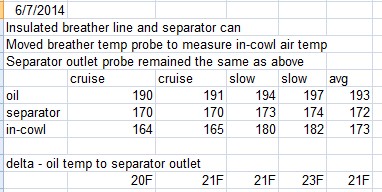

if the separator system is operating at a temperature above the dewpoint of the components we wish to eliminate (water mostly), none goes back to the crankcase. It's in vapor phase and goes to the outlet, be it the freestream or an exhaust tap.

I went ahead and installed the AntiSplat system, into the exhaust, with the safety bypass valve. So far it’s been working as advertised. My plan is to remove the exhaust tap at each condition inspection and de-coke with a drill bit as required.

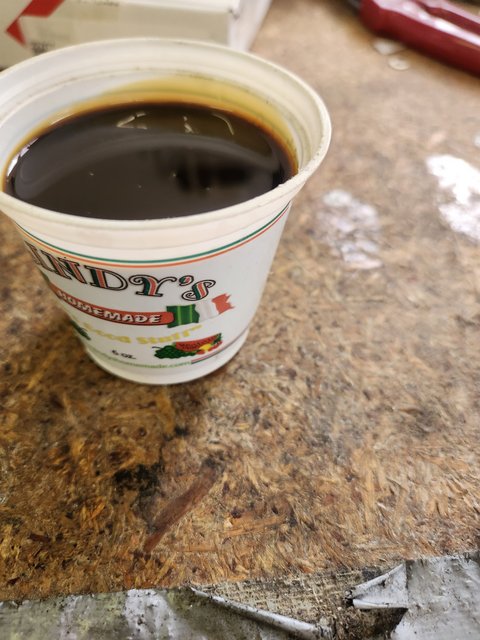

Another survey could be what people do with the drainage from the separator: dump it? Brasso can? Back into the crankcase? It would also be nice to hear from the "experts" on the drawbacks of sending it back to the crankcase. Arguments above to dump it back into the crankcase make sense but may not be valid......:confused:
There is no way I would pipe this gunk back into the crankcase! Most of the drainage is water, a little oil, and this is what remains after a few years... too long... I will be checking it at annual from now on...
Only two ways to to send liquid water back to the crankcase. It left the breather port as liquid (cold engine), or the separator system was acting as a condenser, and cooled vapor back into liquid.

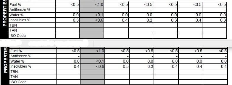

My proof? Decades of using different air/oil seperators and draining the by product coming out from these seperators into a catch can and analyzing. As others said you do not want that in your engine. Half of it is water. The other half is oil emulsifierd with more water and afore mentioned combustion products.

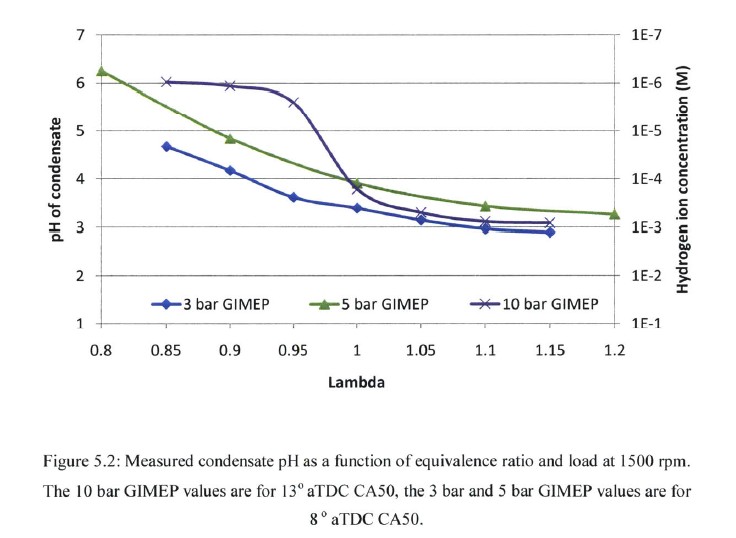

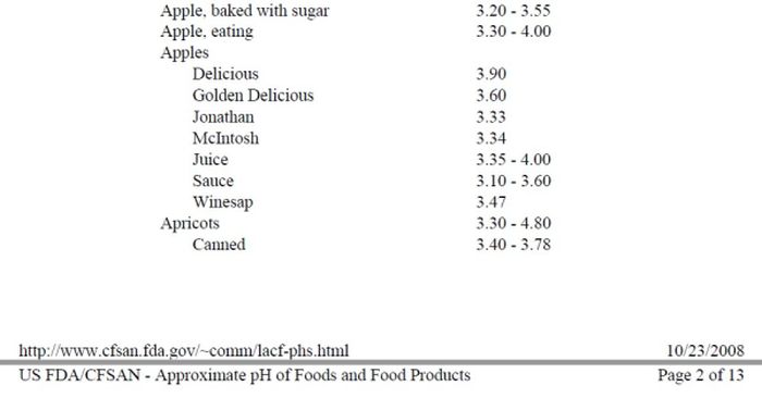

From MIT "Characterization of the exhaust gas condensate pH values of gasoline engines", Ph is in the 2 to 3 in rich condition. Read the chart below. At best in lean condition 3-6 lean, still on the acidic side. I can assure you our aircraft engines are closer to the 2 to 3 range. One we have a lot of blow by and two we run rich a lot. In other words it is "NASTY". You don't want to keep combustion products in your CRANK CASE. It seems like common sense, no?
https://dspace.mit.edu/handle/1721.1/106780
Scale if acidity and alkaline
More over one big by-product of combustion is H2O, not including H2O that condenses inside engine when parked. You agree dry air inside engine is good. Moisture is an electrolytic and causes corrosion of the steel inside engine (cam, lifters, rods, crank. accessory gears, rings, cylinder bore).
"From MIT" sounds impressive, but the referenced document is a grad student paper, dealing with acid formation in an exhaust gas recirculation cooler...the polar opposite of the desired conditions in a separator. But hey, let's humor your choice.
The student predicted PH of the condensate in an EGR cooler would be 2 to 4. When the student actually measured the PH, it ranged from 3 to 6, with lambda (approximately peak EGT) being about 4.
Rich and high IMEP (full throttle) was 6.
Perhaps a wee bit excessive. Not that it matters a whole lot (the above PH values were for water condensed in an exhaust cooler), but a PH of 4 isn't so bad. Apples are in the threes:

BTW, why am I sure about the separator system temperatures? The gray wire is connected to a thermistor inserted into the separator outlet. Initially there was another in the breather outlet on the accessory case, which confirmed breather outflow and indicated oil temperature were essentially identical. Later it was tasked with in-cowl temperature. Insulating the breather hose with a length of firesleeve, and the can with fiberfrax and aluminum tape, keeps the system from becoming a condenser. Gas temperature only drops about 20 degrees. Both inlet and outlet are well above the dew point for water and fuel. That's the key.

Two Blackstone reports, different owners, different airplanes...fuel and water content before and after the installation of separators with sump returns.
I have the simple (and inexpensive) ACS air/oil separator on the firewall.
https://www.aircraftspruce.com/catalog/eppages/hboilbreather.php
It drains to a ~12oz Brasso can and the breather hose exit extends down to the normal spot above the exhaust pipe.
The first photo is the ~6oz of oil that emptied out of the Brasso can today - about 80 hours of engine operation as I empty the can every other oil change.
The point being if not collected much of this oil that came out of the breather hose would have plated out on the bottom of the fuselage. From experience I can report that 6oz would make a huge mess. This is the reason I have an air/oil separator.
Side note - I’m adding one quart of oil every 30 hours or so - as in I’m not blowing oil out the breather line as you can tell from the lack of stain on the exhaust pipe. 374 hours on the engine.
Carl
No oil return to the engine
No crankcase vacuum valve stuff
