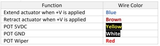

I just received the new style Vans flap motor in my kit but I can't find any info on it. Does anyone know what the pinout is?

If you look closely at the wires, the heavier gauge red wire and the only black wire are your power wires. Just reverse polarity to extend/retract.
Sorry for that description, but there aren’t pin numbers on its molex plug.
Progressive automations does have a data sheet on their website for this, but I had a hard time following their pin callouts.

The manufacturer's documentation for this flap motor leaves a bit to be desired...
The thick wires are flap motor power. The thin wires are for the potentiometer. Yellow is power. Red (or Blue) is signal. White is ground.

The supporting engineering dept. just provide the following and I believe work is being done to incorporate it into the install documentation.

Scott and Eric thanks for the info, exactly what I was looking for. I had figured out the main motor wires but was unsure which wires were what for the pot. I'm glad Vans came out with this new motor, I was going to install the ph aviation one but having the mount already redesigned is easier.
