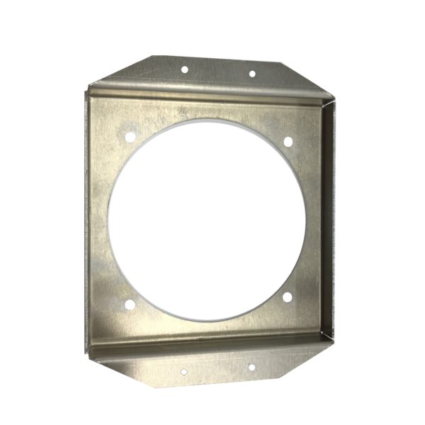

Great idea! I set my G5 up to be a backup as a standalone backup navigation instrument in the event of an entire EFIS failure, even putting it on a different power bus switched from the right master. I reasoned that if I wanted a backup ADAHRS for the 5400, I can stack a second SV ADAHRS unit back there. Ironically, the main reason I replaced the 4500 with the 5400 was a failure of the original XBOW ADAHRS that was built in to the 4500. By using the 430W as its GPS source, I can get the G5, HSI or DG, to display track instead of just course. The G5 is a great instrument, and its price for the Experimental segment is outstanding, especially since that version can be switched between HSI and DG, whereas the certified version can only do one of the other (you would need two G5s for your certified version to do the same job as one Experimental version.
I do note that they make a recessed frame that allows the G5 to be mounted flush with the panel. That would be nice, although cutting the panel for it demonstrates a real commitment.
