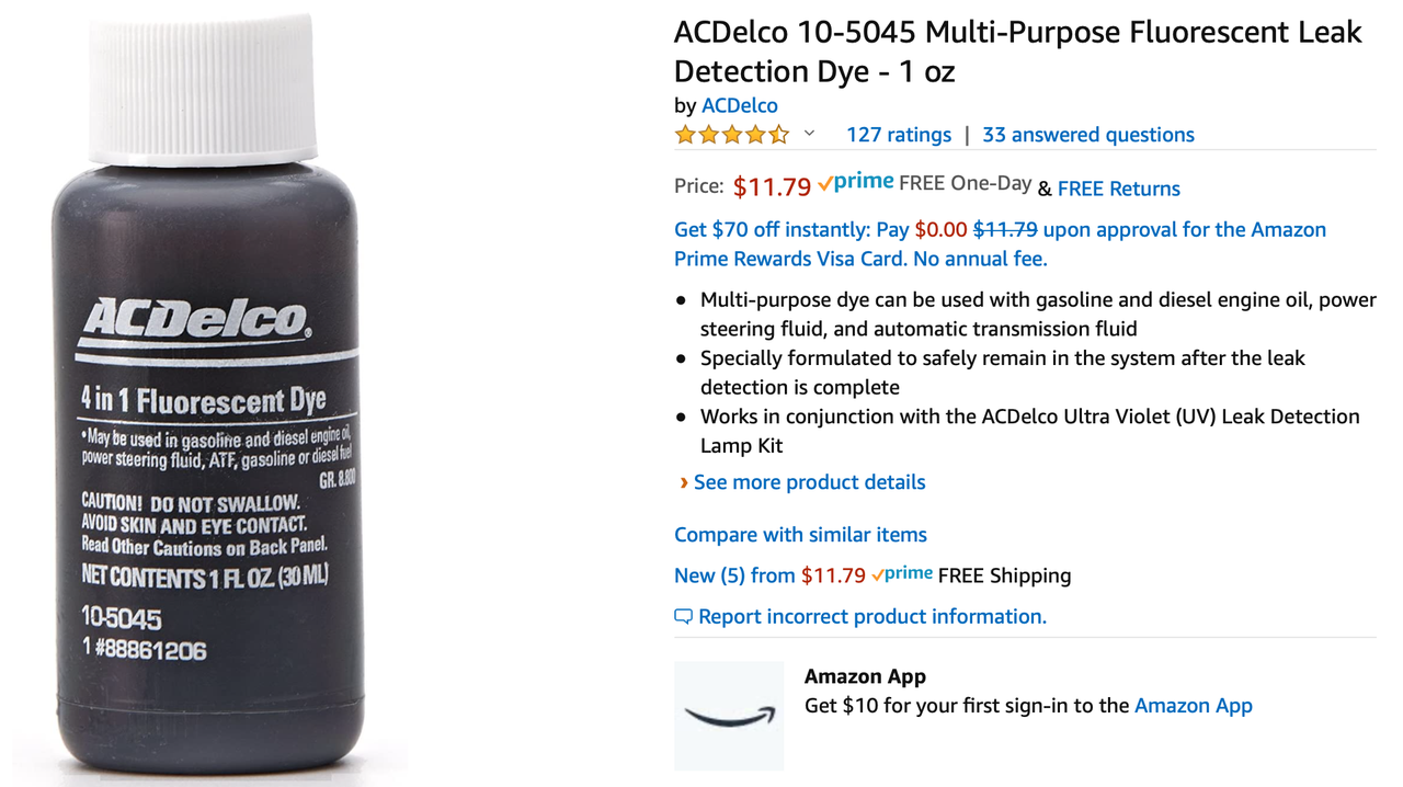

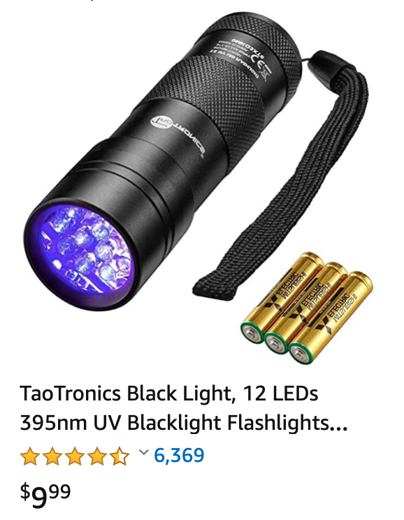

I used fluorescent leak detection dye to find a stubborn leak in my fuel tank. The fluorescent tracer will show smallest leak.

I have the fluorescent dye coming, thanks Jim. After running that through the system I'll pull the top cowl. Based on what / where I see I will recheck the float weights and check the adjustment on the float arms.

I put the dye in the tank and went out and flew .5, came back, pulled the cowl and saw some coloring around the carbs. Without comparison, and having never used the dye before I wasn't sure if it was old or new. In hindsight I think it may have been old fuel, it was more orange than yellow.
I ran the pump for .5 minutes and removed both carburetor bowls. The fuel levels were about .52" from the top on both with the floats removed. The float weights were 3.30 grams for both rights and 3.15 and 3.20 grams on the left. The gaskets on both carbs both looked good but I replaced them just to be sure. I used part #15-08666 gaskets.
After reassembly I ran the fuel pump for .5 minutes. I rechecked my work with the black light and when I shook the carbs slightly I could see the fuel seeping out of the gasket on both bowls. I disassembled the left carb bowl and carefully re-seated the gasket, refilled the carb and with a little sloshing could see the fuel seep under the gasket again. This dye stuff works real good for seeing the leaks.

The dye in the fuel tells me more than I would ever know.
I gave up last night after reassembling the bowls for the second time only to see the fuel weep out from under the gasket again....but I only could see that because of the dye and the black light.
Tonight I rechecked to see if any fuel would leak and there was no leaks. It seems that the gasket over 24 hours conforms and makes a seal.
I suspect everyone has a fuel weep immediately after a new gasket is installed but doesn't see it, the dye is the only reason I knew.

Glad UV Tracer is working to help find leaks. Real eye opener...
Let us know what you find after a few flights. Particularly interested if fuel present at overflow/vent tubes.
