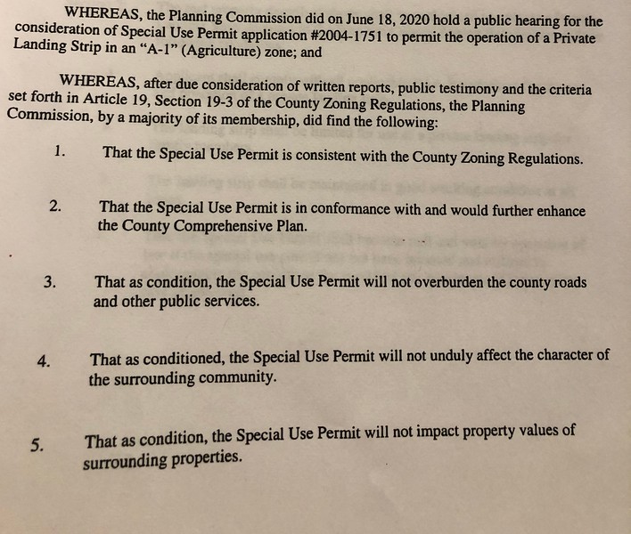

I'm not a lawyer but the initial planning commission findings are very favorable:

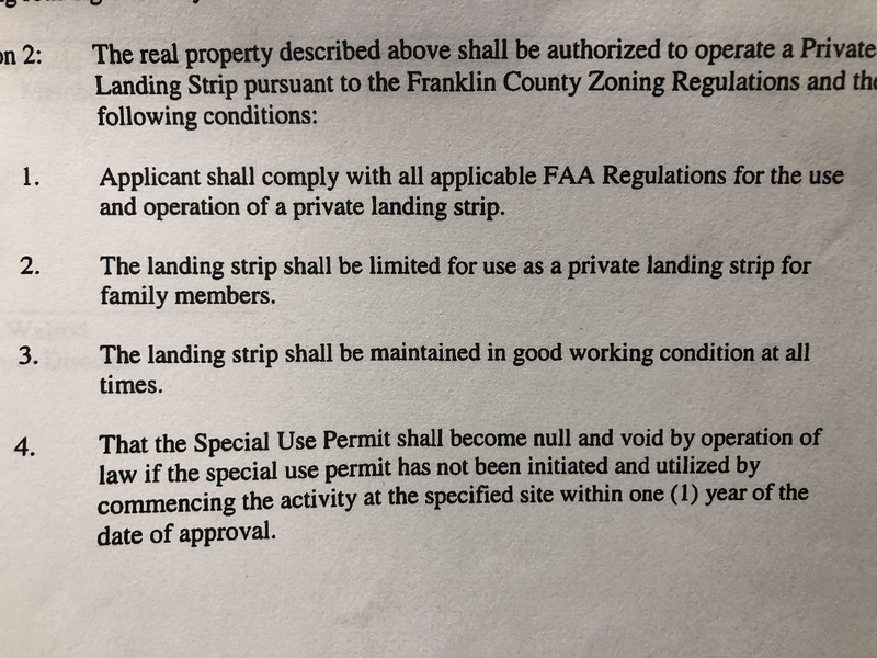

But Conditions 2, 4 seem rather restrictive, the rest I would comply with 150%.
I'm not too worried about 4, depending on their interpretation of "initiated and utilized" I can bribe a friend with a Cub to land anytime or drag some dirt with my old Allis WD.
Condition 2 worries me. A landing strip just for "family members" doesn't seem reasonable, I'm sure I don't have to explain this the the VAF people. One adjacent neighbor has already checked into flight training and his brother in law flys a Pa-32 around. I'm not sure if a logical explanation will suffice to the county or if I need to get a lawyer. I'ld really like to handle this on my own, partly $$ but mostly because I don't think any local lawyer would have the proper knowledge and definitely not the heart of the matter in mind.
A restriction to just family members seems unreasonable for a private airstrip, I'ld like to think I have a lot of airplane friends that would want to stop by. Realistically that's a handful a year, maybe doubling the 3-6 operations a month on average.
I would definitely appreciate thoughts and advice from those that have gone before me.
Thanks!
I have not gone before you, but I would ask the county....
If I was applying for a permit to build a driveway to my house, would it be restricted to family member use only??
I think 2 should be more like:
2: The landing strip shall be limited for use as a private landing strip for family members or users pre-authorized by family members.
"Private" VS "Public"
I think the intent is to prevent future public use, so how about inserting: Family Members (& Their Guests).
The reason for #2 may be based on state aeronautical code. It would be in Alabama, where the code spells out different land requirements and licensing for public and family use.
For reference, here are the relevant code sections. The airport license is granted the by the Dept of Transportation; municipal or county permission, including zoning, is a separate matter.
(b) Private Use Airport that is used primarily by the licensee but available for use by others upon specific invitation of the licensee. To be licensed in a private use category, an airport shall meet without exception the minimum standards of effective runway length of 1800 feet. The minimum usable runway width of 60 feet shall be applied for hard surface runways and a minimum usable runway width of 60 feet shall be applied to turf or sod runways. Invitation of licensee refers to a specific offer and acceptance type of invitation, not an invitation offered to the general public. A holder of a private airport license cannot advertise in a newspaper or other publication that all airplane owners or certain aircraft type owners are invited to be the licensee?s guest at this private airport. An invitation to land on or use the facilities of a private airport must consist of an invitation and a response. Communications between individuals, not a general offer to come to the airport, must exist.
(b) Personal-Use airports are not required to be licensed. A Personal-Use airport is a restricted landing area on private property, designated for the use of the property owner and his, or her immediate family.

Thanks everyone! We just had our county planning committee zoning hearing, our special use zoning permit passed with all yes’s. Now on to the county commissioners, odds seem to be in our favor.
Only 1 letter of complaint of property values, planning commission had already mostly ruled against the complaint and my wife’s cinnamon roles and an explanation of what our small grass strip would consist of took care of the rest.
We were also able to amend the aforementioned restrictions to:
-comply with applicable FAA Guidance on private strips
-is limited for non commercial purposes (pay for use of)
-the landing strip shall be maintained in good working order
-The zoning goes with the land.
Things I believed helped our positive outcome:
-my wife’s cinnamon rolls and visiting with the neighbors
-Thanking the board members for their service and explaining our past residency and continued residency
-Referencing KDOT’s airports division’s position that FAA guidance on private airports is restriction enough
-Having local private strip data and letters on the small amounts and type of operations expected. My example was a private fishing pond in your back yard, you want a few friends to enjoy it with your express permission.
-3 local long term resident pilots to Share their comments in person, one has served on several local advisory boards
-a local developer’s advice to use key language, “the proposed restrictions cause an undue hardship and de-value the improvements I’m making to the property.
