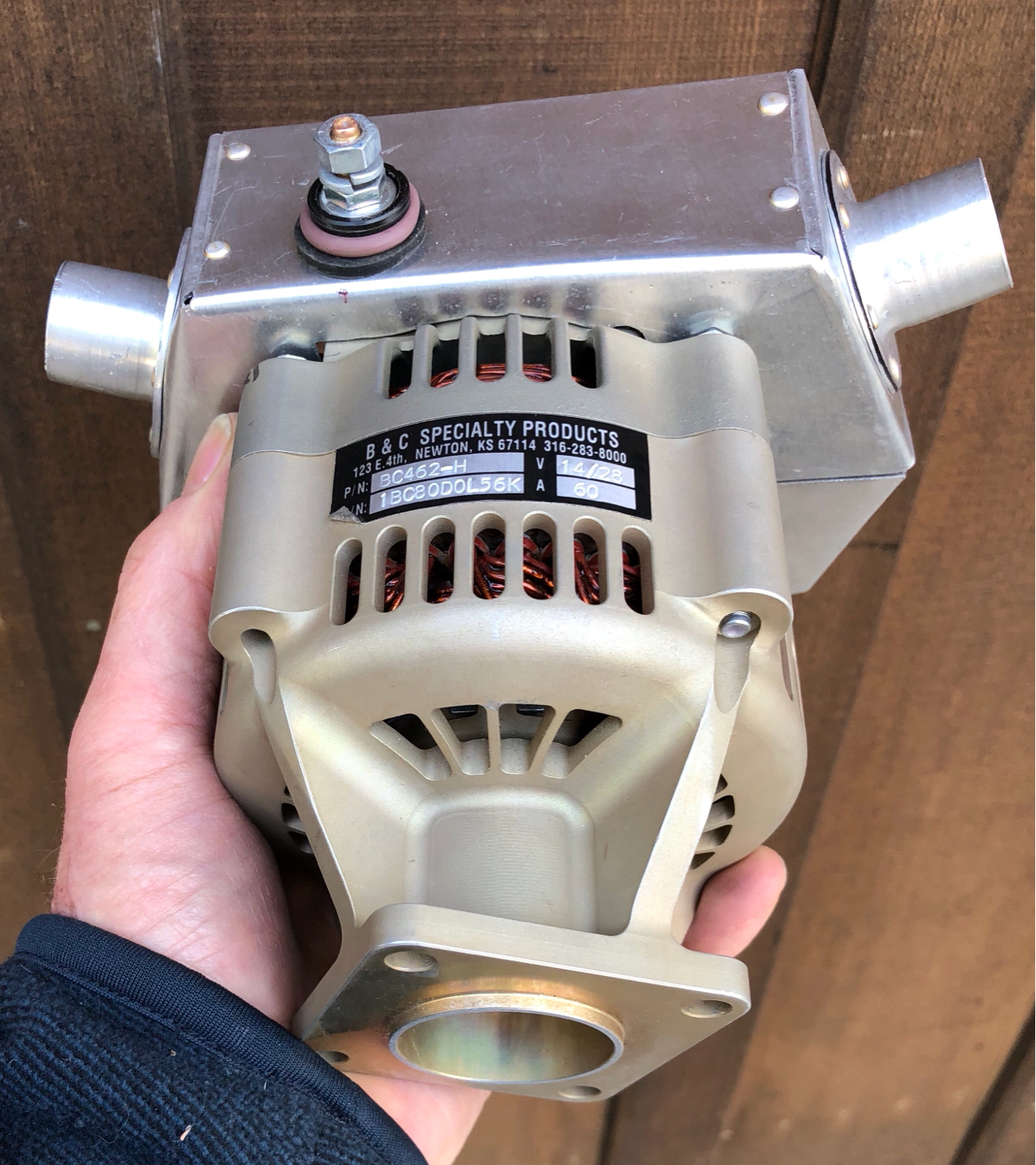

My solution to all of these concerns was to build a closed shroud around the rectifier assembly, pressure fed with cold air via a 1” SKEET tube connected to the point of highest pressure recovery at the rear engine baffle.

I first made the installation leaving the belt-driven alternator in place with an on-off-on alt-field switch installed so that I could select either system. Performance of both alternator and shroud have been spectacular during the 12+ flight hours of testing that I’ve completed, and I’m now confidently removing the belt driven alternator and its drive pulley from my bird. The new system including shroud and regulator added about 7.5 pounds total, and I’ll soon be able to report how much weight the items I’m removing have saved.(edit note- total weight removed at the propellor station= 10.25lb.)
In cruise, the rectifier section exit-air temperature magically stays almost exactly 100°F below oil temperature regardless of altitude or power settings. The indicated bus voltage on my EMS remains locked at 14.0V with an indicated 1-2 Amps positive at all times in normal operation, and I’m happy to report that the low-voltage light supplied with the B&C regulator stops flashing at a fast idle of just 1,000 engine RPM in normal operation.
I conducted the “acid test” during a long cross country, cruising at 9,500’. First, I allowed plenty of time for everything to stabilize, with OAT at 43°F, oil temp at 173°F, and alternator exit air temp at 72°F, 14.0V and +1 Amp indicated on the EMS.
Next, I turned off the alternator field, and flew with an indicated load of about minus 12Amps on battery power for about 20 minutes. My current battery is a near new Odyssey PC-680.
During 20 minute period, with a load of about 12 Amps, indicated bus voltage slowly dropped from 12.2V to 11.7V. Interestingly, the alternator temperature dropped just 3°F to 69°F, probably corresponding to ambient temperature of the pressure cowling, whose differential with the 43°F OAT of 26°F is a combination of pressure recovery elevation and radiant heating from the engine within the pressure cowl itself (which likely explains the fixed alternator temp vs. Oil temp differential). This suggests that quite a lot of air is being “stuffed” through the rectifiers and fan by my shroud. Once I have a chance to fly in hot weather, I may be able to choke down the cooling air supply a bit, but I’m in no hurry to do that.
When I first re-energized the field, the battery absorbed an indicated load of fully 32 Amps, so with the equipment load of 10 Amps the Alternator was putting out 42Amps at 2550 RPM (3315 alternator RPM). The BC462-H was able to maintain 13.6V into this load- pretty impressive. During the next 16 minutes, the alternator temperature slowly climbed from 69°F to a maximum of 79°F and returned to the original 72°F as the battery re-charged and the indicated amperage slowly dropped below +3. Pretty cool!! - Otis Holt
