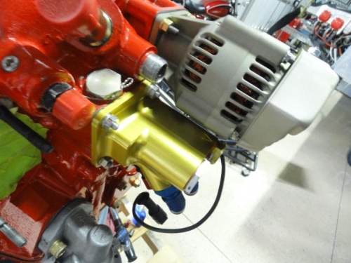

Just received my B&C 410H which I believe used to be sd20 but won't fit on my IO540 with the oil filter adaptor I have. Is there a simple resolution without having to redo oil filter?

When you have the SD-20 (or newer 410) in combo with the B&C filter adapter you wind up with a spacer on both. Their oil filter adapter gets a 1.4" spacer to clear the engine mount and the SD-20/410 gets a .75" spacer and different shear coupling. It's pretty easy to change out the shear coupling and add the spacer yourself, just give them a call.

I had that problem with the tach sender interfering with the backup alternator. The hydraulic pad won't work for the alternator. I've finally got a tach sender with cable that works. My oil fiter adapter was no problem because I got the Airwolf remote filter and that adapter just clears the alternator by 1/8" (put the alternator on first). I know you don't want to mess with your filter setup, but if the extension does not work then at least you have an alternative.

Sounds like that's what I need, my engine came with a 2.5" ofa spacer so I do need to change both, confirmed and ordered thru b&c today.

Is that the 410 or 460 in the photo above?
Mine? It's the 462.
