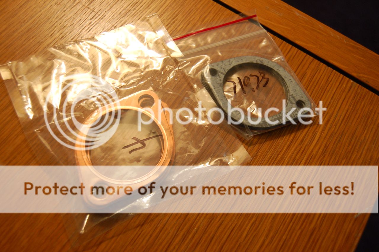

....I have been watching the threads on intake gaskets and their shortcomings. This is and has been a problem with Lycoming engines since their conception. This is one of the main causes of rough idle and a lean cylinder out of sink with others etc on carburated engines. There have been some efforts here recently to solve this issue with " Fluorosilicone Intake Gaskets" and this was a step in the right direction, but not necessary. I didn't say anything about this until now because it appeared a considerable amount of effort and expense had went into getting gaskets made and distributed. I didn't want to look like the party spoiler, but now it seems to have died down so here it is. We solved this problem in the mid seventies, haven't used a Lycoming intake gasket on any of the engines built or serviced by us since, and have never had a failure or problem. As a matter of fact we reuse our gaskets over and over. The gaskets you want (Spruce # 77611) are actually copper exhaust gaskets. They have the exact same bolt center distance and bore as the intake ports and will last the full life of your engine and then some. We usually coat them with a very thin film of high temperature silicone if re-using them. This gasket has a crush ring, is made of solid copper, and is literally blow out proof. This will solve all your Lycoming intake leak problems permanently. This is one of those "rock and hard spot" situations! Some having had a need for gaskets will be mad that we didn't post this sooner, and others involved in making or distributing the fluorosilicone, that we posted it at all! We are not trying to rock the boat, just offering a 100% solution to the problem. Regards all, Allan..:confused:.:eek:.:o.:).:D

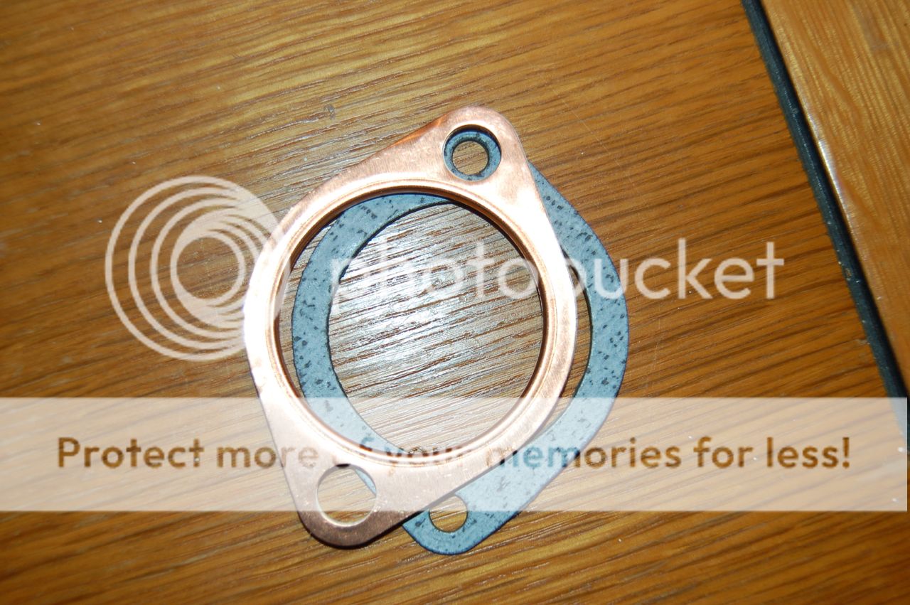

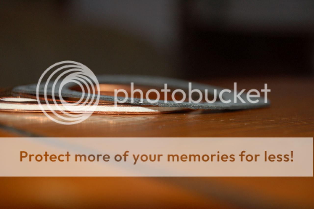

Below are some pictures to compare.
Thickness.
For a seasoned A&P it's very easy to center oversize hole but for a freshly baked repairman who shoveled all his biannual pocket cash for that new motor it's kind of scary :D

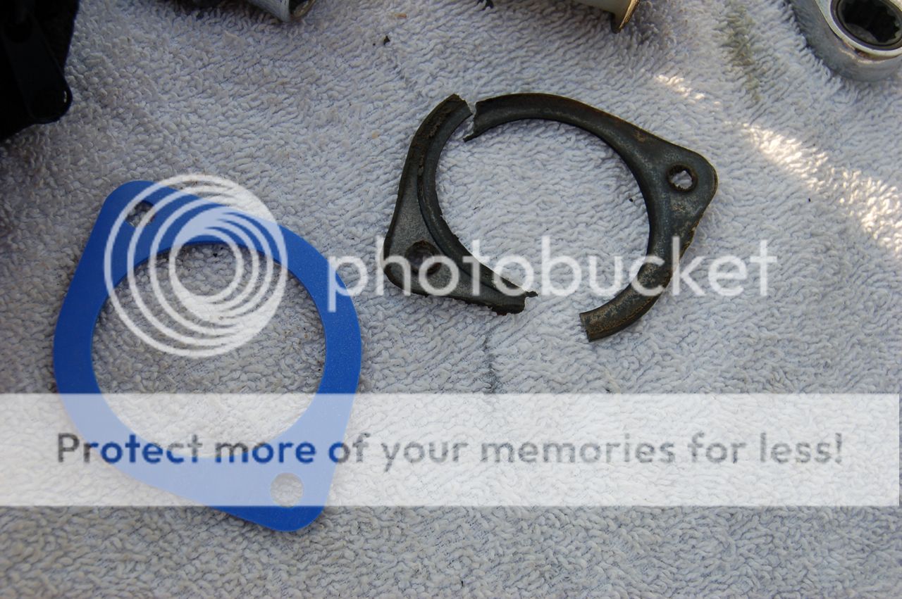

The flurosilicone gaskets are much easier to install just watch the torque it's so low. Almost 200 hours on beta and nothing to report ... :)
I tried installing one of the silicon ones and never felt comfortable with the torque. It seemed they were squeezing out.

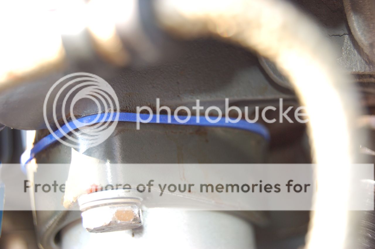

I experimented and liked the results. This is how the gasket looks after 400+ hours still reusable if you flip it. The challenge is to perfectly center it while installing. It accepts torque values for paper gaskets and stays leak free.

.... It is actually very easy to center them. You simply rotate them as far as possible against the studs, and they will self center the bolt hole radius, then tighten them up and you are good to go. They will last the life of the engine, not get loose, leak or come apart. Happy New Year everyone. Thanks, Allan...:D

The gaskets that have been recommended in this thread are not the no-blow brand exhaust gasket (all steel with the laminated crush area).
They are 100 % copper
Though I am not endorsing or recommending against there use.... I have zero personal experience with this modification.
77611 varies
Thanks Scott.
The 77611 I got from spruce is not copper but rather appears to be steel outer with a crush ring inner. They look like no-blow.
Update: Just got back from Aircraft Spruce and PN 77611 will get you steel no-blow gaskets. The Spruce part number for the cooper exhaust gaskets is (07-03090) . The lycoming part number is 75118.

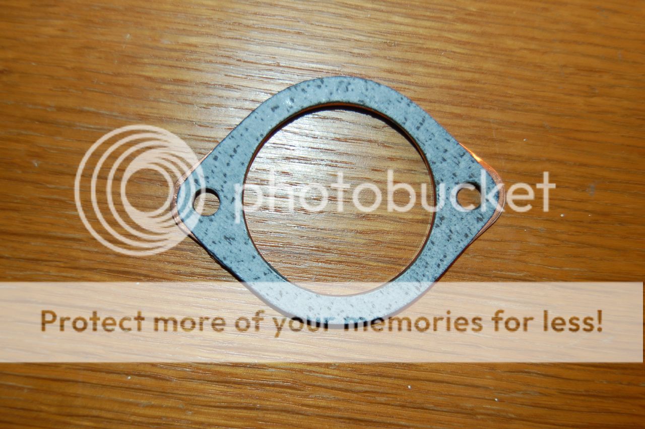

Brian the gasket above is of a copper/asbestos sandwich. The space rubber examples went back to the developer lab. That's how they looked. Version 1.0.
So the copper / asbestos sandwich are the exhaust gaskets allen was talking about? And you are still happy with the performance?

Yes, Jeff very happy. No leaks for long time. These types.
Paper gasket is there for comparison only. I don't use them at all.

If you look at the copper gaskets they have a raised portion that I would suspect would go in that relief area you mentioned.
