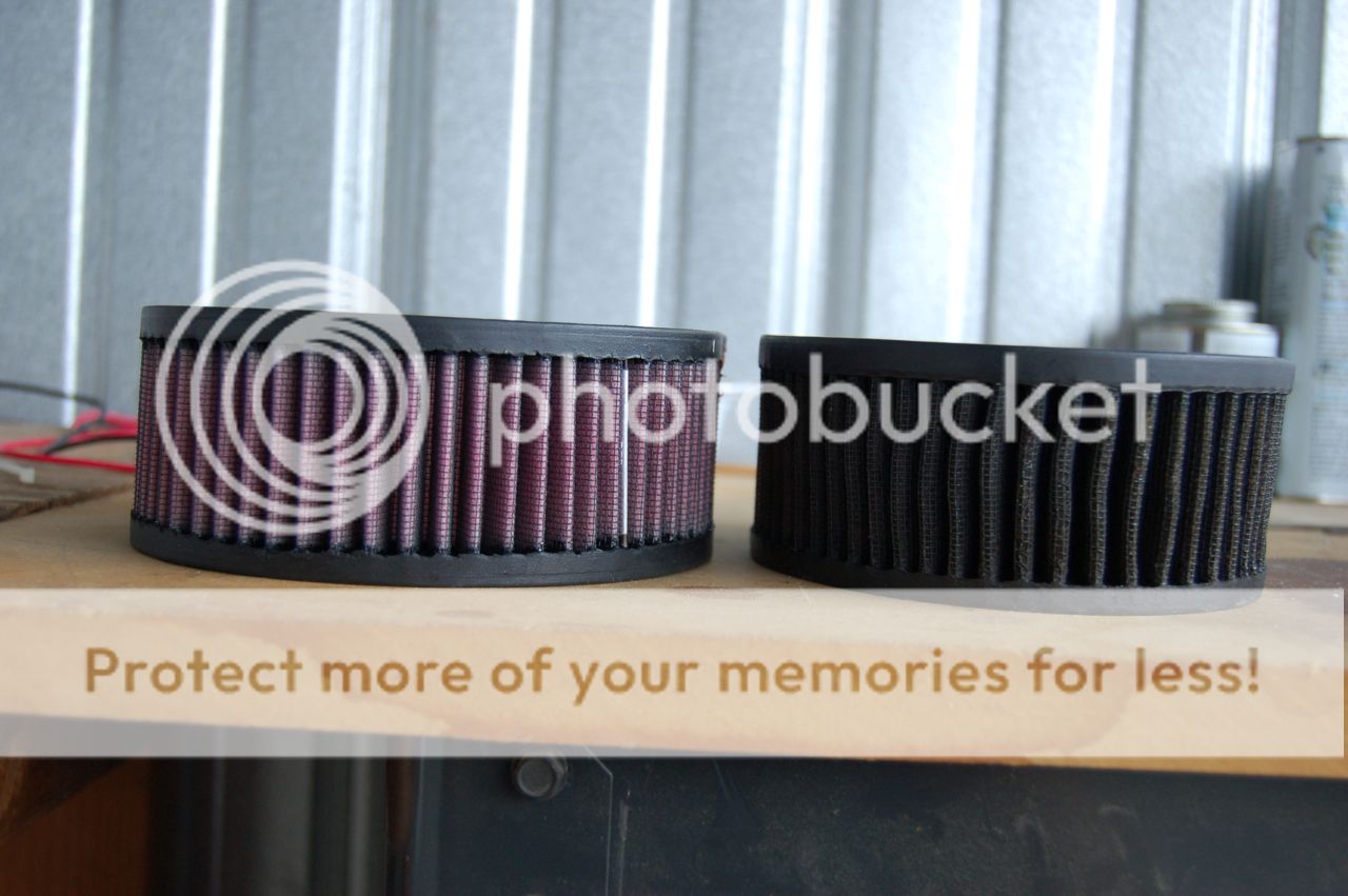

I find this all the time...
Wrong:
Right:
The E3450 you get from Van's is not the same as the E3450 from Spruce or other sources, the smaller ones lack the 'B" suffix seen here:
I've not found another source other than Van's for the correct filter.
That's my point, the A077A6 is not the same as the A077A6-B but both are listed under the same E3450 PN.
The K&N filters are known to shrink over time, whether from heat or some other reason. How old/ how many hours on the one in the first pic?
I've bought E-3450 from Autozone and it's the same as the one from Vans. Same K&N part #, stands to reason it's the same unit.
I guess I'll just have to go buy one at AZ and then compare it to the ones I get from Van's.
I've seen this at least half dozen times, perhaps they all shrunk exactly the same amount :confused:
Are you saying you've never seen these filters shrink over time? Also, I'm still curious how many hours were on the smaller one. We could be talking about two completely separate issues here.

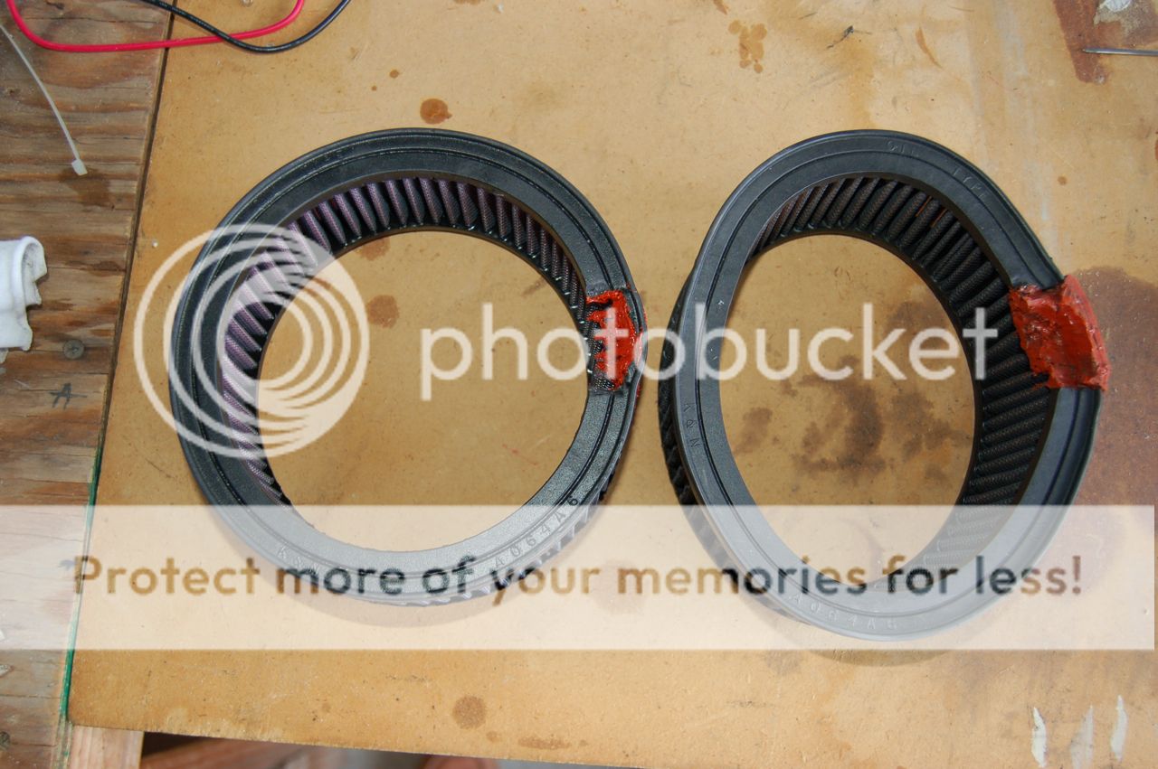

I had one shrink and over the course of the 300 hrs this year, the relative movement had worn a hole in the bottom of the filtered air box.
Re glassed with 4 layers of cloth.
Well looks like you guys are right, the filter I removed is a full inch less in ID/OD measurements than the figures posted above by Brantel which matches with the filters I get from Van's.
I am amazed it could shrink that much!
So I guess the title should be changed to "The Amazing Shrinking Air Filters".

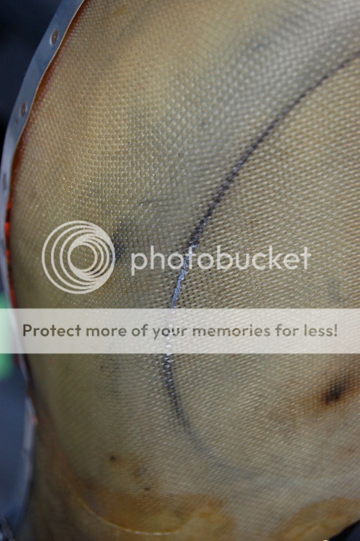

I bonded a .032" aluminum plate to the fiberglass bottom to prevent the filter from wearing through and to provide better attachment for the alternate air door.

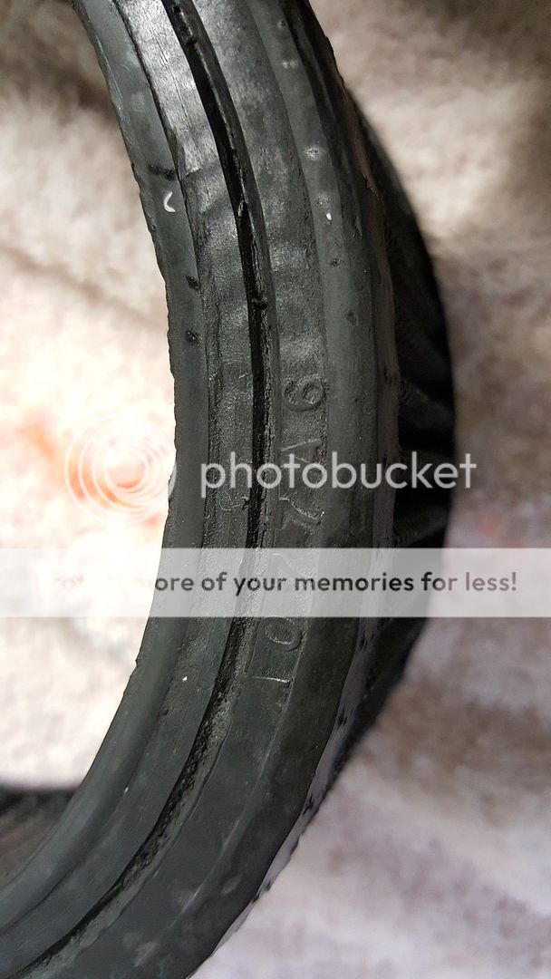

So please help me

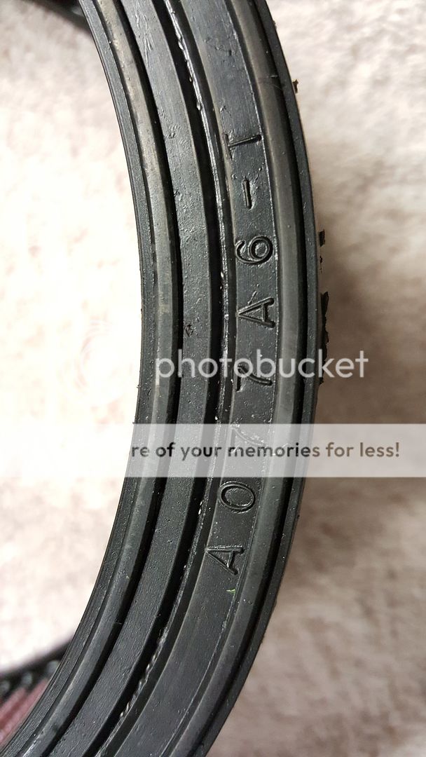

I received my FF kit.
Nowhere does the part# E-3450 appear on the filter, only on inventory list. It was sealed in a plastic bag, no box. No VANS or K+N number on the bag.
On one side it says A077A6-T, on the other side it says A077A6-B.
The measurements are as supplied in Brantel's post.
It is round and not oblong as shown in the plans. What keeps it in oblong shape inside the FAB. (I have not build the FAB yet, but could not find the answer to this in the description).
Printing on the filter also says "oil before using". Is it OK to use as implied in this thread? Is there a way that I can tell if it was indeed oiled? It has pink/purplish color to the element.
Thank you.

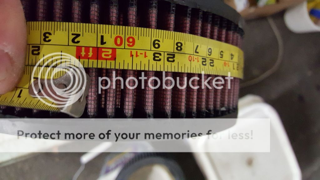

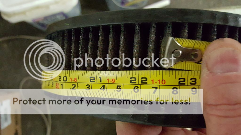

I had 25H TT on my filter before needing to do my condition inspection. I removed the filter which fit just fine, it did not snap off or anything odd. It sat for a couple hours, still fine. I washed it (K&N filter wash) , set it out to dry (breezy sunny day after a gentle air blow off). Was wrapping up and pulling stuff in to find one side of the filter had shrunk significantly, diametrically, over three hours of drying time. It looks like a trunchated cone now. I can't say if just letting it sit would have caused the same shrinkage, but I'm suspicious of the washing process. I'll go to blow-off/shop vac/re-oil for regular condition inspections now, and a periodic replacement (3 years? 5? Depends on degradation or deformation) rather than washing.
