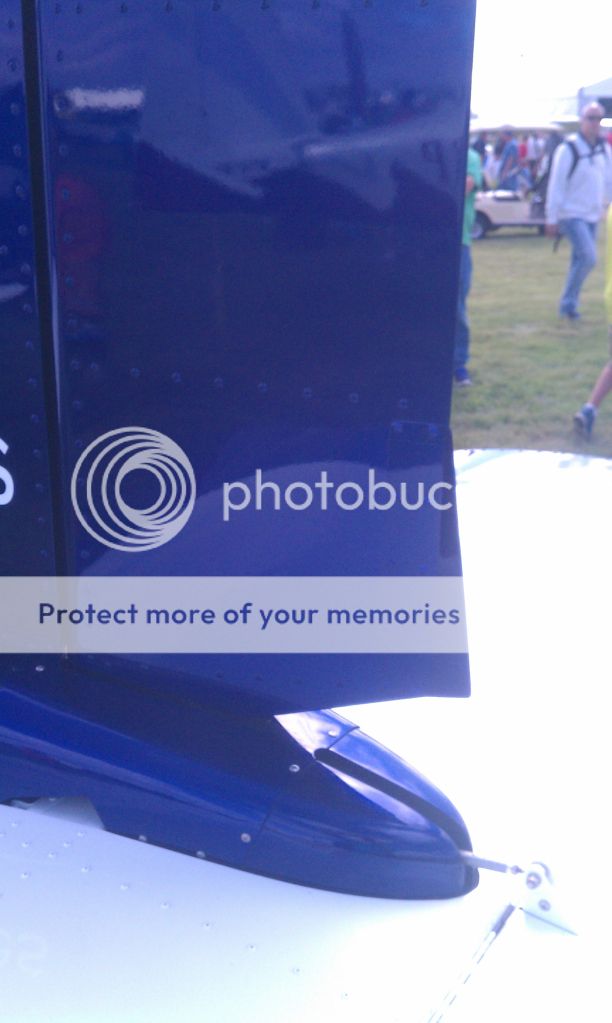

One of the first factory built RV12 at OSH 2013!:eek:
Actually I think you mean OSH 2013 (there was no S-LSA RV-12 at OSH 2012)?

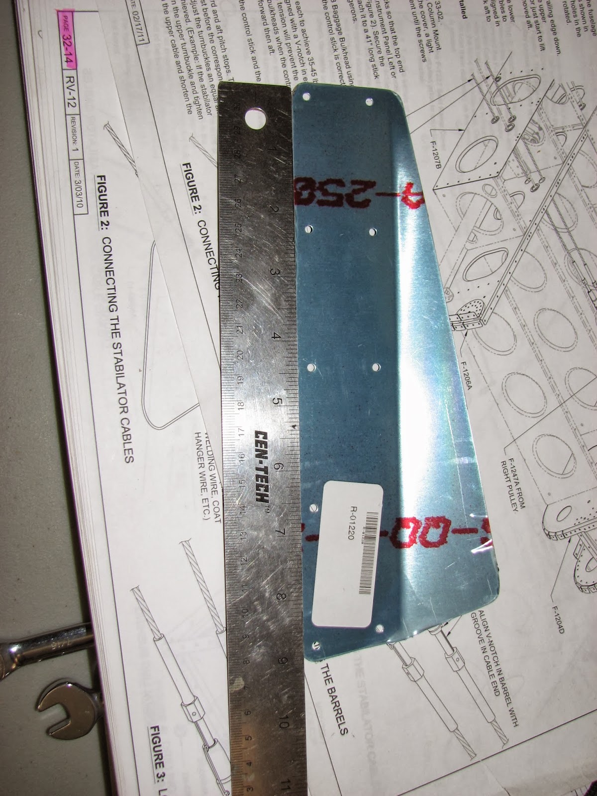

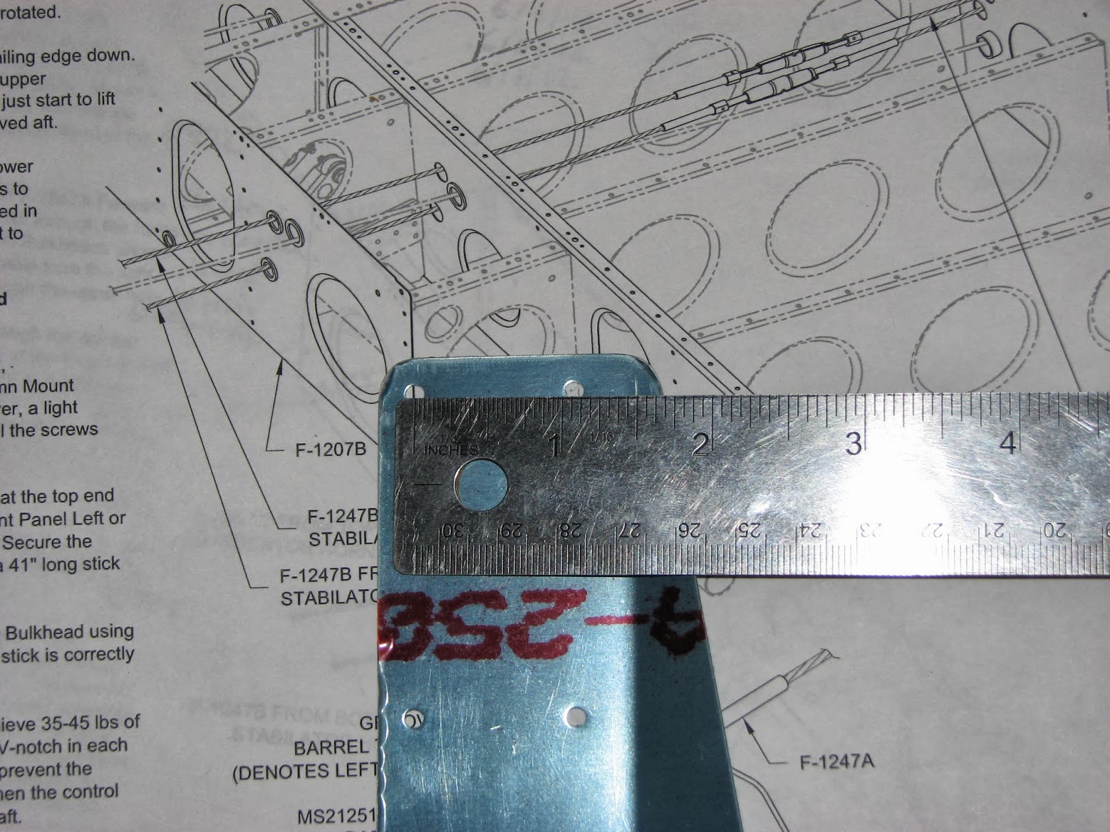

Here are some pictures and measurements for the trim tab:

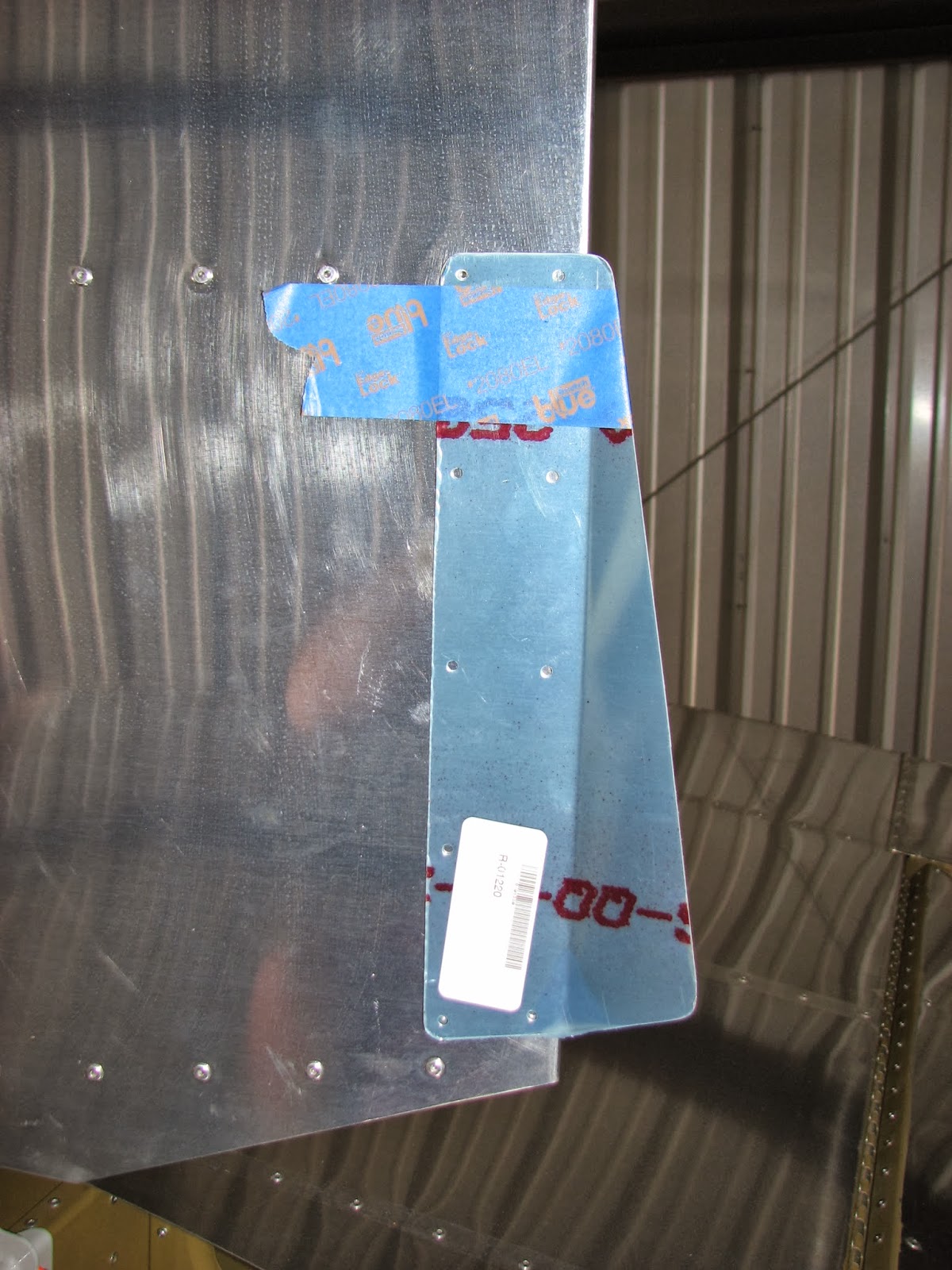

And with removing one rivet, it could possibly go here:
You're right, Joeri, in line with underside looks much better and that's how it is done on the SLSAs as I see now.
