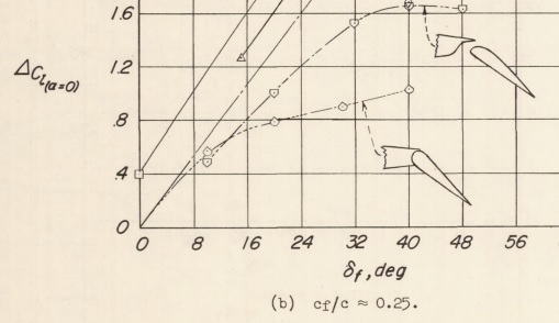

Some quick googling reveals that the increase in lift coefficient from flap deflection (according to papers like
this) looks something like the following. This of course depends on the airfoil and its angle of attack and so on.
For a plain flap, you see that the curve bends around 12 degrees. For the first 12 degrees, your CL increases by about 0.6, and then for the next ~24 degrees, it increases by a further 0.4. So although this will depend on the airfoil, the kind of flap, and so on, you can see that somewhere around 10 to 15 degrees, you start needing a lot more flaps to get only a little more lift.
For a slotted flap, the trend is a little more complicated… but the “diminishing returns” effect is still there: Because dynamic pressure is proportional to the square of the speed, the initial increase in CL (going from 0 degrees to 12 degrees) reduces your stall speed a lot more than the second increase in CL (going from 12 to 35 degrees) even if the added-CL-per-added-degree of flap does not get shallower (as is closer to the case in slotted flaps).
A quick, oversimplified example: A 23012 airfoil stalls when the CL is about 1.5. For an airplane weighing a little over 2000 lbs and with 126 ft2 of wing area, that works out to about 68.4 mph. (This is only a little off from an RV-14. Again, general ballpark, not exact numbers). If 12 degrees of flaps increases the CL by 0.6 to about 2.1, that would allow for a stall speed of 57.8 mph, a reduction of 10.6 mph. If going to 35 degrees of flaps increases the CL by another 0.4 to about 2.5, that would allow for a stall speed of 53 mph, a reduction of only 4.8 mph. (Note that this assumes 100% span flaps, e.g. ailerons drooping along with the flaps, or full-span flaperons… So, again, the lift increase in an RV will be smaller than this).
Even in a back-of-the-envelope calculation, the “diminishing returns” are clear. You get about two thirds of the benefit (stall speed reduction) from the first one third of flap travel.
(Note that max aileron deflections are around 15 or 17 degrees, right?)

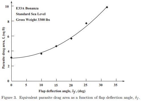

What about the drag? That’s even harder to quantify, because although the wings generate 100% of the lift (or pretty close), the rest of the airplane contributes a lot of drag. So if the drag of the wing – or the drag of the flap surfaces – goes up so-many percent, what is the increase of the drag of the overall airplane? That would be tough to calculate. But even just looking at the flap, as
this study does…
Interestingly, the increase is minor for the first ~12 degrees, then gets steeper, i.e. the opposite of the lift trends. That’s not surprising.
