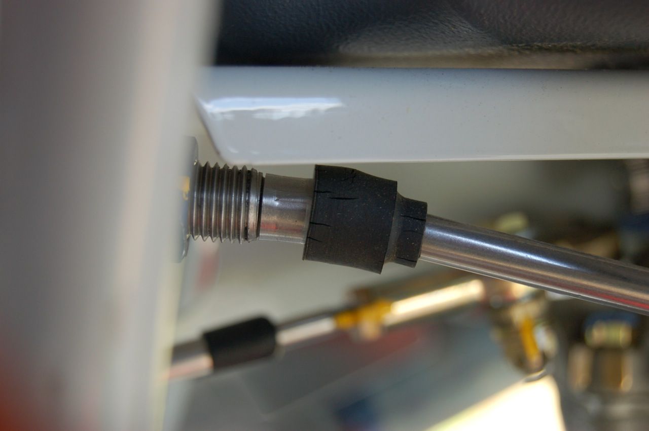

You are very meticulous Paul good job! I would suggest to replace the cable end caps (stock black rubber) with newer ones they are blue. You still have a good access. It will save you headache several years later. Mine cracked and disintegrated after about 400 hours.
I'll put a couple sets on my next spruce order. Thanks for the info.
