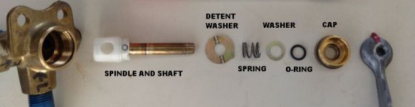

I had previously lubricated the standard Vans brass valve with a very thin film of EZ Turn. It was fine initially, but over time it became difficult, I think more so than a valve assembled dry. So, given its non-performance, coupled with the bad habit of clogging fuel controls, henceforth I'm consigning EZ turn to some dark corner, perhaps never to be seen again.
This time the valve went back together with a very thin film of Krytox on the Delrin spool. Bill Lane investigated and recommended Krytox for fuel cap o-rings, for which it has proved to be wonderful. At this time the valve operates like butter. I'll report in a year.
The interesting point was the stem o-ring. I suspect it gets overlooked a lot. On close examination, it appeared to not be in full contact with the stem under all conditions, having become a bit hard, squared in cross section, and shrunken. See the photo. I'm pretty sure they started life as the same size.
Here's the thing...a leaky o-ring has the potential to allow sucking air into the fuel system prior to the boost pump. It would also need to leak past the spool-to seat contact, which is not inconceivable. A few times in the past year I've seen random fuel pressure reductions during steep climbs, with no obvious cause, boost pump on or off. Well, air bubbles will do it. We'll see how she does in the coming months.
Yes, I know Andair valves are popular...

It's not a case of lubrication, the cone is self lubricating against the brass. The problem is the spring is too firm and forces the cone to bind to the brass. To prove it to yourself, place two fingers under the handle and lift slightly and turn.
I cut out one loop from the spring, and with no lubrication, have had a glass smooth valve ever since.
The valve can be serviced without removing any fuel line fittings.
Back the handle screw off two turns, pull up on the handle to unseat it. With fuel level below the valve, unscrew the cap.
Now lift the handle, shaft and cone from the body.

Part of the problem is the hole in the brass cap is overly large, so the shaft can rock around a bit, and the o-ring can't stay sealed at the extent of movement. Obviously age and shrinkage makes it worse.
I'm thinking about soldering a sleeve to the cap to hold a lip seal, or machining the cap to press one in....but you know how I love overkill.

I also had some recent variability in the fuel flow pressures (0-360 with standard carb) Have about 260 hrs on the plane (valve movement was never considered "sticky") and when I pulled the standard vans fuel tank selector valve this weekend, the O ring around the valve stem had some little brass flakes on it.
The O ring didn't look nearly as bad as Dan's did, but after putting in a new O ring with a little machine oil on it, the first test flight was rock solid on the fuel PSI. Did not really see any noticeable amount of resistance required to move the tank selector after the O ring replacement.

Performed overhaul last fall just as Dan did here...replaced o-rings and used Krytox. Valve is smooth as butter now and detents are more defined.
Added benefit...found last installer used teflon tape for AN816 nipple. :eek:
If anyone is wondering...here are the o-ring part numbers (non-ethanol):
O-rings: fuel selector shaft - Dash 011 (MS29513-011), cap - Dash 018 (MS29513-018)

I burned the fuel out to 5 gallons per side. Took the selector apart, cleaned it up and put the proper lubricant on it. It is smooth but hard to move, detent is perfect. My fuel pressure is much better, higher in the climb. I suspect that I was sucking some air. I replaced both “0” rings. I can live with it being stiff as long as it is smoth.
Fred, what was the "proper lubricant"? If it's hard to turn when lubed with a tiny bit of Krytox, somethin' ain't right.
Krytox
I did use krytox, I put a small amount on the bottom and on the “0” rings. I can fly the fuel off and try again. Could I have over tighten the top?
Thanks Dan.
I don't think it's possible to bind rotation no matter how much the top is tightened. The axial shaft pressure is a function of the spring.
If the tapered part of the white nylon spindle is lubed it should turn easily. I dunno. A bit of grit in there?
