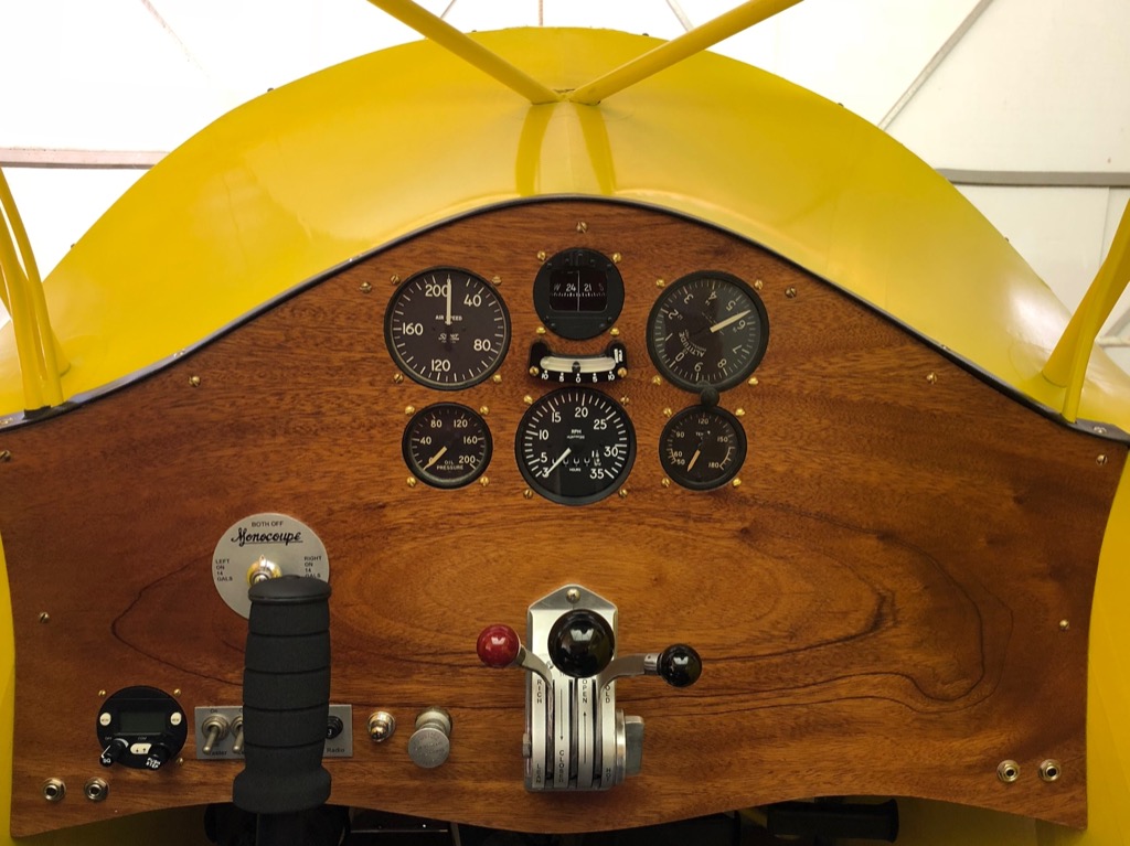

I did this on my 1932 Monocoupe 110. Followed advice and recommendations from other antique plane restorers that had gone before me. Panel blank was 0.063 aluminum. Fit, cut and drilled all holes first. Scuffed aluminum with scotch brite pad. Cleaned with acetone. I used rubber cement. Brushed on both the panel and the back side of the veneer. Let it get tacky (plenty of advise on the internet on how to do this). Carefully position on veneer where you want it (get the best features of the veneer piece). Used a heavy rubber roller (sold at wood/veneer shops) to roll out any air bubbles. Weighted it down with a board and some weights. Let it dry. Carefully back drill holes using a wood board underneath. I cut 90% of the instrument holes out with a razor knife, then finished with drum sander on Dremel tool. Light sanding. Varnish with PolyFiber polyurethane clear varnish (which is what I had to use on the rest of the airframe woodwork). Multiple thin coats with plenty of dry time between coats, you don't want to solvent saturate the veneer.
6 years so far in AZ weather extremes and so far holding up.

Wife is at a sewing event all day, it's a good day to get the Traeger out and finish the panel. I decided to use a spray on poly because my past experience with varnishing has been hit or miss and I didn't want to chance ruining the panel at this stage, and I was afraid I'd get runs on the wing panels. It worked great, but I did 5 light coats and 2 heavier ones to finish. Luckily I had the gas turned on for the hangar this week so it's warm inside.
I was a bit overcautious with the epoxy in a couple spots and the veneer is lifting up/didn't attach well, have to keep an eye on them but most of the spots will have screws/switches over them to hold them down. Contact cement might have been a better option after all. (on my next plane...) As expected, you can see where the rivets are for the nutplates, but they will be mostly hidden. I was able to find a piece that almost matches for the landing gear sub-panel, I hope Fuzz from Car SOS will be proud of me.
I made up a box from 3/4" PVC pipe for it to dry in, but on the last coat a kamikaze bug dove into the wet varnish on the bottom edge of the panel. Got most of the little ******* off, but there's a slight smear. grrr...
And as always, wife knows best. I said I'd be done around 7, she said I'll see you at midnight. 2247 now and I'm getting ready to leave.

There's still another couple things to do on the panel before it's done but they will have to wait until the poly dries, I leave on a trip tomorrow so that will give it a good week. Than add labels and a final coat of poly to seal everything.
Would I do it again? I don't know, I'm a bit frustrated by the areas lifting up, I was too worried about applying too much epoxy and having it soak through. I'm already resigned to doing another panel but it will be a plain powder coated one, probably.
On the other hand, I've learned some things, so far have not made a major project killing screwup, and, if I can pull off the next part, it's really going to look cool, even if it only lasts a year. And I've had a **** of a lot of fun doing this, and that's really what it's all about.
edit: day after.
Yeah, I' totally do another veneer panel.
I was hoping this would come out better, but I'm not disappointed with the results. My local trophy and engraving shop has a laser engraver, I stopped by a few weeks ago and talked about what I wanted and they were all for it.
We did a couple practice burns on scrap and then went for it, and that's where it got messed up. We had done the practice on bare wood, when we did the panel Judy put a piece of paper over the wood to absorb any splatters from burning varnish. Unfortunately it meant the laser did not burn as deeply as we thought, and instead of a deep, dark burn we got a deep, light burn. They were really embarrassed, I was slightly disappointed but I'm happy with the results, I was already planning on doing the panel again next winter to fix a couple thing I wanted to do better. In daylight it's a nice, subtle effect, which might even be better. And it might darken down a little bit with a coat of varnish after I add the labels.
moral of the story: fight like you train, practice like you're really doing it.
